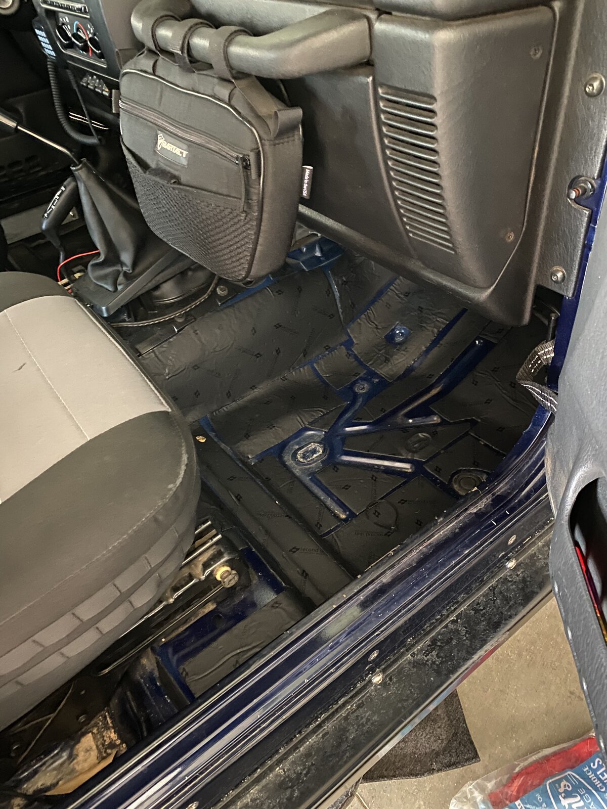

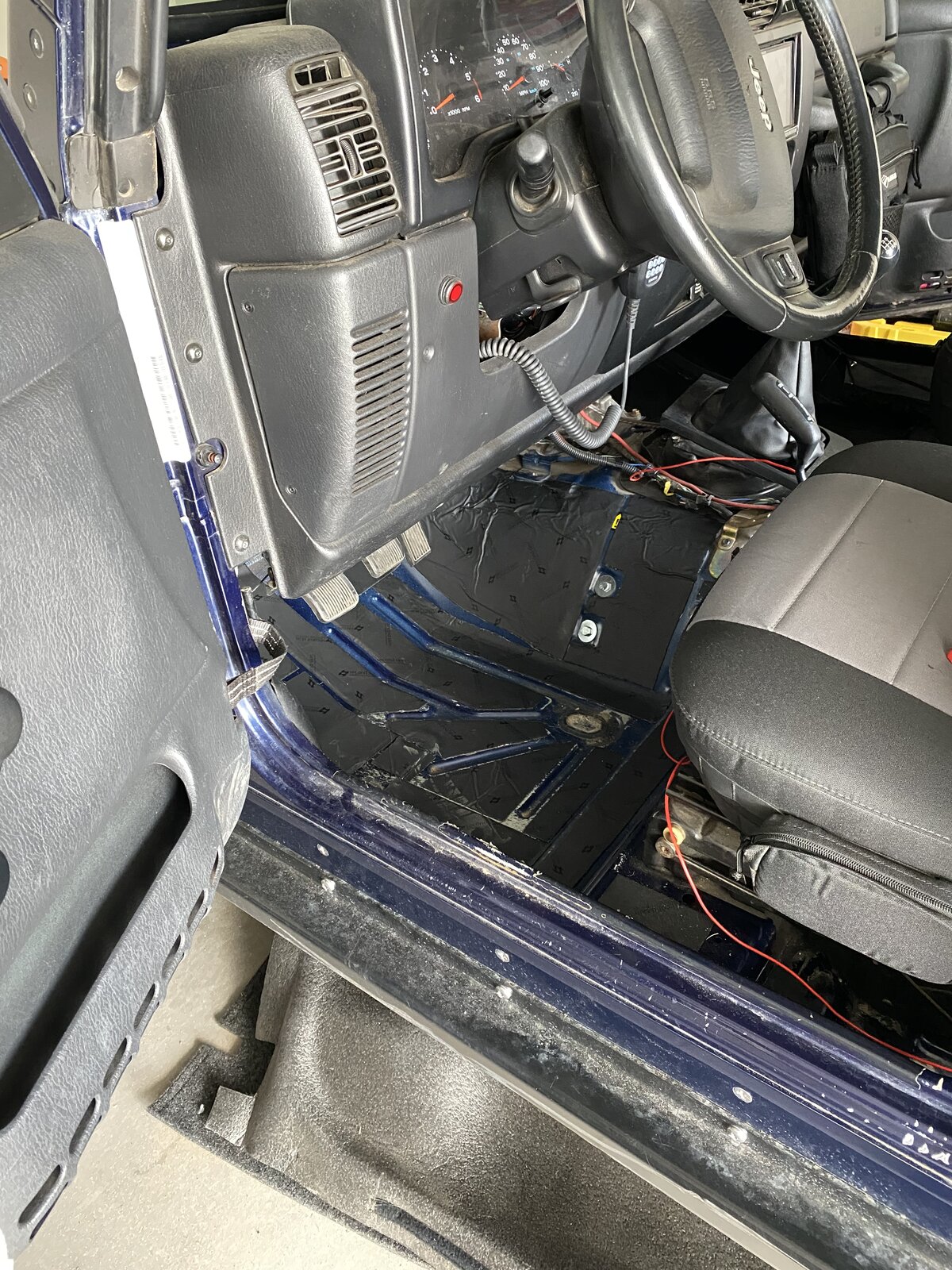

Finished up the floor, and transmission tunnel. I left all the drain canals open, so water has somewhere to go.

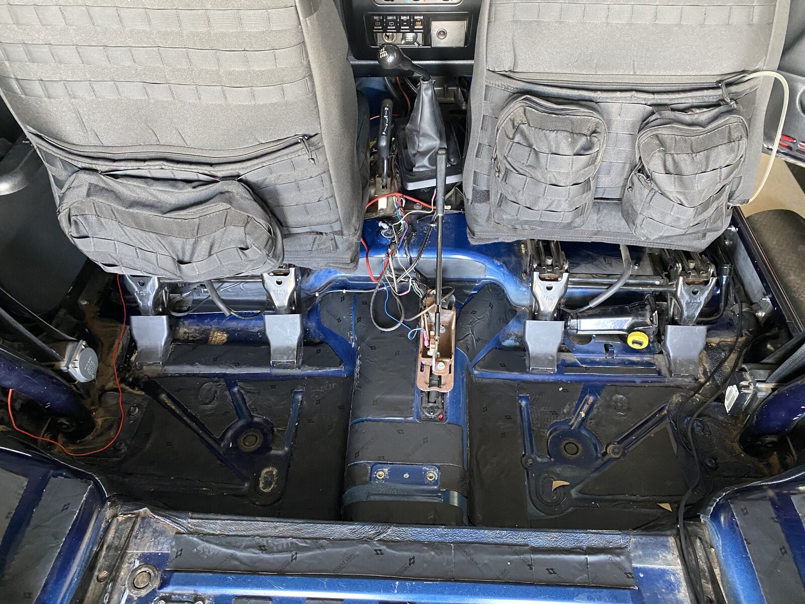

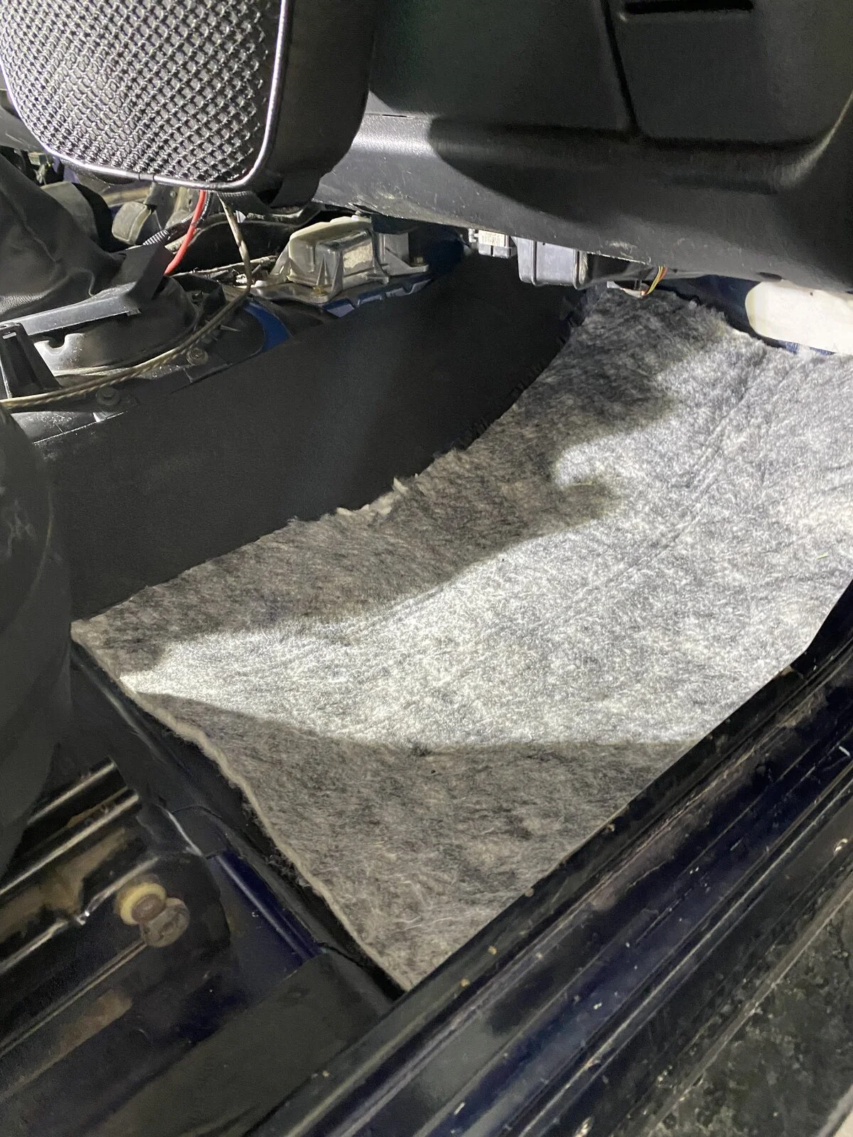

Ok so finished up most of the sound deadening today.
Things have kind of changed. I tried several times to get the mass backed vinyl and foam to work stay out in the quarter panels inside but it was very time consuming tender to keep flopping over. I still may revisit this option depending on how my current solution works out.

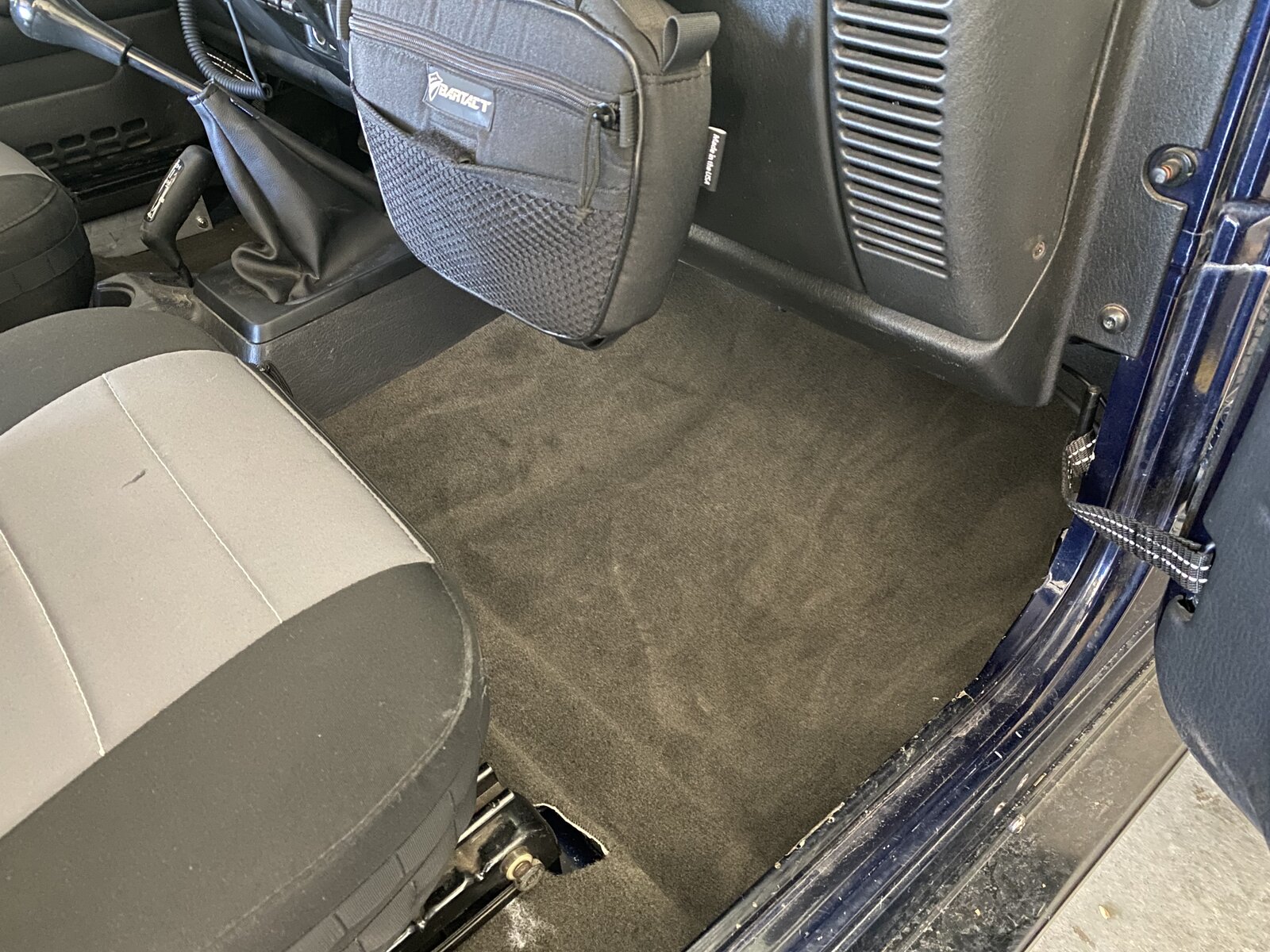

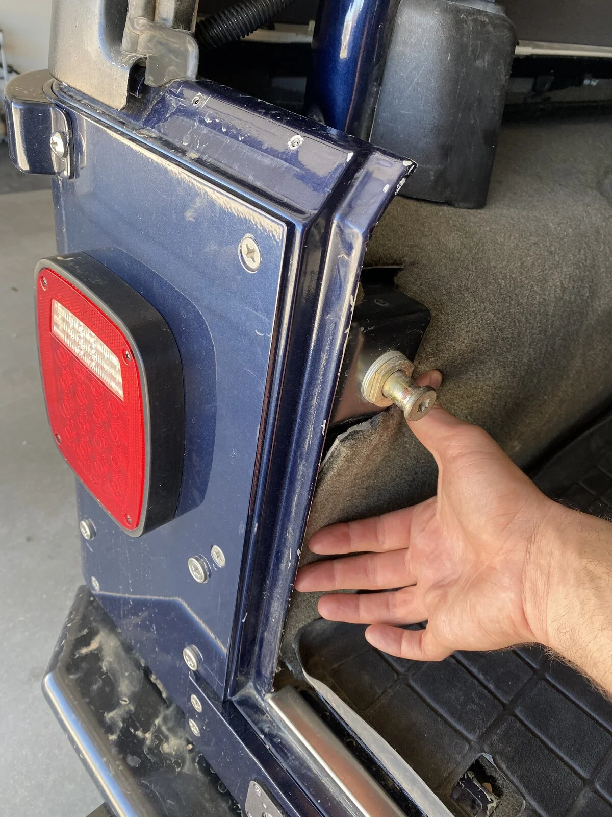

So after learning that the ACC Carpet has a mass backed option I figured that would be easier. For the LJ they only offer the cut to fit yourself option. So I got that for the back figuring it wouldn’t be to bad and for the most part it wasn’t. Other than finding a way to make it stay attached on the sides. (Photo below)
For the front I looked up Bedrugs part numbers for the TJ and LJ and they are the same. So figured I could order the “OEM fit” for the front from ACC for the TJ. Well I am not sure if TJ’s and LJ’s use different carpet in the front or not but I was not impressed at all with the fit and had to spend a long time trimming and cutting etc to get it to fit.

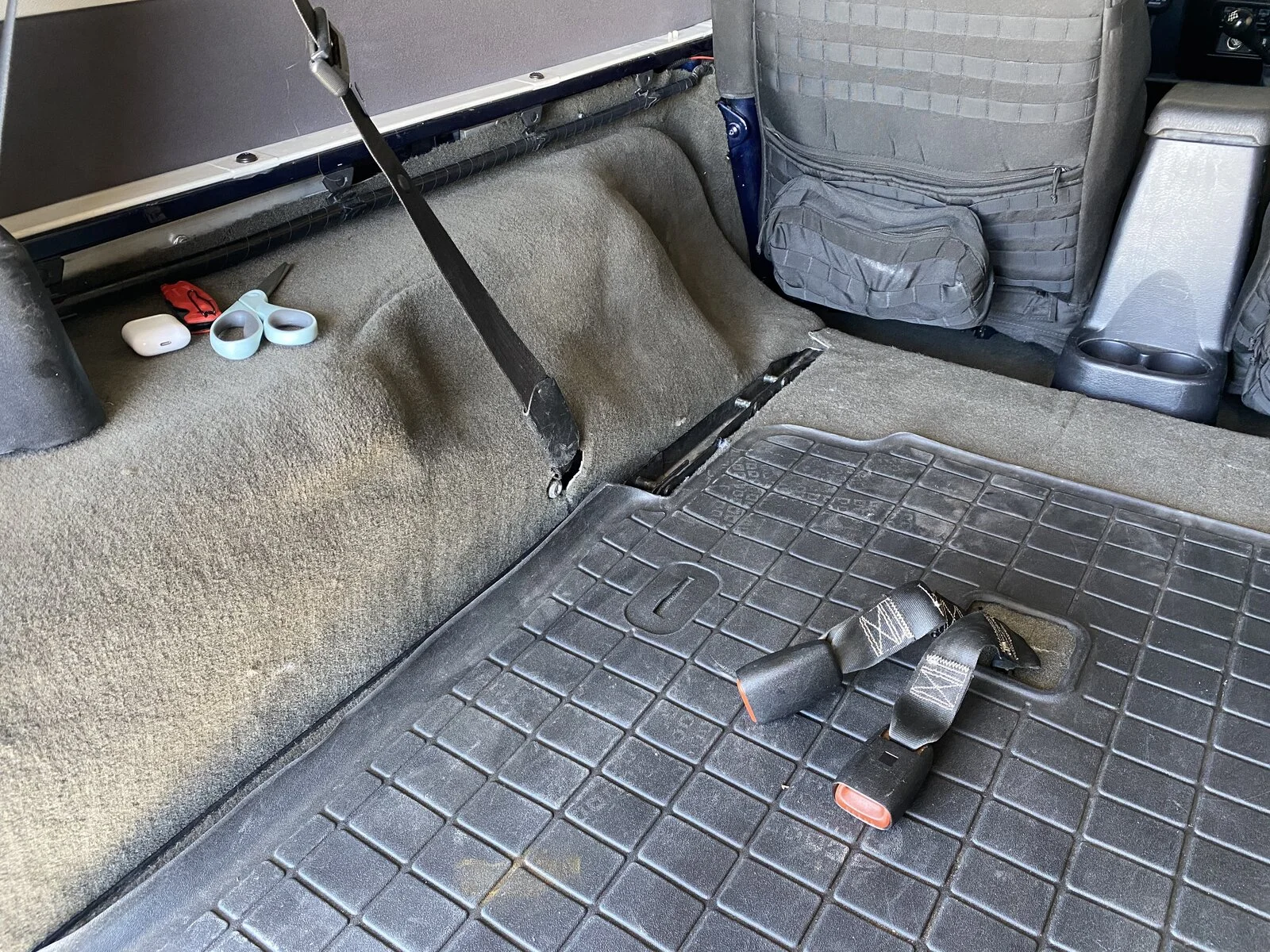

Here’s a couple photos of the finished installation.
I ordered a quality jute for the floor and use a 1/8” closed cell foam on the vertical to act as a decoupler so noise doesn’t transfer through the vinyl. I tried the Jute everywhere but there was no way to get it to fit so had to compromise on the verticals.

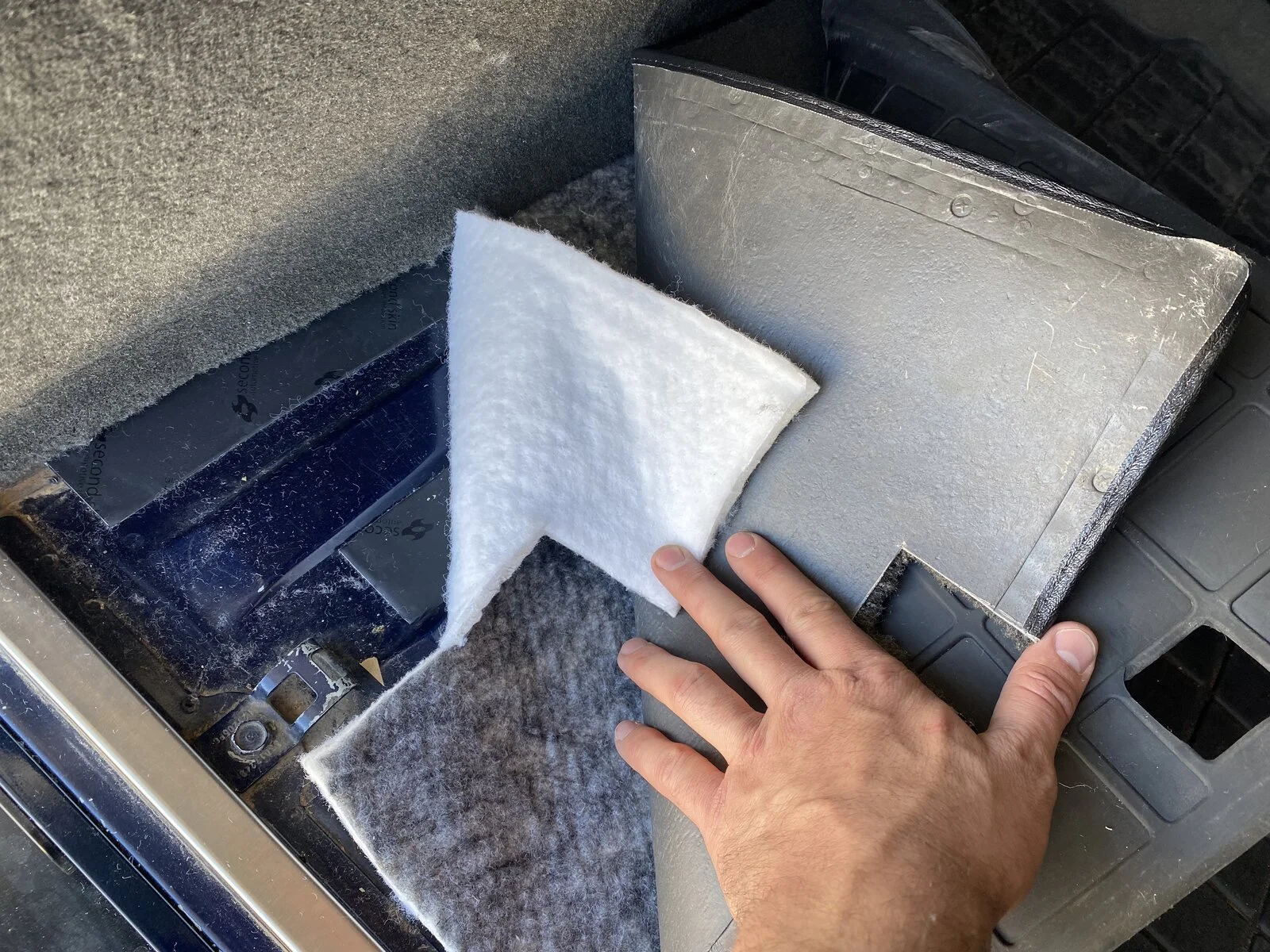

This photo shows what I have going on
Sound deadener on bottom, 1/2” jute on top of that. Followed by ACC Mass Backed ESSEX carpet. The top is just a weather tech floor mat.

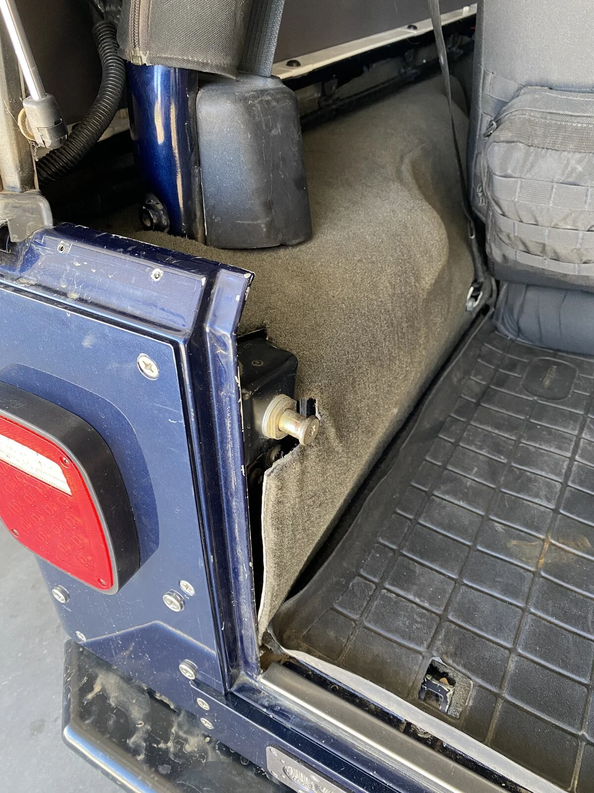

This is the main problem area, both sides are similar. I can’t get anything to stick to the mass backing. Tried some super aggressive industrial strength velcro that is a nightmare to get off metal and it won’t adhere at all to the mass backing on the carpet so not sure how I am gonna finish this out nice.
