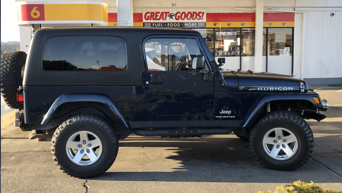

Here is a photo of it getting gas on the way home.
Nice find, looks clean! About what did you pay for it if you don’t mind me asking?

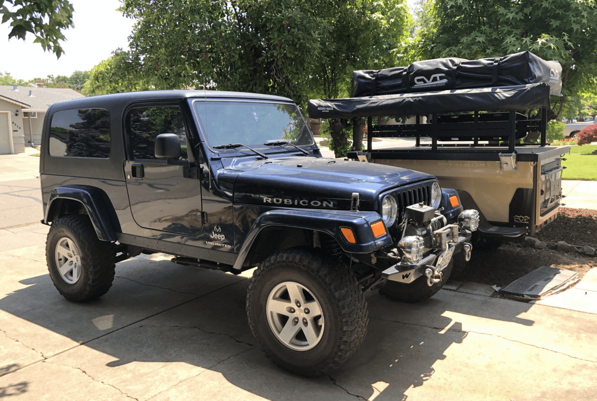

Here it how it sits as of today, finally bringing this thread up to date. It also came with a pretty much brand new trek top so I installed it for the summer, not sure I like the slant back, would prefer OEM style but this top was included so what the heck!
Things I am still finalizing are which Big Brake Kit to run, I know I am going to do a Black Magic Brake kit just need to call and talk to @mrblaine to see which he recommends for my application with towing the trailer etc.
Also still trying to decide which gears to get, seems to be between 4.88's and 5.13's Might opt for 5.13's because I will have the trailer behind me a lot which in CA results in 55mph speed limit. But need to do more research and get feedback from others before I decide.
