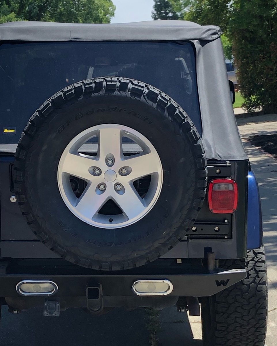

Yeah rear bumper research has been driving me nuts, at first I was looking only at tow rated ones, then realized there not any different than the non tow rated ones and as long as they have good tie ins to the frame and places to hook chains I would be happy. ARB is one I am still considering.

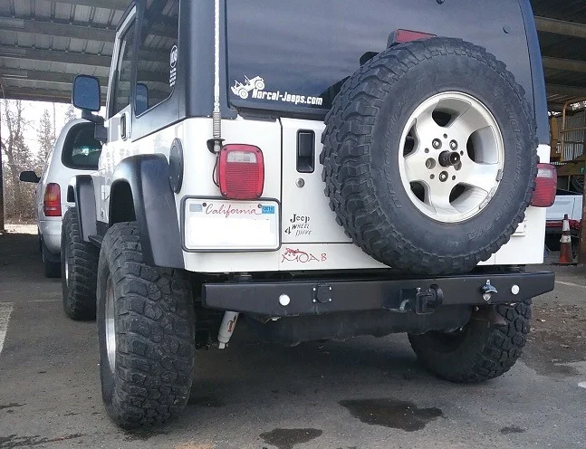

Do you happen to have a direct side shot of your Jeep with ARB bumper on it? I cannot seem to find a good one showing how far it hangs down from a side view.
I am also looking into the nextventure rear bumper for a very minimalist approach.
https://www.nextventuremotorsports.com/product/tj-457/
Checked out JCR too! Bumpers have actually been driving me crazy and I keep going round and round.

I'll go take a picture of it for you.
