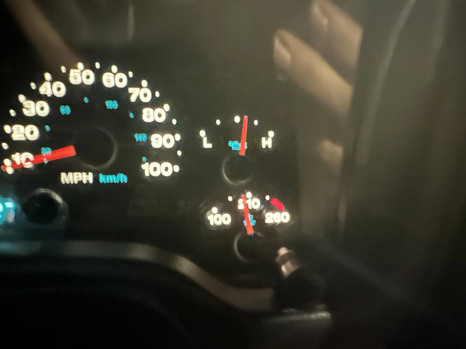

Changed the thermostat over yesterday to a 180. Still needs the controller on the fan to be turned almost all the way up but this is after pulling a trailer around most of the day. Stays 20-25 degree cooler even when running the AC. Of course it’s a totally different Jeep with a big motor and different transmission. But the one thing that I noticed most after the power increase, was the way it rides. It just feel softer almost and that can only be from replacing the body bushings all around. Y’all check yours out and if they even look remotely worn out…change ‘em. It’s cheap and easy to do and I promise you’ll feel a huge difference.
Mine runs right at 183° with the 180° thermostat.

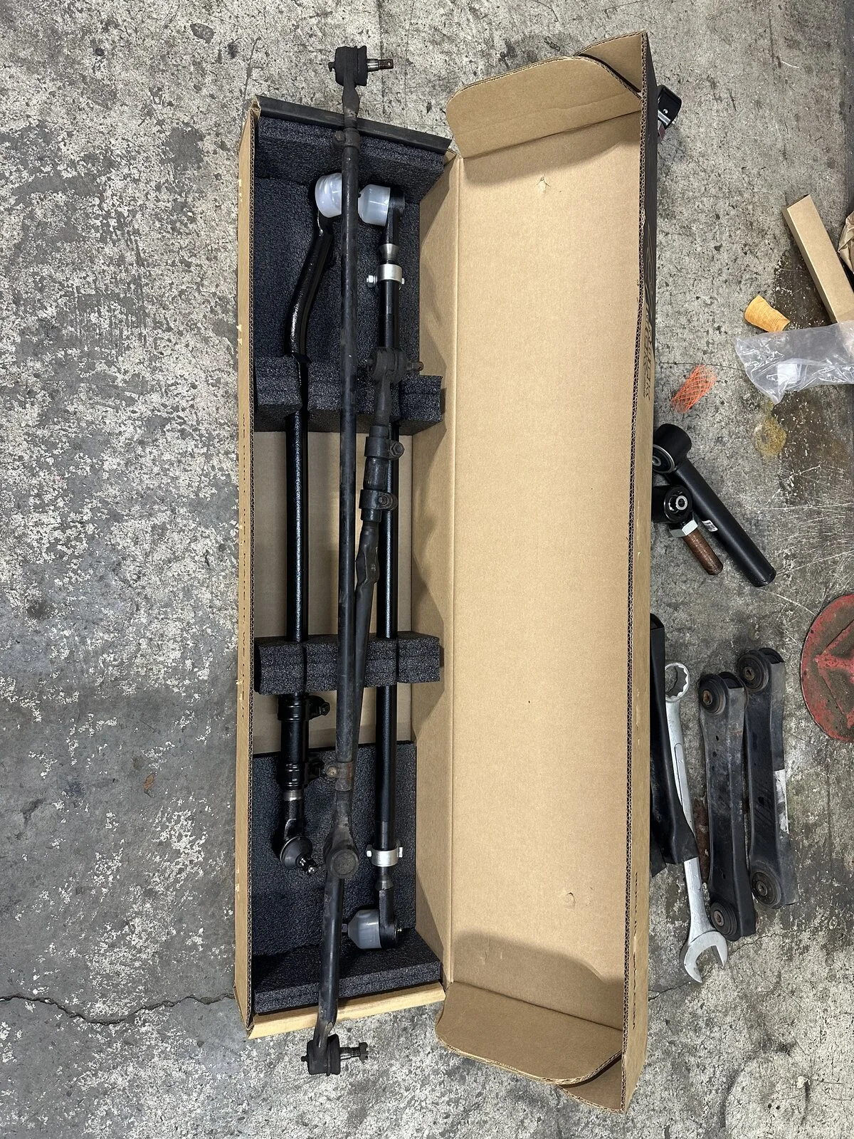

I probably will do the complete Curry Currectlynk steering setup just because.

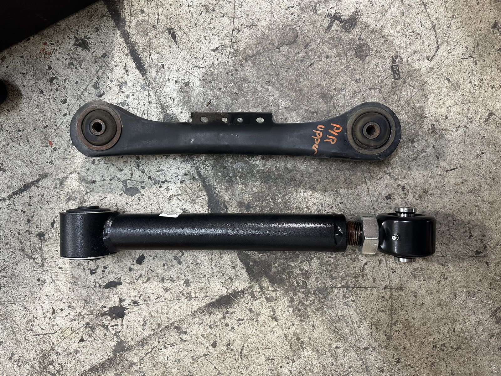

Added Rough Country’s upper and lower adjustable control arms along with the Currie Currectlink in efforts to track down the vibration. The factory bushings, sleeves and ball joints in all parts were toast. Waiting on new quick disconnects for the sway bar to come in. Not because I think they could help the vibration but because the boots were torn and shot. Had an alignment done after installing everything and lo and behold……….still a vibration. So at this point the tires have been road force balanced twice, rotated tires everywhere, pulled the front drive shaft, pulled the wheel spacers. I even jacked up the rear end enough and put it in gear to make sure an axle shaft wasn’t bent. Still trying to find someone local with factory tj wheels they aren’t using that I can try on mine to see if it’s a bent wheel or something but when they’re spinning on the balancer they look perfectly round. I’m kind of at a loss at this point. Other than upgrading the sway bars and track bars which I plan to do soon, anything else to try or check?

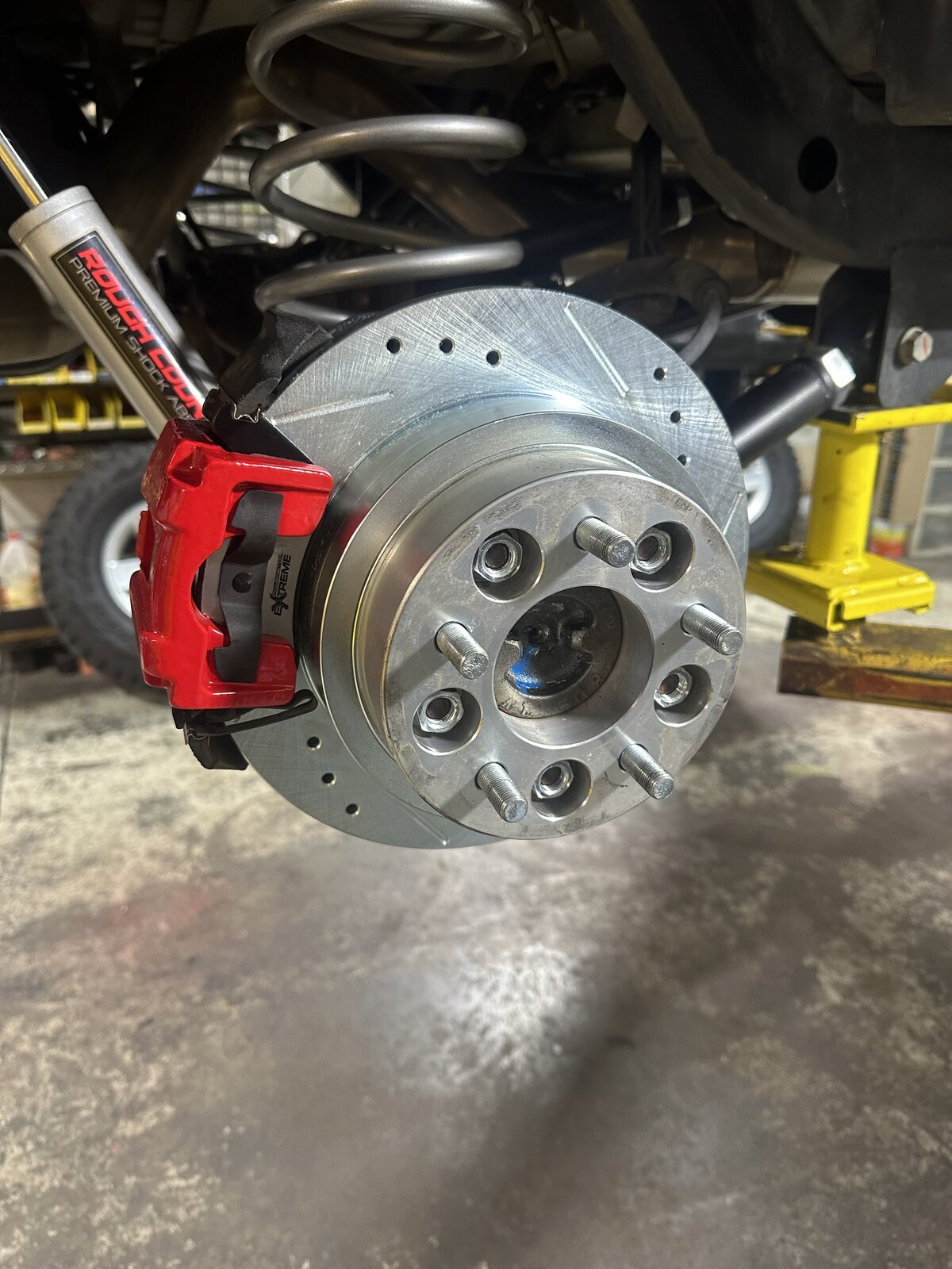

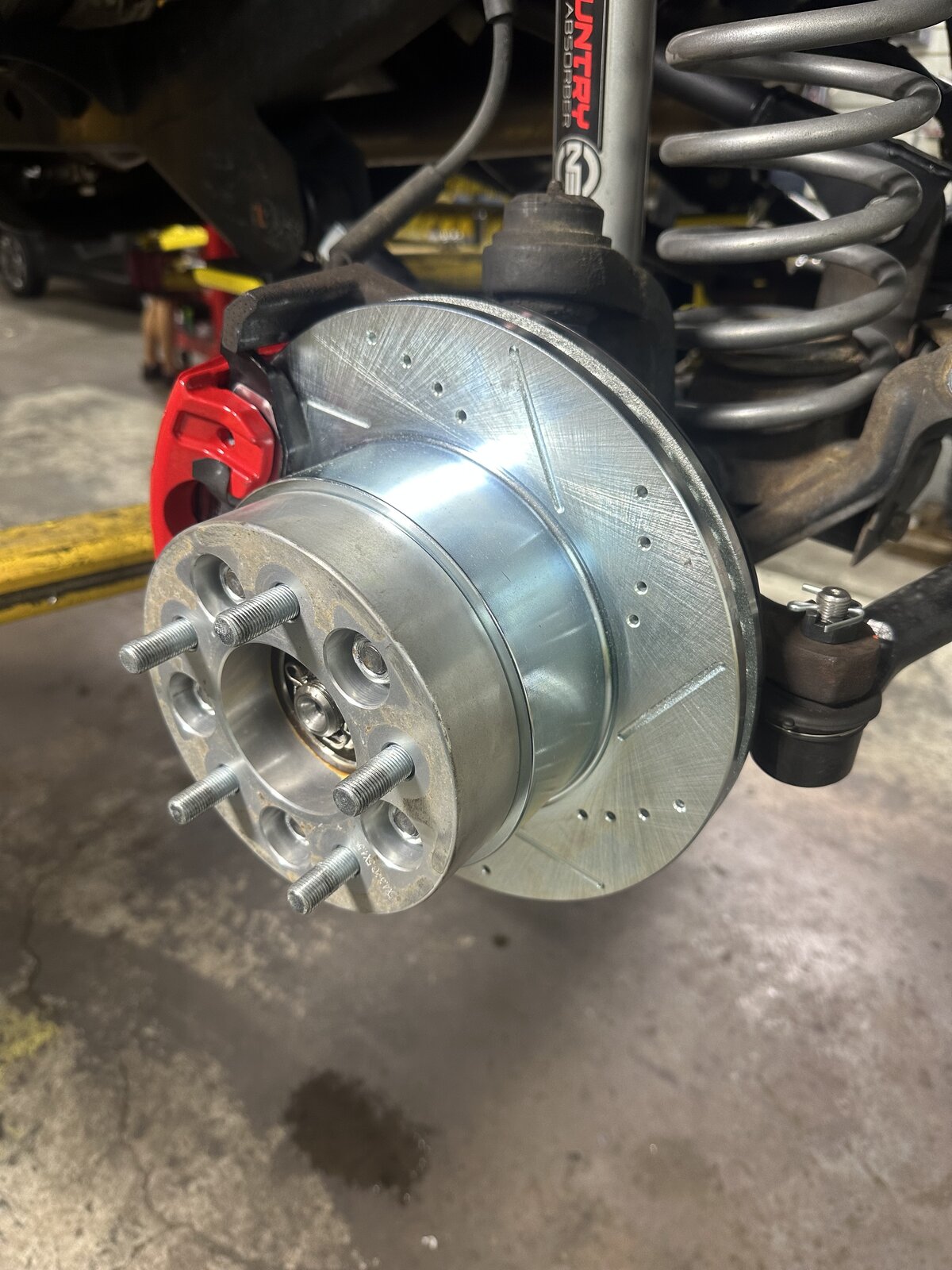

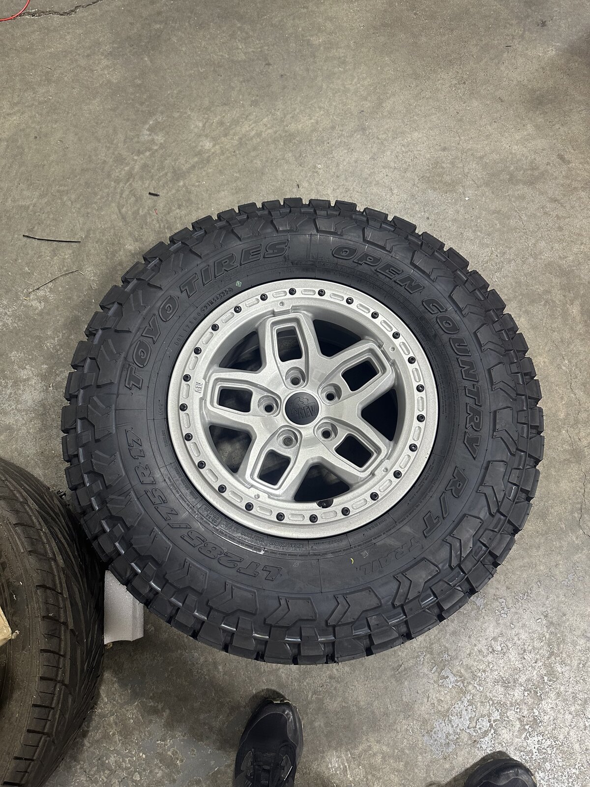

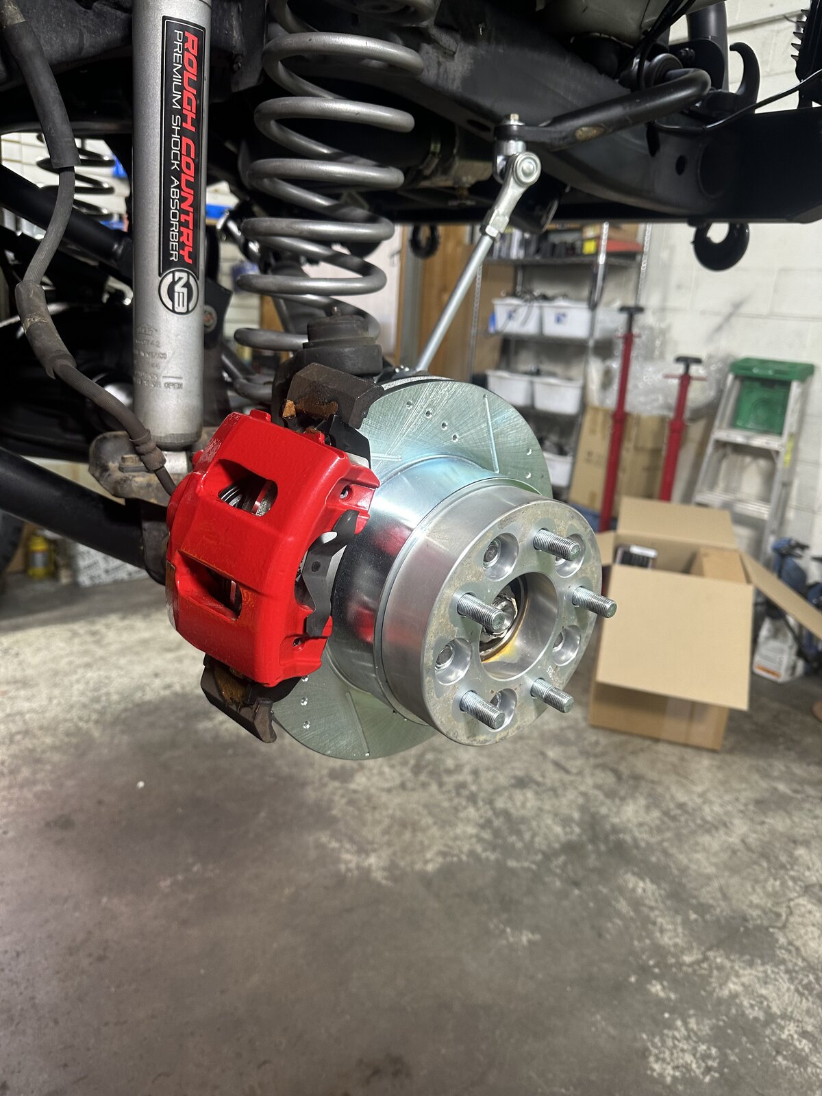

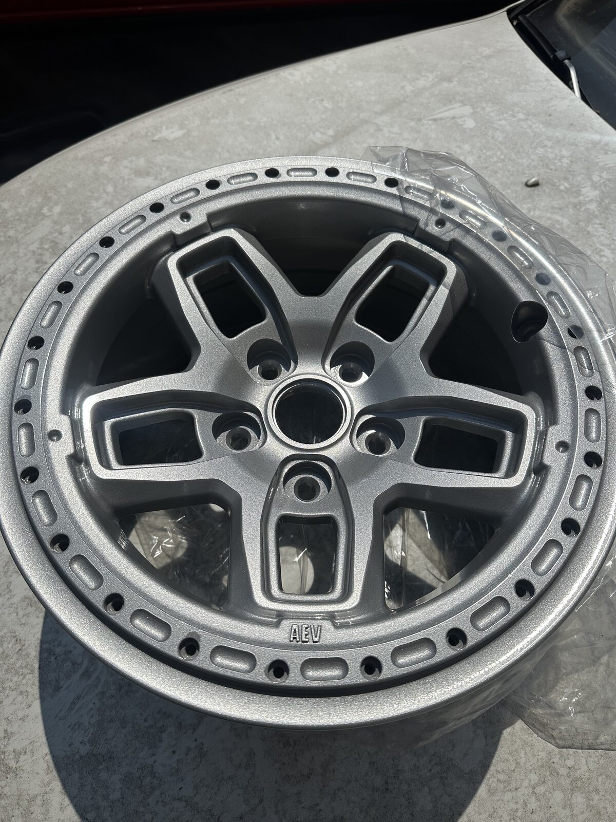

Been a little bit since I’ve updated. Made a few changes to get ready for Jeep Invasion to be in the Tom’s 4x4/Rock Solid Motorsports booth. Was able to find a super nice set of the Warn sliders I’d been looking for. Drove 756 miles round trip in one day for them too! Just like Warn powdercoat does, it was flaking pretty bad so I had them blasted and recoated. Had the black AEV Borahs I bought a while back blasted and recoated in a silver close to the factory Rubicon wheel. Went back and forth on just setting them up as a bead lock but I’m gonna hold off for now. Had to get new tires going from a 16 to 17 so it was a good time to try the new Toyo RT Trail. 285/75/17. Other than a little more aggressive sidewall, it’s the same at the RT. It still had the original pads and rotors on it. Figured it was time to change them. Ended up going with the Powerstop kit. New pads, cross drilled and slotted rotor and new calipers. Happy with the way everything has come out at this point. Other than a cage which I’ll work on next summer…I think I’m done. Never owned a vehicle before that I’ve done everything I wanted to to! Time to drive it for a while I guess.
Those Borah’s look great in silver!
I really like the silver Borahs! Did you know that AEV published a list of "approved tires" to use on them? In the event that you switch over to functional beadlocks, it might be worth looking into to see if your tire has been tested/ approved. Or it might be a dead end. :/
https://www.aev-conversions.com/product/jk-borah/#ring-option
