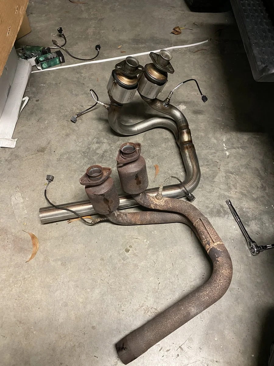

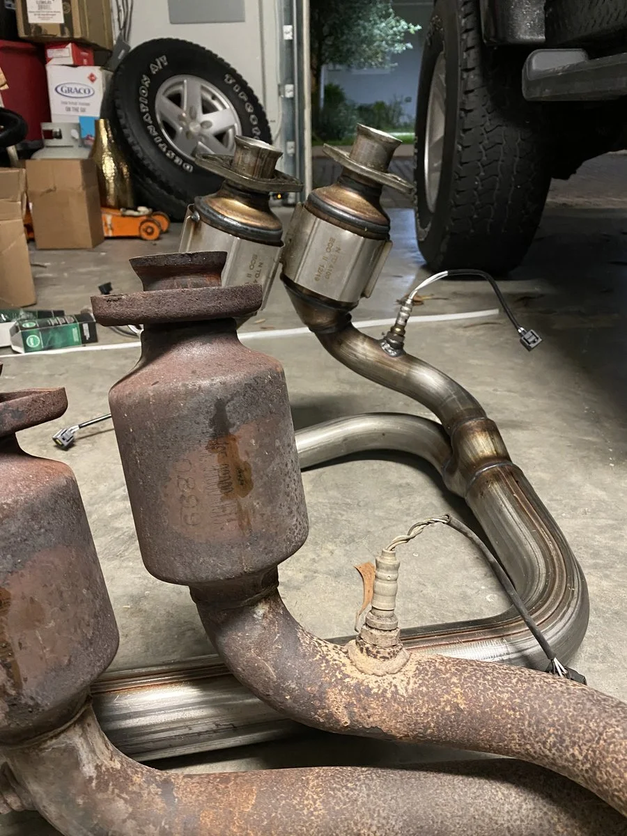

Catalytic converters are done with new NTK O2 sensors. Don’t know if someone did this as a sick joke but mine has different size bolts. The back two bolts of bank 1/2 cats are 15mm with a nut on top you don’t have to hold. The front two bolts of bank 1/2 are 11/16 or 17mm, different on top and bottom. Don’t remember that being the case on my 05. Managed to get everything off and new ones installed in about 3 hours. This included full exhaust. Everything until the end of the 3rd cat is installed, I’ll have the thrush welded muffler done today and carried out to the back as OEM. My last LJR had a turn down but now that my daughter will be in the back I don’t want her getting fumes in her face.
While I was under there, the drivers side oil pan is seeping, rear main definitely is and drivers side valve cover. The heat the drivers side has does wonder to gaskets. I’ll address them in time.

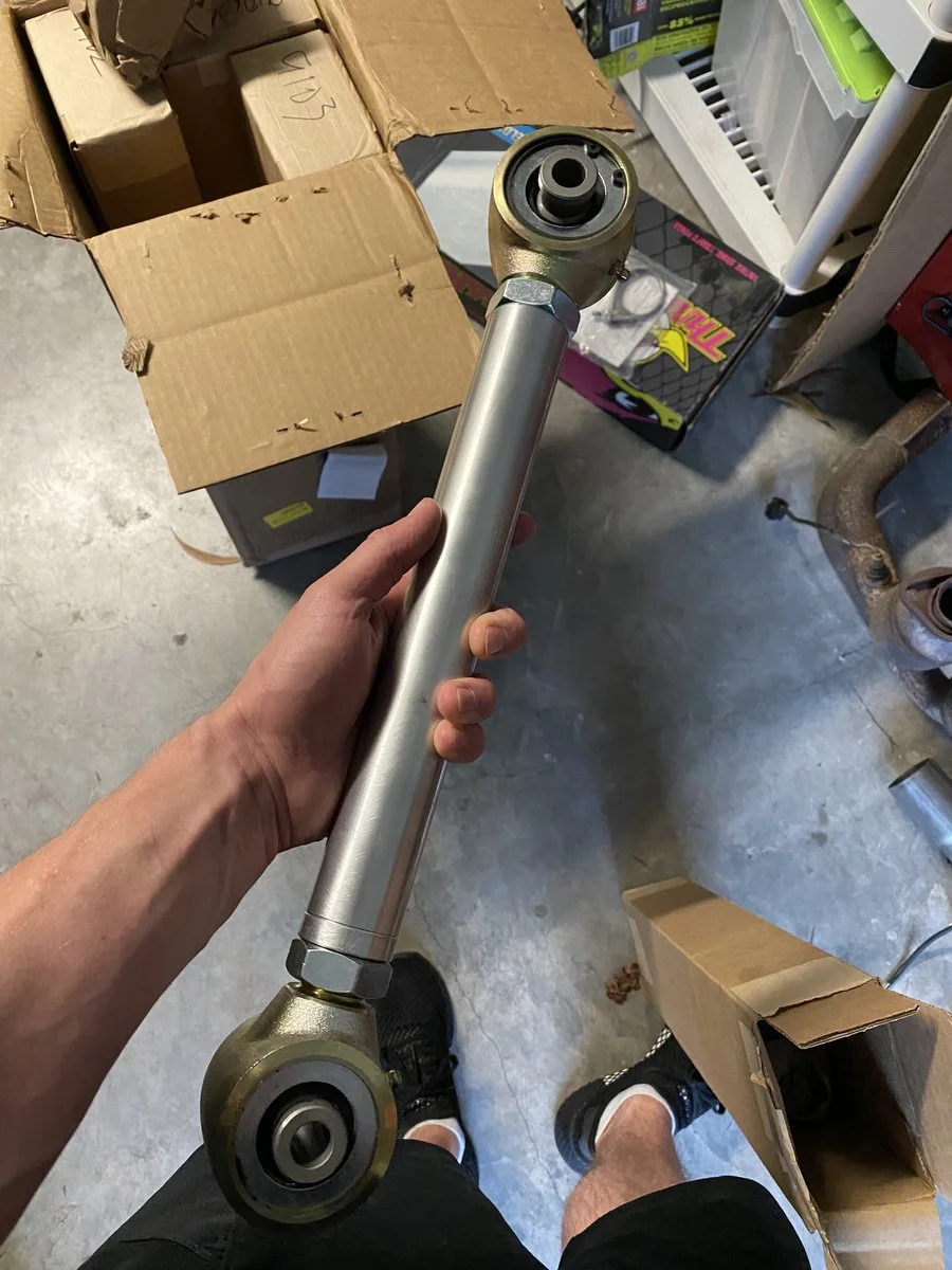

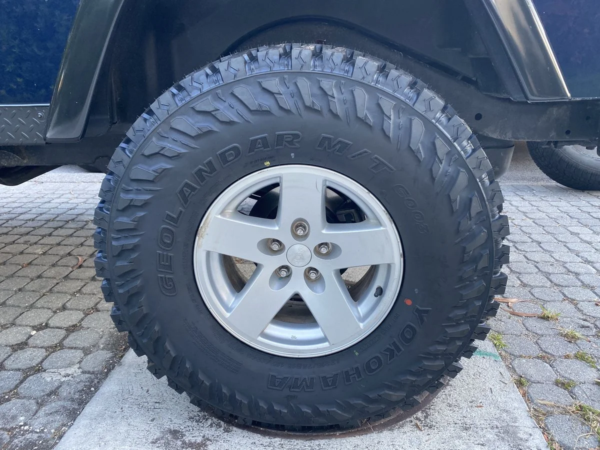

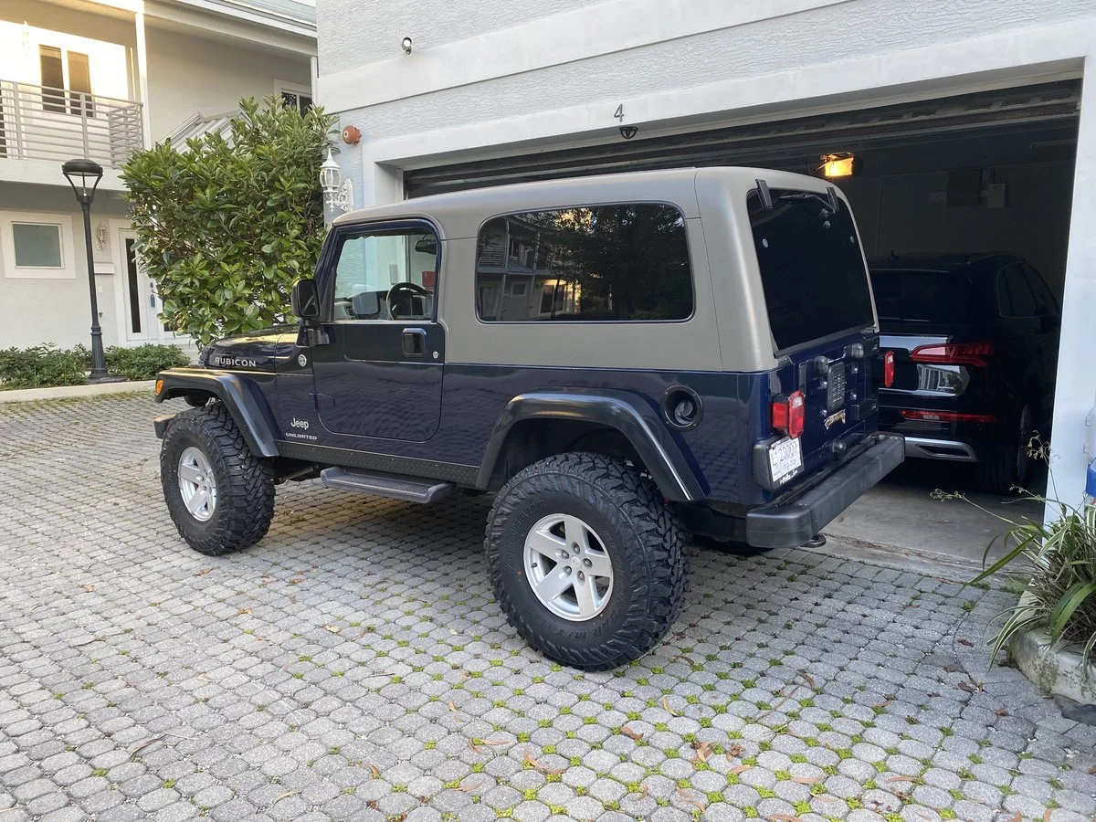

Full brakes with lines, RP synchro going in the transmission, radiator flush, low pressure switch for the AC which was my leak, all getting done today/tomorrow. Savvy arms showed up yesterday, rest shows up today. That gets done Wednesday and Thursday. 315/75/16 Geolander MTs are getting done Friday. I know I said I wasn’t doing 35s but I couldn’t pass on the deal I got through a connected friend. Shot him an email and he replied saying, “You’re going to email me in two months saying you need 35s, so get them now. Here’s the deal I can do for you...” Price was too good. I’ll have to adjust the bump stops as I don’t have a body lift yet but this will be pavement queen for time being so shouldn’t be an issue.
