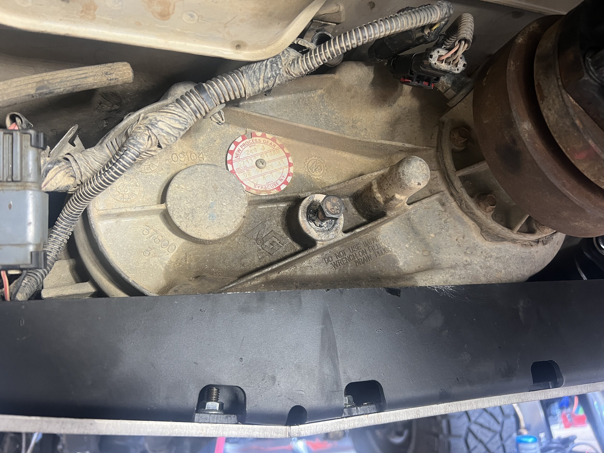

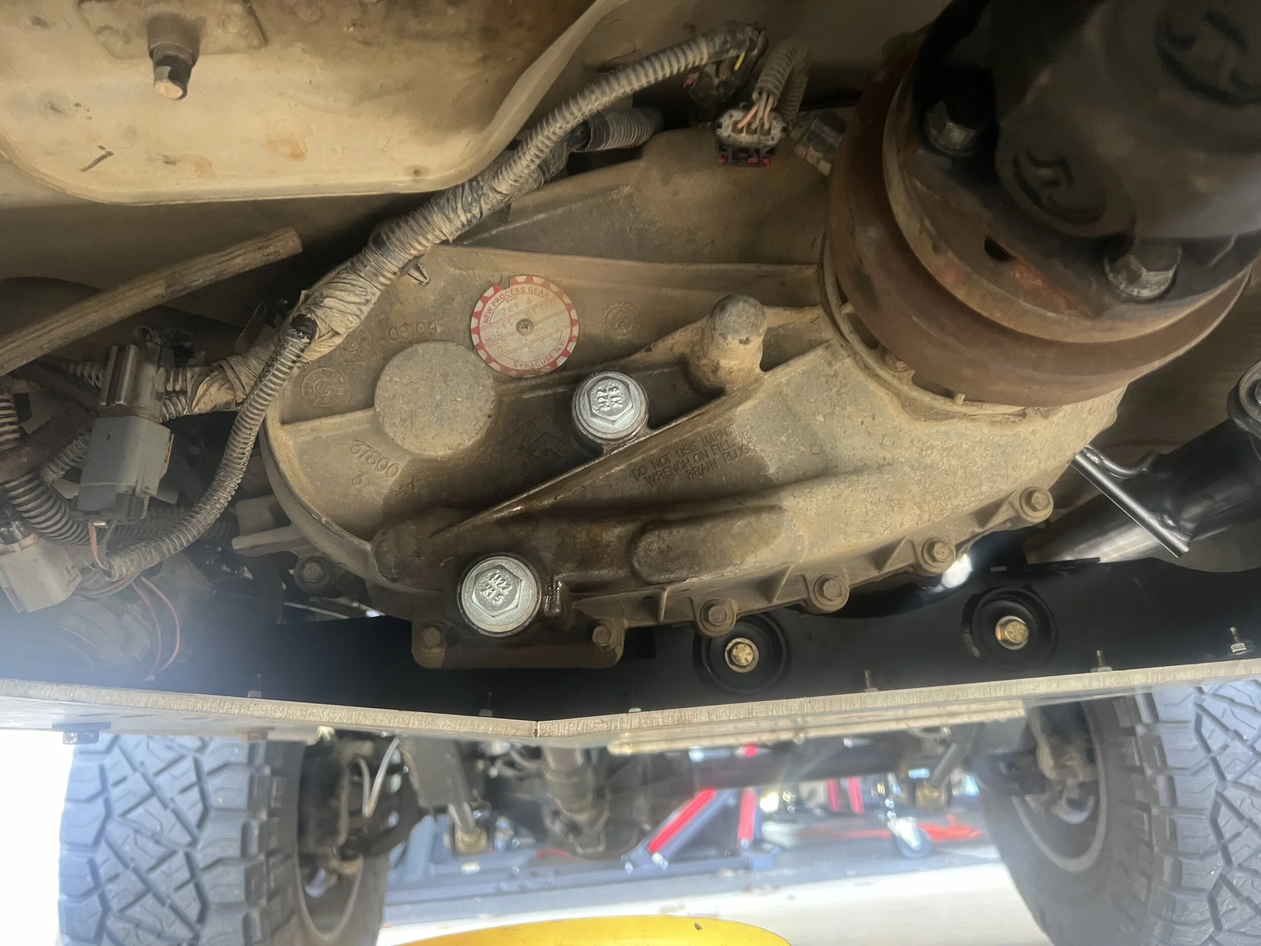

Took some time today to replace the fluid out of the transfer case. Realized I’ve never checked it when I first purchased the rig. The fluid was in great shape but the fill plug was practically seized on there. Ended up having to weld a bolt on before I was able to remove it. I ended up replacing both drain and fill plugs with hex heads instead.

Aren’t those pipe threads? Where did you get a pipe plug with a hex head?

There was a forum member here that mentioned googling a “Doorman M22-1.5” when he replaced his.
I believe the Doorman part # was 090-055, heres a link.
Are you using copper washers? (edit: looks like you have aluminum washers)
Either way, I'd be nervous about mismatching threads in this application (good catch @Mike_H ). You don't want leaks or the case threads to be compromised. I wouldn't assume that the fasteners are under proper tension or will stay that way. And the change interval is something pretty high like 60k miles iirc. Not telling you what to do...but would be remiss if I didn't share my concerns.

That is not a pipe thread. I hope it works out for you. To be totally honest, I don't remember if those drains are pipe thread or not, but I'm pretty sure they are.

I recalled it being a felt-type gasket that was included for both of them. The plug itself is suppose to be an Oil Drain Plug for a BMW/Subaru when I was looking for more information.
I appreciate input from the both of you, last thing I’d want is to blow my transfer case. I’ll pay close attention to it moving forward and worst case order a new fill plug.

Yeah, if it’s not leaking, run it. That would be the only worry I have, as long as it’s not protruding into something in the case.

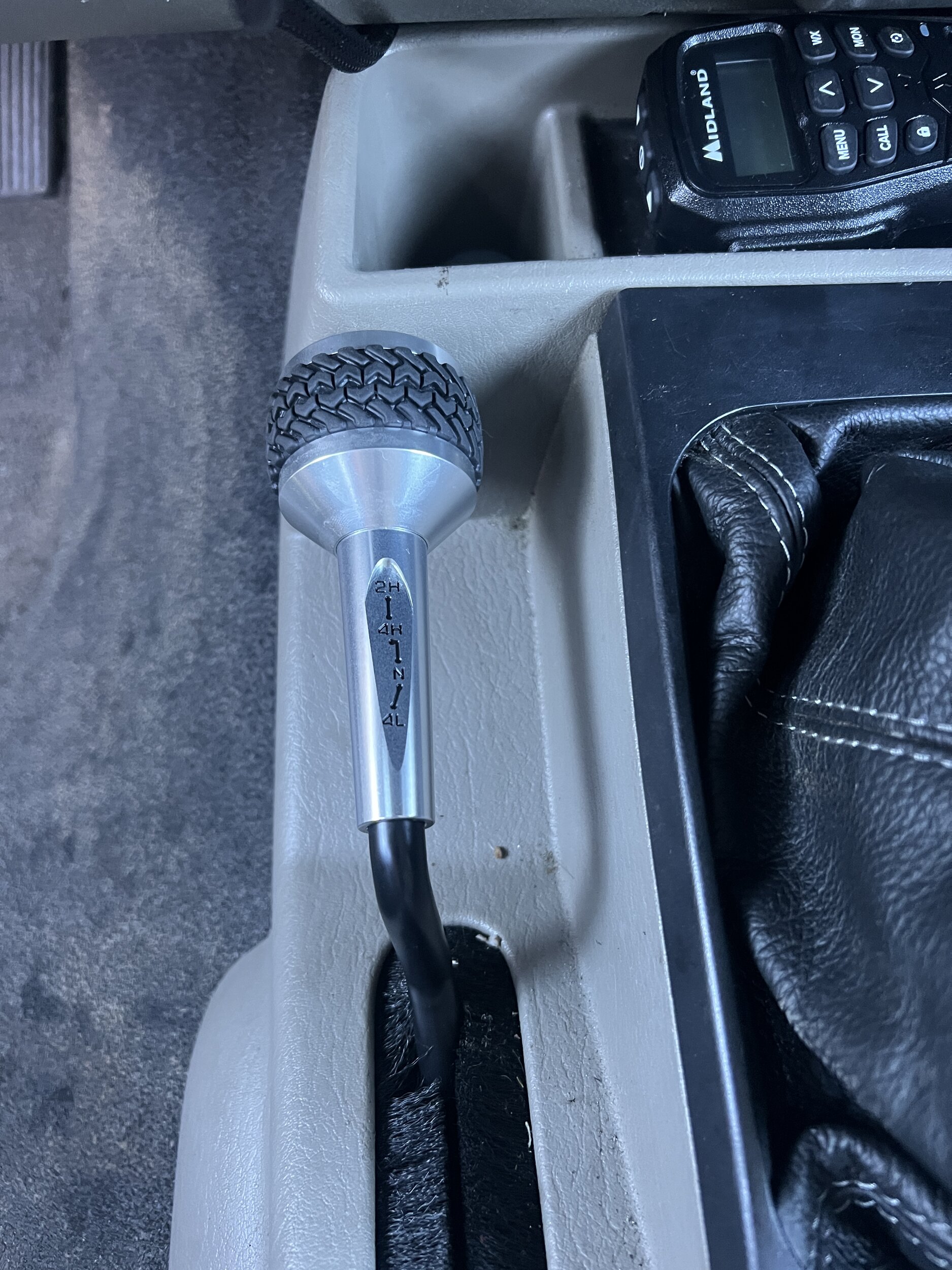

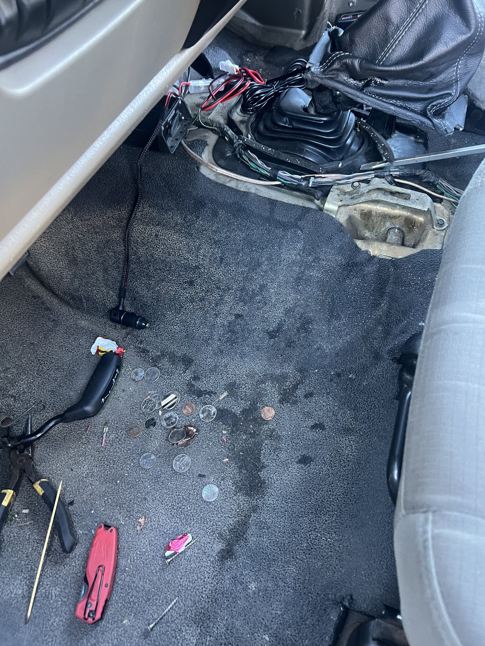

Took some time out of the morning installing the DV8 4WD lever and Shifter Knob. I’ll likely end up removing the shifter knob and remove the black anodizing to match the raw/aluminum finish. It was a straight forward installation and ended up finding a few dollars worth change that my youngest had found a way to hide under the 4WD lever 😂. Also threw in the Midland MXT 275 I picked up on sale in November.

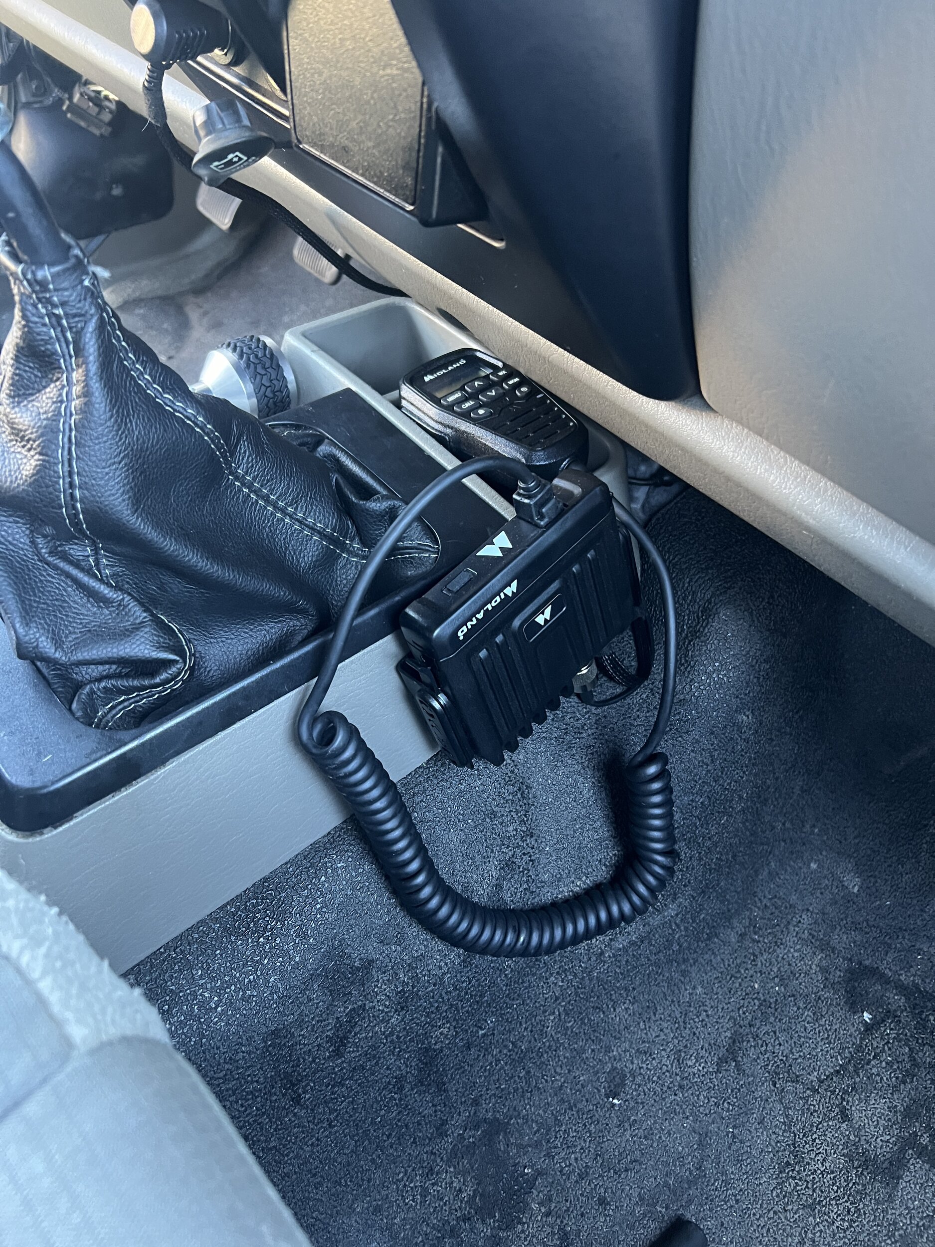

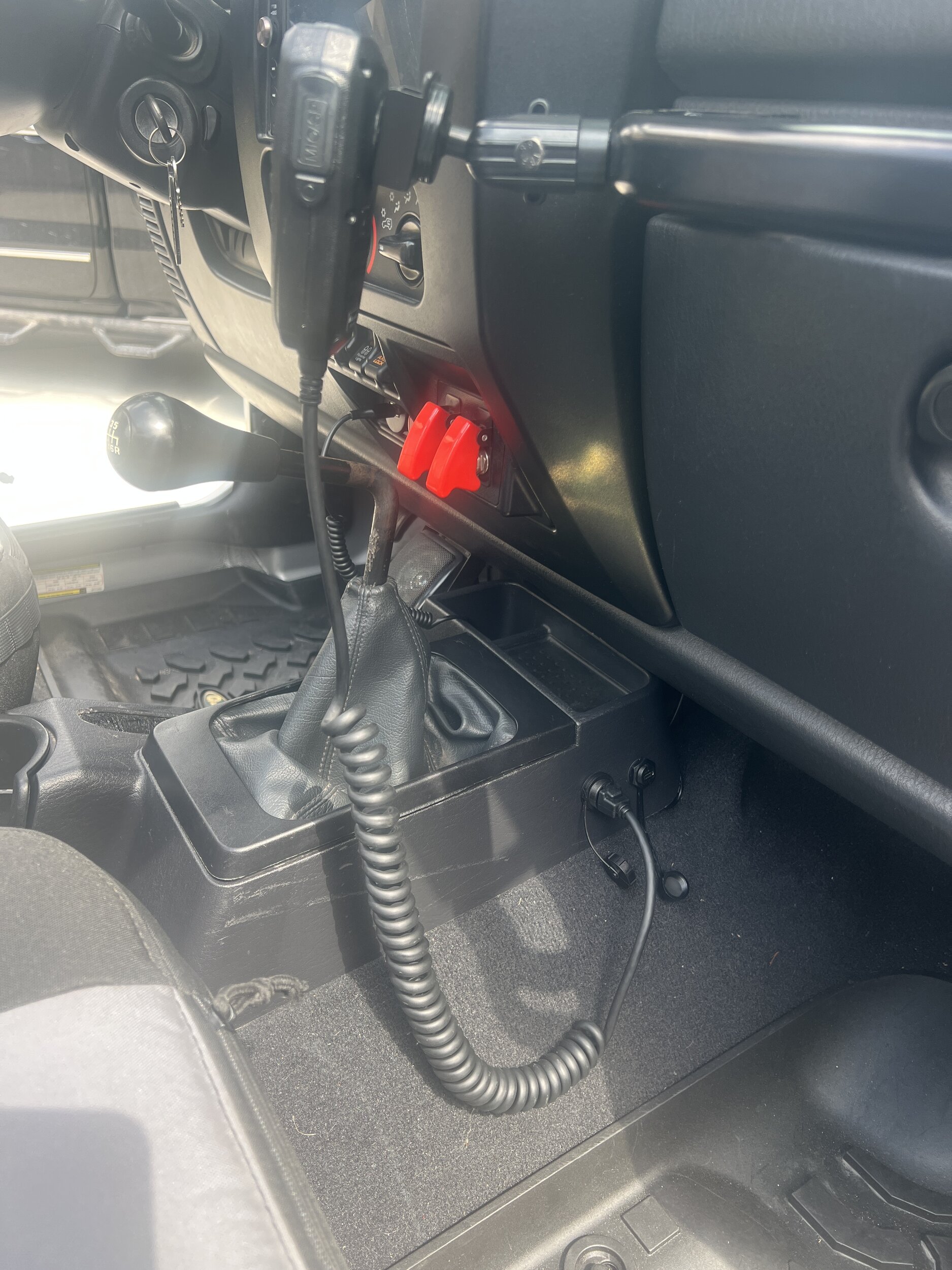

My Midland radio of the same model fits underneath where you have your mic resting. I used Cat 5 and USB C bulkhead connectors to clean it all up.
You know, it was a quick solution but I was thinking of better ways to mount it and think you absolutely killed it with yours. I’ll likely copy it. I had plans to mount my mic on my 67 Design mount with similar arms you have once I have another 20mm ball from the company.
Thanks. In the picture I have a Bulletpoint mic holder attached to an aluminum passenger grab handle. The handle was a bit of a splurge but I really like it and never even considered it as a mounting point when I bought it.

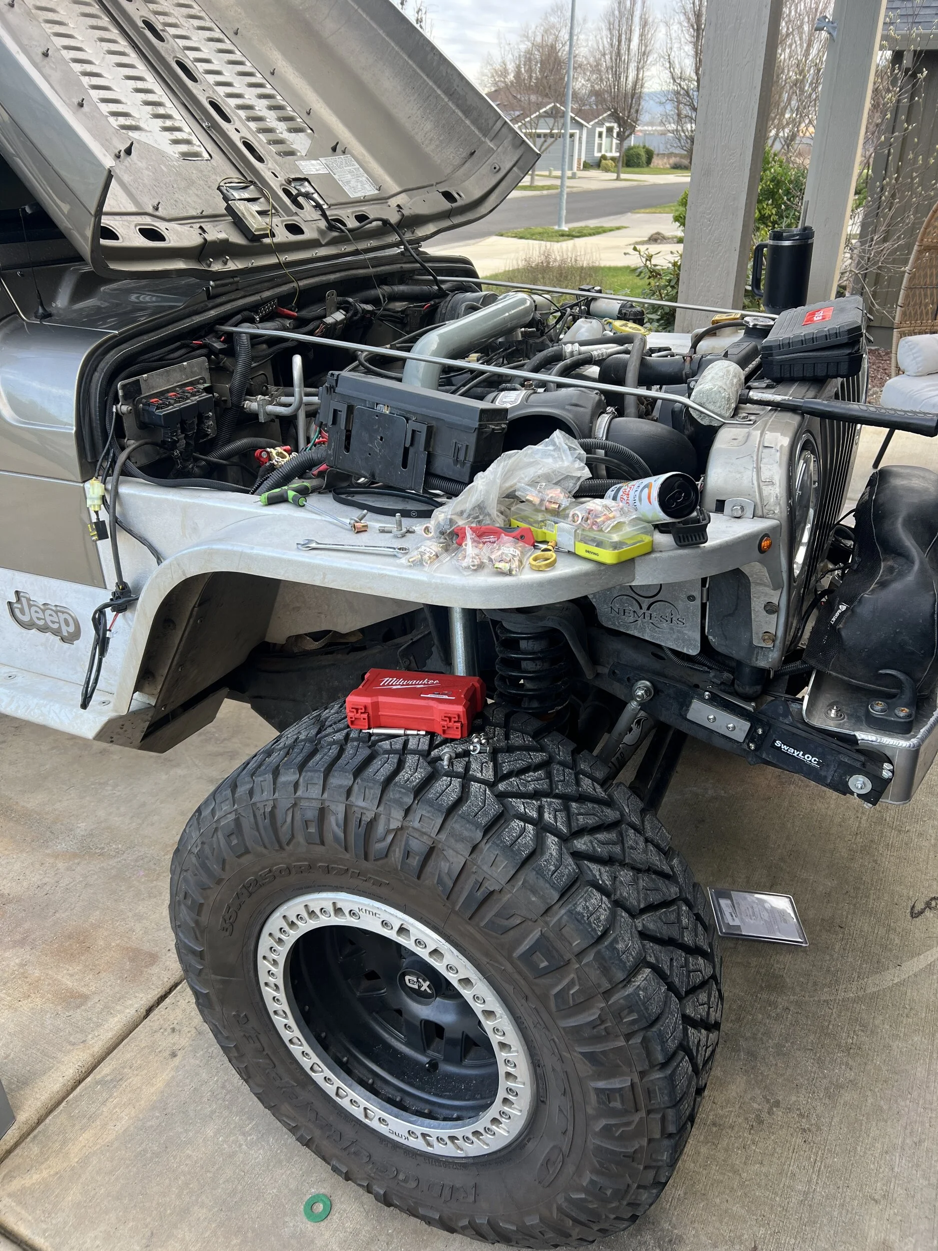

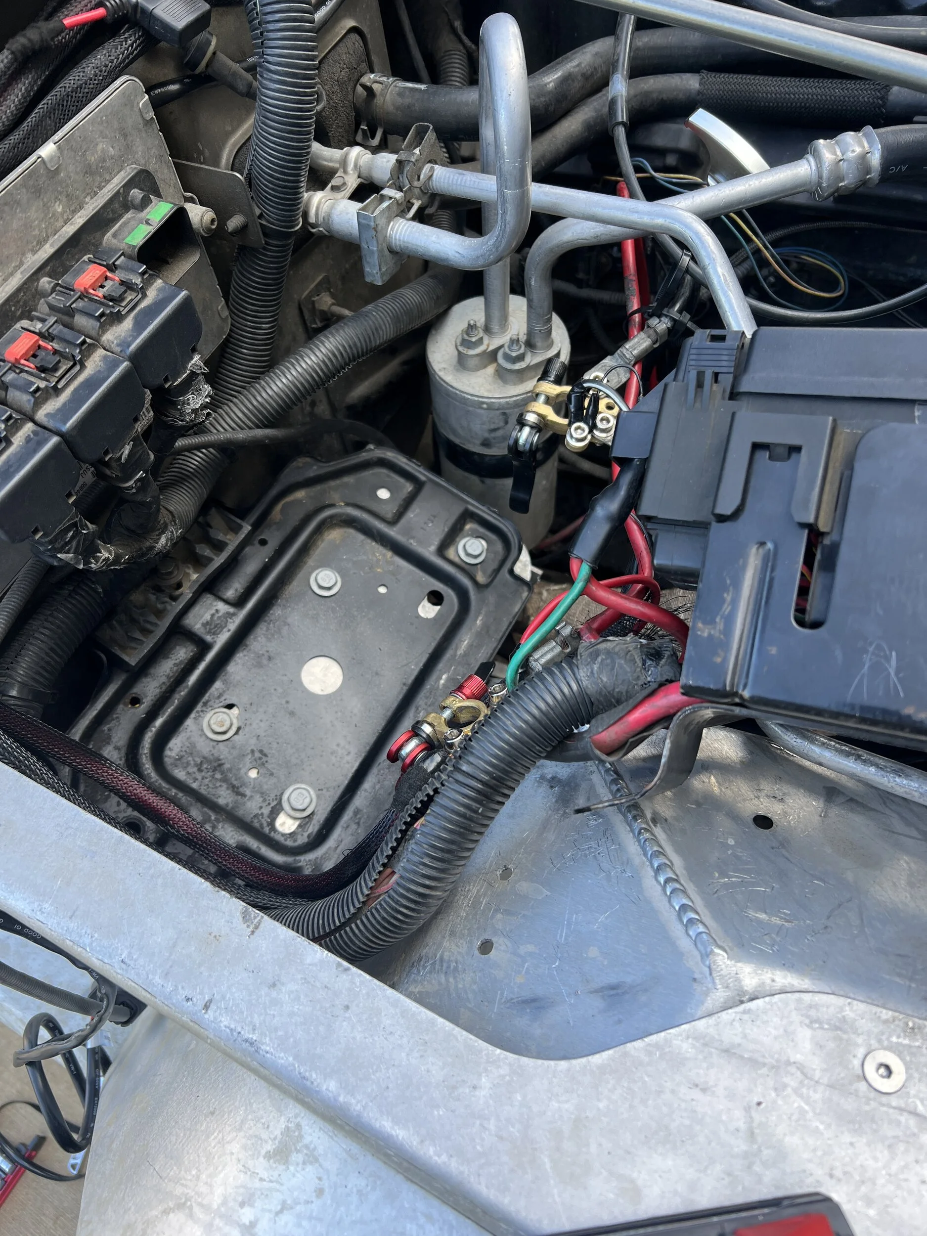

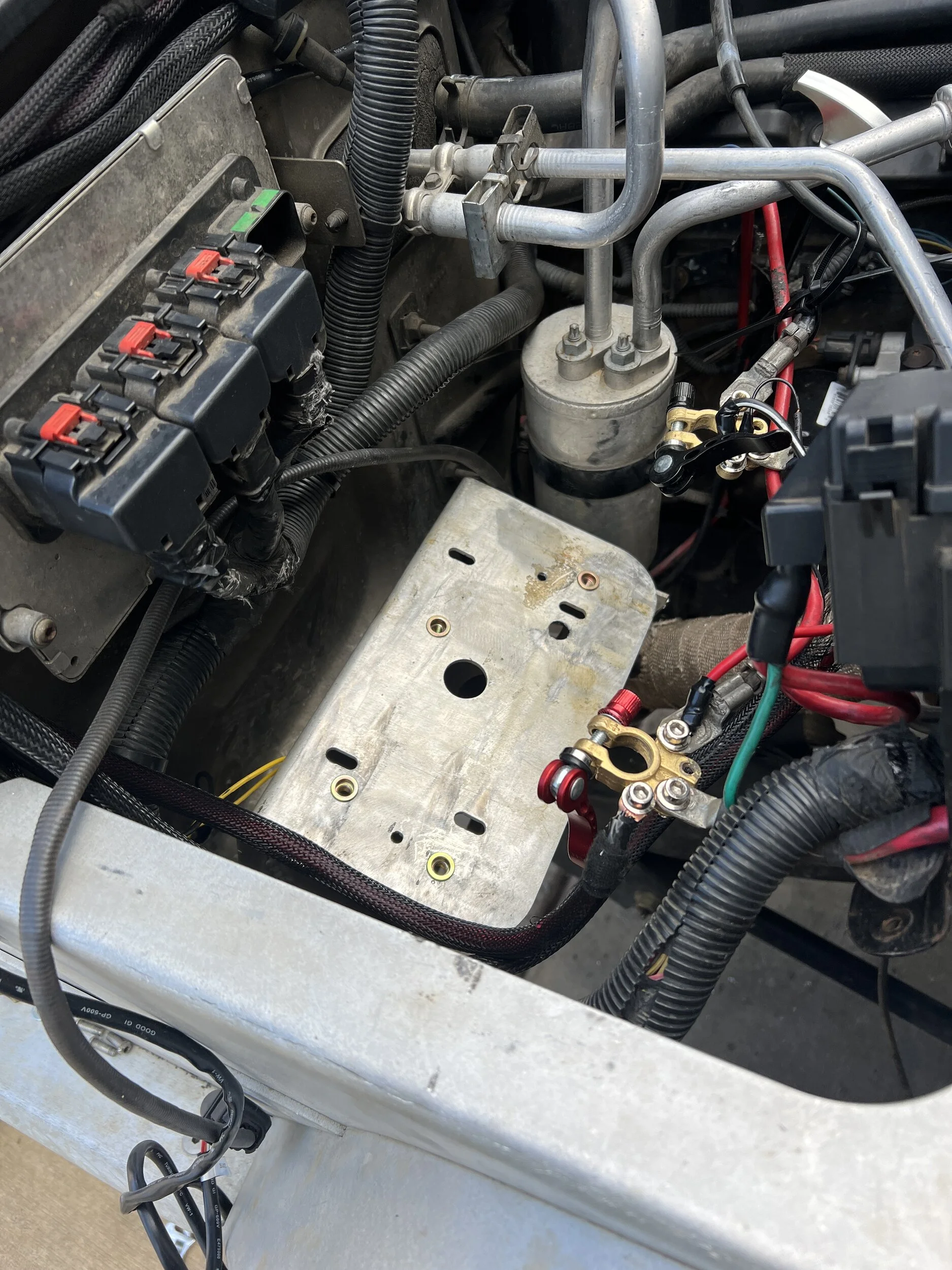

Got around to addressing a few small issues with the Nemesis Fenders.

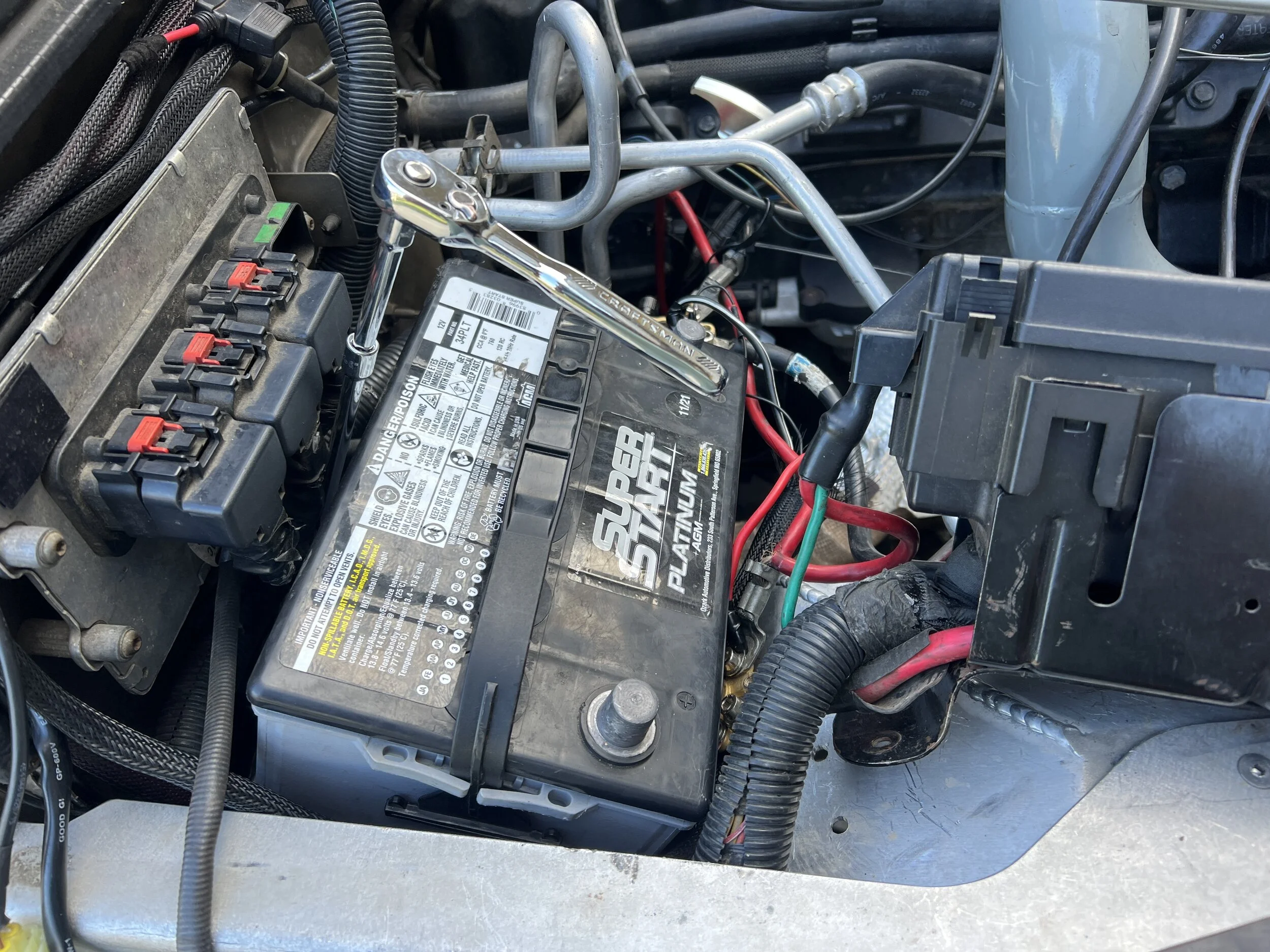

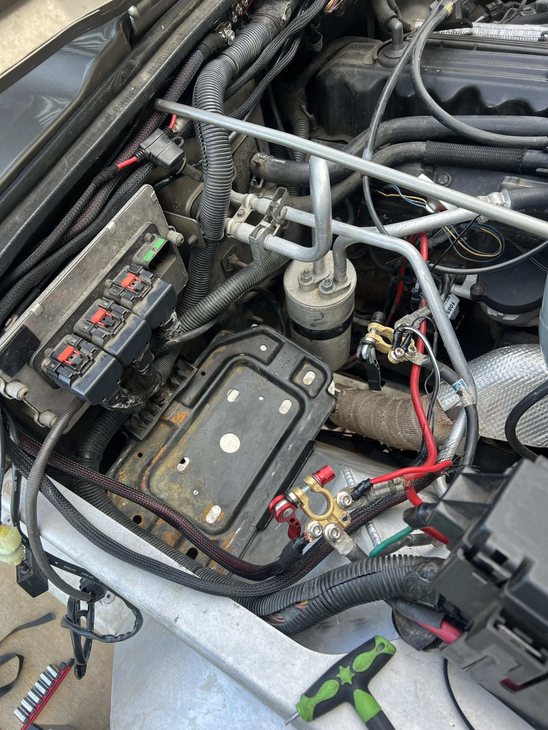

I purchased them knowing they only accept Optima Batteries although it’s been well documented their QC has gone down hill. In the meantime, I just ran a small strap to hold my SuperStart AGM battery in place though noted it would slide around a bit.

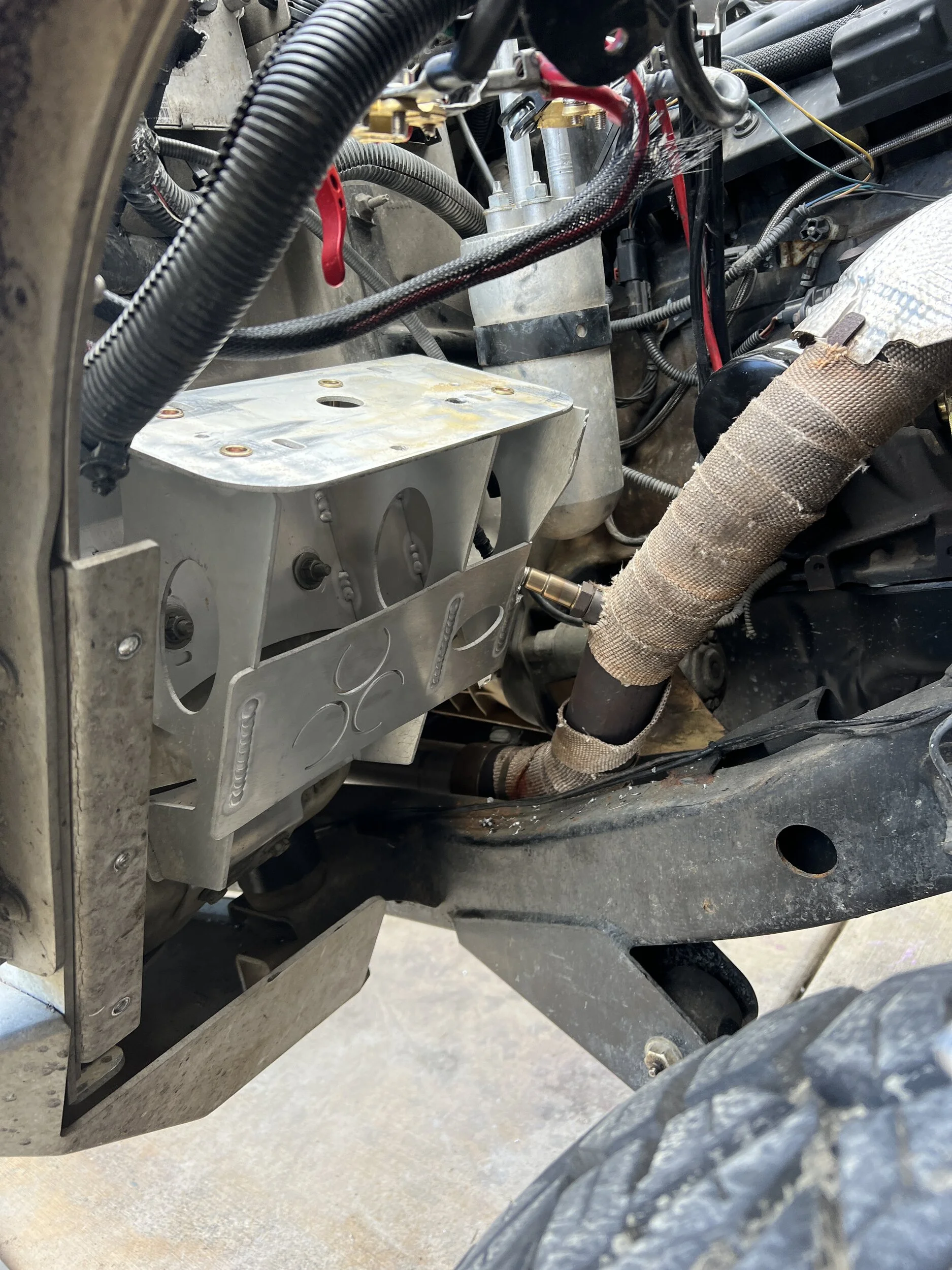

I realized while messing around with the Nemesis Bracket the stock battery plate/hold down from my original fenders would still work if flipped 180* from how it originally sat. I drilled a few holes to the Nemesis Bracket and with the addition of nutserts, some bolts I had lying around, and multiple mock ups, the battery plate was installed. I had trimmed one side of the battery plate previously attempting a different route that didn’t end up working. I’ll be keeping my eye out for a replacement and just switch them out.
The only “issue” I noted was to reach the bolt that holds the battery in place I would have to run an extension between/through the PCM Harness but given my limited options I accepted it.

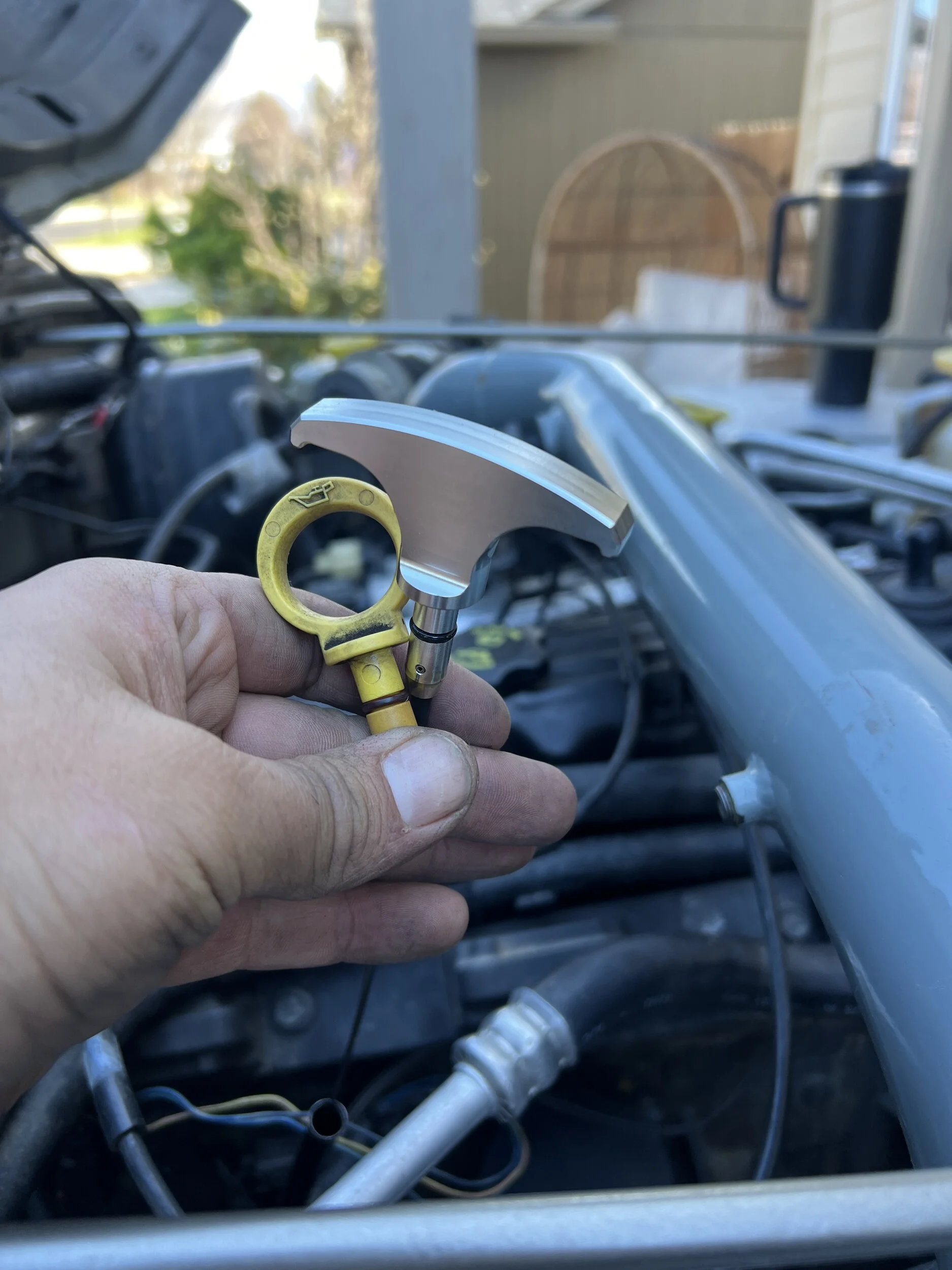

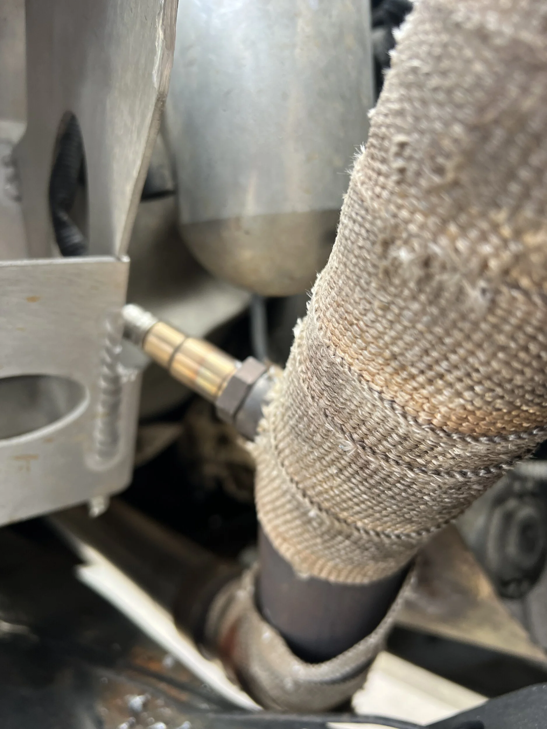

I also had to trim the Nemesis Bracket to fit the Air/Fuel Ratio Sensor for my turbo as the bung was already welded on when I had Poison Spyder Hi-Line Fenders on my TJ. I also switched the original dip stick for a silver one from DV8 to go along with the color scheme.
