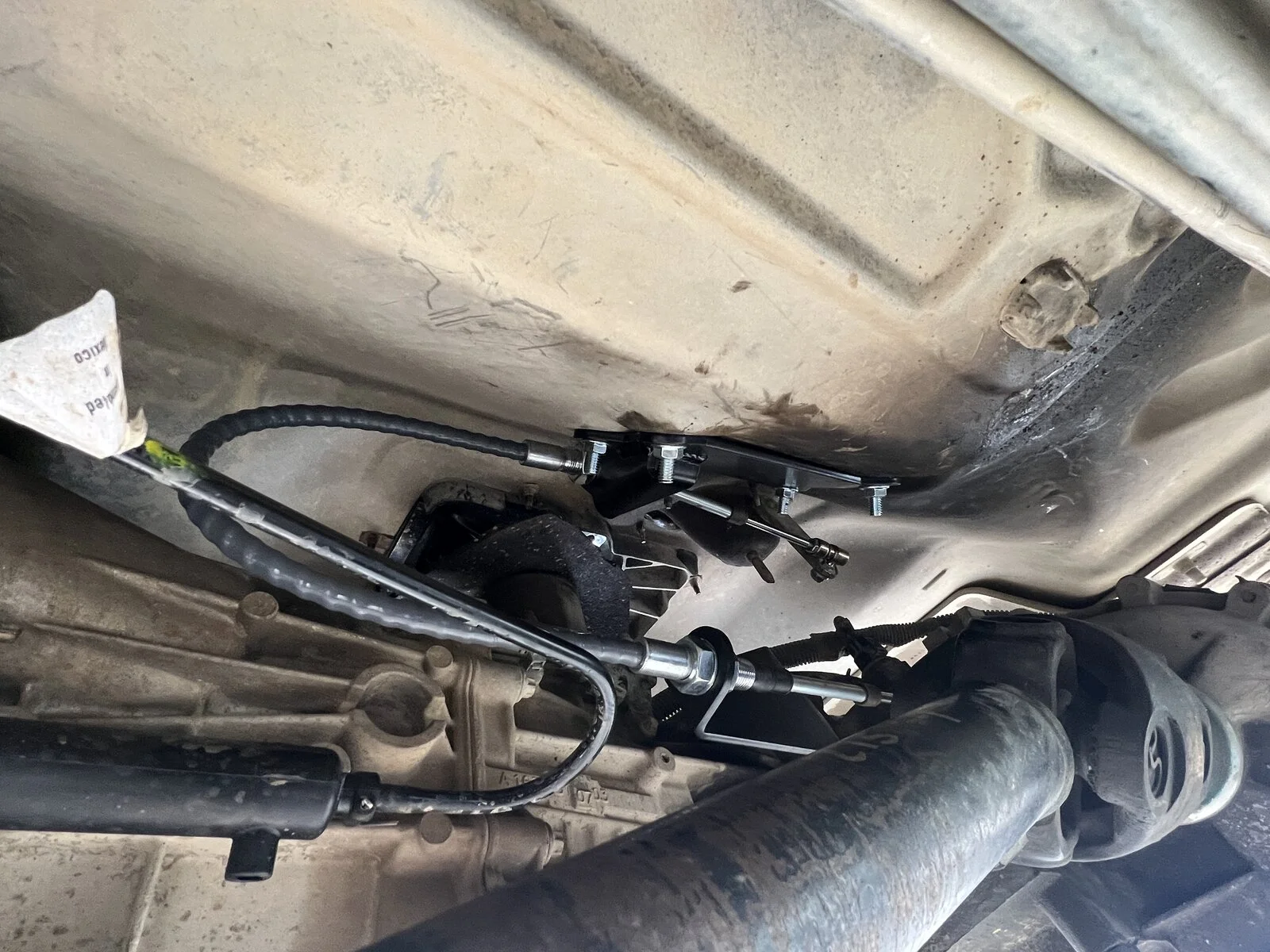

Ordered the Savvy Cable and it had arrived a little over a week ago.

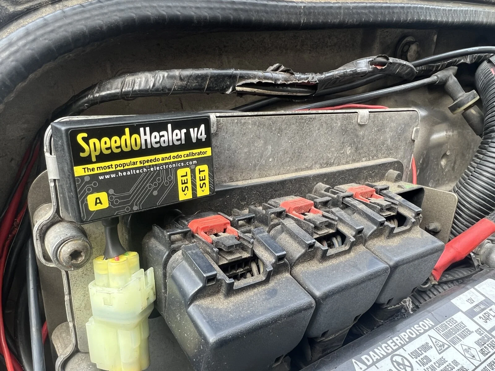

Finally got around to throwing it on, with the 4” lift and TT the shifter use to bind quite a bit and now shifts smoothly! I also had the time to throw on the Speedohealer to correct my speed with 35’s and 4.88 gears.

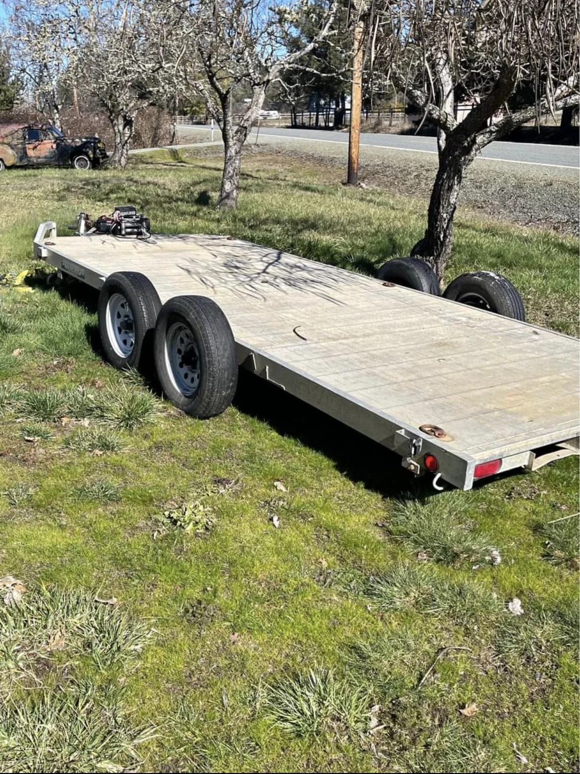

Slightly off topic, but my father and I have been looking off and on for at least a 7k trailer to haul rigs to flip and of course for my Jeep for future travels to Rubicon, Moab, etc.
Earlier today I found a 2006 18ft 7k Aluma Trailer w/ dual electric brakes that needs quite a bit of TLC. After going back and forth we agreed on $2,500.
I felt at that price it was pretty hard to pass up and thus finished picking it up an hour ago.
Very excited to restore this to haul my LJR with my Ram 1500! 🙂

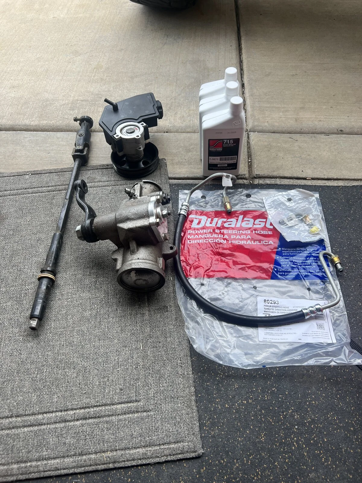

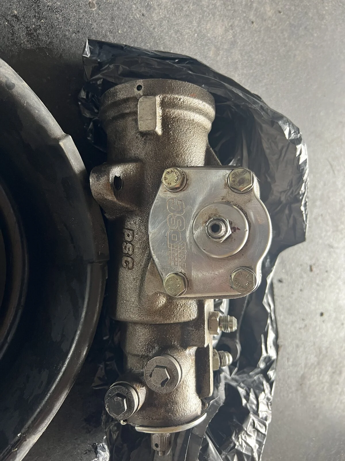

Recently came across a used PSC Big Bore Steering Box on Facebook Market Place in Las Vegas. Made an offer for $300 + flat rate shipping on my end and within the week received it!
It appears the condition to the steering box is good overall and found markings that make me believe it was made on April of 2019. I’m tempted to send it off to PSC and have it rebuilt but we’ll see!
Been wanting one of these for years back when I had my yellow TJ. Glad to finally have one on hand!

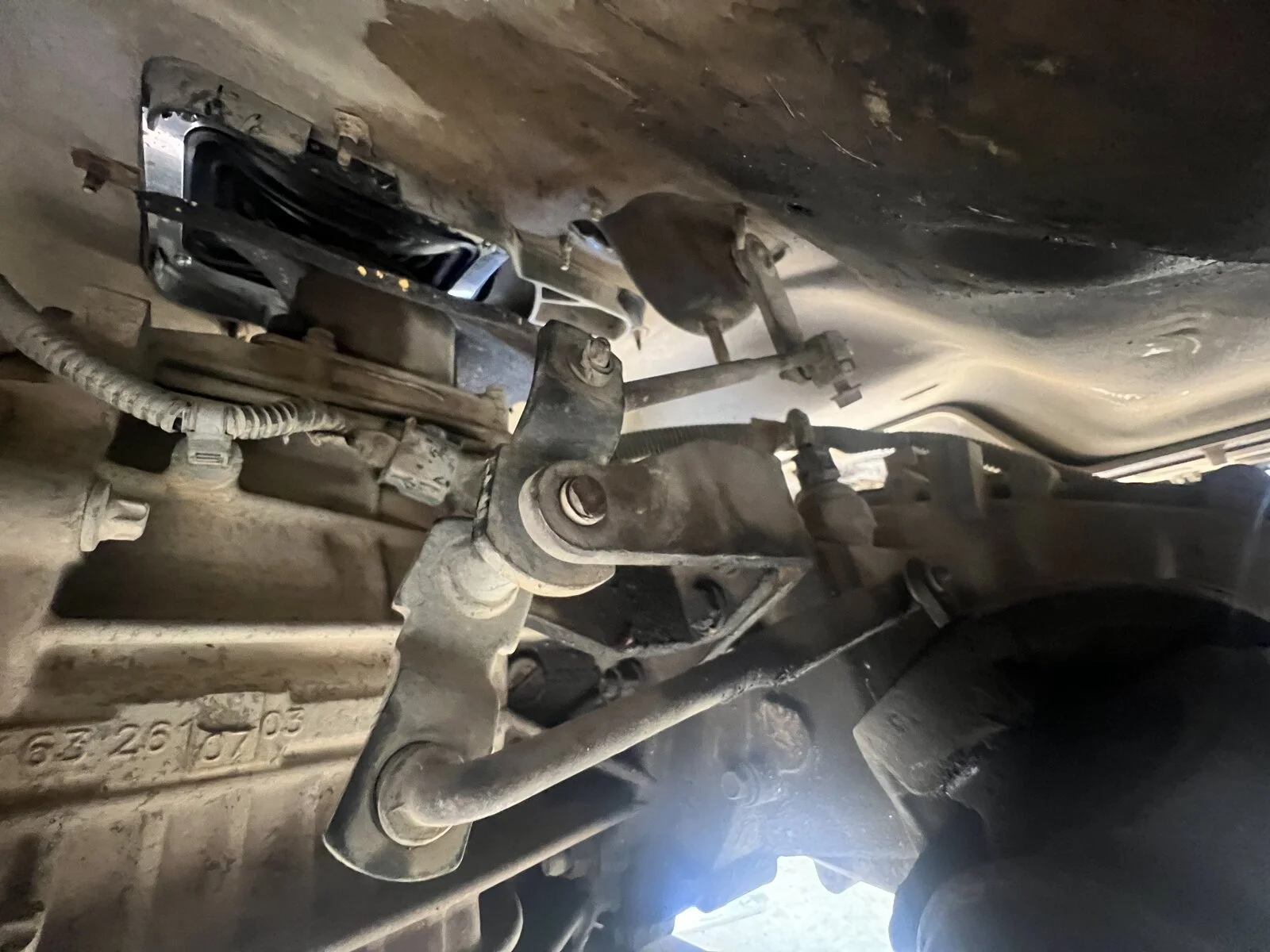

Found a used MOPAR Transmission Mount here on the forum and decided to switch out my polyurethane mount. Prior to, there weren’t any notable vibes on the rig though would prefer the opportunity to run all rubber on the rig.
While switching the mount I also ran to the hardware store for the proper length bolts and removed these odd spacers that were added onto the bracket that holds the transmission mount/exhaust hanger.

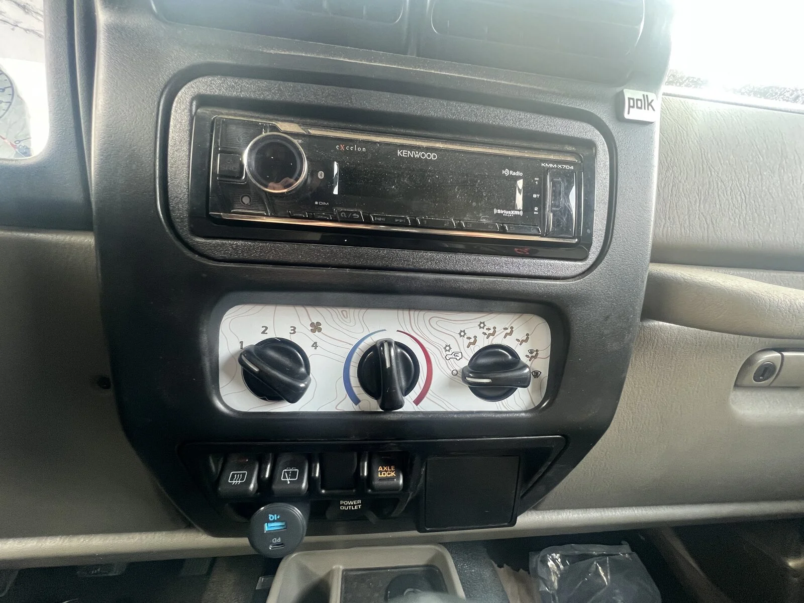

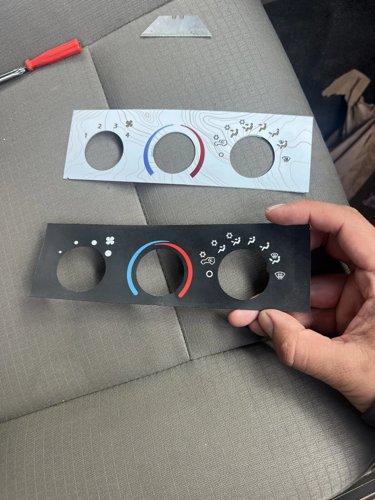

Decided to do something a little different with the Gauge Cluster on the Dash and HVAC controls. I placed an order through Azzys Design Works and at the same time Amber LED’s for the Gauge and Warm LED’s for the HVAC and Interior Lights from Super Bright LED’s.. Overall love the difference it made!

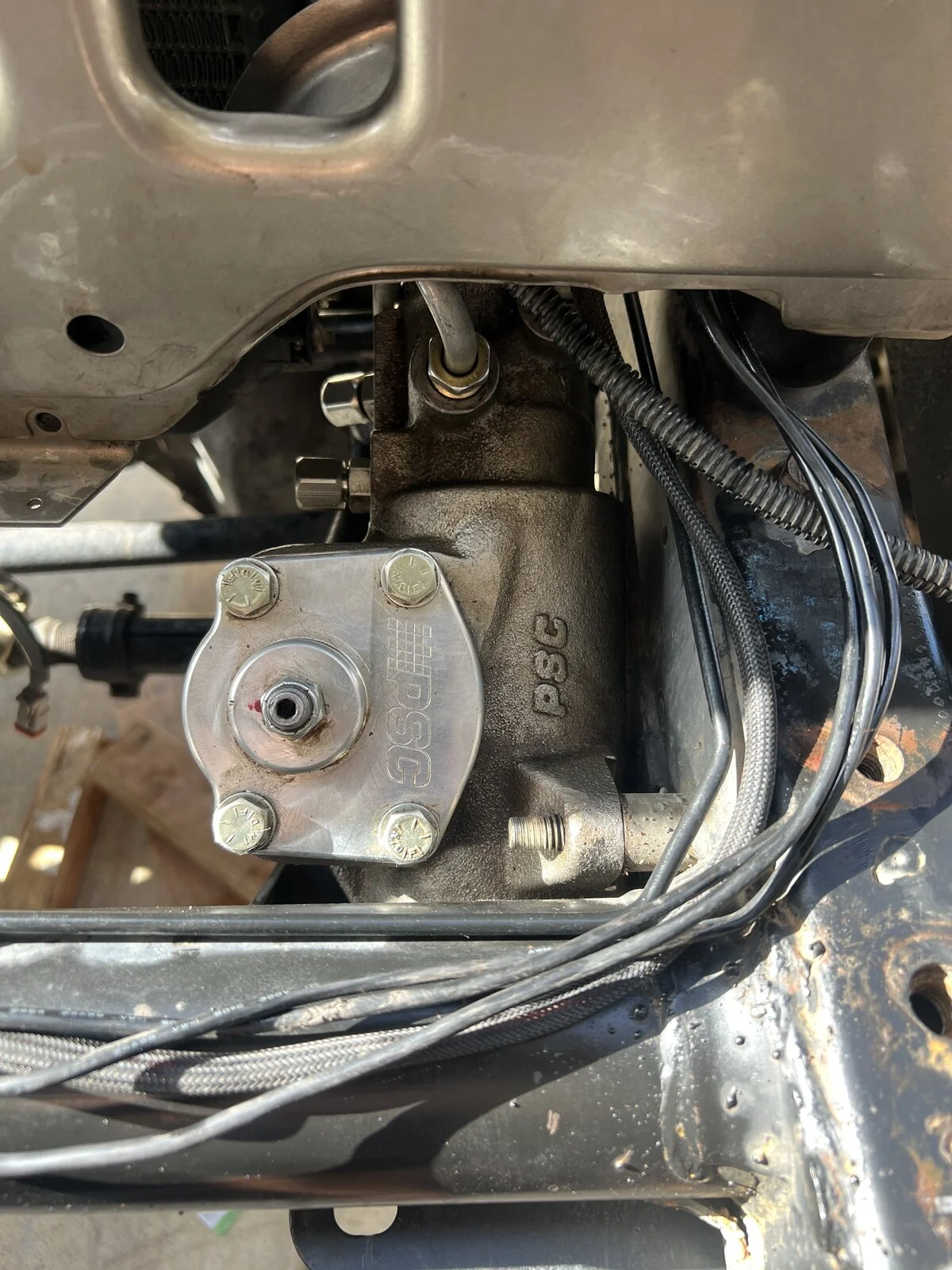

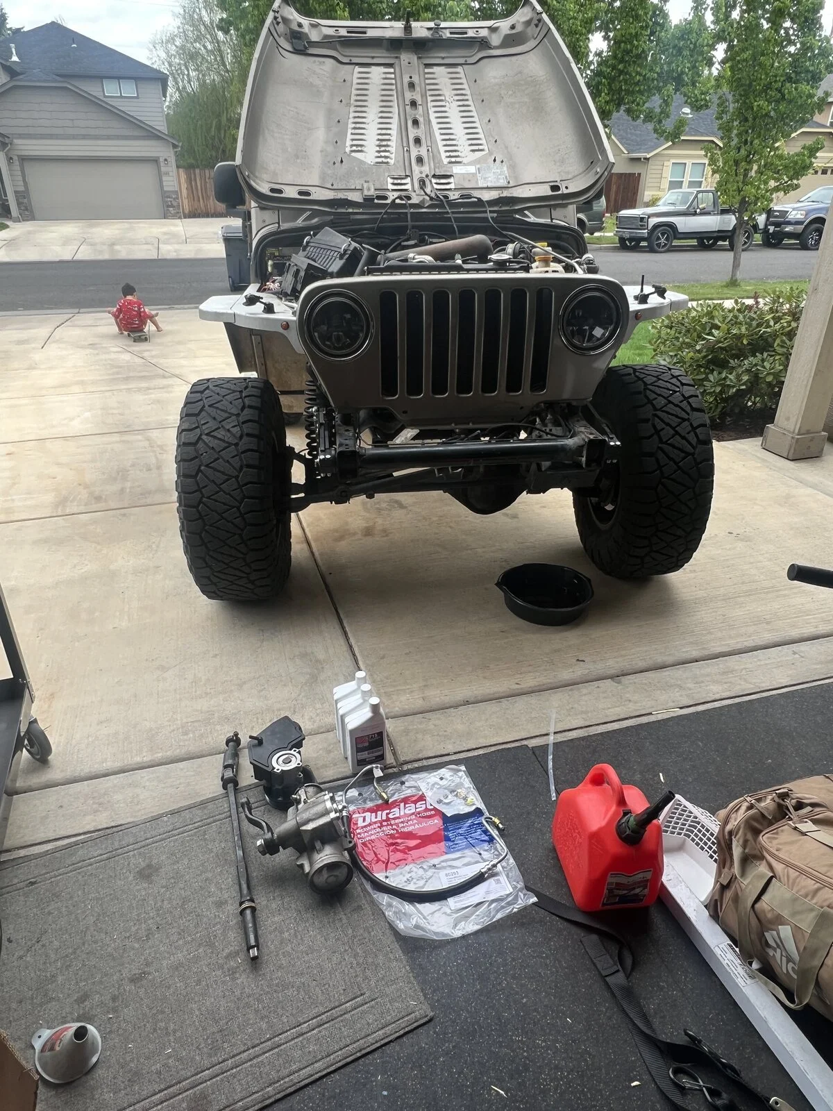

Sold my Poison Spyder Front Bumper a little while ago and while waiting for my replacement aluminum bumper by UCF to arrive I went ahead and installed the PSC Big Bore Steering box and PSC direct replacement steering pump.

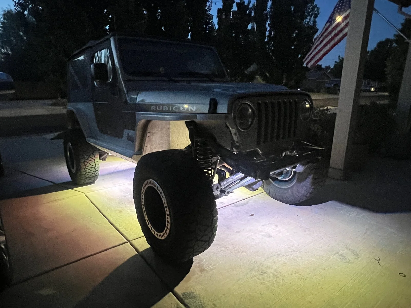

I also installed an old set of 6 Infinite Off-Road rock lights from my previous Jeep I had hidden away in the garage. They’re tied into Infinite-Offroads “SPOD”.

Might I ask why you upgraded to PSC parts? Were you having trouble turning on the trail?
I upgraded to get rid of the OEM Mercedes Box (once it fails it’s expensive to replace, unless you buy a used box).
The one from PSC is a Saginaw Box that’s overall beefier compared to OEM and retrofitted to work with the 03-06 Wrangler. It also has benefits of easily adding hydro assist down the road not to mention is rebuildable.
