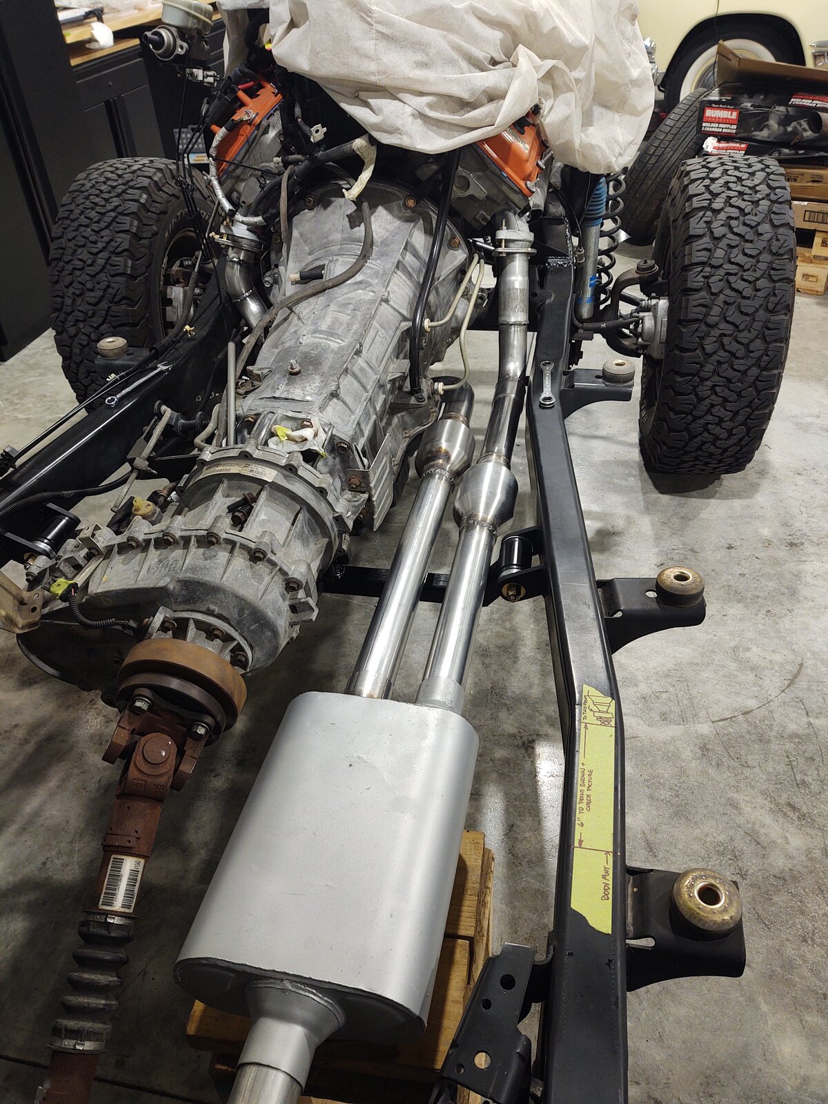

Anyone have any suggestions on a good high flow cat?

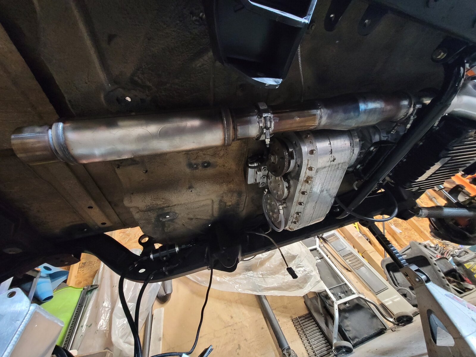

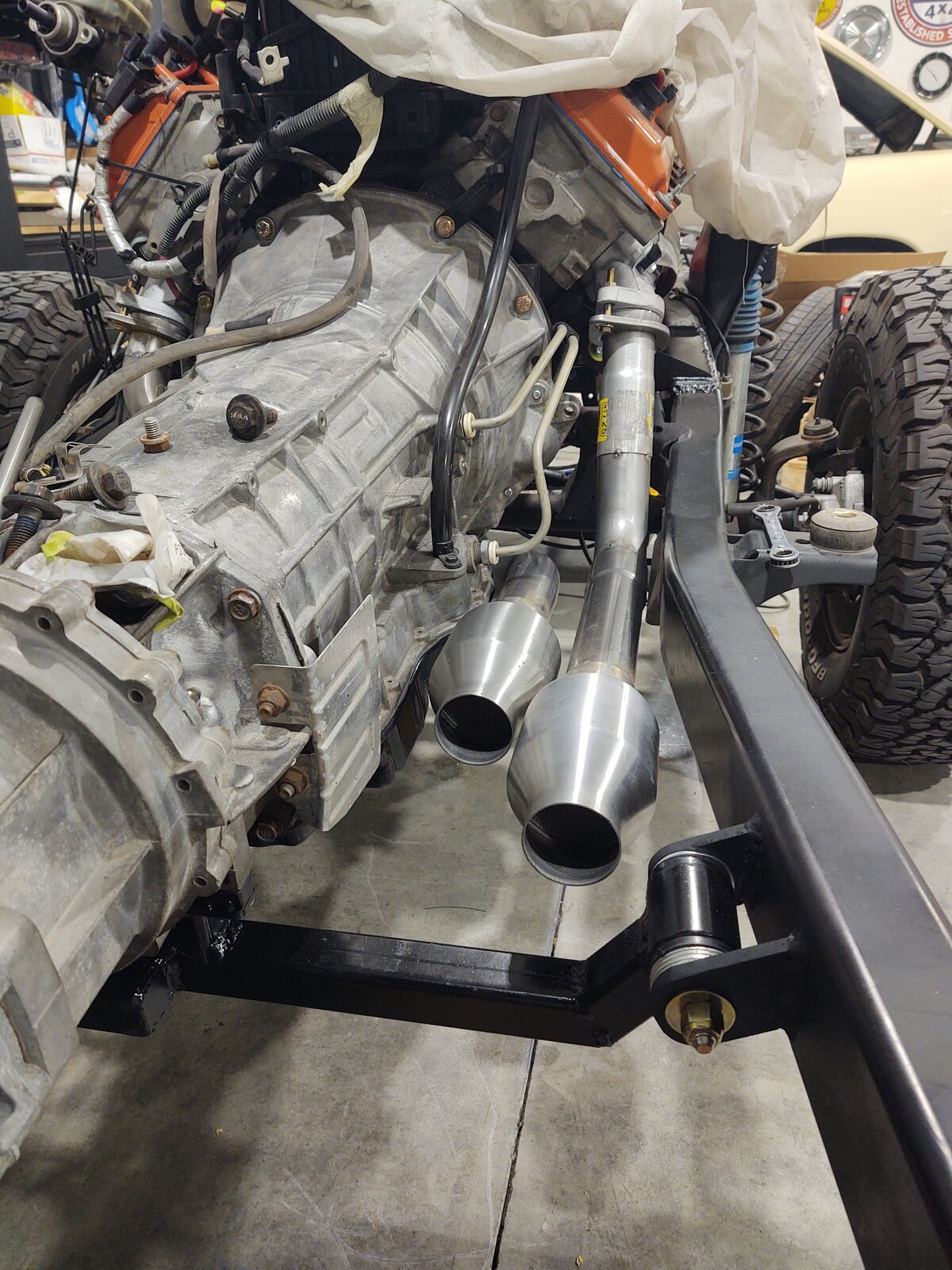

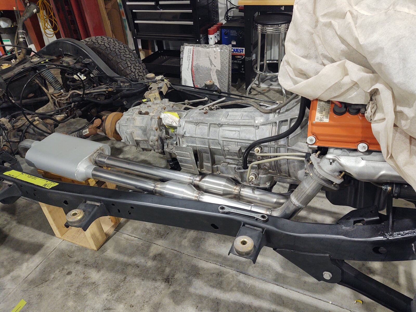

Yep, I used 2 of those in the 100 GPI index and they are almost empty inside. I would guess no restrictions at all.
Reactions: Daubie3
Same type I used on my exhaust. I'm running 3" diameter exhaust. I'm amazed you fit two of them on yours.
Sometimes I amaze myself, but very rarely do I amaze my wife.
I wasn't sure if I was going to be able to get both of them to fit but they just barely did. They are two and a half inch pipe size and 4-in diameter overall size, and I think about 9 in Long.

Also make sure to check the Grid Per Inch rating on them. The lower the number, the less restrictive they are. I think factory cats are 400 and high flow are 100-200. The ones I used are 100 GPI.
I think I have the 200 GPI on mine.
Reactions: Daubie3
The main goal is to eliminate smelling the fumes but it’s also the first attempt at quietening it down a little. It’s just a little too loud in the cab. Some have said a high flow won’t help with sound and some have said it will. Won’t know till it’s on. But again, sound isn’t the main goal.
Yeah, I really don't think the high flow cat will do anything for the sound, but definitely will clean up the exhaust.
