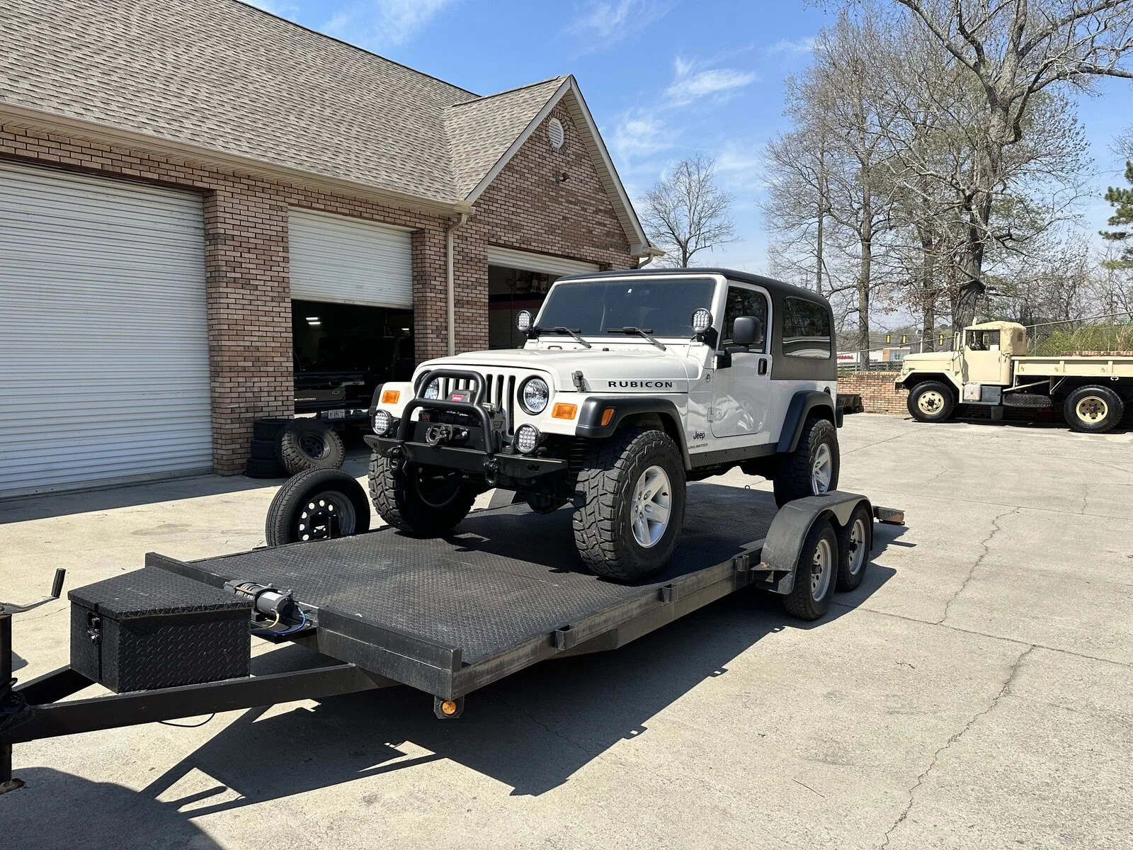

Picking it up tomorrow. Tom’s is completely done with the swap and the only thing left is some dyno tuning. They’ve got a few other projects that won’t allow them to get the Jeep down to Injected within the next few weeks so to help them out I’m going to just take it down myself. It’ll be loaded up and ready to go the first of next week. Hopefully Monday or Tuesday we’ll get the call and head down. In the mean time I’ll get some better pictures of all the work and wash it for the first time in about 5 months.

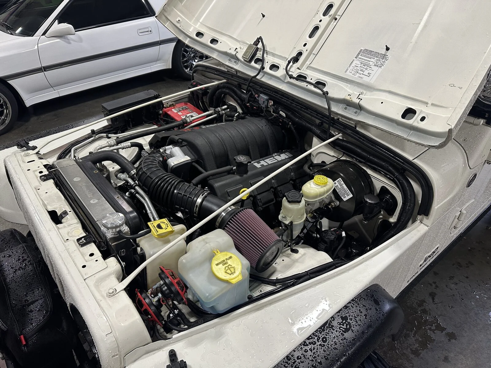

Had to move a harness plug at the back of the motor. It was making contact with the back of the intake and started to take the powder coat off. Let it run for a little bit to get everything up to operating temps and make sure it’s still good for Wednesday. Came back out after about 5 minutes noticing the body shaking from the cam! Hahaha! I didn’t expect it to shake like that but thought it was hilarious. Doubt it’s idle will change after it’s been tuned but heres a quick video of it running, the completely finished engine bay and how well everything tucked away underneath.
