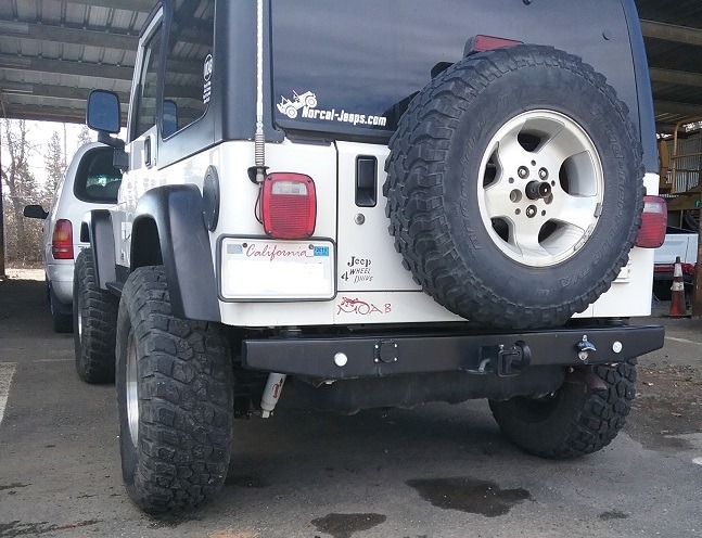

Another choice to add to your list,
https://www.olympic4x4products.com/TJ-Mountain-Climber-Bumper.htmlIt advertises a 2500lb. tow rating. I've since modified a few things on mine.
The ARB bumper that @lowranger has is very stout and hides the butt crack.
Olympic actually discontinued their whole product line until Christmas so they wouldn’t ship if you bought it, there’s a note at the top of their website. I was lucky and got one off 4WP on sale for around $150.
Reactions: Midnight LJR
