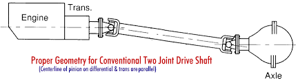

By raising the motor or lowering the TC that would change the angle of the output shaft on the TC. If you have a cv driveshaft that might be ok but with stock u-joints don't the angles of the TC output shaft and pinion have to be the same? And how would lowering the TC affect the front driveline angles, by reducing the angle of the driveshaft would you also have to reduce the front pinion angle to match? And that would change the caster as well.
Front ds has cv joint
Sent from my SM-G935V using Tapatalk
It is an attempt to bring the ujoints to the same angles. A dc shaft does not need that and should be adjusted with the control arms. The front shaft isn't affected all that much due to it having a dc joint.
My lj has about a 2' rear driveshaft. A 1" drop is about a 2.4 degree change. The front is about 3' which is about 1.6 degrees. I've been reading a lot about caster and front pinion angle lately as I'm installing an OME lift on it now. As for the dc joint the pinion angle still has to match the driveshaft angle, doesn't it?

That opens up the adjust for pinion angle or caster debate. I've read good arguments for both. Guess I'll have to set my pinion angle to the driveshaft and cut the axle tubes, rotate the steering knuckles for caster and re-weld the tubes... it's so simple I don't know why I didn't think of it before. LOL. I'm just not a fan of trial and error but I'm probably going to have to get over that.
Before you start cutting axle tubes, re-welding brackets, and adjusting front pinion angles, how much lift are we talking about...?
I have a TJR with an OME lift, and absolutely no driveshaft/pinion angle adjustments or changes were necessary, front or rear. I really can't see an LJ needing any, either, unless you are dead set on keeping the exact same pinion angles, just for exact sameness' sake, which seems pointless if not needed. It's your Jeep.
The pinion angle / caster 'debate' really only comes into play around the 4" and beyond amount of lift threshold IIRC.
Sorry the cutting and welding was meant as a joke. Would probably try adjustable ball joints first(another joke).Only installing a 2.5 inch ome lift. Had to replace some of the control arms so I decided to just replace them all at once. Ended up getting the Rancho adjustable ones, they were a good price at RockAuto and Rancho is running rebates right now. Set them all pretty much right at the stock length just added less than a quarter inch to a couple of them after reading some other posts in the Forum. When everything's mounted and on the ground I'll go for a ride and take some measurements and adjust if necessary.
