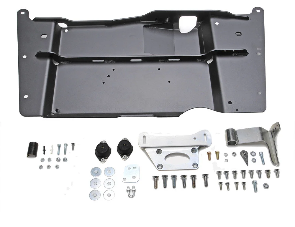

The Nth mount uses 2 bushings to isolate, so maybe it'll be better? The bushings still look small compared to the amount of rubber used in a stock mount to isolate vibes.
Yep, my fear, but it'll be interesting to get the reports. I wonder if we called Nth if they would describe the difference in vibrations from stock TMount? We could even couch it in the context that the UCF LoPro is known to have vibes. Then they might be prompted to describe a comparison on that front too. Of course, I'm going for a full tuck later, so the info is not too valuable to me except to help others...
Does a link exist to look at said Nth mount? I've seen it mentioned in the TT description, but not seen an actual photo of what we're talking about as far as the TMount in question.
You can see it in parts here, along with the two rubber bushings. It reminds me of the AEV transmission mount.
