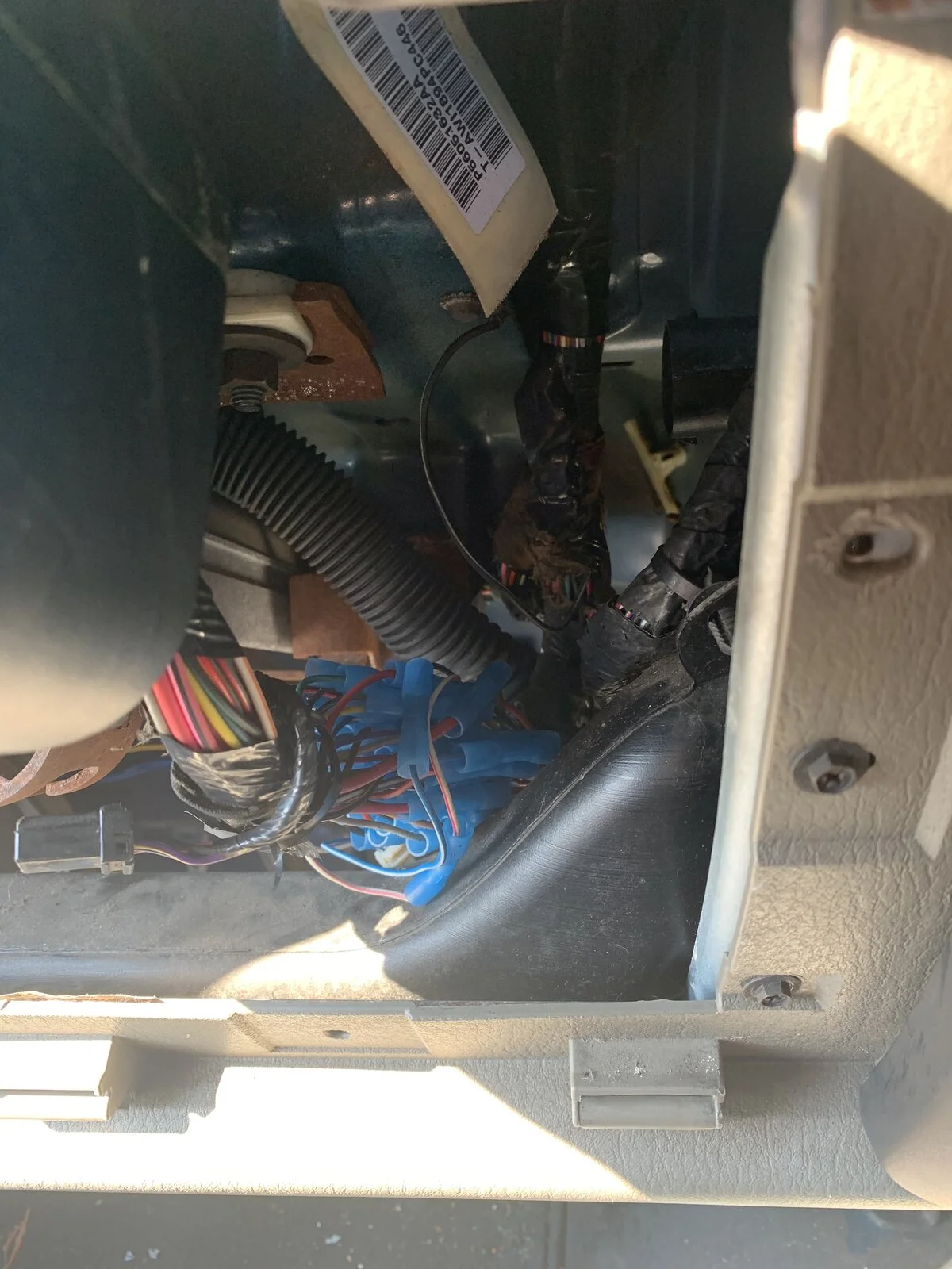

So… I recently obtained my 2004 Wrangler X, 4.0. It spent a considerable amount of time open to the Florida elements, judging by the condition of the interior. I’ve also had some intermittent blinker issues, an air bag light that comes on and off for a few days at a time and the horn doesn’t work. This led me to open the dash compartment under the steering wheel…the photo shows what I found.
My first question is WHY?? What would be the reason to even do this? That mess is a ton of shabby connections, some of which are clearly not connected. Is it worth the trouble of taking all that rats nest apart and re-splicing them all? This is not an easy place to work! Is there even a diagram that lists what these individual wires go to?
Next question: Have any of you fine folks replaced an entire dash harness? If so, what kind of time commitment can I expect? How do I know which harness to get? I’ve found a few online in various conditions for around 150-200 bucks, all used of course. Is there any way of confirming that I’m getting the correct harness? I’m concerned about spending that kind of money to rip the dash apart and find I have the wrong harness.
Holy cow. If it were me personally I would remove that harness from the dash so you can work on it in a nice and open area, and splice it all back together one by one with butt splices and add heat shrink. Then wrap all the wires into a taped bundle.
What a mess. Gotta love POs.
Could maybe just find a harness from eBay as an alternative. Probably would want to confirm year range and features supported, if those vary. Lots of the times the eBay sellers like dead Jeep and such are pretty good about labeling what year their harnesses fit.
Good lord... get that cluster fuck out of there. Whoever did that shit is a half ass :LOL:
