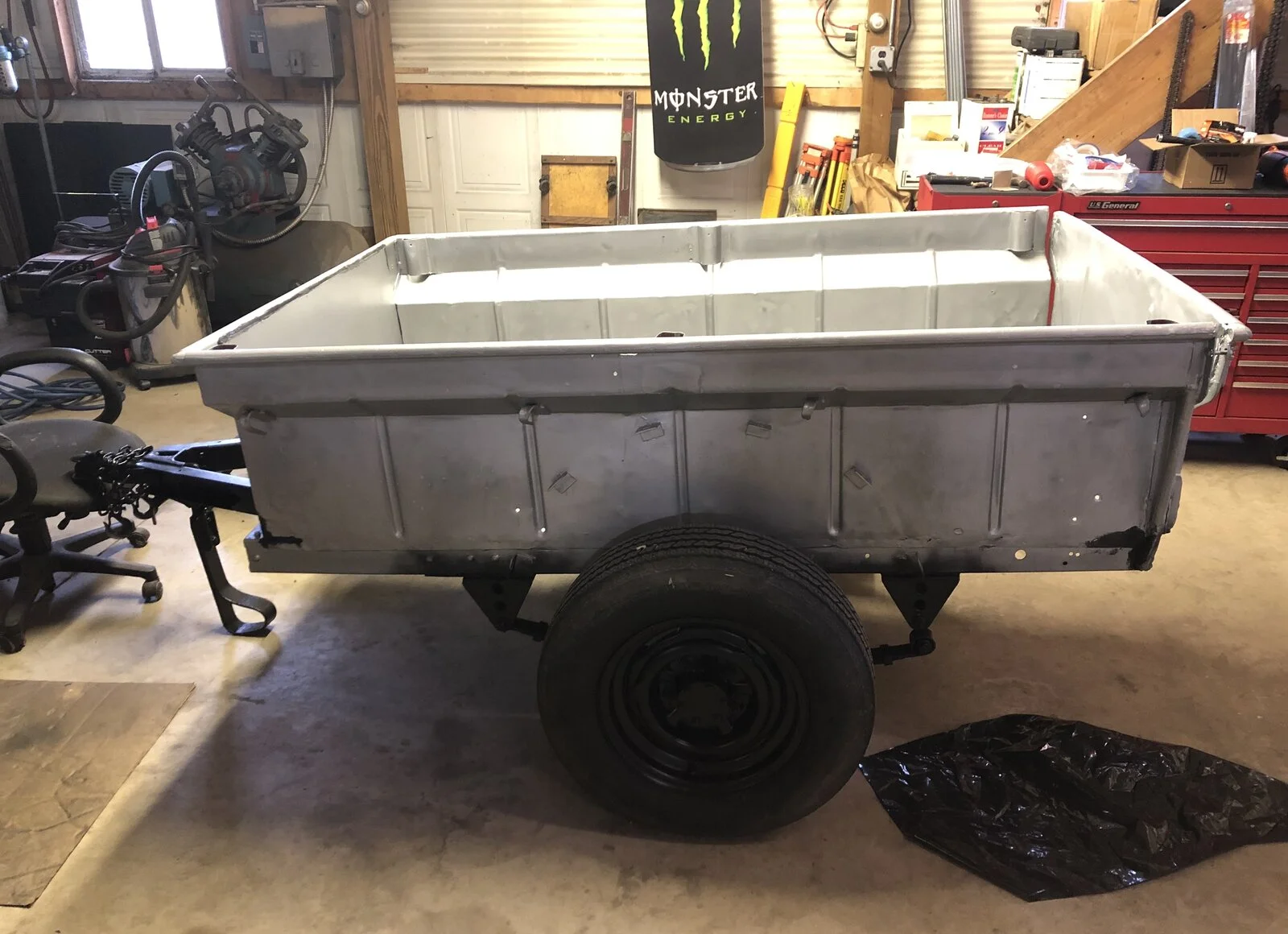

I am wrapping up my bantam trailer project and need to decide on a finish. Currently the entire trailer is coated in chassis saver and the frame/chassis is painted in rustoleum semi-gloss black. Originally I intended to roll finish the entire trailer in Mostaliner roll on bed liner and even went so far as to order the kit but now I’m having second thoughts. The trailer is mechanically sound but is definitely a 10 from 10 so I’m after utility over show and will be used accordingly. Mostaliner seems like it will take a beating but rustoleum is way easier to touch up and might be easier to keep clean. Thoughts?

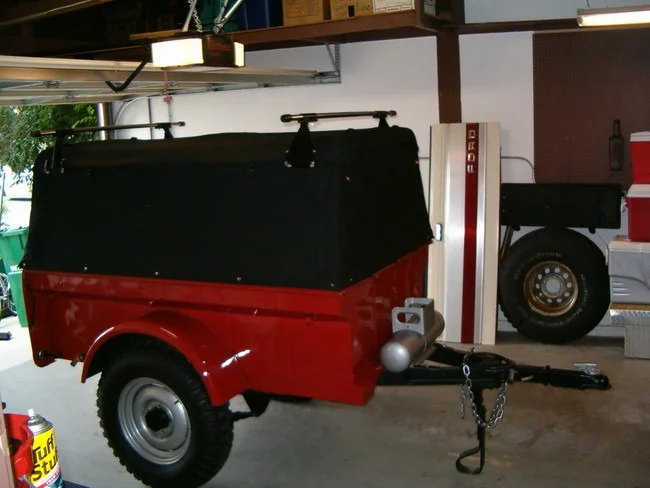

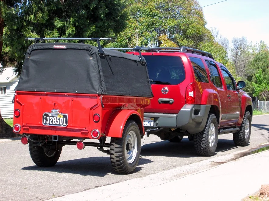

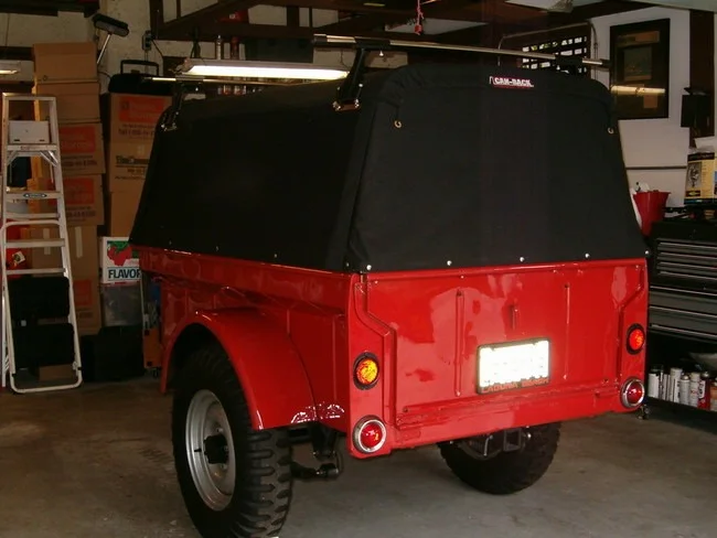

As the owner of the restored 1946 Bantam T3-C (#9466) pictured below, my opinion is to avoid any kind of bedliner on the outside of your tub. My recommendation would be a good single stage paint instead.
Hey I’ve read your entire build thread on that trailer! I actually have been talking to some local Amish about building a cover similar to yours. May trailer is #143 and was super rough when I got it. The floor was pretty much gone and when I plasma cut the rest out it kept catching on fire from all the bondo in it. It definitely isn’t “restored” but will have a better life than when I found it.

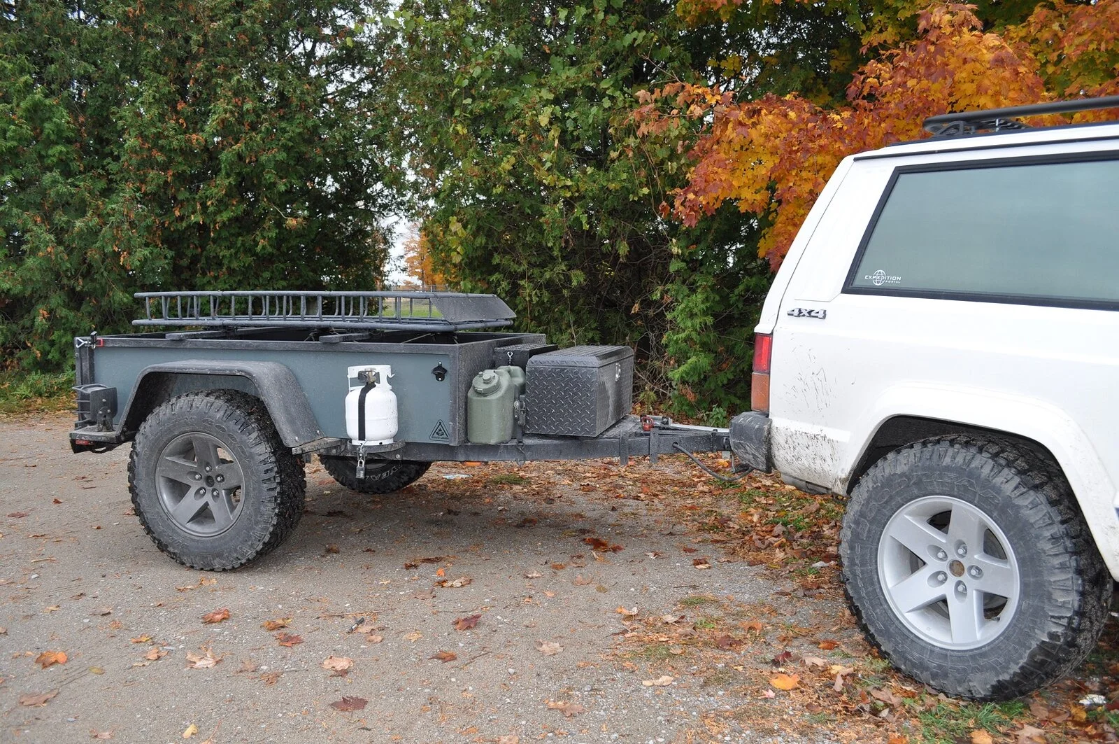

I agree with this. I used Tremclad single stage enamel (same as Rustoleum) on my off road trailer. I sprayed it with a basic HVLP gun. I expect the bed to get the most abuse and I'll most likely touch it up with a roller brush. I don't plan to bed line it though.
I used a hardener with the enamel to promote faster dry time and improve the gloss. I'm not sure it did either ... and it's usually a bit muddy anyway.
