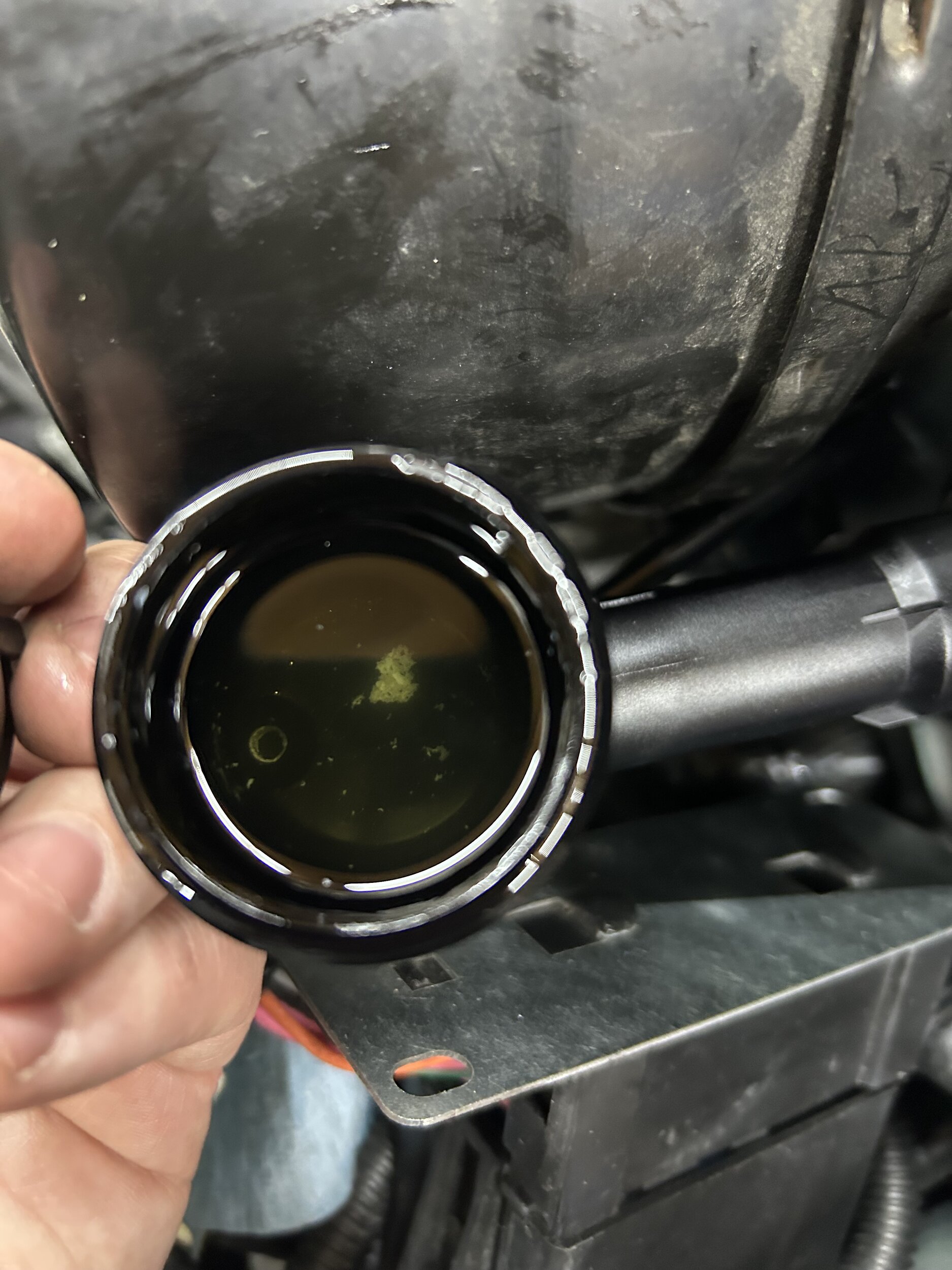

I tried bleeding the new hydraulics, but no luck. I did however see some white stuff in the reservoir and near the hole so maybe? Pressing the clutch it feels normal though like it has full pressure.

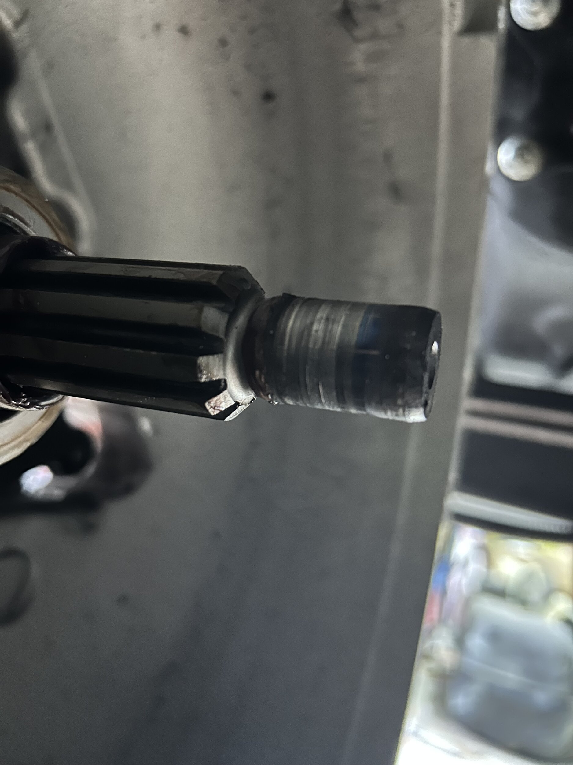

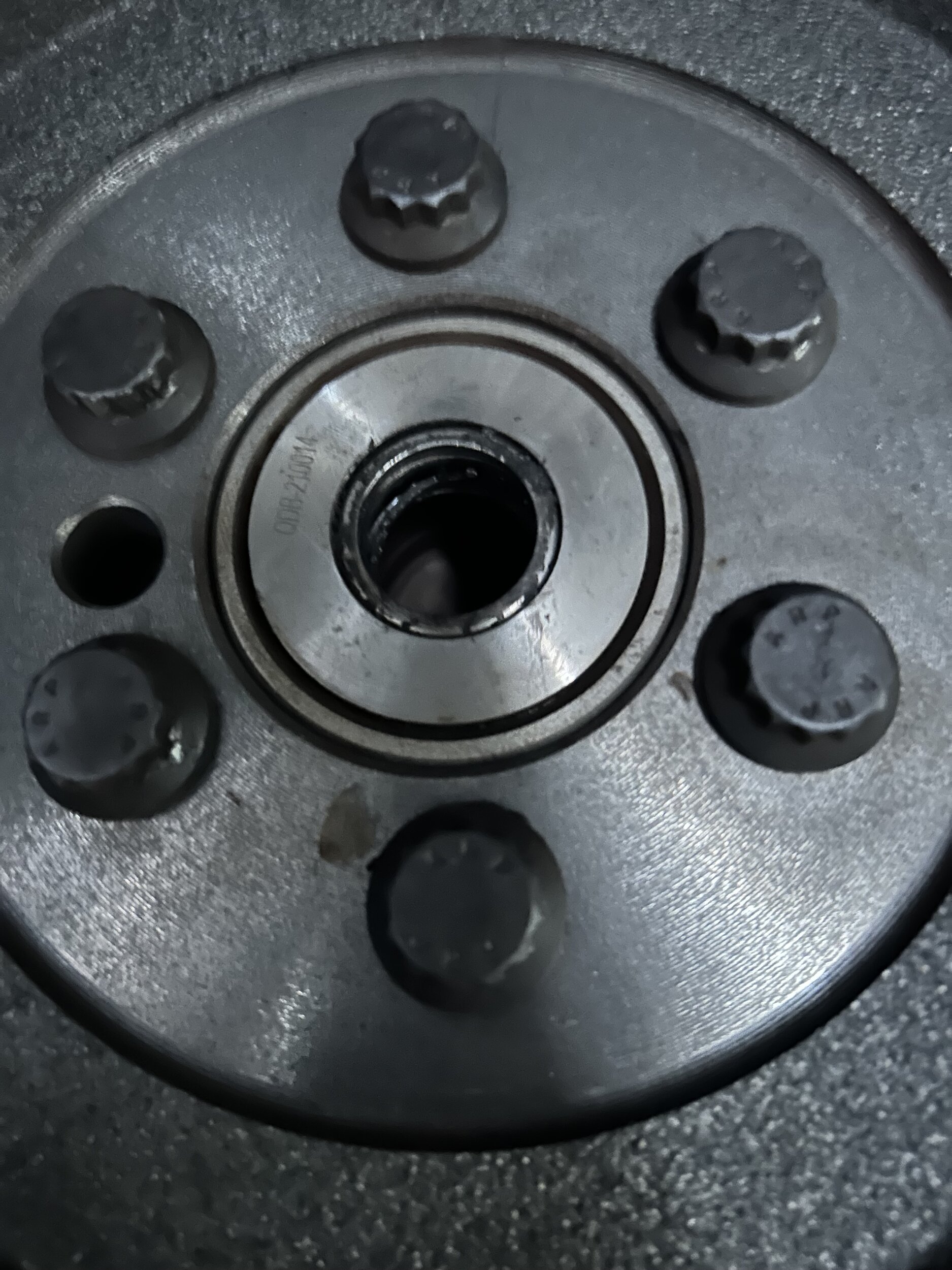

Pilot bearing got exploded. Was not a good sign when a little needle roller dropped out of the initial gap made separating trans from engine. So now the question is why did a sub 3000 mile bearing fail? My guess is when I dropped the trans around Christmas time, I reinstalled it wrong or am I supposed to grease it or not grease it? Trans input shaft looks a little rough?
  • Sad
Reactions: Apparition
Yes you were supposed to pack grease into the new pilot bearing with your finger, that's why it failed so soon.
Well crap, I guess chock this one up to learning not to trust the bearing was greased enough when new.
Also need to find an input shaft too apparently. Annoying I have to replace that on a new AX15.
Reactions: Jerry Bransford
On the flip side I've seen folks put too much grease in the pilot bearing hole and struggled to get the shaft in because it was essentially hydro locking.
