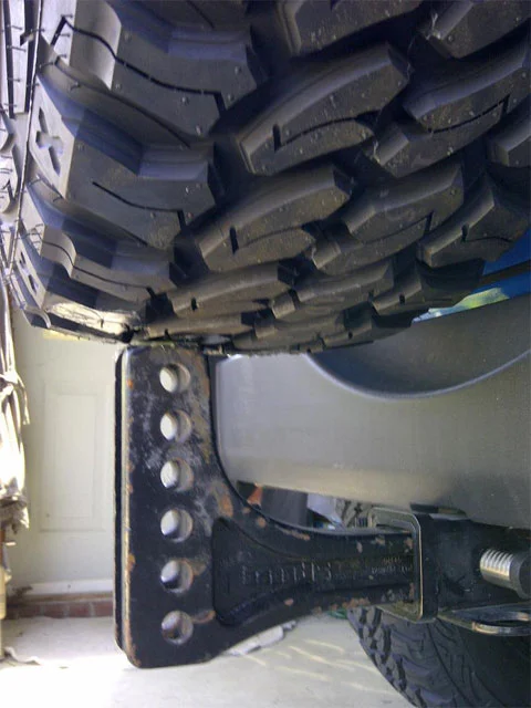

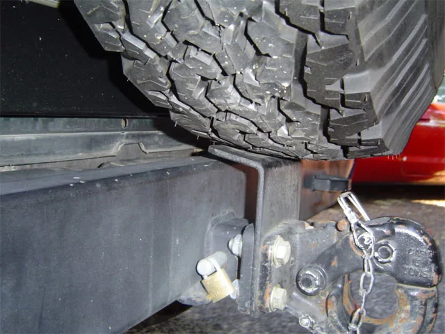

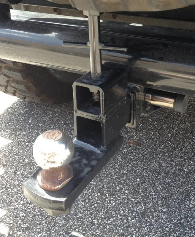

Do you have corner armor? You can use the hinges and roll bar bracket minus the outer plate, so long as the armor is same thickness, or hinges are shimmed so corner armor matches the tail gate plate.
No, just lift up on the spare a little when opening or closing it.Thanks @Jerry Bransford and @Serbonze, that makes a lot more sense. I can see how that would support the weight of the spare tire considerably.
One question though, does that piece have to be removed anytime you open or close the tailgate?
