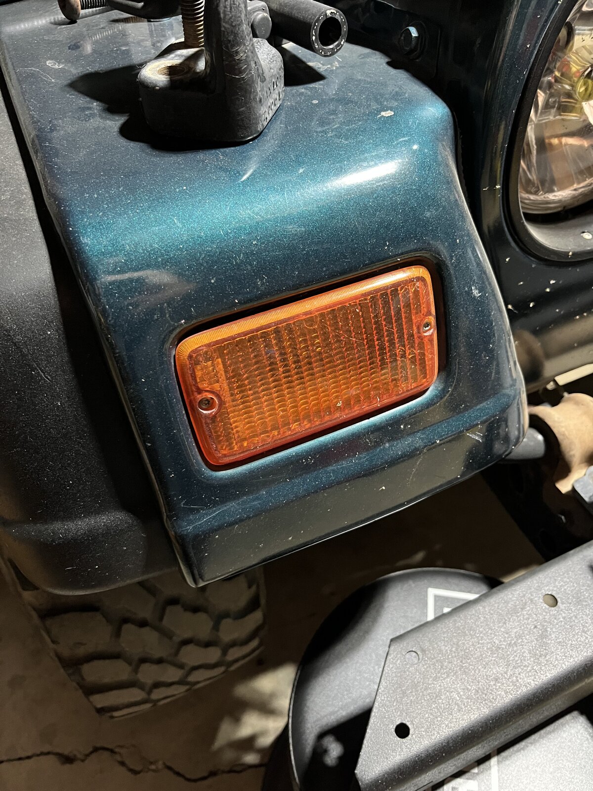

Check your front turn signal bulbs … my 98 did something very similar to that a couple years ago . I was getting the chimes like the key was in the ignition or the lights were left on and the dim lit turn indicator. I turned on the turn signal 1 at a time and the front left facing signal/marker was not working . Replaced the bulb, still not working . Ended up ordering a new socket for it from rock auto and it fixed it. Good luck!👍🏻

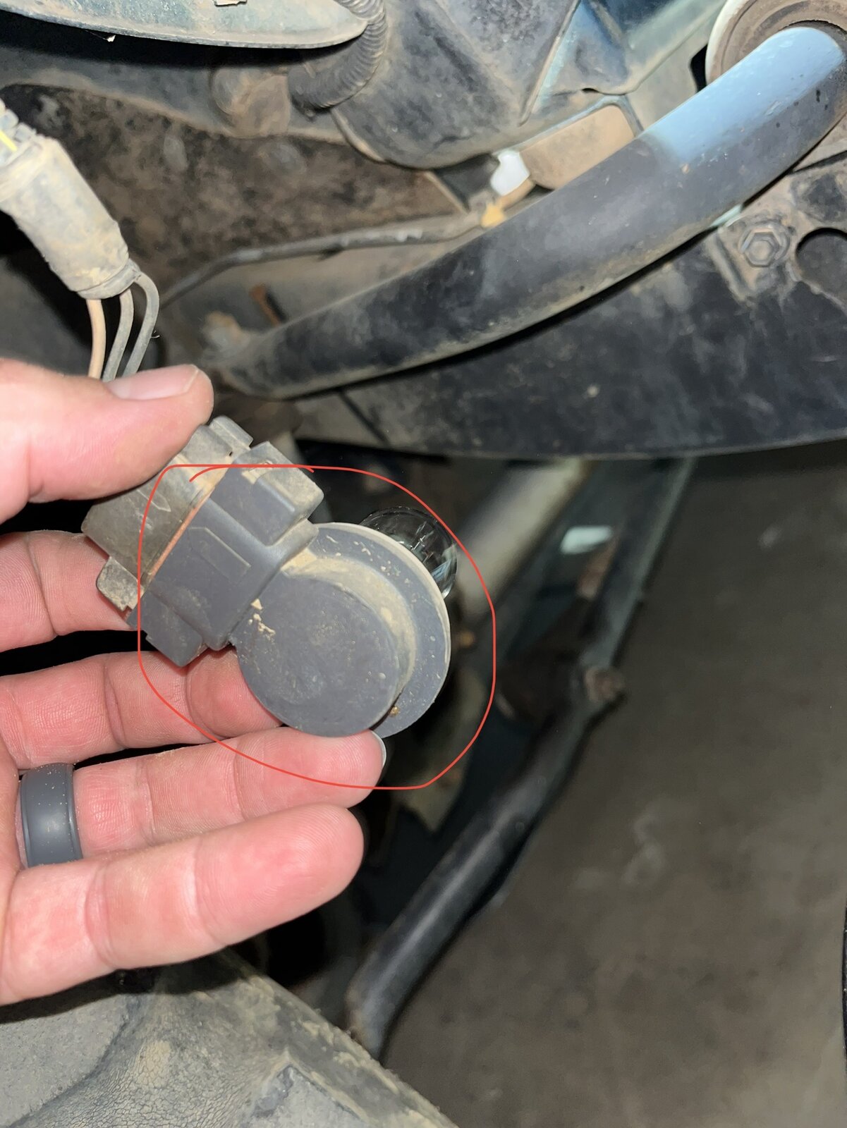

Here I took some pictures … circled in red is the part of the socket that is replaceable and where my problem was.
Old Post - But I Hope it works! I for some reason NEVER thought of the socket. The Park lights work but the turn signal doesn't - Front only Non-LED bulbs
