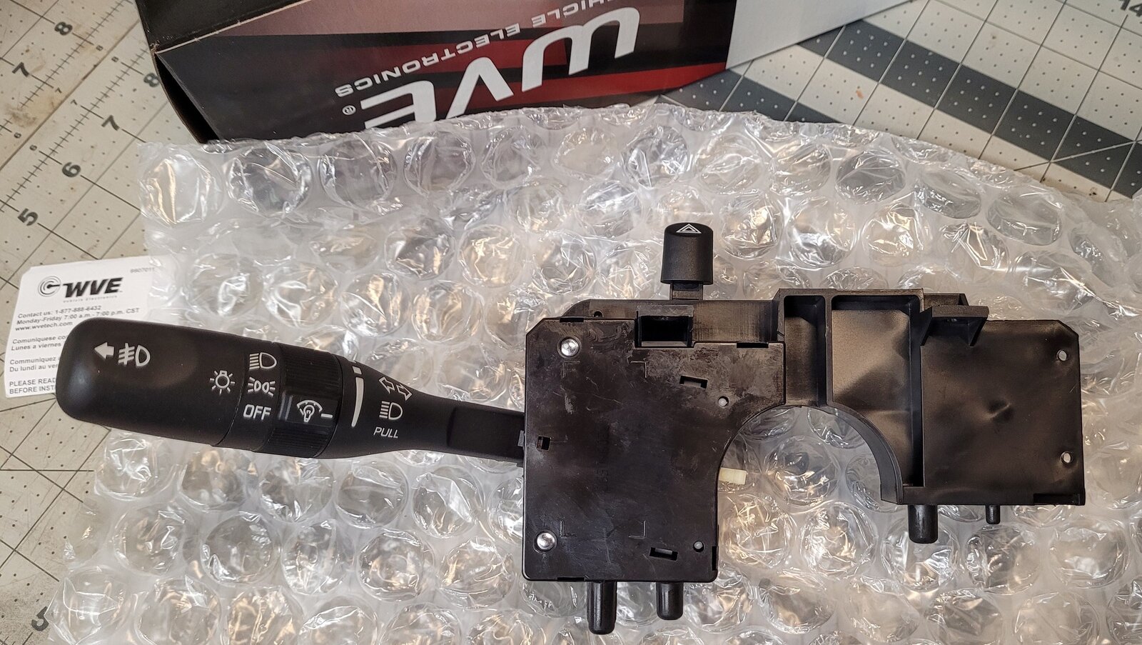

Like many others, my multi-function switch had begun to act up. My fog lights were not turning on by themselves, but if I was driving with the lights on and hit a good bump, I would get a long series of warning beeps. No engine light or anything else, just 10+ beeps. The first time it happened was a little wild looking for the reason for the noise, but I researched here and found how this is a problem with our turn switch, its connector, or both.

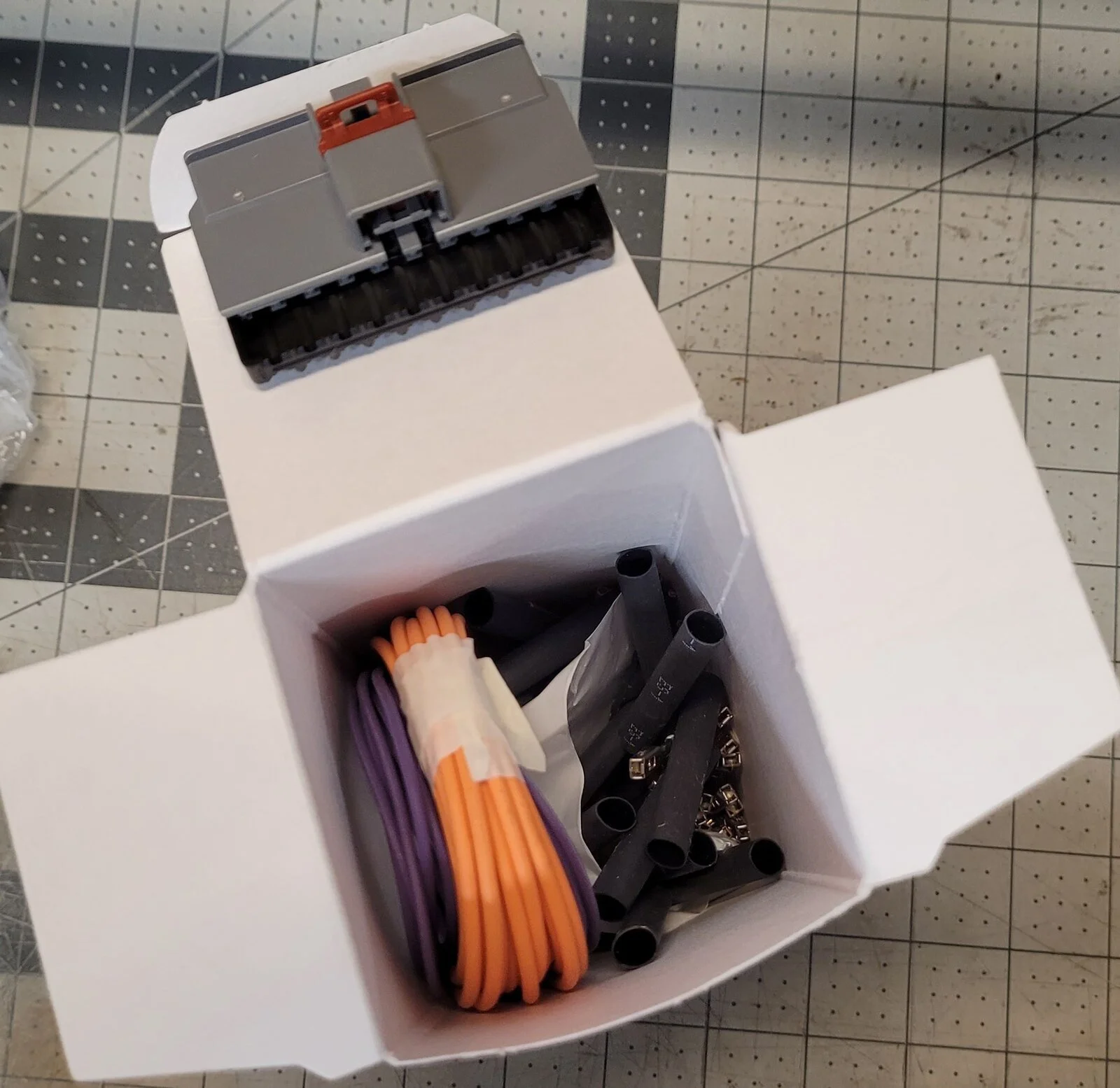

I recently figured out I could cancel the beeping if I lifted the turn signal like I was about to make a right turn. However, not wanting to have a major short and seriously damage something, I went on the safe side and bought both parts (switch and connector) before I even looked in the steering column. I went to Rock Auto and purchased WVE brand parts. Details on WVE stuff is sparse so I figured I'd add some detail and pictures.

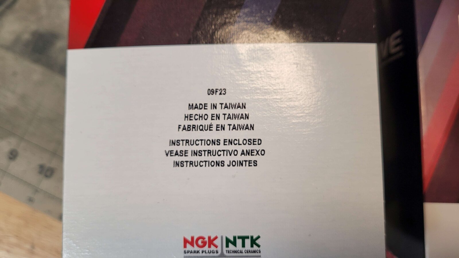

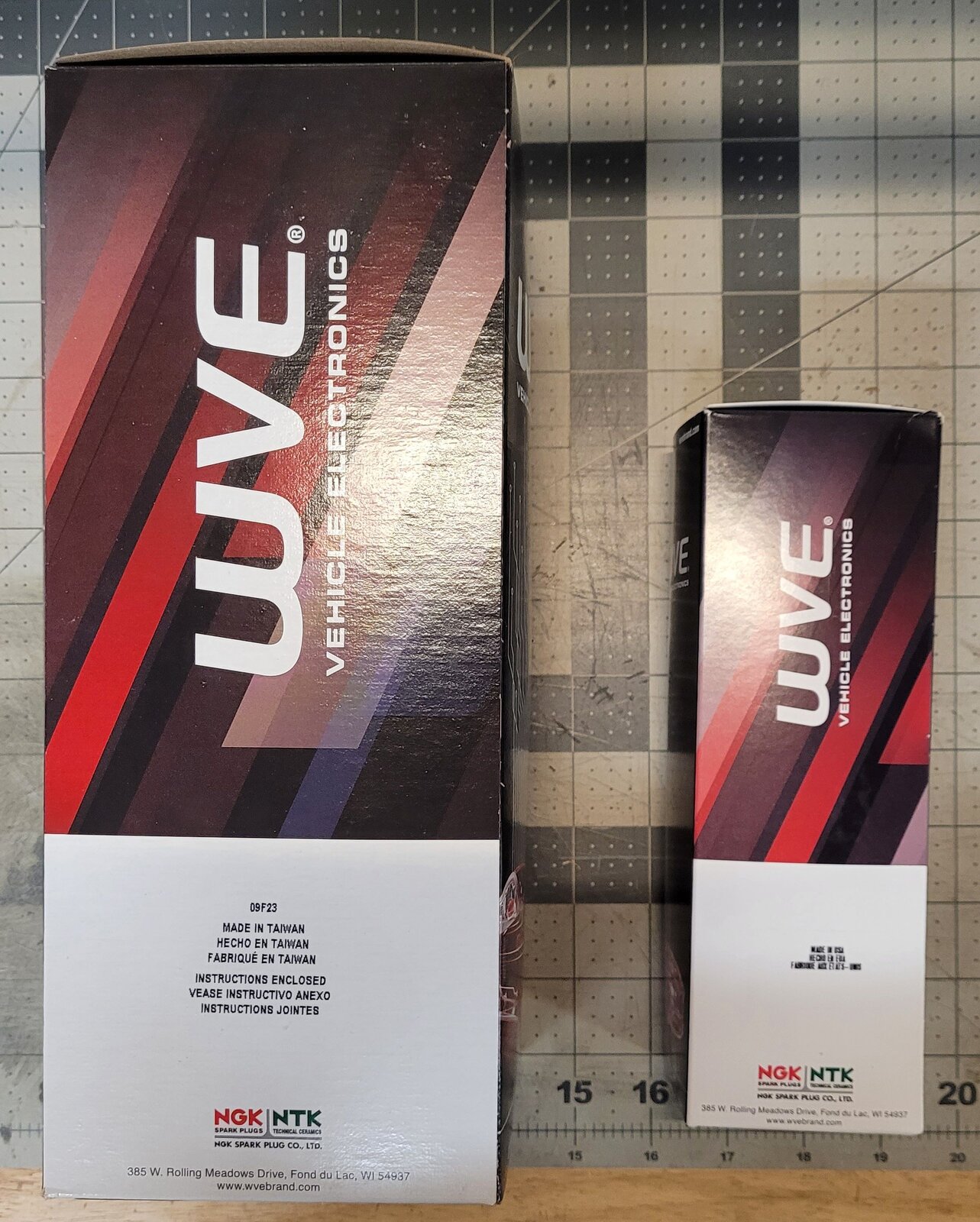

This is what the boxes looked like:
The switch (big box) was marked "Made in Taiwan" the connector (little box) was marked "Made in USA".
Switch:
Connector:

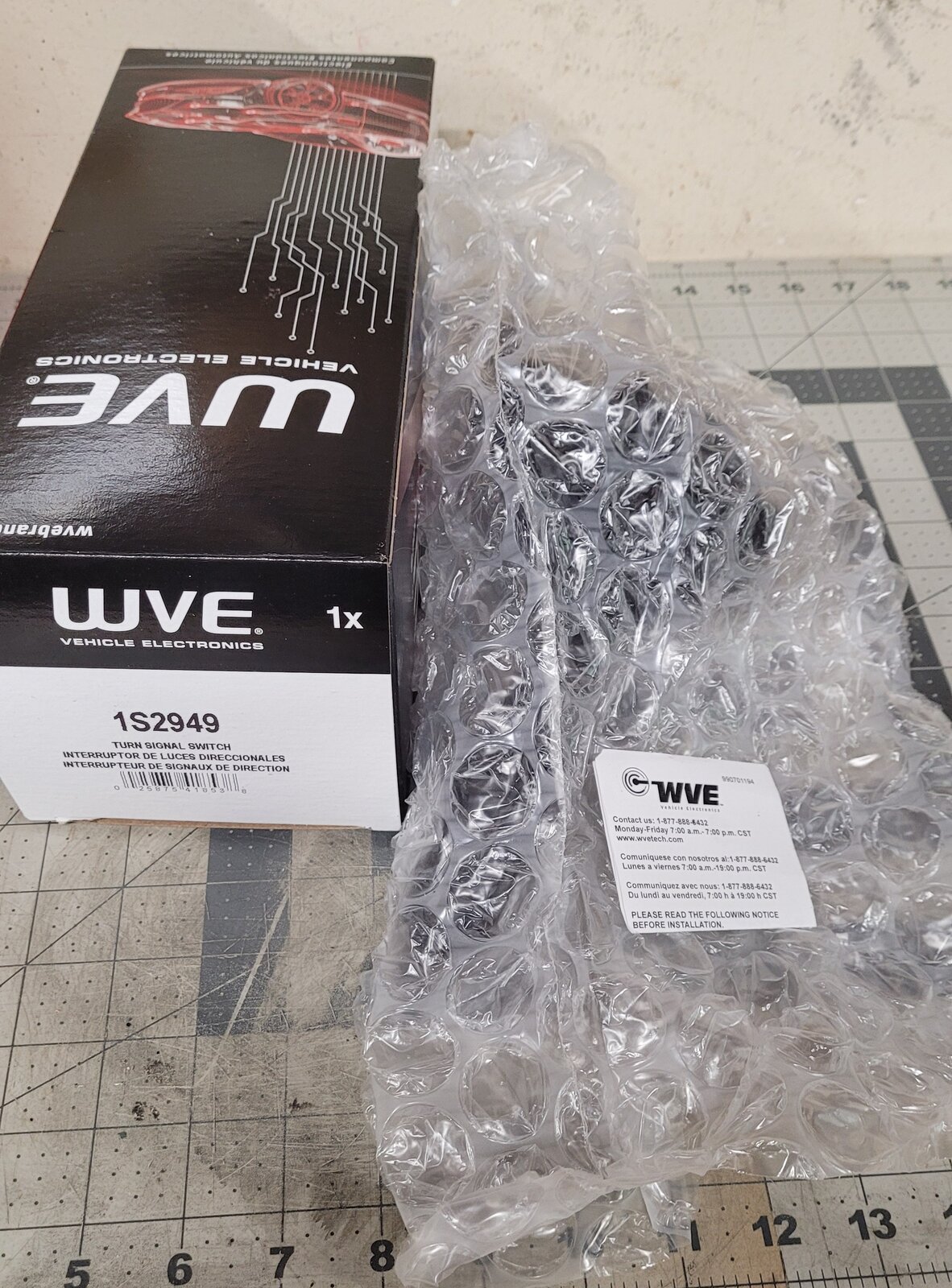

Packaging was what I'd expect:
Switch:
Connector:

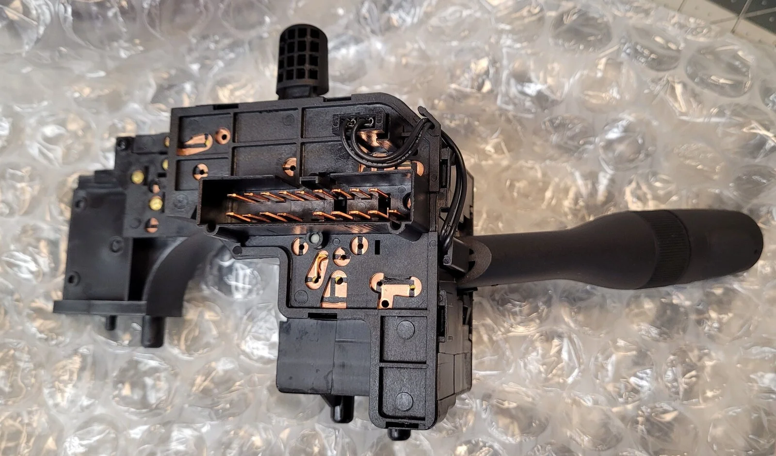

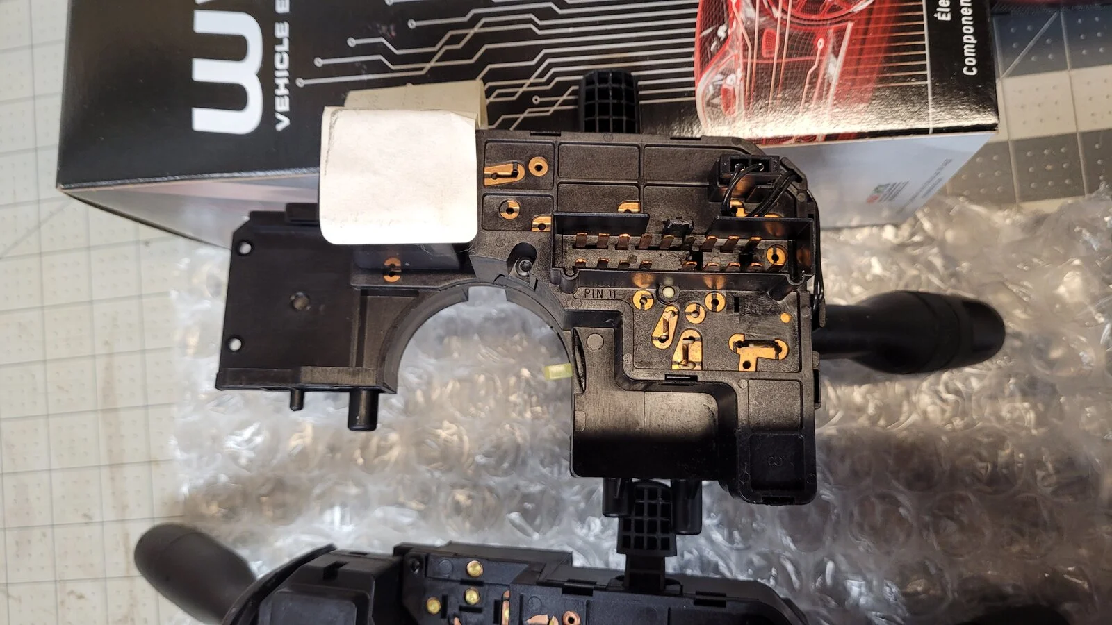

Here is the new switch:
Front:
Rear:

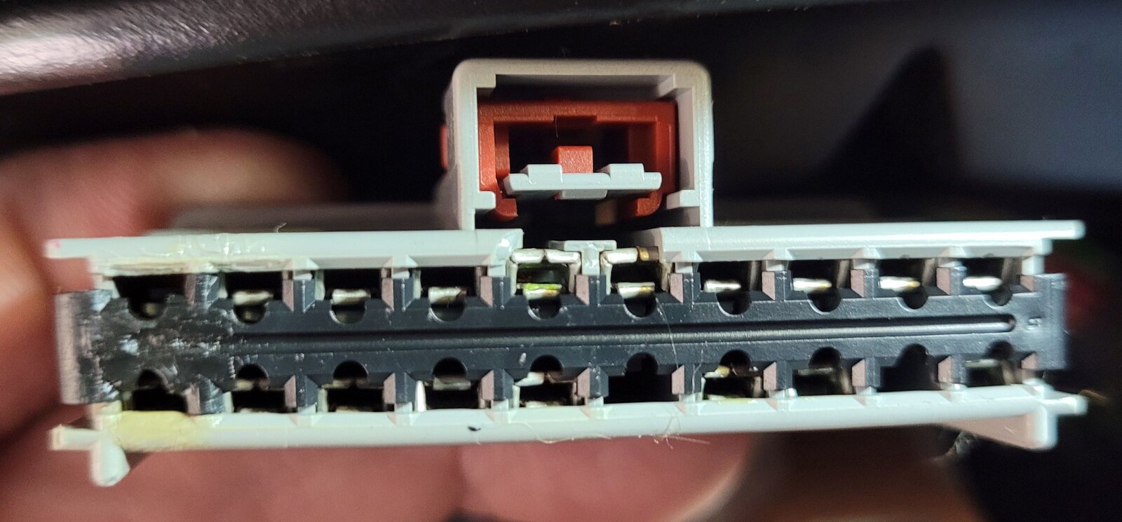

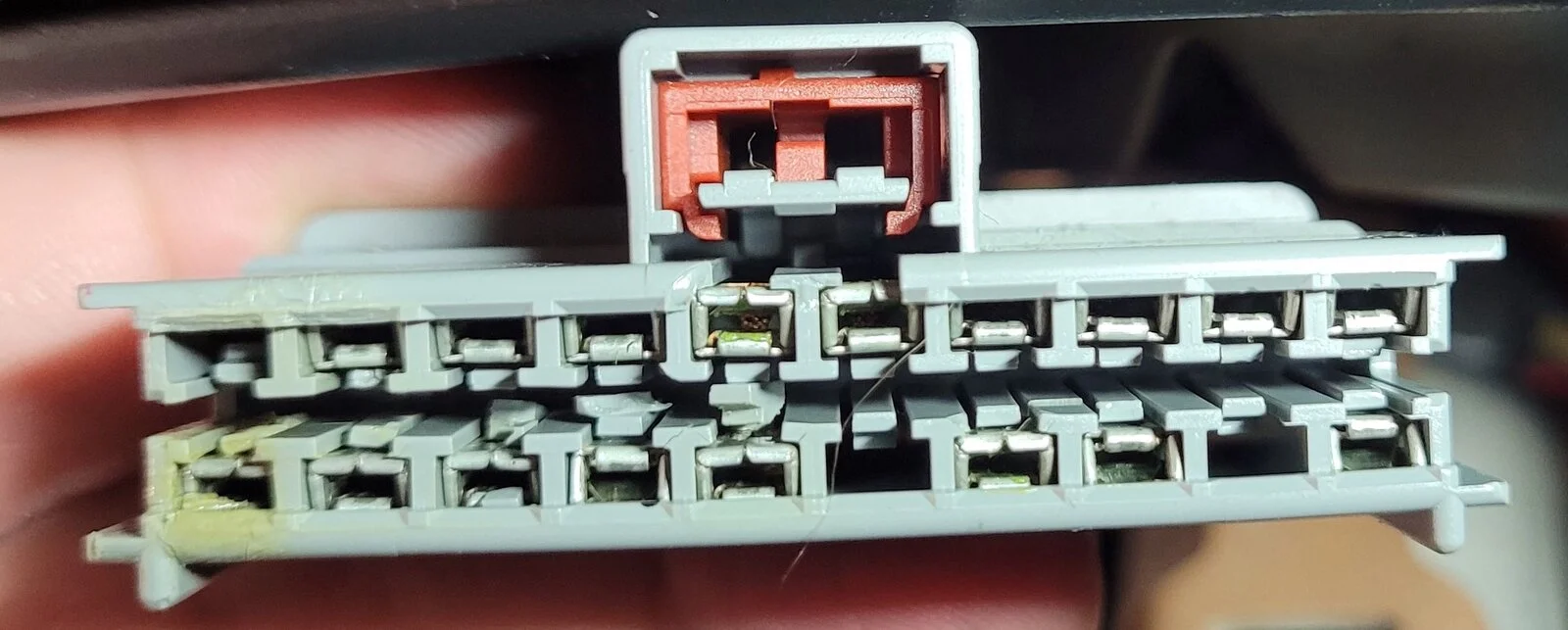

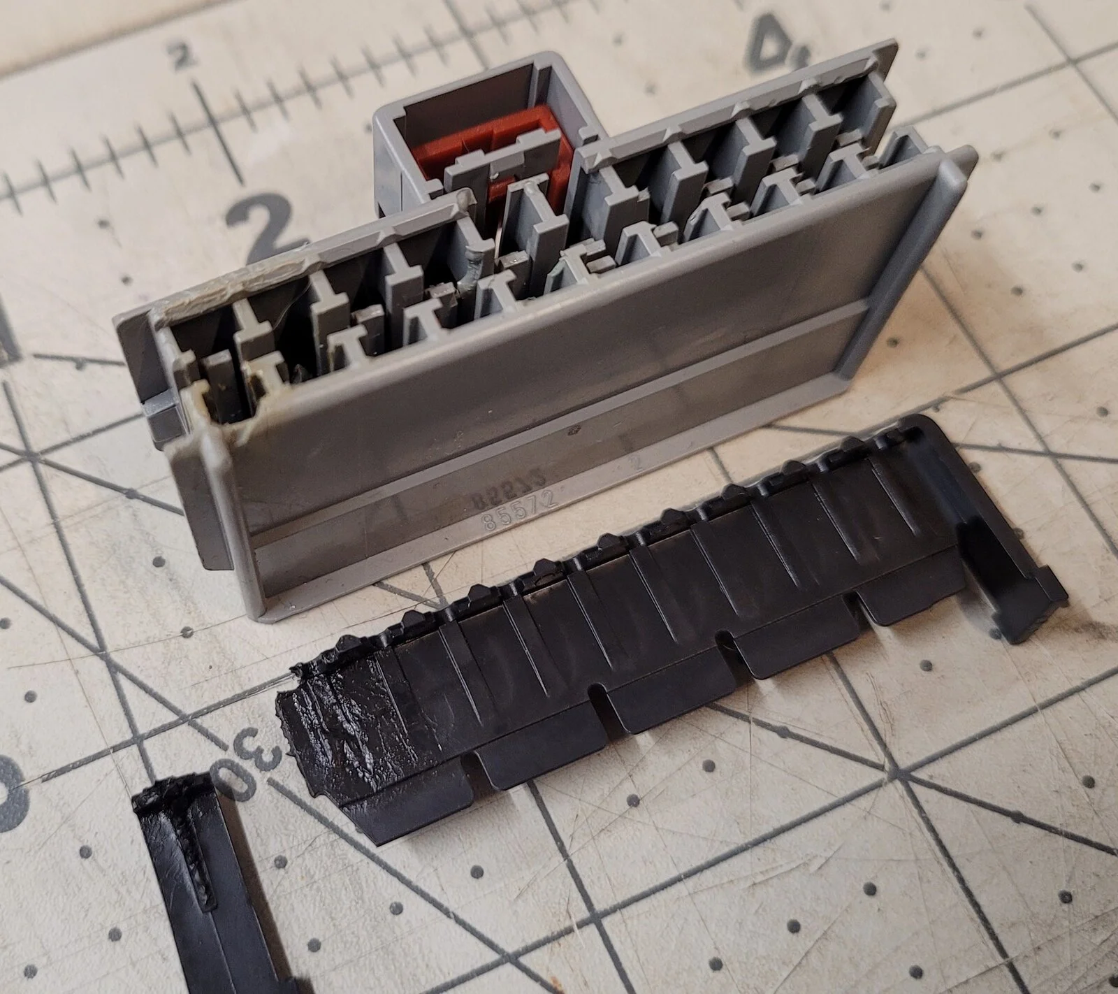

After opening things up and disconnecting the original switch I saw part of the problem, a melted and beginning to disintegrate connector.
Damaged connector:
Here is another picture after I removed the black, clip-on face plate. It actually just snapped off at the melted side with slight pressure.
Signs of heat and several broken locking tabs:
Detail of the damage:

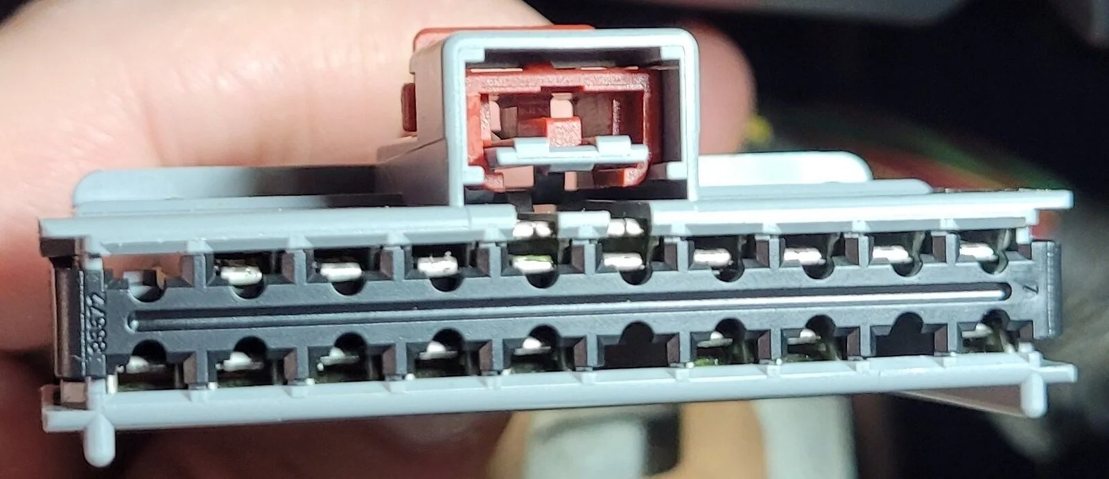

I used a small screwdriver to release each pin individually and reinserted them into the new connector one-by-one.
Here is the new connector, all pinned and ready for the new switch:

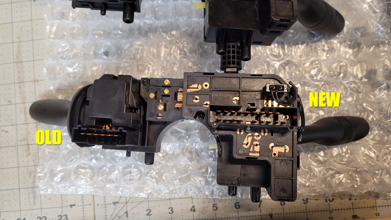

Over at the workbench I got the switch ready.

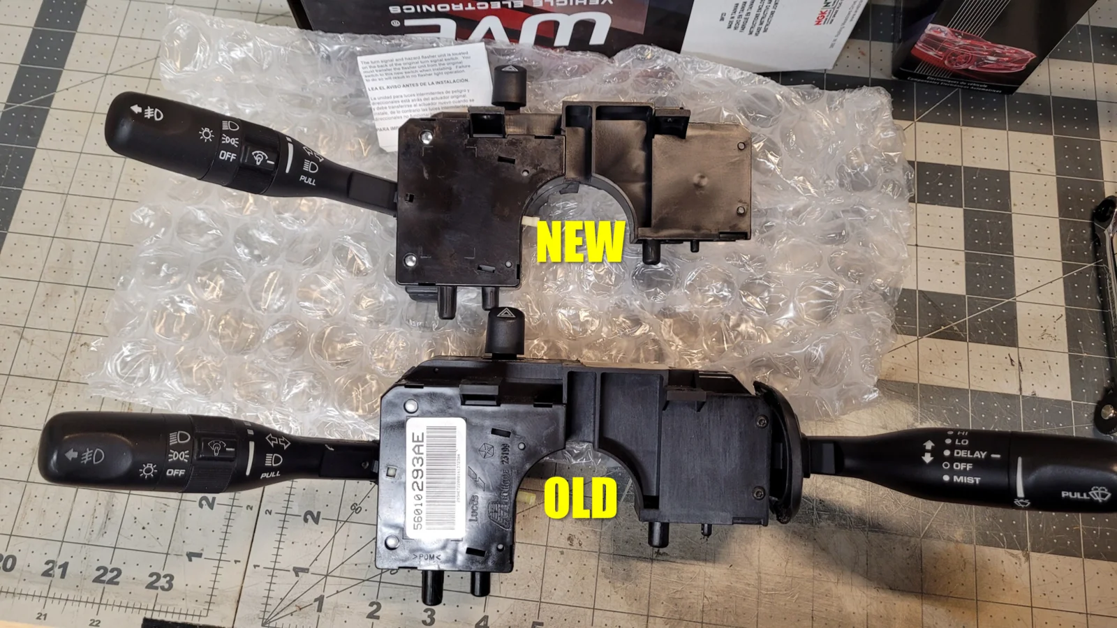

Here's a comparison of the old and new parts:

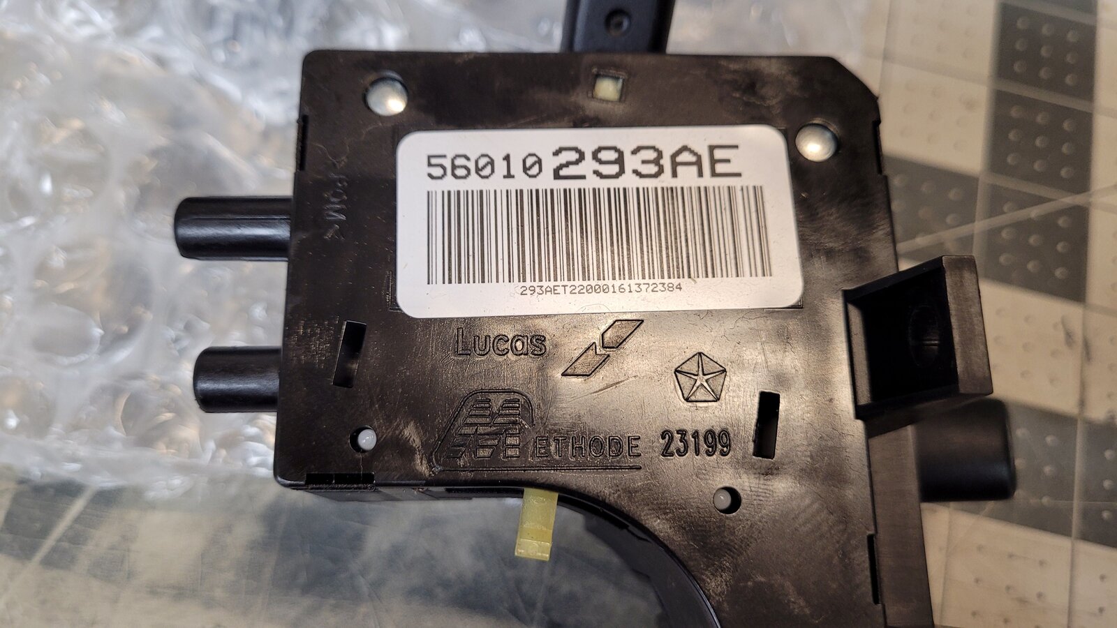

In case someone wants it, here's the detail on the OEM:
The original relay still had a label over it, so I kept it on when I transferred it.
Here the relay is still on the back of the OEM switch:
Here are the old (washer switch) and new (multi-switch) parts assembled:
During reassembly it all lined right up, no surprises in misalignment or odd sizing.
