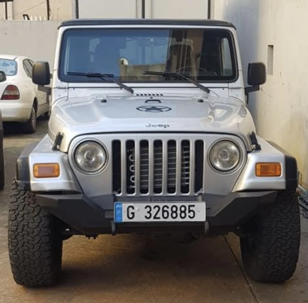

Here it is stock the day I bought it:

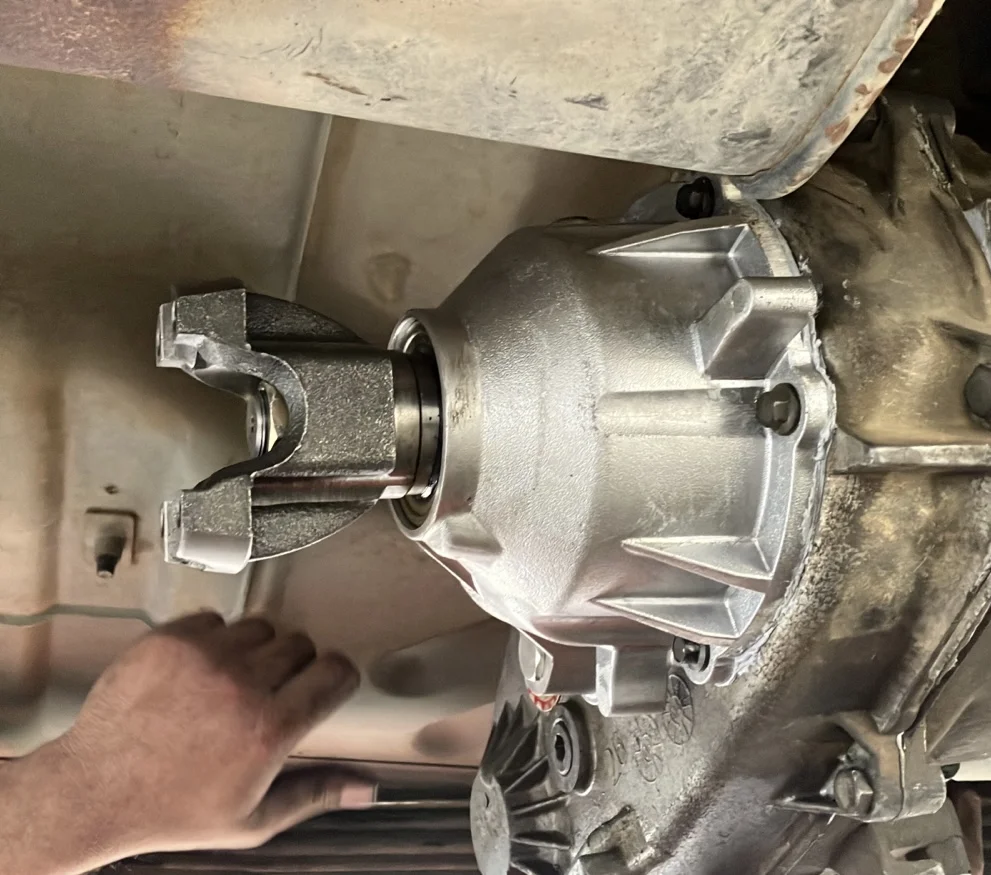

For the axles, I swapped the rear Dana 35 with a Dana 44 and the front LP Dana 30 for a HP Dana 30. USA Standard 4.88 gears. Eaton e-lockers on both ends.

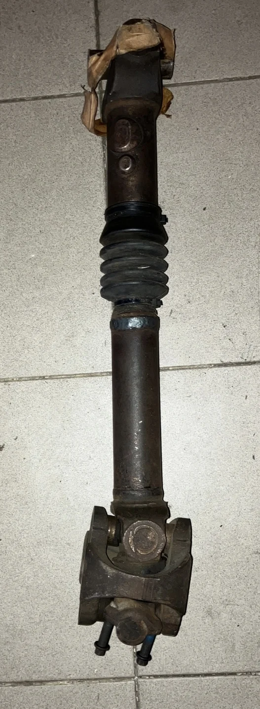

Rugged Ridge SYE with a shortened DC rear driveshaft.

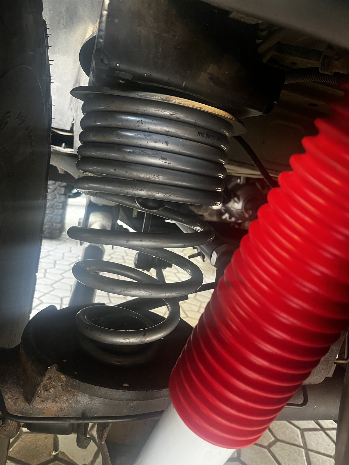

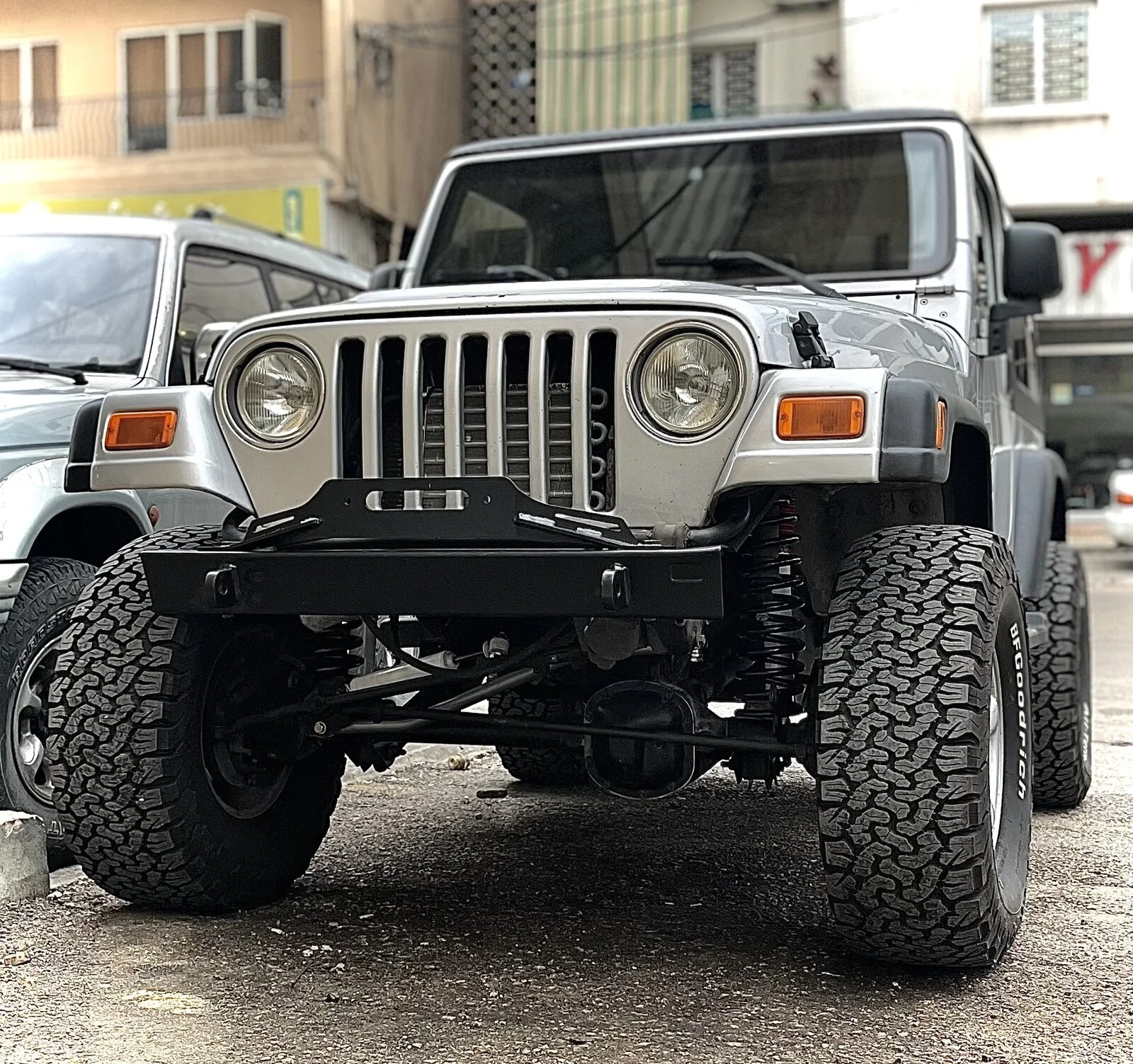

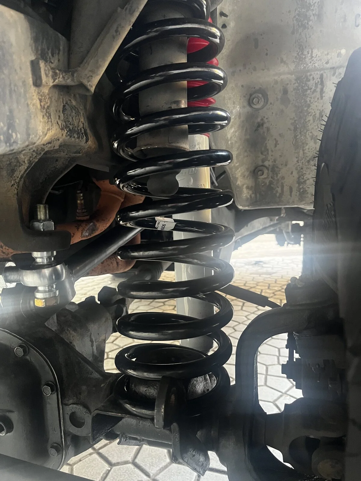

For the suspension I mixed and matched components from different brands with the hope of achieving the most comfortable ride possible both onroad and offroad:
Shocks Rancho RS5000x
Rear coils RE 2.5” progressive coils + spring relocating brackets (netted 4.25”)
Front coils OME 4” (netted 4.5” even with the bumper installed)

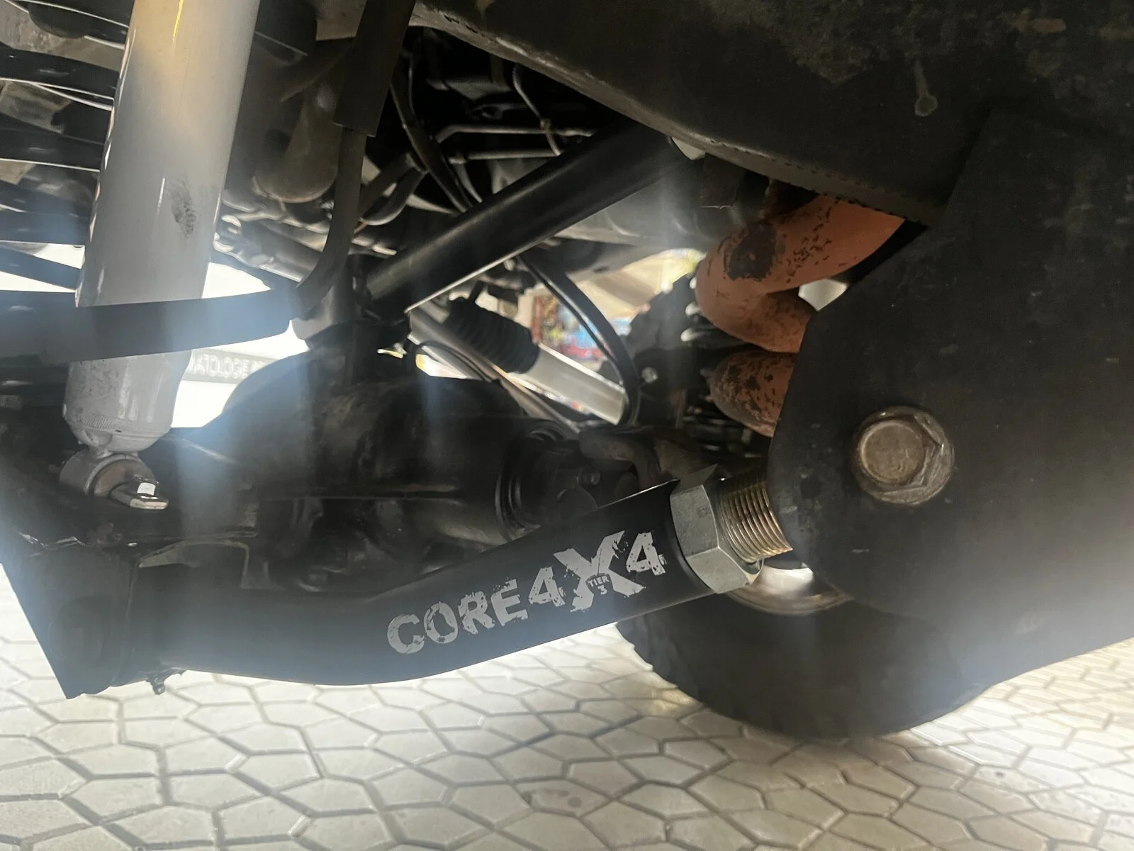

Core 4x4 tier 3 control arms (with currie Jhonny joints)

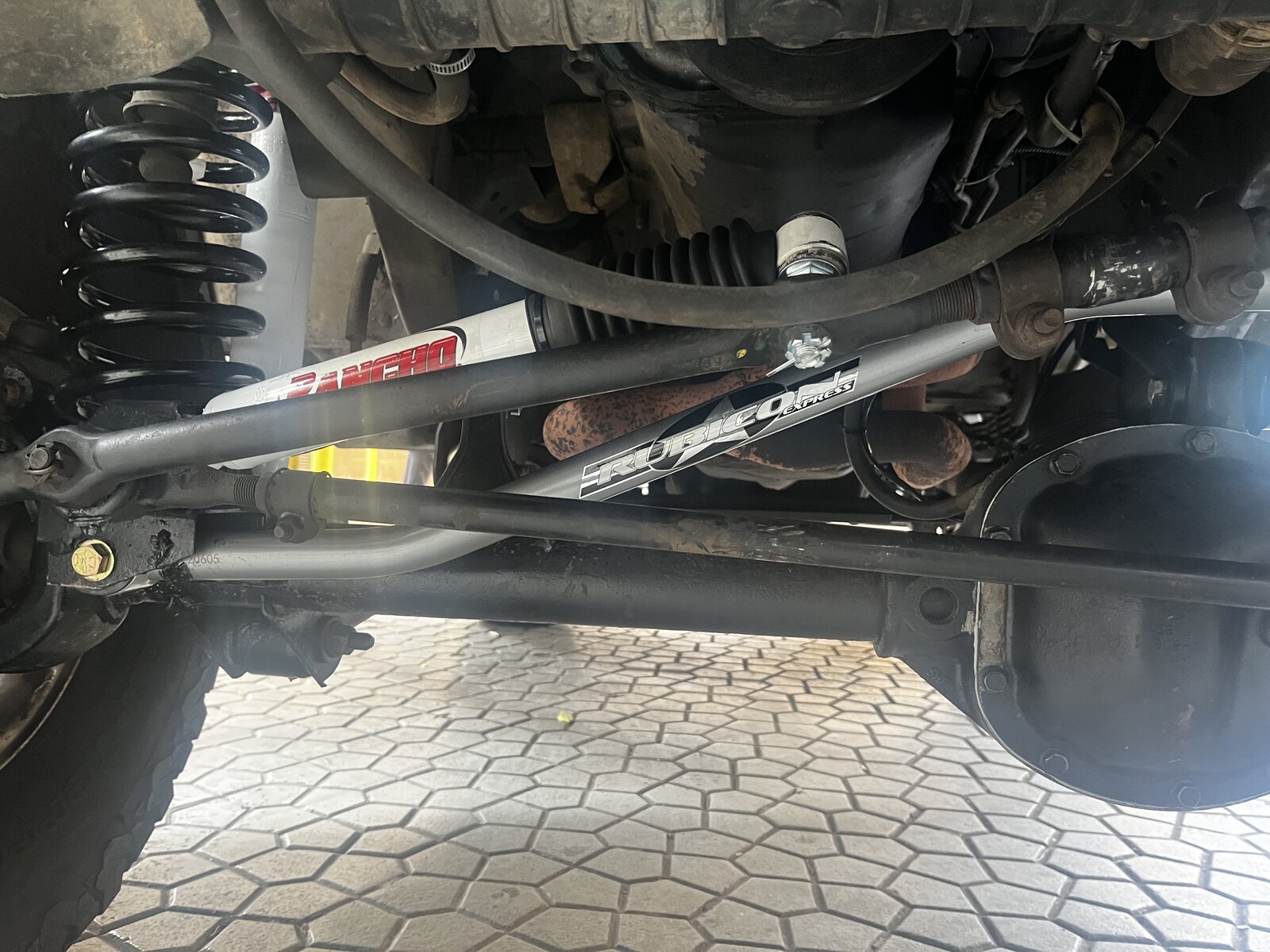

Front and rear RE adjustable trackbars
Rancho steering stabilizer
RE front swaybar disconnect

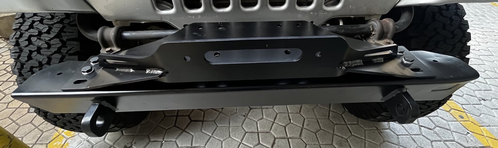

Smittybilt front bumper (cutout some lenght to make it a stubby) and a rugged ridge raised winch plate

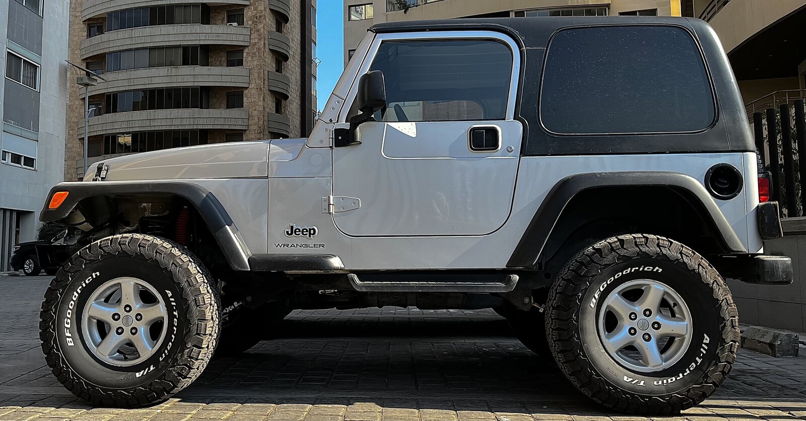

33-12.5-15 KO2 on stock wheels and spacers

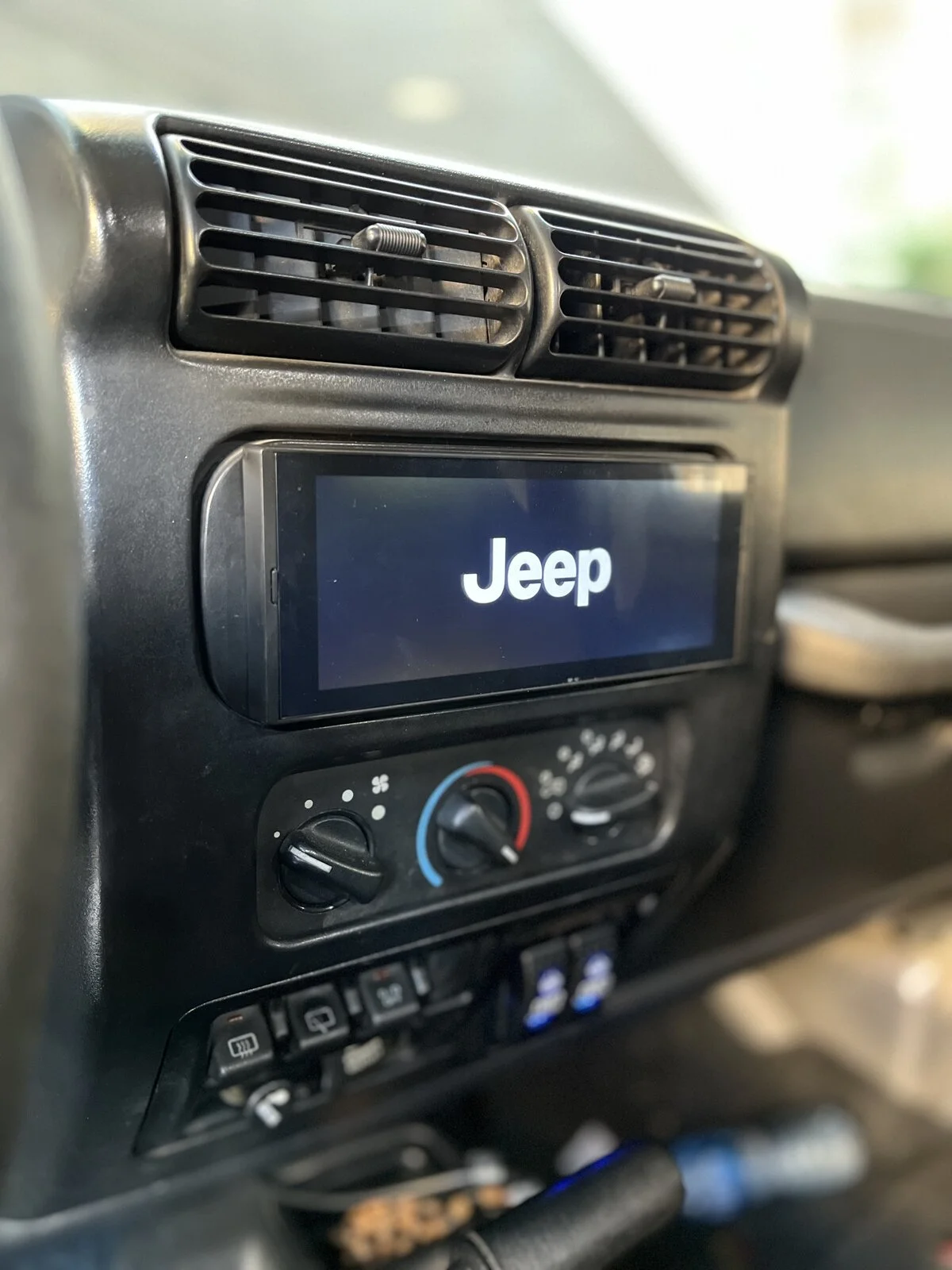

Had to change the headunit as well:

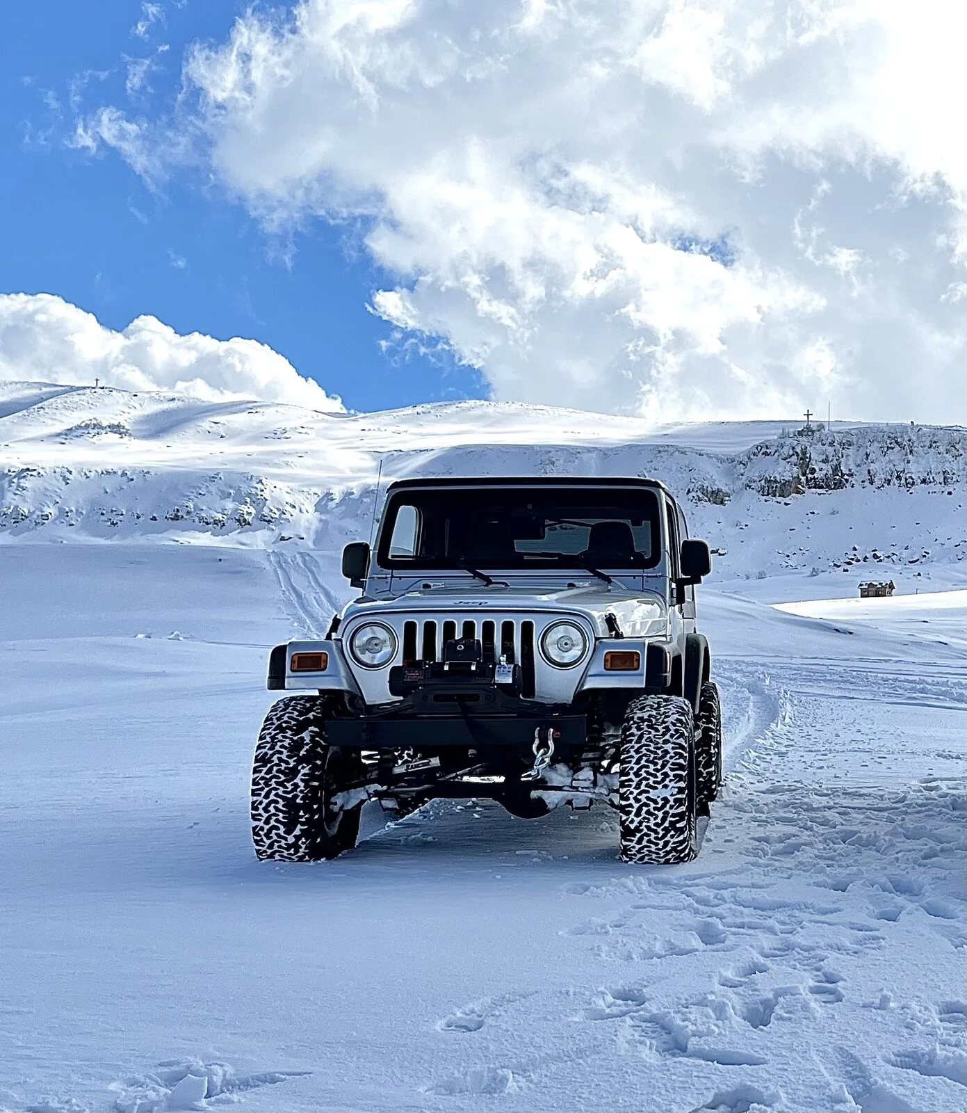

Here is how it sits today:

Are you happy with your suspension choices? Did you achieve your goal?
I love wheeling in snow because it washes off the underside so well 😅
Looking good!
It took a couple hundred miles for everything to settle down and yes it rides perfect to my taste! It glides over potholes, very stable at highway speeds and tons of articulation offroad (I am in urgent need of bumpstops even with 33’s)
Reactions: EternalHobbyist
Thats an easy fix. :) Congrats! Its a great feeling seeing something come together like that.

Tell me about that head unit.. please.
Brand is ZWNAV found it on amazon. Comes with Carplay. Doing ok so far.
I liked it mostly because its a 1din screen that require no mods to install and it doesnt look out of place on the TJ’s dash.

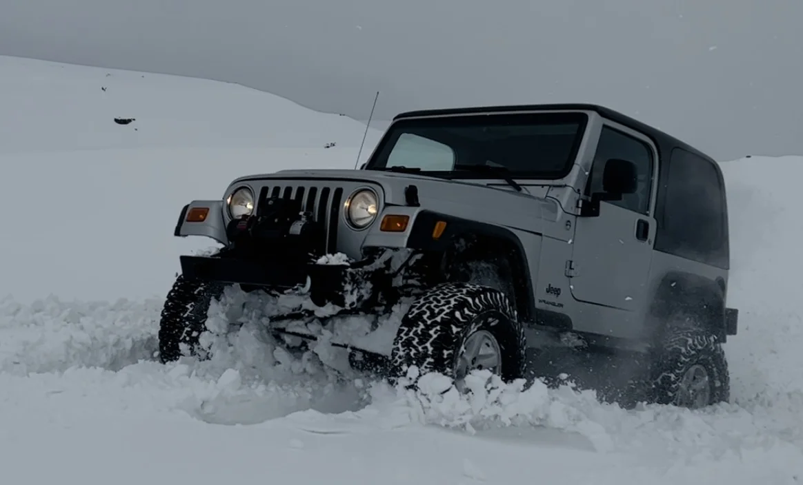

New snow footage.
Satisfied with the setup overall but would really like to upgrade to 35’s for more flotation on snow and better clearance under the diffs.
Any recommendation?
KO2s are doing good in packed snow but struggle once it gets mushy. Would like something to work in both.
