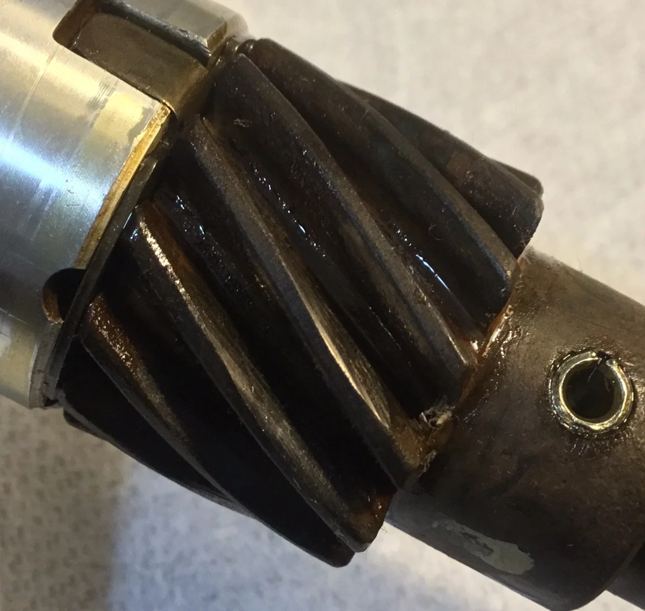

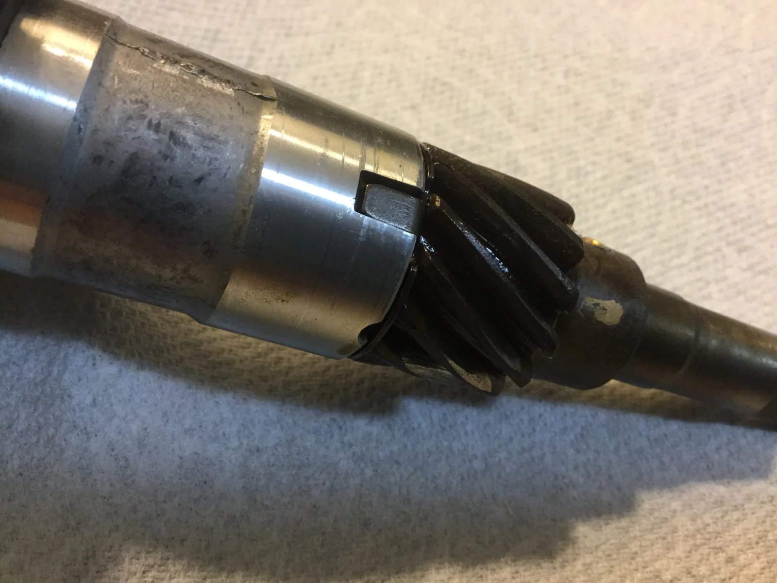

I’ve been hearing every little noise under the hood and the OPDA is always on the back of my mind so I finally picked up a new one and changed it today, easy as everyone says. Some uneven wear on the gears but no missing pieces, the old OPDA seemed to have a bit of play in the shaft and the idle was at times a tiny bit rough, the idle now is rock steady after changing the OPDA I’m not sure if I’m imagining the improvement?
Pics of the old pump drive gear;
Mine looks to have been the factory original I imagine it could have been Chrysler updated? Anyway I’m glad it looks normal, best thing now is I can forget about it for a while.

What model year? Your Profile that is supposed to have your Jeep information is empty.

Whoops, OK I’m all updated. 2006 Rubicon automatic 3.5 lift on 33x12.5
Both drive shafts, PCM and the OPDA amoung a host of other things are all new. I think that’s most of the 2006 issues I need to worry about.

Your perfectly normal 05-06 OPDA with so little wear after 186,000 miles is a welcome counterpoint to the chicken little mentality of those who seize every opportunity to claim that those model years should be avoided at all costs.

That is way better than mine. I changed both on mine because, just because.......hmm... because!
I concur. My 06 OPDA with 80k miles looks perfect when I pulled it out to replace it with the Crown. I’m completely confident the $100 Crown OPDA will be just fine for the life of the vehicle and that the OPDA issue is blown out of proportion.
I’d recommend that anyone with an 05/06 just change it out as part of regular maintenance with a Crown unit every 100k miles just for peace of mind.
