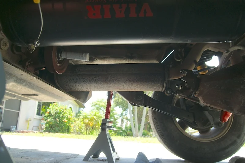

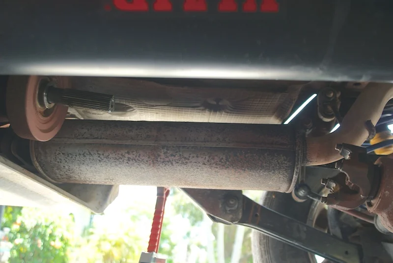

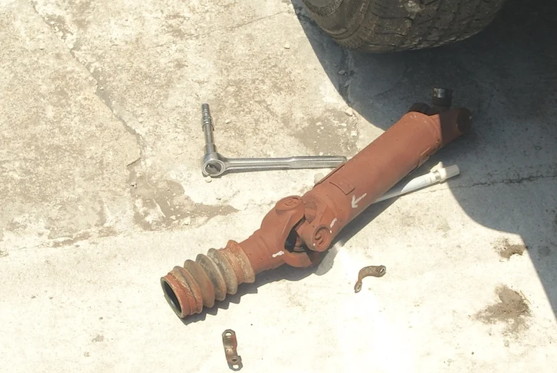

@NWPA Jeepy T Nailed it - its the forward rear driveshaft u-joint. But not to leave @Jerry Bransford out, driving the jeep in FWD, makes me believe the axle U-joints are bad as well, there's a kind of ratcheting motion on sharp on-pavement turns (read: Parking lots). The driveshaft removal was as easy as everyone said it was - so easy even a Belly Dancer can do it!
I actually ordered a complete new set of U-joints last nite as I figured that even if it turned out to not be the problem, they were due to be replaced anyway. I bought Jerry's recommended greasable DuraLast brand from AutoZone. ;)
The CarFAX for this Jeep noted that "driveshaft u-joint(s)" were replaced at some point - wonder if I'll be able to figure out which one(s). I covered the xfer case output shaft with electrical tape to protect it until the U-joints come in and I can get them installed. I'm still trying to put this house back together from the re-pipe job, AND to make the end phase of this barely-passed Mercury Retrograde complete, wife's car had a cooling fan go out, so until I got that driveshaft out of the Jeep, we were down to one car! That fiasco killed both my monthly facial as well as my Thursday nite dance class.
Dumb question: Does the front to back orientation of the driveshaft matter? I marked it, but want to know...
The CV joint end goes closes to the transfer case. That's toward the rear since you don't know where the transfer case is. 🤣
