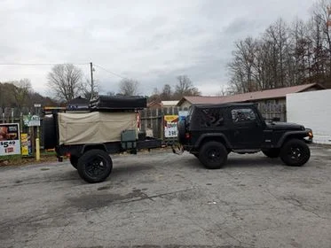

Hello all I am brand new to this forum but it seems like a plethora of info to say the least. I recently bought a 2000 TJ sport manual with 4.0L. My end goal is to have a jeep that can pull my overland trailer on and off road. A teenager had it before me and put some 32s, lightbar, and a 2.5 inch lift on it otherwise everything else is pretty much stock except for a couple of accessories. The only thing I have done is add a smitty built XRC rear bumper (so I can to my trailer) and wiring harness
My current plan
- Keep the Dana 35 (don't hate me please) and beef it up (I don't plan on ever running over 33s) and a maybe rear locker????? I don't plan on rock wrestling just getting places on forest/trails for camping. Regear to (not sure yet) so I can better pull my trailer (its a dog pullin the trailer in anything over 3rd gear)
- Rewire so I can add aux fuse panel for lights and winch eventually
- XRC tire carrier so I can have a correct size spare
- Sway bar disconnects
Here is my rig.
I am still extremely new to the jeepin thing and would love anyone that has done a TJ overland build/anyone else for their insight.

Super 35 would be able to handle up to 35" tires while locked so keeping the 35 isn't a big deal. - If you're sticking to fire roads a locker and super kit isn't really needed with 32" tires as long as you keep it open.
I'd look into the MorRyde spare tire reinforcement kit over a swing carrier.
@Mr. Bills has a nice set up you may want to check out. Remember the TJ is only rated to tow 2,000lbs.

Awesome appreciate the advice! Do tailgate mounted tires hold up better than the tire carriers on bumpers? (Just trying to learn). The reason for the locker idea was I figured I was already down there with the re gear but if you believe it isn't necessary I will forgo it.

I had a warn tire carrier and currently have the MorRyde I mentioned. The swing-out carrier held up just fine but it was annoying to open it each time I wanted to get to the trunk. The MorRyde makes it act just like the stock setup so you don't need to do anything special to open the tailgate and can easily support a tire up to 35".
Don't get me wrong, a locker would be great and would make the jeep much more capable. But if you're only going to be on fire roads it's likely not worth the extra 2k +-500 for the locker and super 35 kit. I would think really hard about where you see yourself going. If you think there's a chance you'll be lifting tires due to uneven terrain it would be cheaper, in the long run, to get a locker now vs adding one after the re-gear. Alternatively, an LSD could be added but I'm not sure if you'd need to add a Super kit. My guess would be yes.

I was suprised to find it has a 4.11 listed on the plate on the rear pumpkin. This rig is on its second engine (replaced 50k miles ago and 2 owners prior). I am guessing it either had a 4 banger in it at one time or someone did an axle swap. I am probs gonna do the 4.88 regair. Its a dog right now especially with the trailer. I do not use 5th gear really at all and struggle in 4th on a flat road with the trailer.
Type in your vin on the attached link and you'll see what it had from the factory. 4.88 are a good call.

Trailer has 2 deep cycles that can be charged with 7 pin (my suburban used to do that). Right now I just have 4 pin but I am gonna eventuall work on getting some wires ran back for a 7 pin

I am planning on getting trailer brakes next season here. The bumper is tow rated. That actually was a pain because there aren't that many that are. It is the smitty built XRC. It has 4 more areas that it is bolted onto the rear frame along with two l shaped brackets go between the frame and the original bumper holes

It looks like it used to have the 4 banger in it before the the 6 cyl. Could the transmission be causing some of my problems with it being a dog then?
Do you have a ax15 or nv3550? Either way though neither should make it a dog... it likely just needs gears.
Can you confirm it actually has a 6 cylinder engine in it? 4 cylinder to 6 cylinder swaps aren't terribly common as they are a lot of work. The transmission shouldn't affect anything.
Take a photo of the engine if you're unsure.

Okay I am idiot. The product of me going to look at a jeep at night and doing a quick look. It is a 4 cylinder lol. When I was looking at buying a jeep I was talking to like 9 people at once and must have got the information mixed up and thought I was buying a 6 cyl. Well now my embarrassed about that I guess I know to why its a dog on the interstate :ROFLMAO:. I still got it for deal even for with it being a 4 cylinder. I guess that changes my plan of attack with it now
