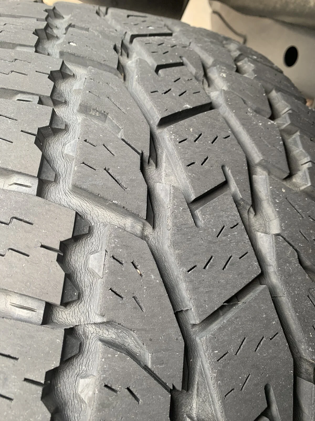

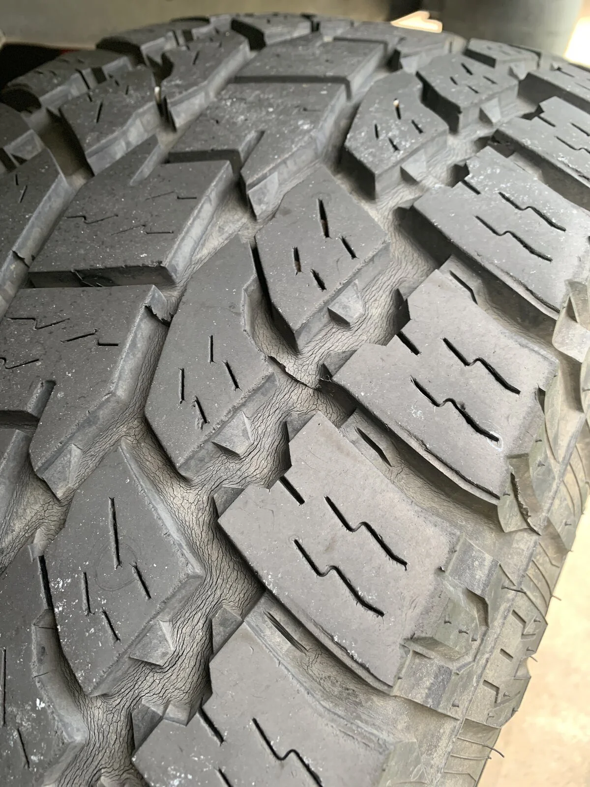

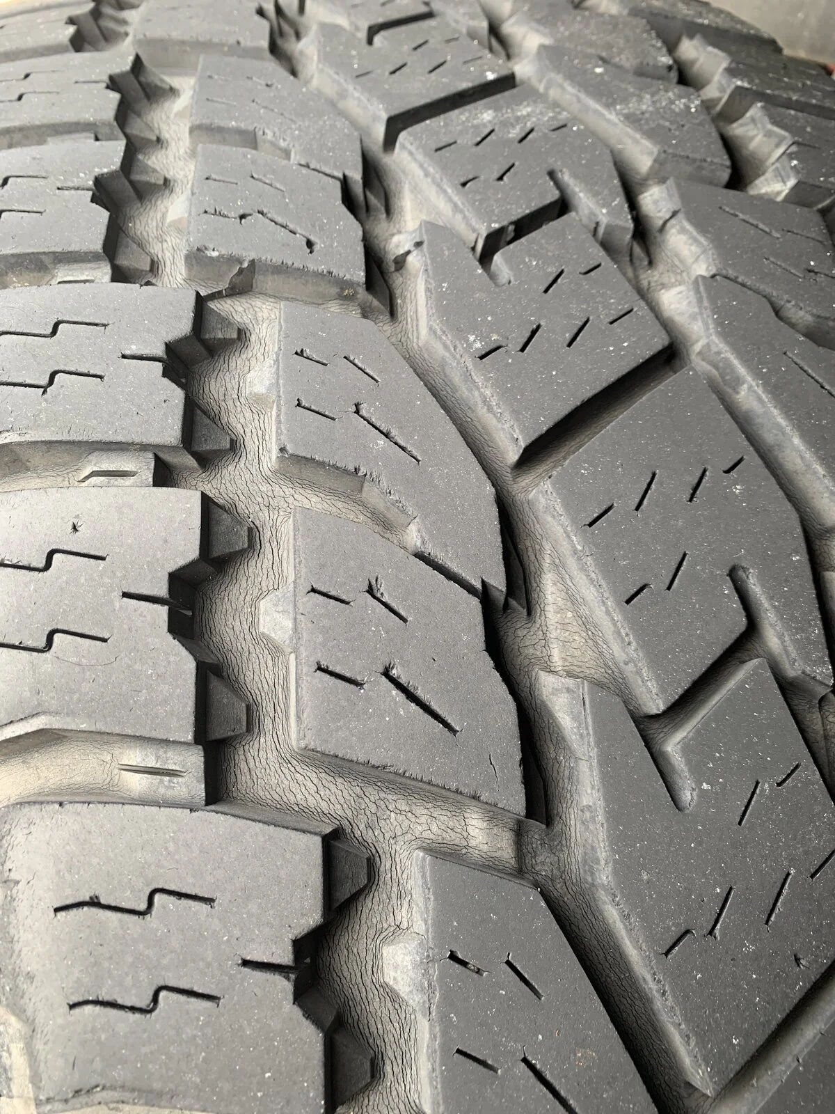

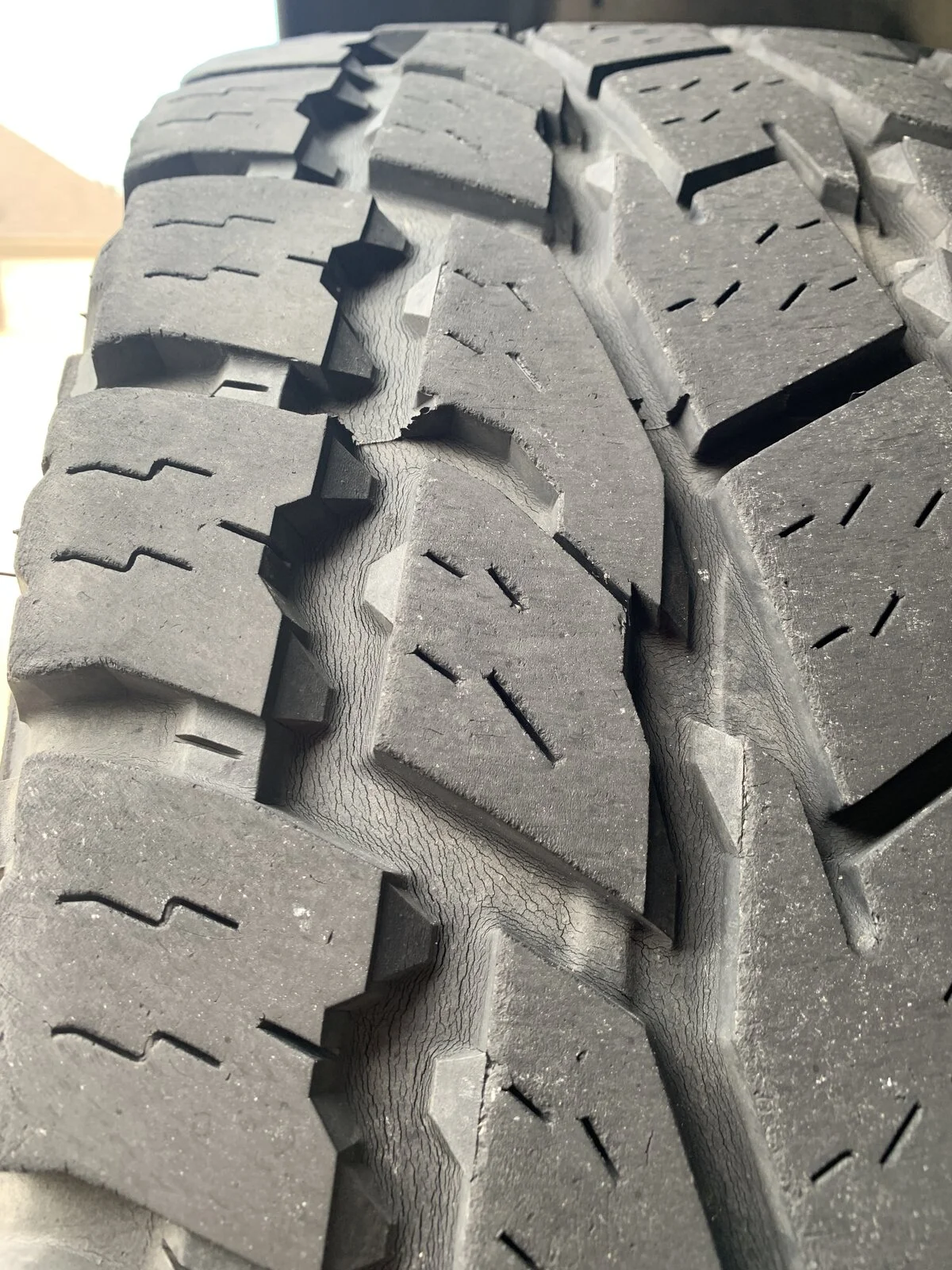

I’ll post a picture once I’m home. I got this Jeep earlier this year. Don’t know how bad it is, my friend just told me that I need to change them out soon. Will post a pic to see what you guys think.
This is all 4 tires.
Those would fail PA inspection at my shop.

Those tires you're running now are not safe.
