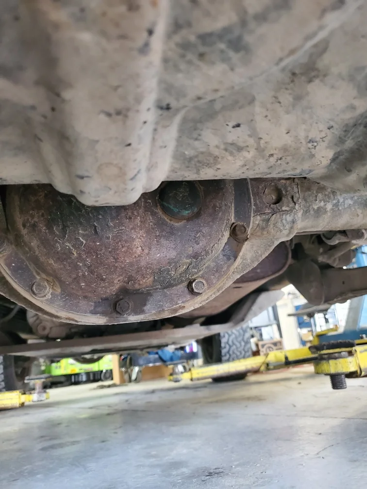

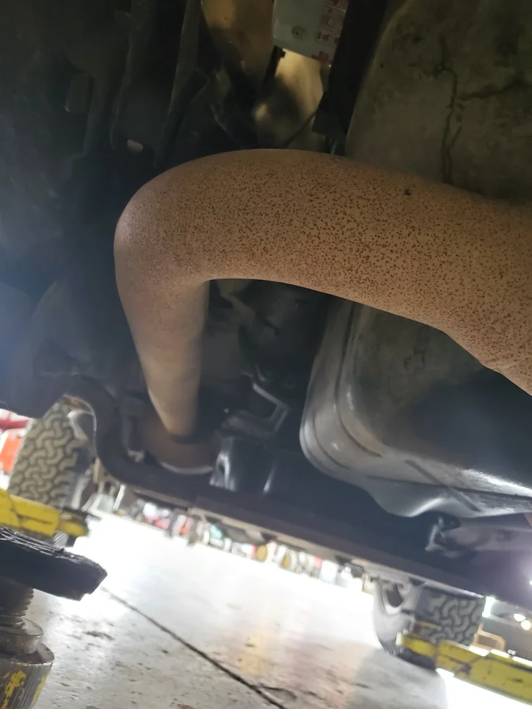

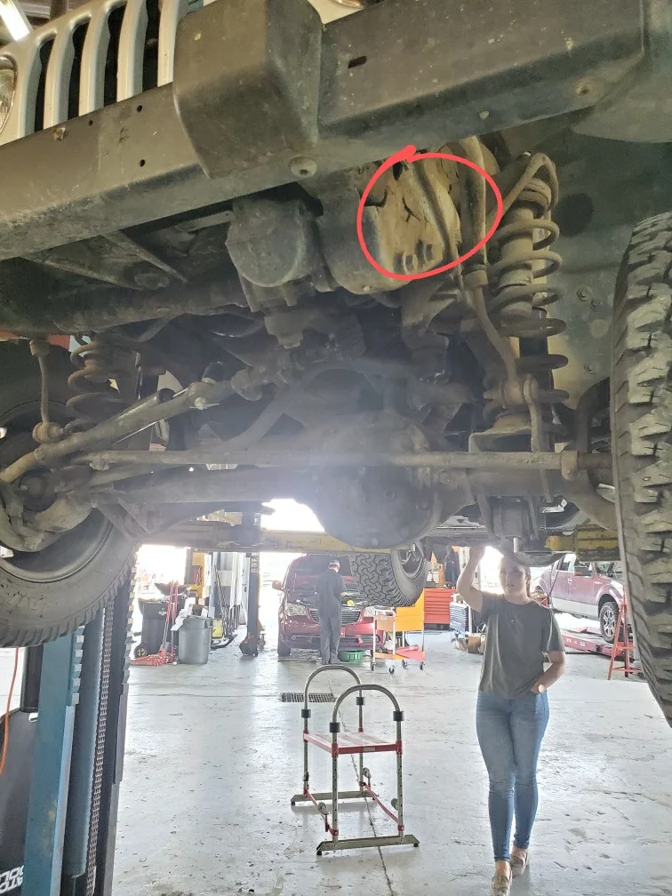

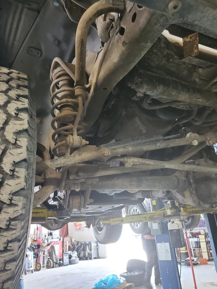

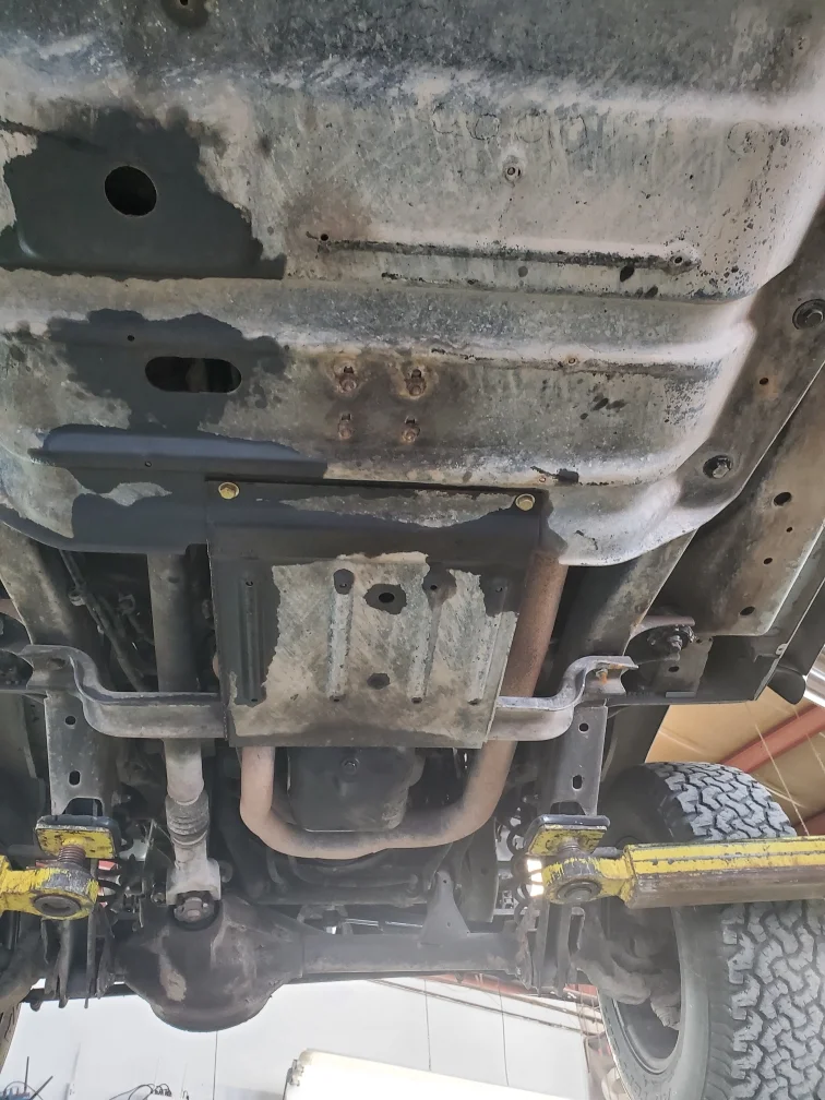

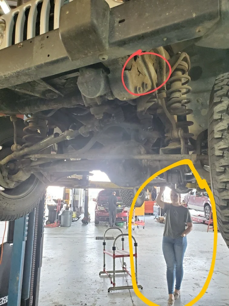

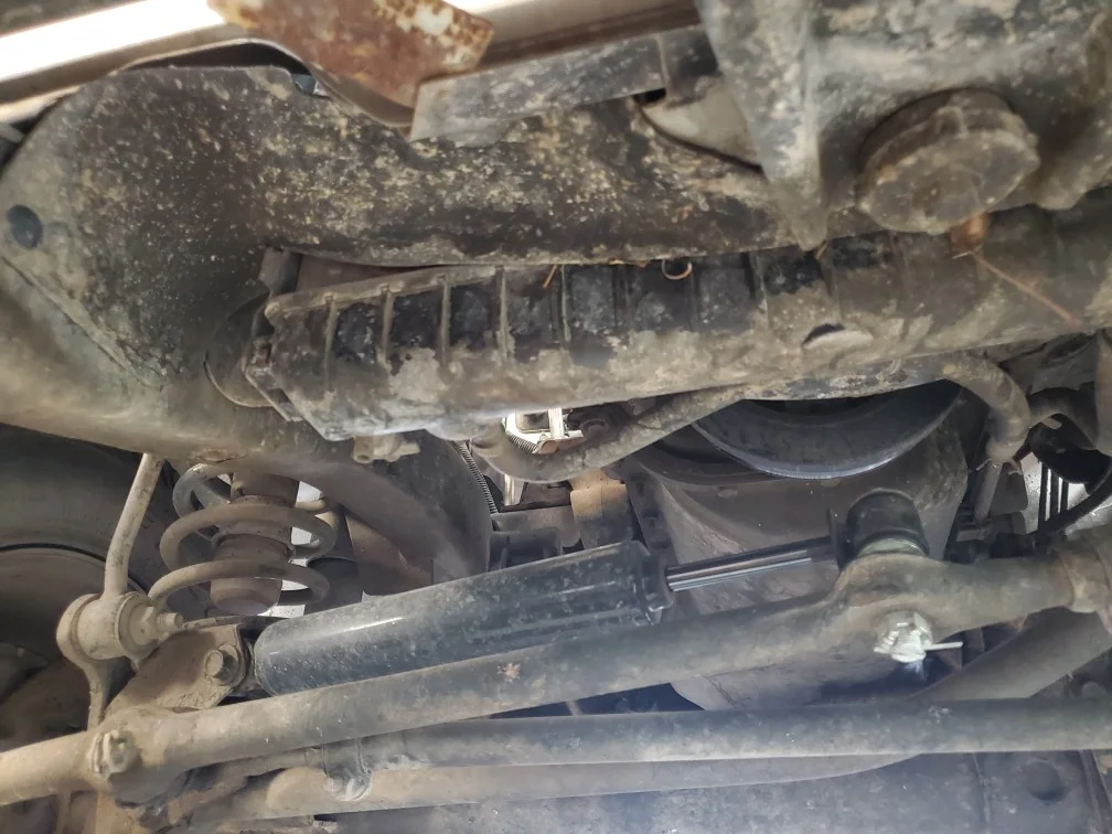

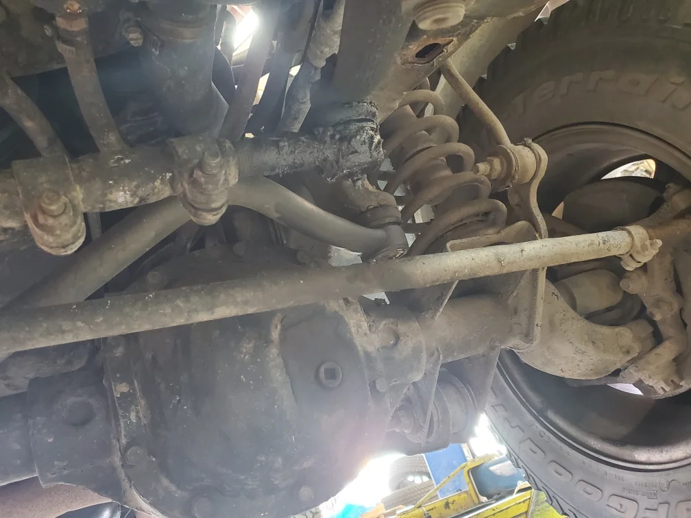

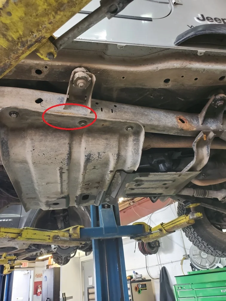

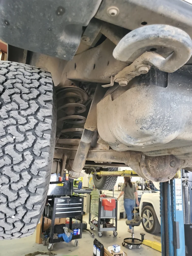

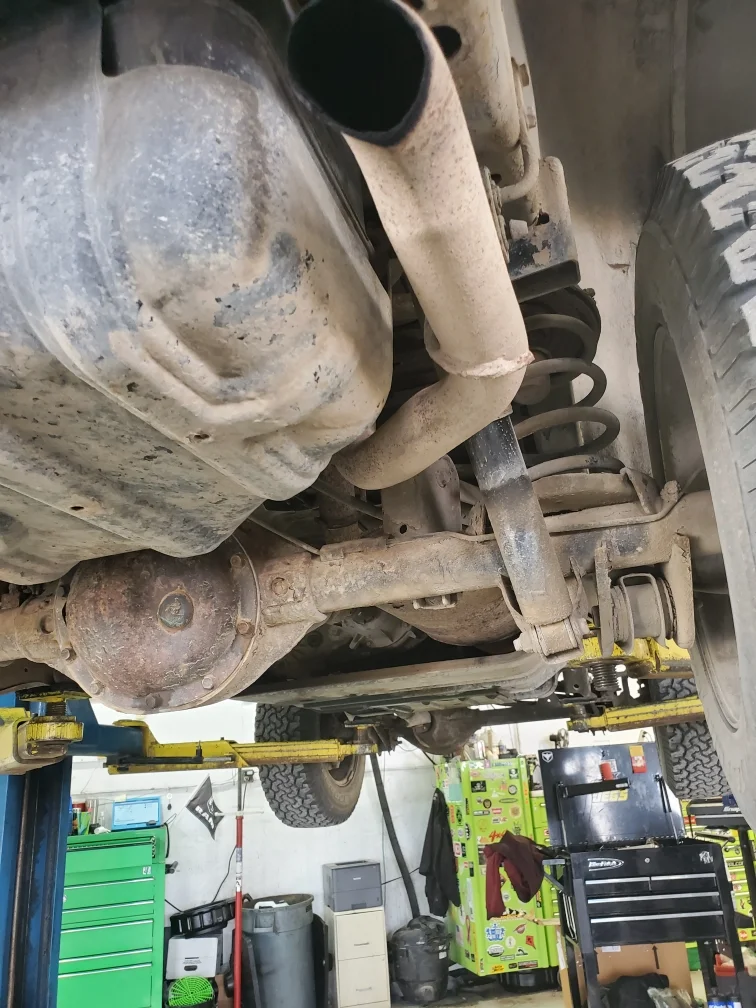

Hi Everyone,
I'm still trying hard to find my first TJ (and trying to be patient!) and came across this one that looks good on the exterior and interior, but I'm a little concerned about what's underneath, specifically rust. I've already been told to look for rust, and then more rust, and finally more rust! ;) It also looks like there are some oil leaks. It's kind of hard to tell because it's so dirty! It spent it's first 10 yrs in Michigan so yeah, salt. It's an 03 with 112,000 miles and 4.0L automatic, asking $11k. Unfortunately it's a couple hrs away from where I live so I can't just go see it in person so have to rely on pics and videos.
What do you guys think? Too much rust and just let it go?
Thanks in advance!
Most looks good to me but this spot says check the inside of the frame. Stick your fingers in all the holes and feel the bottom of the frame for rust.
Take a hammer to the frame, one end to the other. If you can get access to a scope that can be fed through the holes and actually see the inside of the frame that's ideal. But feel around for rot, see if you can find any soft spots. Most common places for advanced rot will be near the exhaust pipe.
Just based on looks it's pretty good.
It took me a bit to see it, but I was wondering the same thing. ;) Really though, 11K for a stock 03 seems a bit high. That's a 7K jeep here in Newer Mexico especially coming from MI. There's a lot of Jeeps in CO keep looking

Nothing I see is a deal breaker. Looks like your average 7 year old car around here.
Though it may need some refinishing of you plan to keep it long term. I would strip it down, grind any rust out, and repaint once I had the time.
I agree it does seem a little overvalued.
There are too many good TJs to start with any rust. Also there's usually enough to work through getting one dialed in , adding that to the mix is a bridge too far.

Thanks for all of the feedback, everyone! I really appreciate it! I'll probably pass on it and keep searching. I really don't want to deal with any rust issues.
I've also been looking at surrounding states, especially AZ and NM. These things are crazy expensive here in CO!
