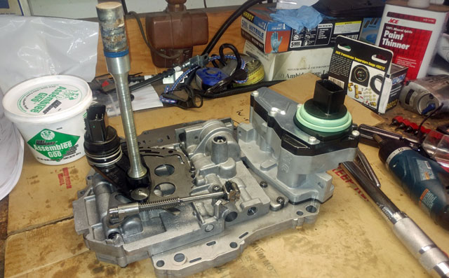

Make sure to also buy a tub of "Assembly Goo" with the green label which is compatible with and dissolvable by ATF. It serves to hold things like the springs/valves in position while the valve body is inserted back up into the transmission.

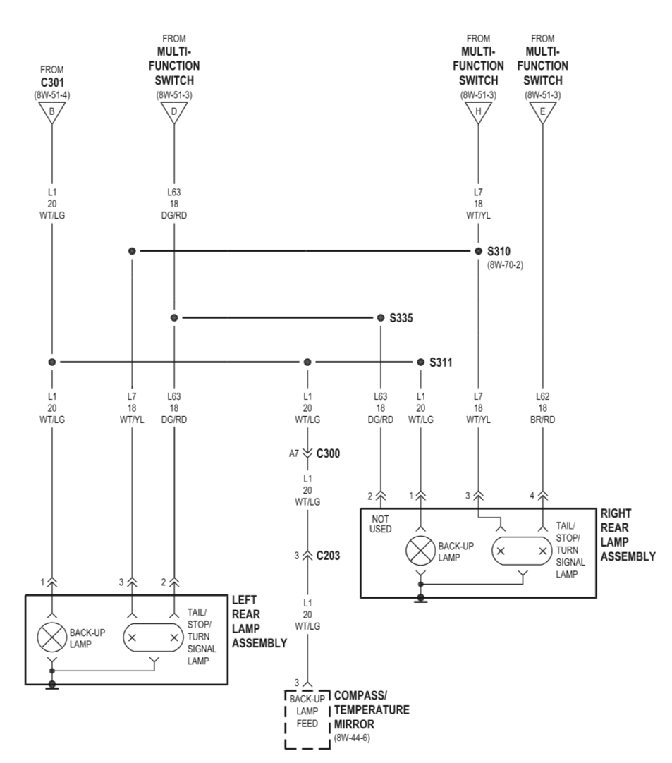

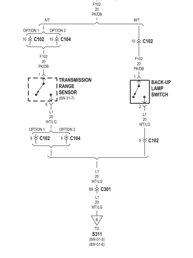

The PCM controls the backup lights on the 42RLE?? Le sigh...
If this is not the case, can you clarify how it works?
My experience is on the 32RH, so it might be different. My sigh was that IF the PCM controls the backup lights its just an unnecessary complication to something, which seems to be something of a guiding principle on the 42RLE.
On the 32RH, the neutral safety does go to the PCM, but only to control whether or not to allow it to start. Another wire goes to the backup lights, w/o the involvement of the PCM. If I have a few minutes, I'll look at the FSM for your jeep.
I just pulled up the FSM for the 05, and it looks like the backup lights don't go through the PCM. 8W-51-1 is where the relevant stuff starts, if you're interested.

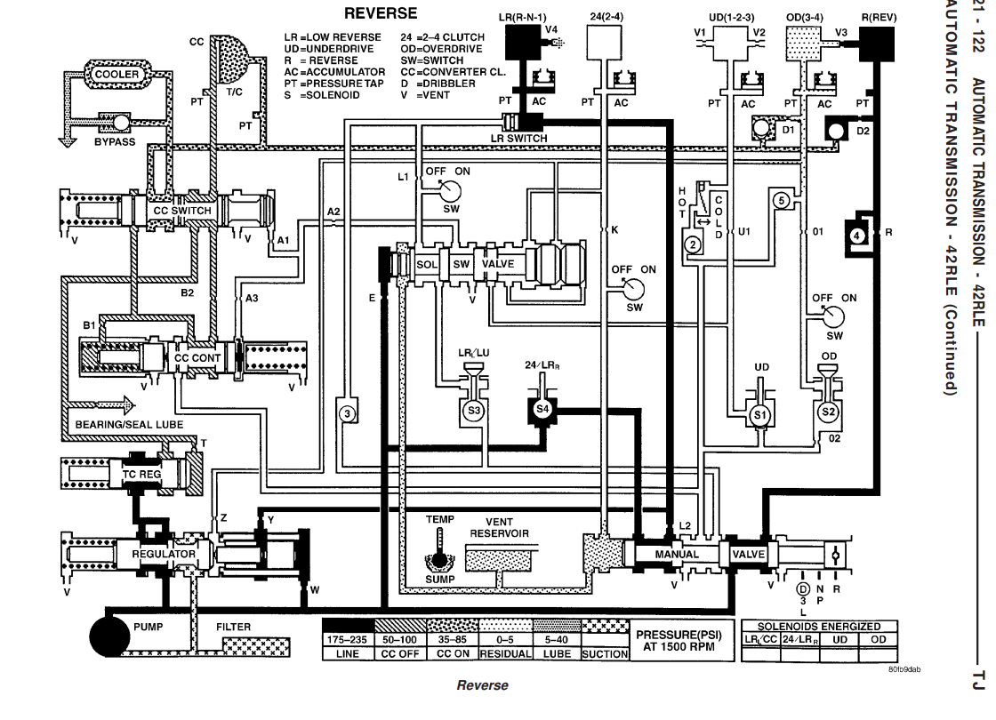

Found the relevant diagram in the https://wranglertjforum.com/attachments/2004-tj-service-manual-pdf.14043/

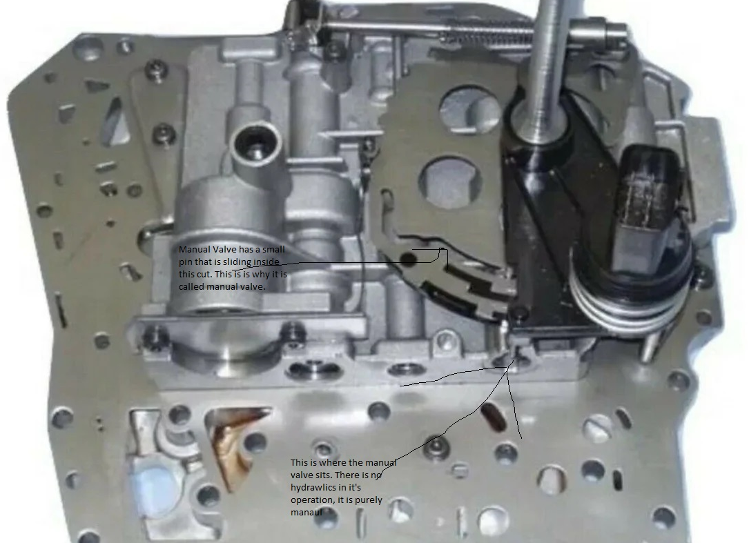

Seems like the R(REV) clutch is controlled by manual valve, which is basically a shaft that is mechanically attached to the shift handle.
As a result, we are left with only 2 variables that impact the reverse:
The solenoids (which are all expected to be in open state according to diagram) and the pressure switches. LR switch is also involved - Both the solenoids and the LR switch will be replaced, as they are contained inside the solenoid pack.
The check balls - i will replace these as well.
Accumulators - I will replace the seals with what comes with Transgo kit. Need to buy this
It could be that the accumulator for LR is not sealed properly, as a result it does not build enough pressure to activate the LR clutch (it needs at least 165PSI up to 230+ PSI).
The seals for valve body (unrelated to accumulators) - will buy Mopar ones.
TRS - Range sensor - never had any issues with it, but will still replace it, just to be on a safe side.

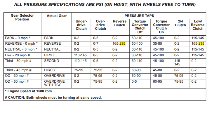

This is the pressure chart. If for some reason, Low/Reverse clutch does not get beyond 165, there will be no reverse.
Taking into account that sometimes it slightly slips in the first gear as well, especially when really hot, it seems to me like a pressure problem.

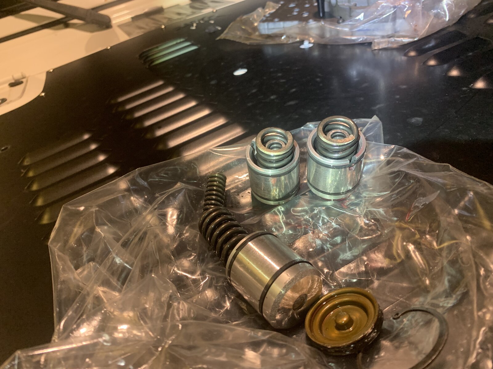

– Sticky LR accumulator seals (Intermittent no drive or reverse) - this can be addressed by me.

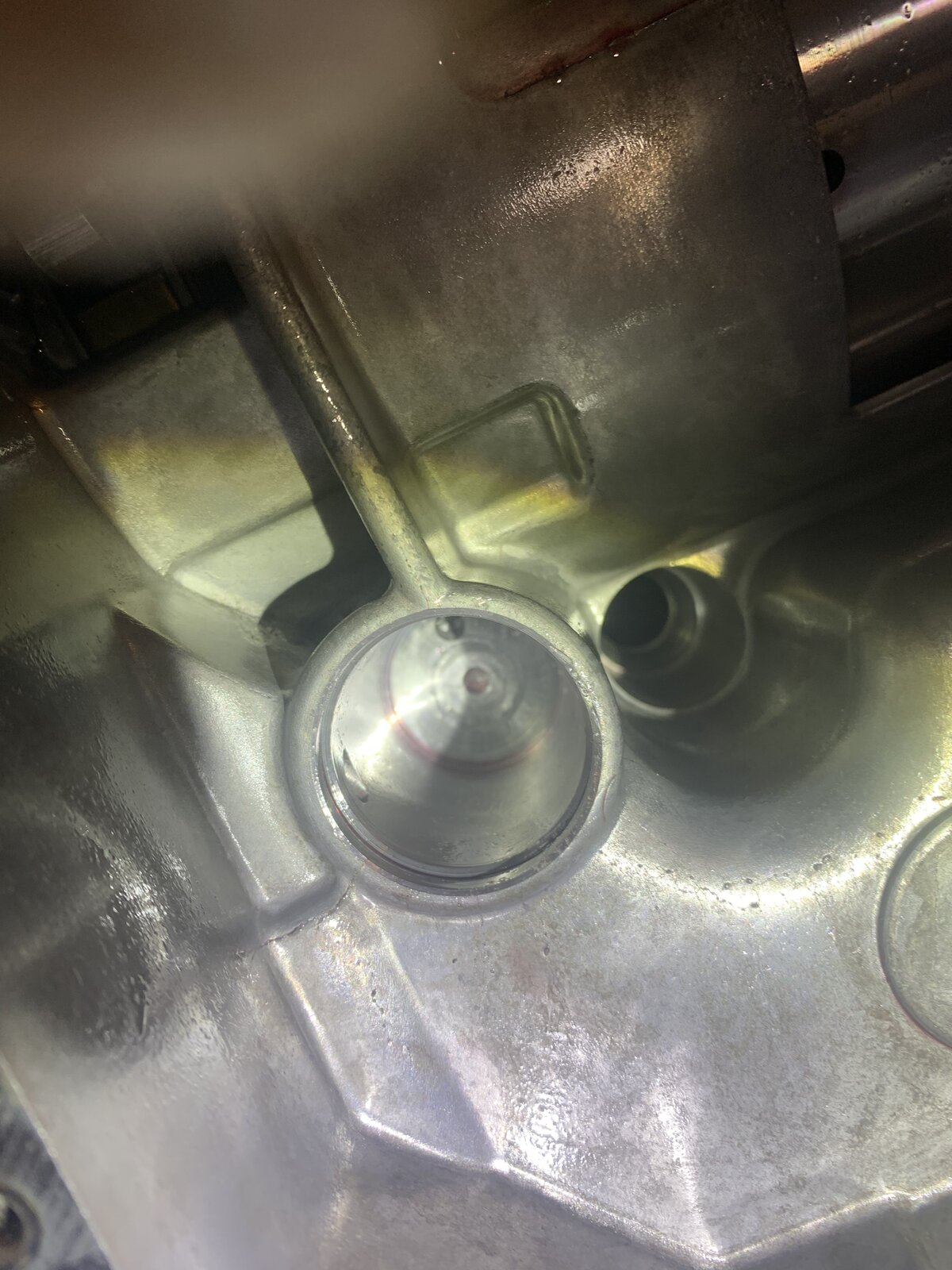

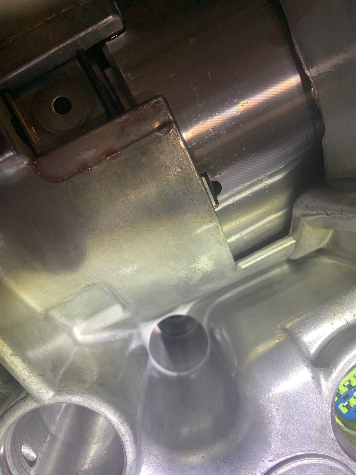

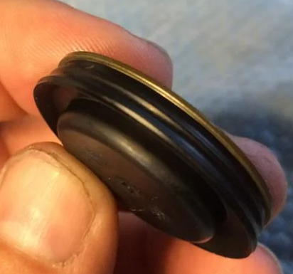

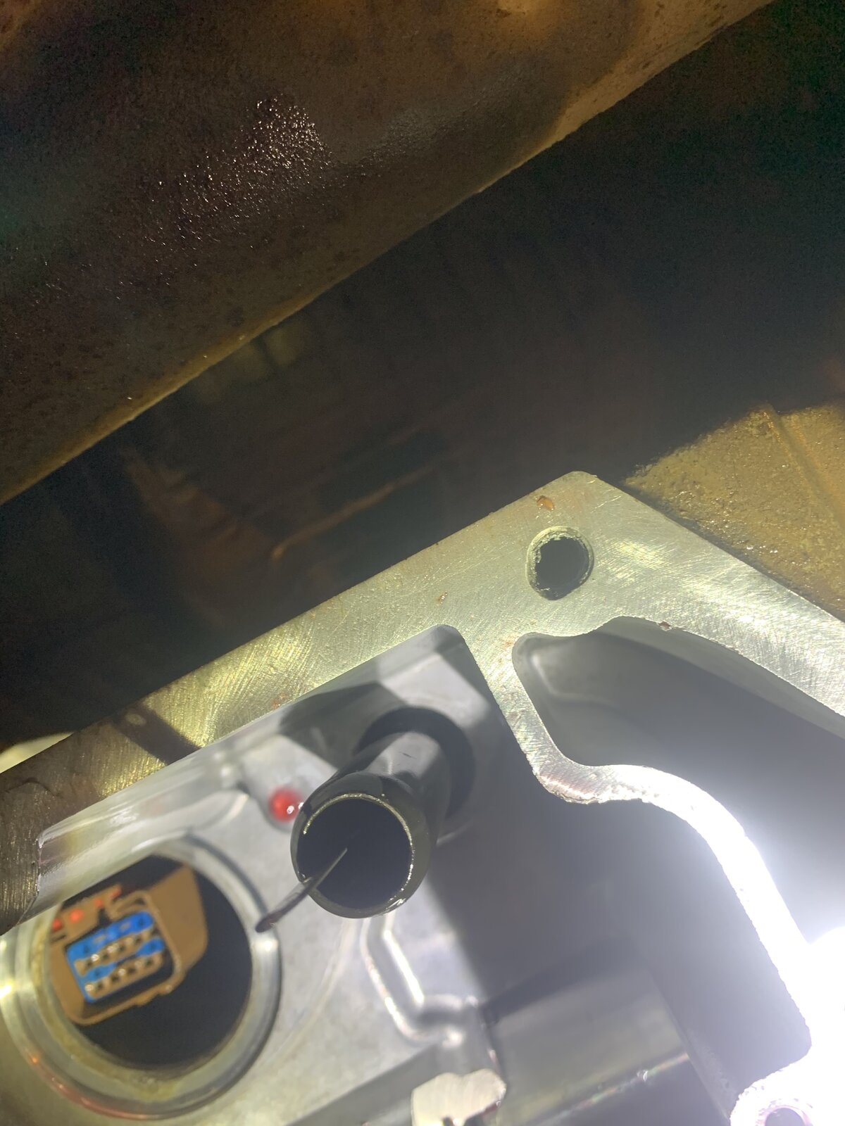

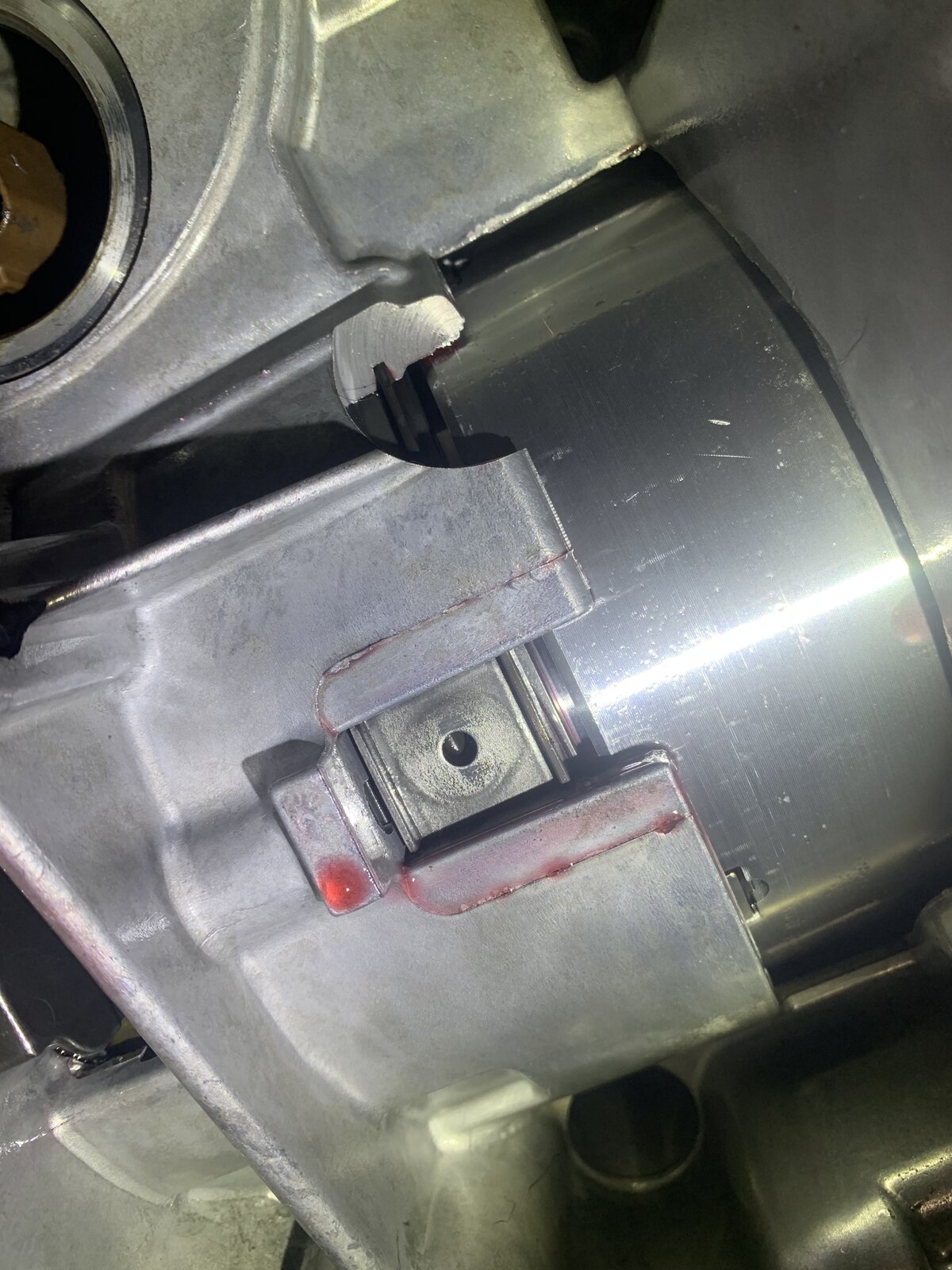

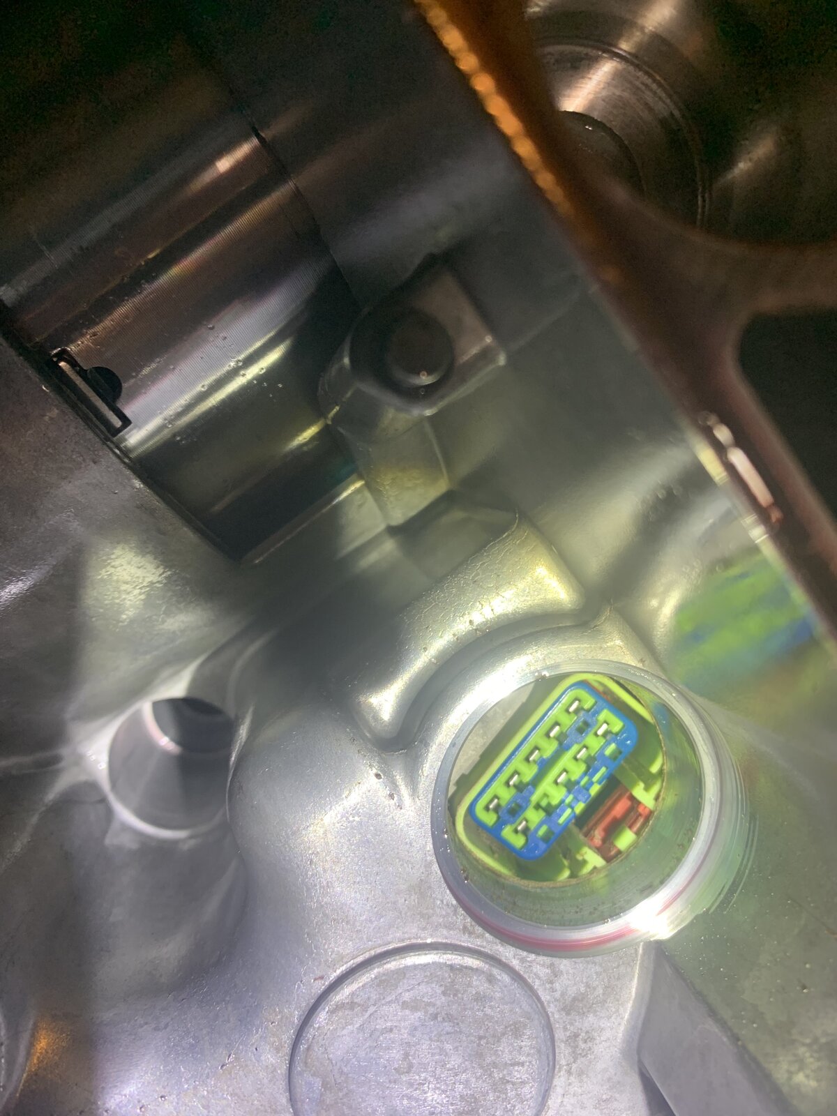

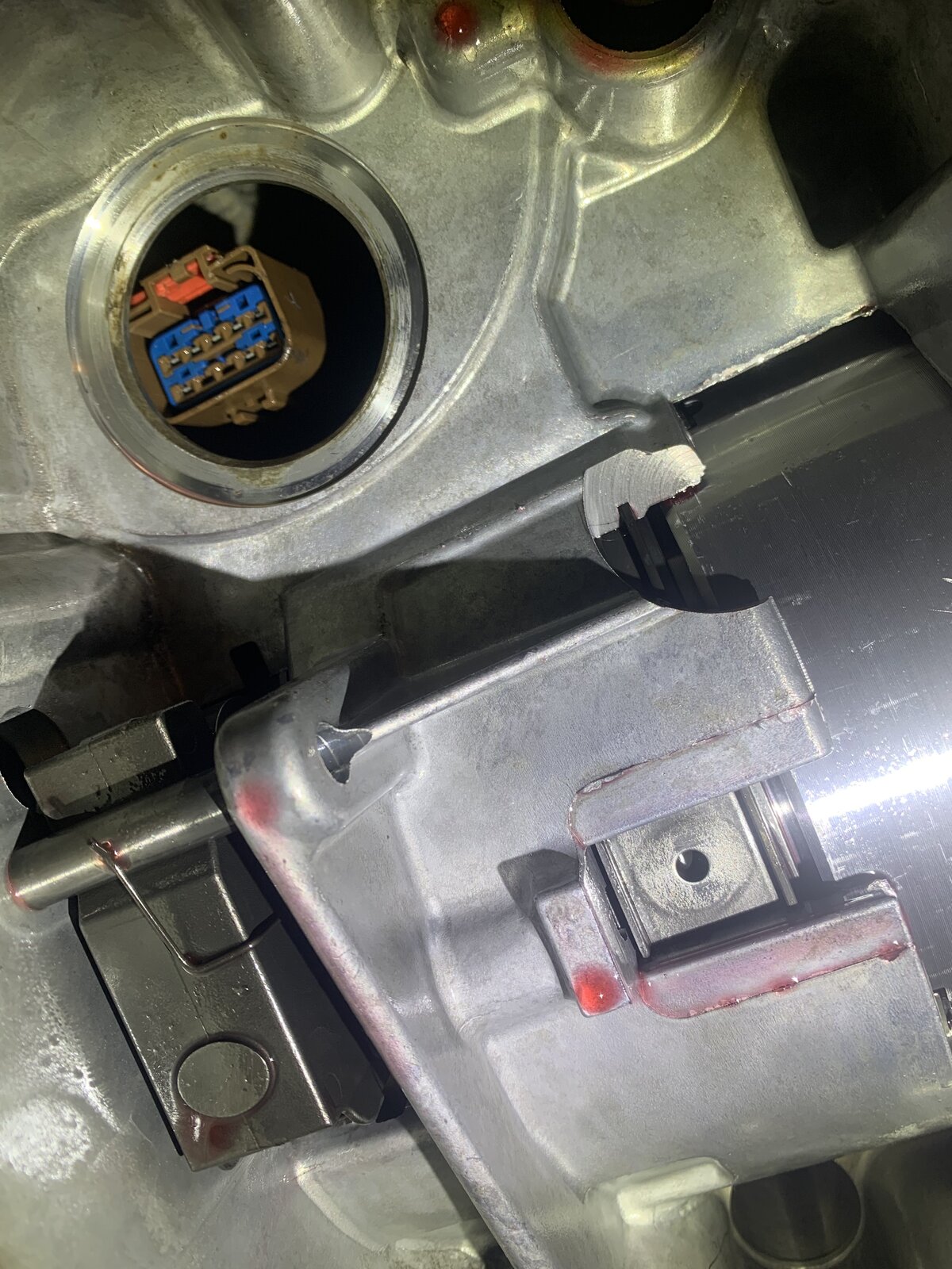

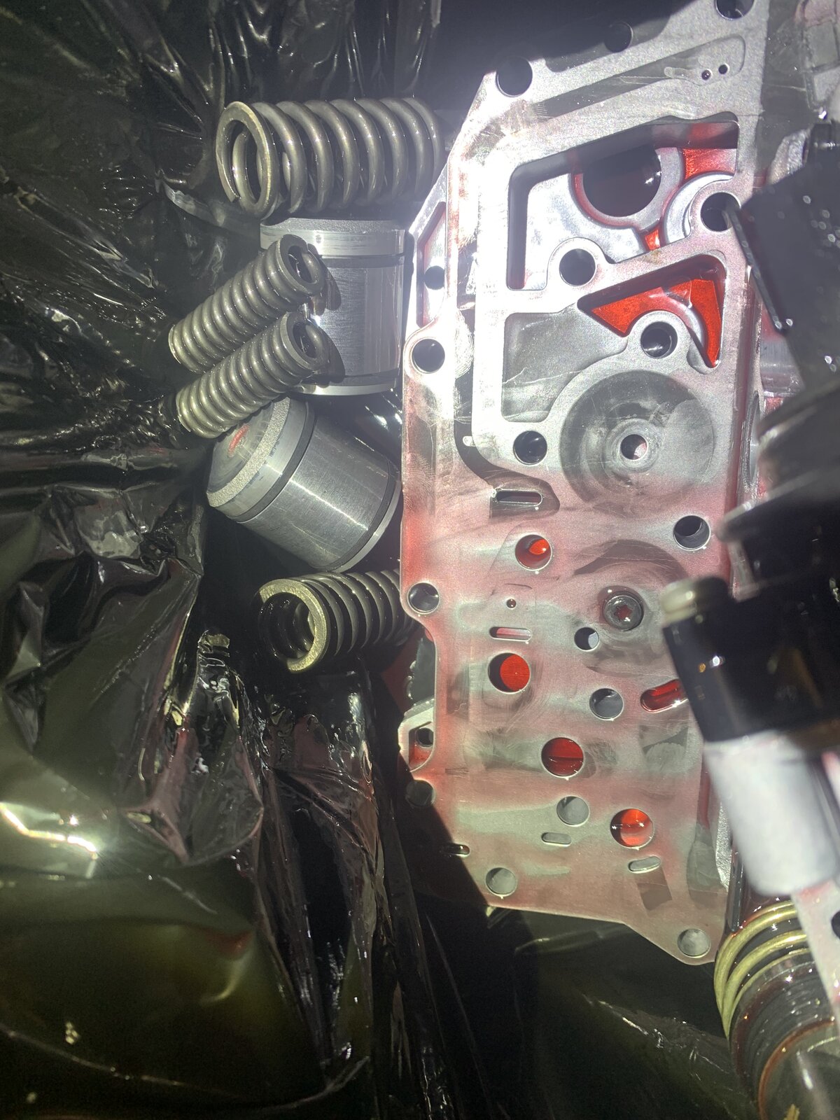

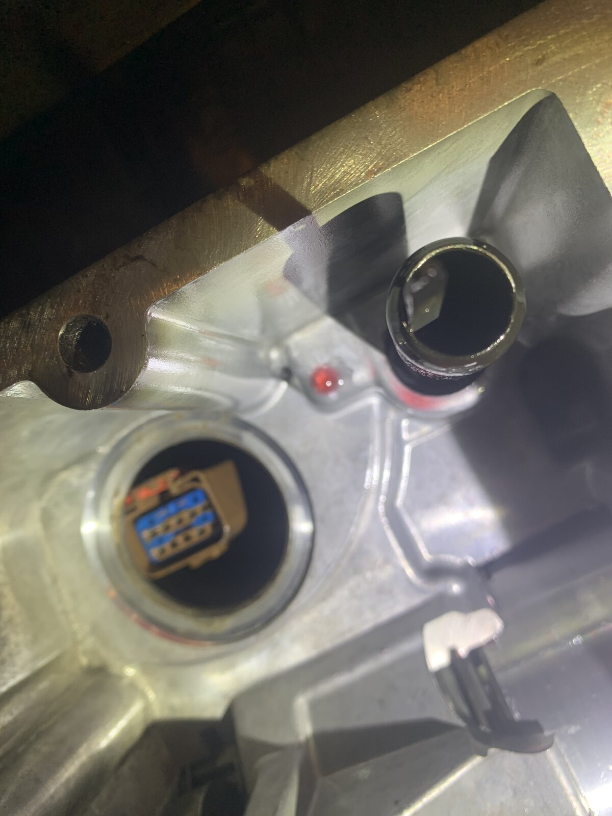

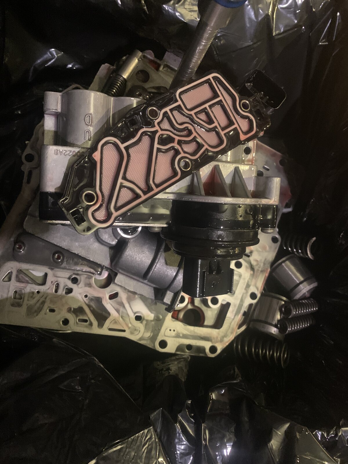

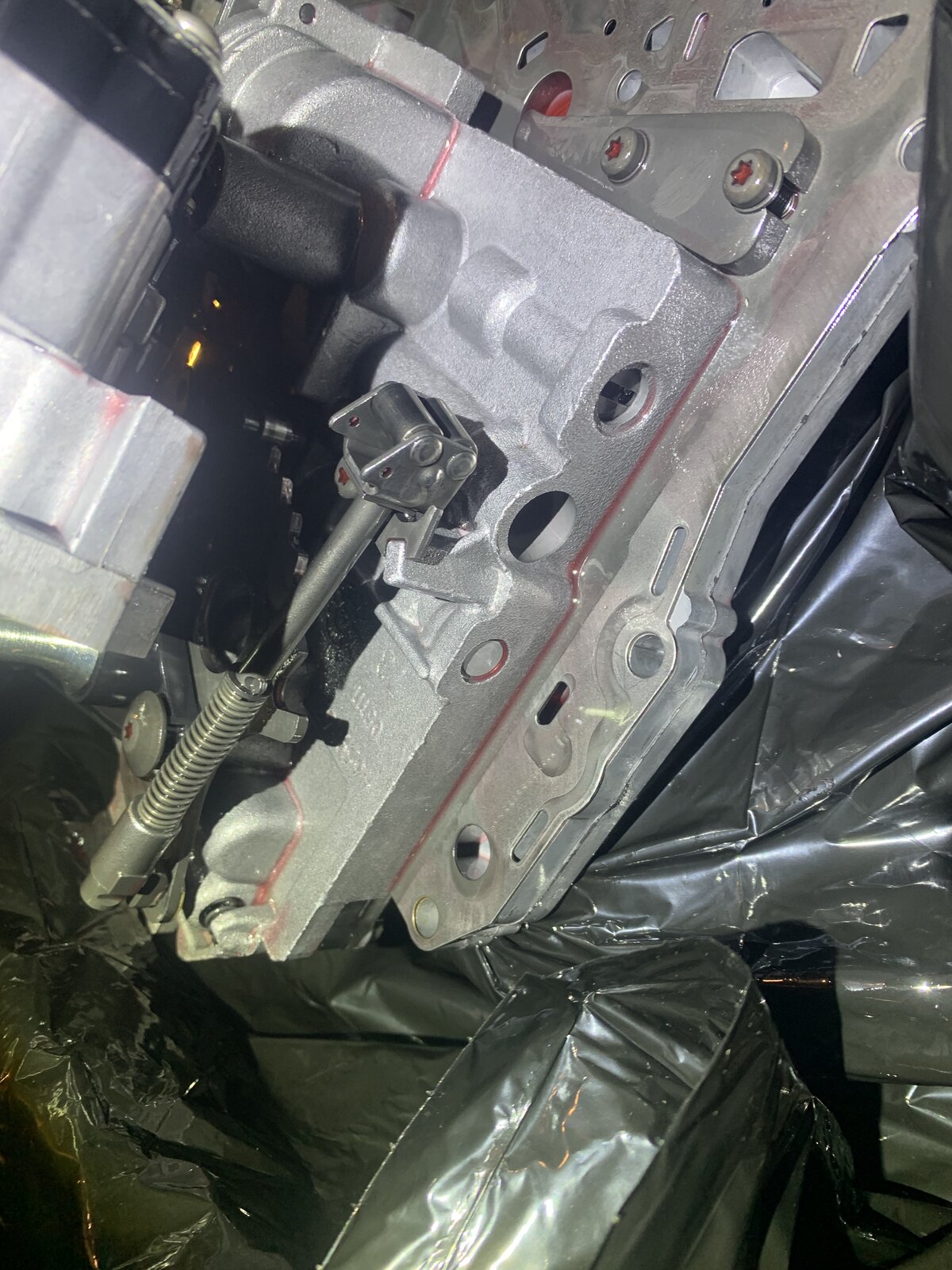

So I have dropped the transmission pan and the valve body. Took a plenty of pics, will make a how to.
Unfortunately all pistons and their seals look completely fine. No any pieces of metal, like broken snap rings, the LR accumulator cover seems perfectly functional. Took the pics of what came out of it.
