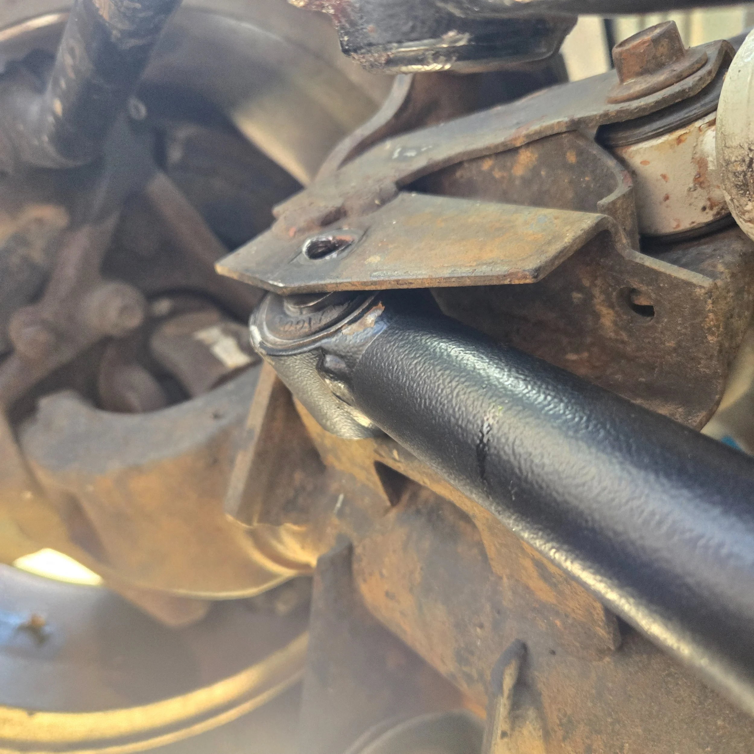

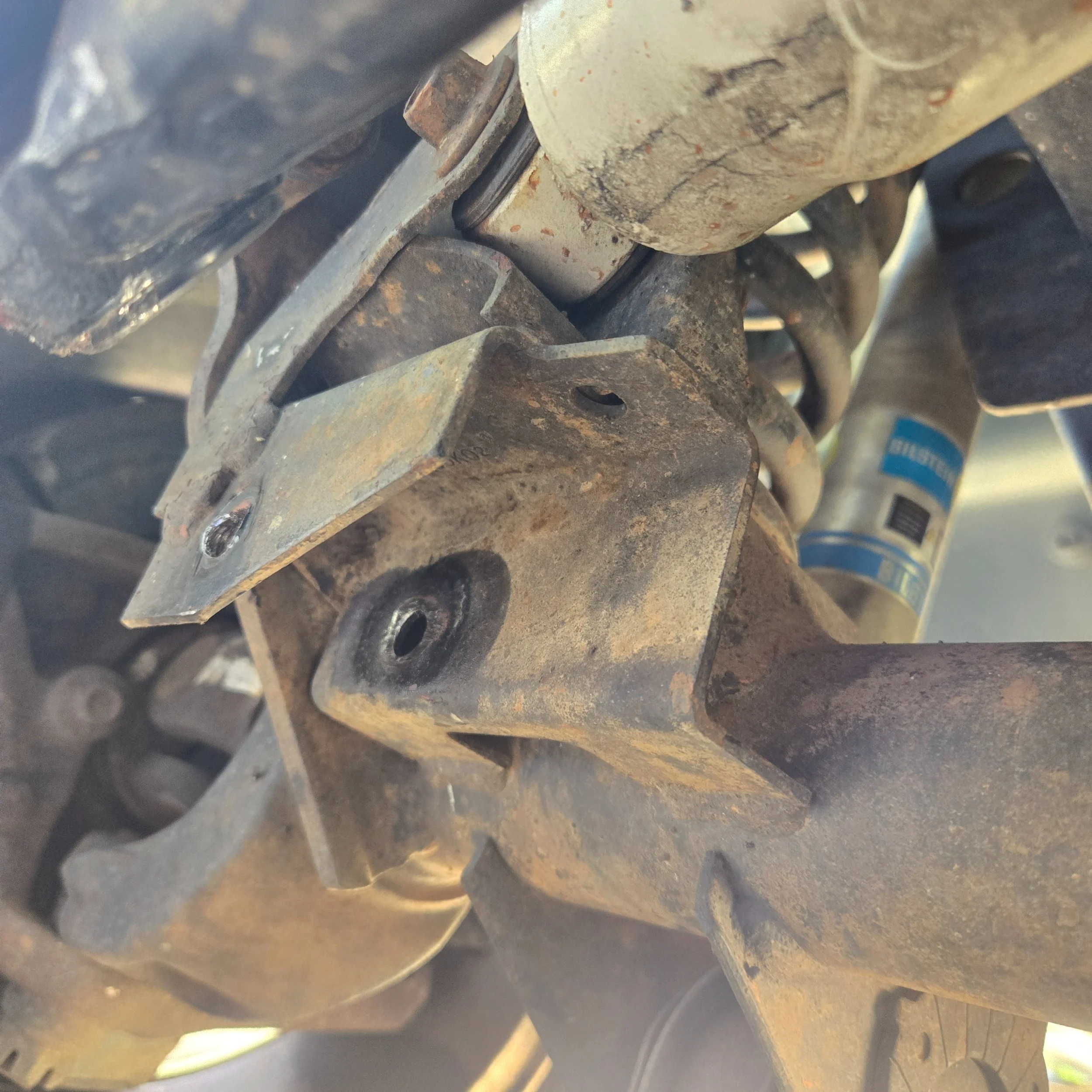

Our grandson 1999 TJ has lost the bolt to the track bar. I'm not where I can see or measure it. Does anyone know the length and size of this bolt?
The bar appears aftermarket, It seems larger in diameter, should not effect the bolt size?
Bolts on the front right side of steering area.
Thanks very much

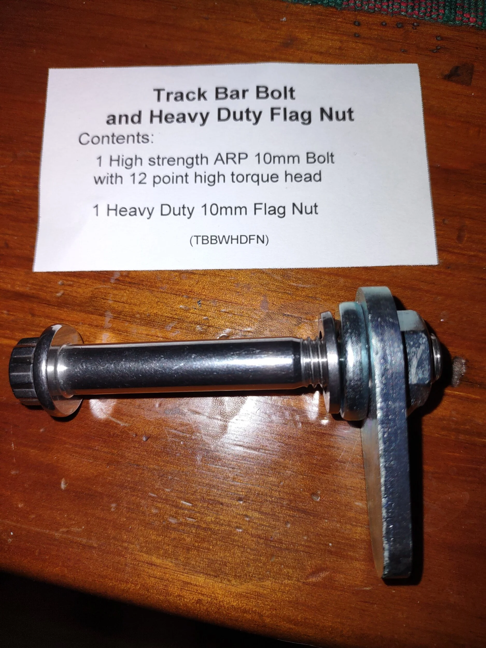

Axle side is M10x1.5x70 10.9 grade I believe. Black Magic Brakes makes a MUCH better one. The other side I don't know. :cool:
M10 x 1.75 x 70 mm
I just threw one in my '02 yesterday, replaced the front track bar, stock, no lift.
This is the axle/passenger side, as the other side is a ball joint into the frame on the driver's side.
FYI, I didn't use a flag nut. There's an access hole on the side that I used a flare wrench to hold onto the nut with as I torqued it down.

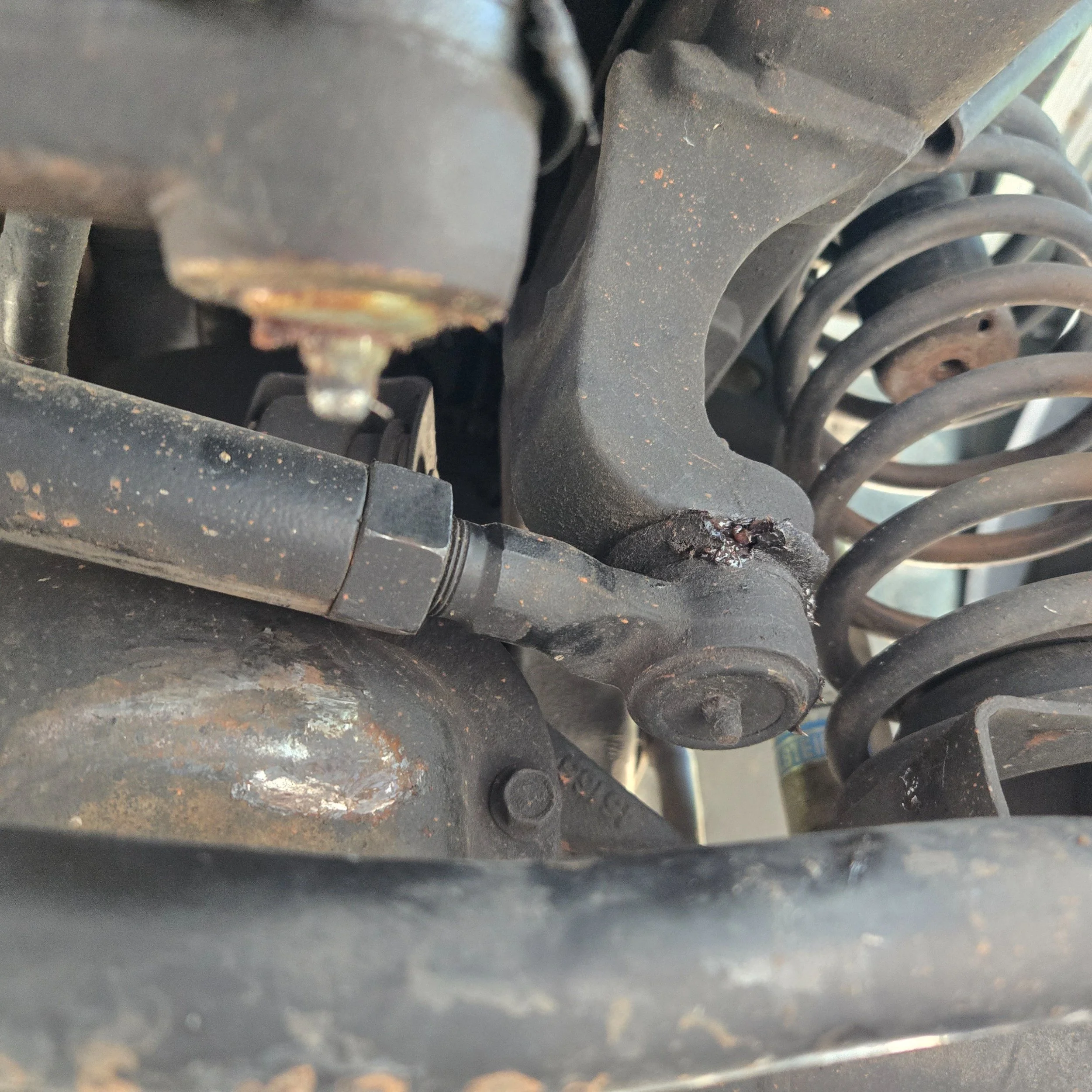

I need to start shopping for front end steering components. Some have been replaced before such as the track bar.
Questions of course.
Why is our track bar not straight?
The bar is newer than the 220k miles the jeep show. The ball joint on on end of the track bar needs to be replaced.
Is the ball joint in the track bar adjustment stock piece?
I see pics on line with the track bar is bolted in on both ends? These are straight bars.
