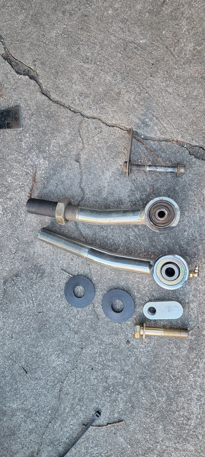

just a quick question since we're here talking about the front track bars. If i remember correctly, you had a MC track bar to begin with at one point, with a 5/8" bolt? I was looking at the currie and thought i read that it uses a 9/16" bolt. did you end up sleeving the frame side mount?
I could be way off an misremembering.
@jjvw
Any new RJ front track bar is going to use a 5/8 bolt on the axle side now that they are using a Johnny Joint there.

I was referring to the frame side bolt that goes into the cast piece. I should've specified.
EDIT: scratch that, I answered my own question. My bad, thanks for the feed back!

Both sides need to be drilled for a larger bolt now.
