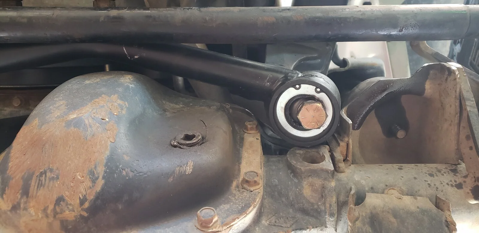

What’s the functional difference? I got the jks, it’s cheaper and causes no interference when I cycle the suspension.
Is the JKS frame side pushed forward at the (not a) Johnny Joint?

Different than mine?

Depends on which one you buy. I'm running the smaller stock size axle bolt in a drilled mount because I wanted the rubber bushing.
TJS track bar uses a 10mm bolt. It can be drilled out to 7/16 but not needed.
TJJ track bar uses a 1/2" bolt but a poly bushing.
Moog k7252 bushing can be installed and uses a 9/16" bolt but does not have a lot of rubber between the sleeve and the barrel.
