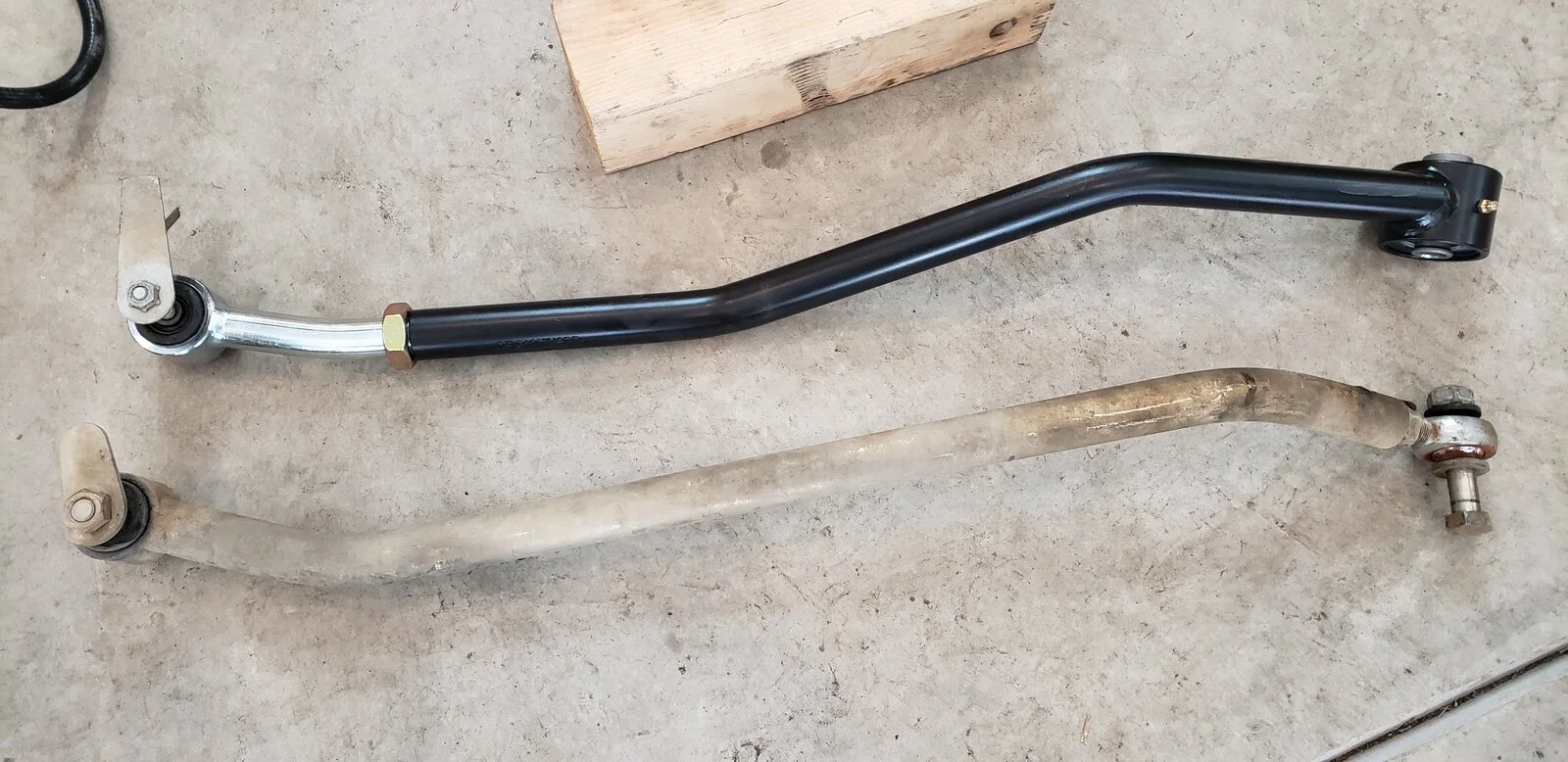

I'll join in on this conversation because I am needing to make some changes in my current track bar as well. So I will add my limited knowledge and experience as well as my questions.
First my setup and observations:
I have a 3" lift with 2" bumpstops. I am currently running a Moog trackbar. My tires line up nearly perfect so I do not need an adjustable bar. However, the bushing is way too soft. If someone turns the steering wheel you can see the bar move about 1/8" as the bushing compresses. This gives a very loose steering feel.
Experience and observations:
When I recently installed my Rancho control arms with the D2 (DDB) bushings, I also installed the Rancho trackbar. The Rancho trackbar is very well built and also has a D2 (DDB) bushing. This is a fantastic feeling trackbar. I did not notice any flex in the bar and the D2 bushing had the perfect firmness. It was firm, but has enough cushion to protect the steering box. I loved this bar except for one thing. It didn't fit. On my Rubi with the Dana 44 and only 2" bumpstop the trackbar hits the diff cover. If you have a Dana 30 or at least 3" of bumpstop I think this would be a great bar. So it might be an option for the OP. But due to hitting the diff cover I can not recommend it for lower lifts. I still have my Rancho trackbar with only a few hundred miles on it. I may be interested in selling it, but I may also keep it to see if I can somehow make it work. Because it really did have a nice tight feel.
Additional observations: (Bushings matter)
So in my experiment, I changed no other suspension components but went from the Moog trackbar to the Rancho and back to Moog. The Moog is a solid bar just like the factory bar. So flex is very limited between both bars. But the bushings are very different. The Moog bushing is very soft and compliant and leaves a wondering steering feel. The Rancho trackbar with the Dual Durometer Bushing (D2) was fantastic. It was firm but had enough give to protect the steering box. Also since the the DDB bushings are designed to swing on the axis it should have a long life and more freedom of movement than a Clevite bushing. I wish Currie would offer a DDB bushing on the axle end, it seems like a perfect fit for the axle side of their bar.
My possible solutions and concerns:
So in my case, I am considering 2 options
1) Pressing out the bushing in the Moog trackbar and replacing it with a DDB or a better Clevite bushing (if I can find one that fits). But this will require a lot of chasing around and if I can't fit a DDB bushing, I might not be any better off with a different rubber bushing.
2) Purchasing a Currie trackbar
My hesitation with purchasing a Currie trackbar is that I have seen how a soft rubber bushing can really give loose steering feel. I hate to spend $400+ and drill out my frame so I can't go back to stock if I have issues.
Please provide any insight others might have.
