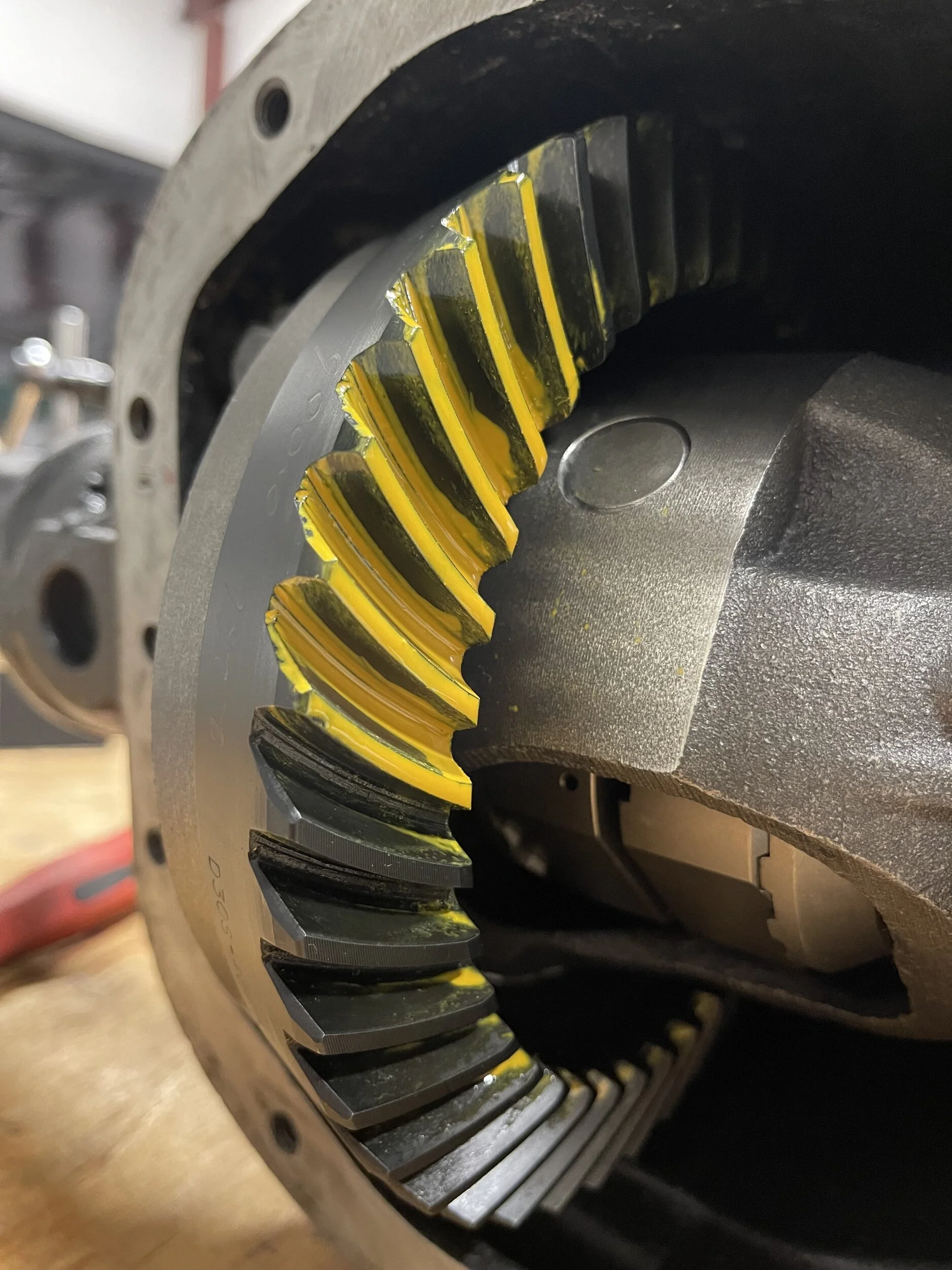

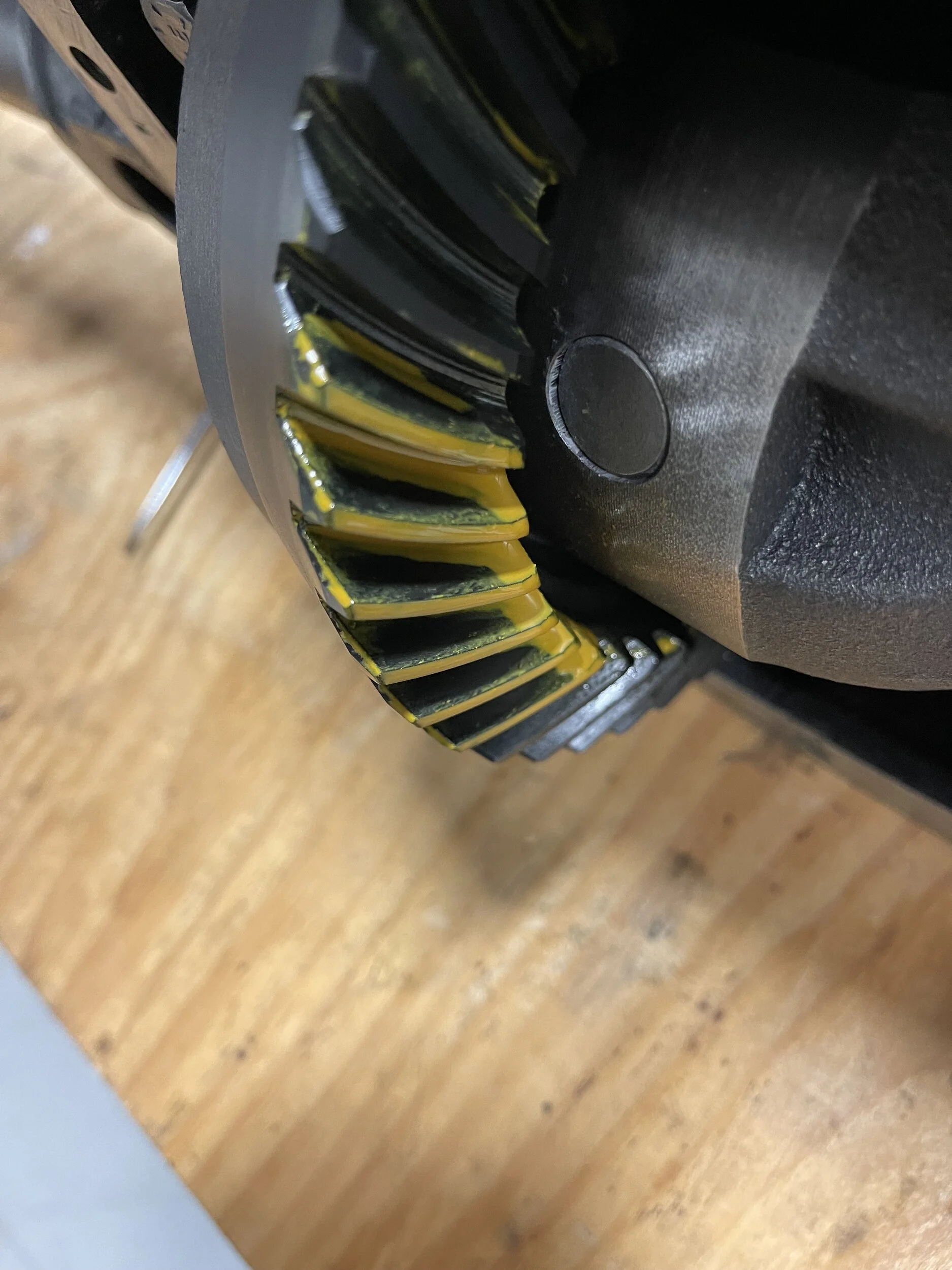

Cajuncrawler Member Original poster Joined Oct 12, 2023 Messages 57 Location Louisiana Dec 23, 2023 #1 Any opinions on this gear pattern? Backlash is right between 8 and 9. For a Dana 30 3.56
hosejockey61 FAFO Supporting Member Ride of the Month Winner Joined Apr 9, 2020 Messages 5,057 Location Parker, CO Dec 23, 2023 #3 Your marking compound is really soupy. Try to put on as little as possible. Contact is good, I just can't tell where the deep end is Reactions: P man
Cajuncrawler Member Original poster Joined Oct 12, 2023 Messages 57 Location Louisiana Dec 23, 2023 #4 hosejockey61 said: Your marking compound is really soupy. Try to put on as little as possible. Contact is good, I just can't tell where the deep end is Click to expand... Thanks Left the shop for tonight. Will try to run another pattern tomorrow
