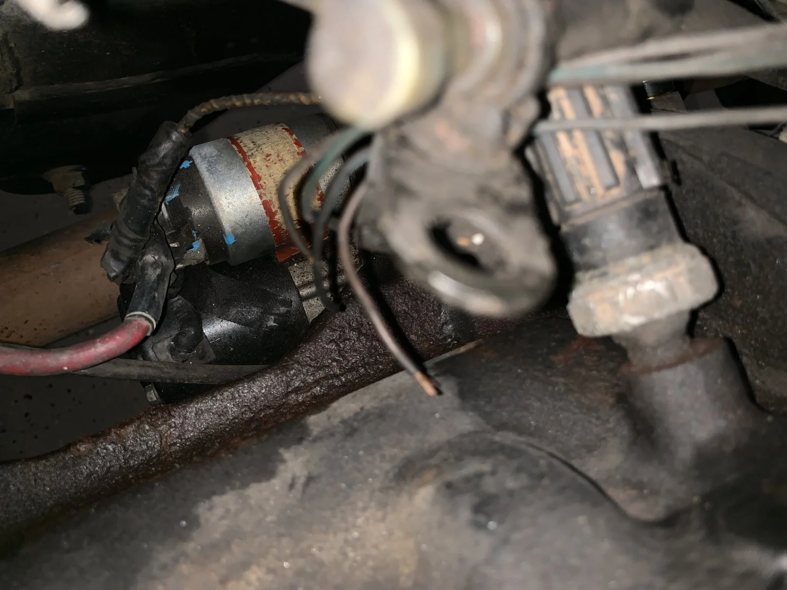

Hey guys/gals I am new to this forum. I bought a 2005 wrangler rubicon couple weeks ago and I am having issues with 02 sensor. Cel came on bank 2 sensor 2. Bought sensor went to change it and the wires are shipped off the sensor. So I found 4 wires coming out of engine harness passenger side I’m assuming they are for that 02 sensor. Bought a 02 pigtail now trying to wire the sensor back in. Jeep has a 4.0 Manuel. The guy who sold it said the engine was swapped with lower mileage one. He didn’t know what year it was. The wire colors coming off the engine harness are. Brown/brown/black with white stripe/green. The NTK sensor has 2 whites. One black. One grey wire. Tried doing some 12v power test and none of the 02 harness from the engine show a constant 12v power. I don’t know if that is normal or not. Check engine only throwing one code. P0058. Any help will be greatly appreciated. Here are some pictures

Hey so the wires were cut off so no pigtail. I did research and the wire pigtail for the bank2 sensor so come off the main harness on the passenger side behind oil filter than it goes over the bell housing to the bank 2 sensor 2. That’s what it should have been. I found 4 wires that were cut on that side so assuming that was suppose to be for the bank2 sensor.

There’s a thread on this forum that has all of the factory service manuals. In the FSM there are complete wiring diagrams for every system in your Jeep that will show you every wire, it’s colors, gauge, connectors, splices, pin numbers, etc. That would be a good place to start.
https://wranglertjforum.com/threads...ice-manuals-fsm-technical-documentation.4618/
Thank you so much man the color chart matched my colors on the harness connected it up cleared code and it CEL has went away and it’s not throwing any codes. Is it normal when you turn the ignition on the check engine light stays on than starts flashing than stays on. If I start the Jeep no CEL on dash appears. And no codes could be read using that Little computer I have
