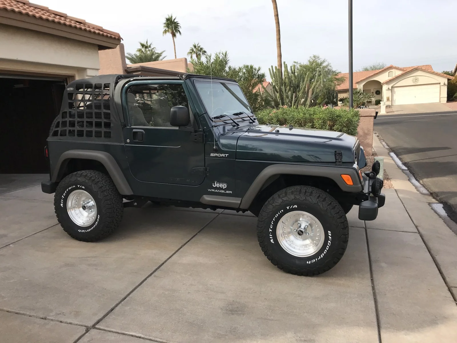

Hello everyone. I could use some help with tire choice. I am new to the Jeep thing and would like to put a new set of tires on my 2005 TJ Sport, It is lifted 2" with the use of Pro Comp coil springs and I just ordered a set of Bilstein 5100's. I am looking at Dick Cepek Fun Country, or BF Goodrich T/A's in 32X11.50X15, I have not owned either, most of my driving will be on road with some trail use. I have been lurking on this site for a while and have read a lot of good information here, any help would be greatly appreciated.

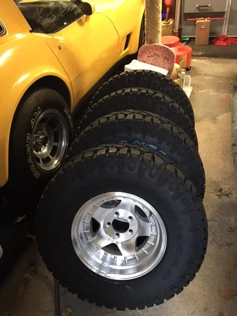

take a look at my new post "look what the big brown truck brought" (actually see pic below) I just got the duratracs...just looks right on a wrangler. But can't go wrong with BFG, do not know much about the DC. I have a Vision brand of the outaws on now and they are nice. went with the American Racing AR23 on the new tires so the knockoffs are going on CL.
Reactions: ac_
81....have had it for almost 19 years, probably have not driven it 3000 miles total, next to it is a 74 TR6 I got last year, I think that is going on the block in spring. Just too big for it and now with the TJ with half doors that will never get driven!
I would like to thank everyone for the information. I am going with BFG's. I will post some pics when I get them. Now I just need to find the best price. Being retired is great Lack of money, not so much.

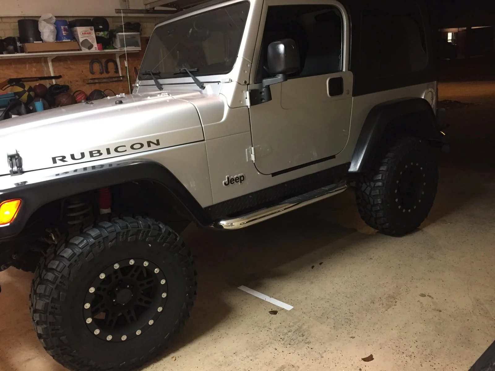

I can’t speak for fun country but I run DC extreme country on my GMC Sierra and at 15,000 they have held up great. I just bought new tires and wheels for my 03 Rubicon and I went with Cooper Discoverer STT Pro 32x11.50x15 and pto comp series 31. My wheel bs is 3.75. I like the DC but wanted to try Cooper out.
