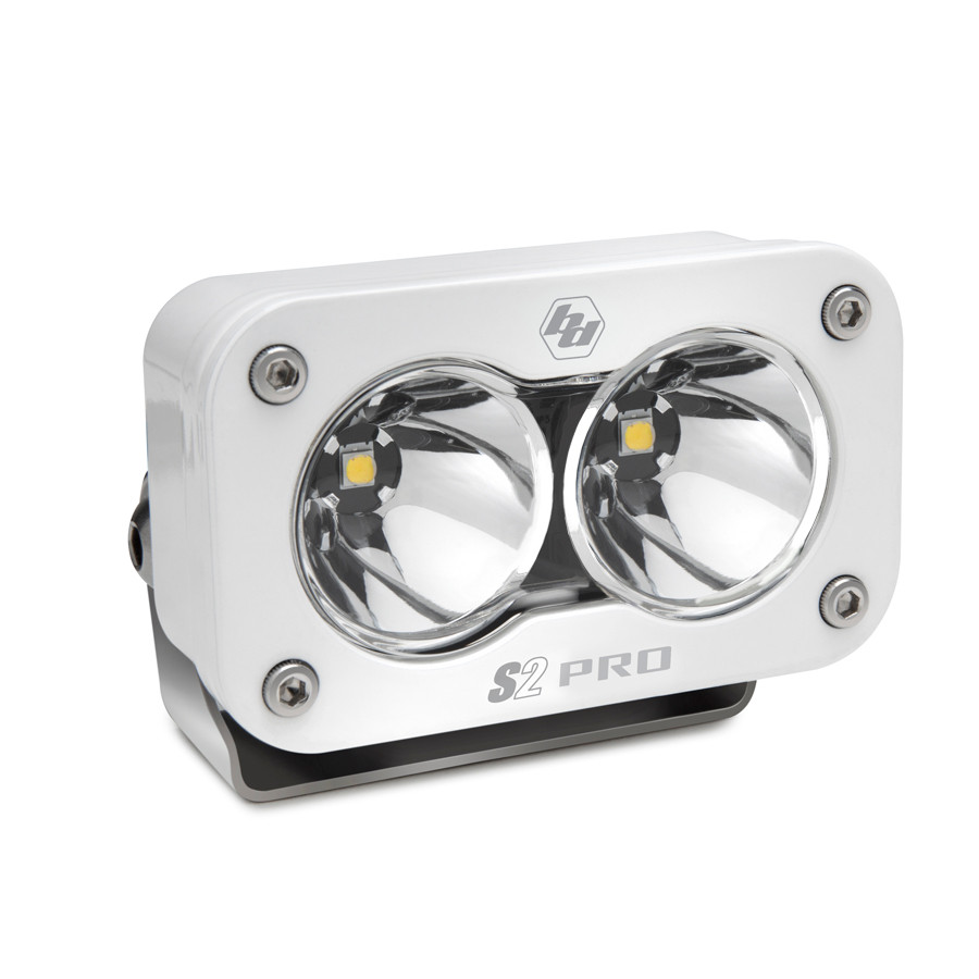

How about these? Way too pricey...but after aquariuming enough Amazon lights I've probably paid for a pair.
https://www.bajadesigns.com/white-led-off-road-lights-s2-pro/
-Mac

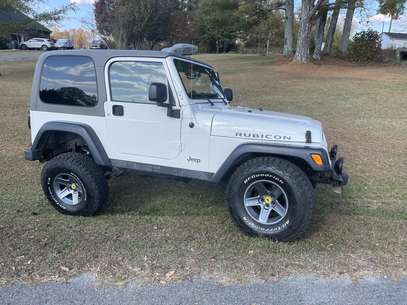

It has a 2” OME lift , Clayton Girro Arms, JKS links, ZJ Tie Rod, meatier sway bar bolt, johnny joints and currie mount at the front axle, ome stabilizer, adjustable track bars, all new sway bar bushings, chromoly rear axles, exogate, Bartacts with the Rubicon logo, bedtred in the rear- next it gets a slight tuck and ucf skid, savvy shift cable, aluminum winch plate painted to match the wheels, hawse fairlead then whatever aux lights- I’d like to dash mount a gps and run a back up camera to it. Heated seats need to happen.
It drives soooo good, the steering feels near rack and pinion. Rode a tad stiff, but has gotten better as the weight went up, the winch should make it just right.
The genrights were sort of an impulse buy (but honestly I love @Plumber1 s awesome white Rubi ) and now they are painted I’m pretty sure I want to put them on it vs. my 03.
2nd had the rack off for coating. I was dialing in my bump stops.
Lower was soon after I got it.
The jeep fits me like a denim jacket.

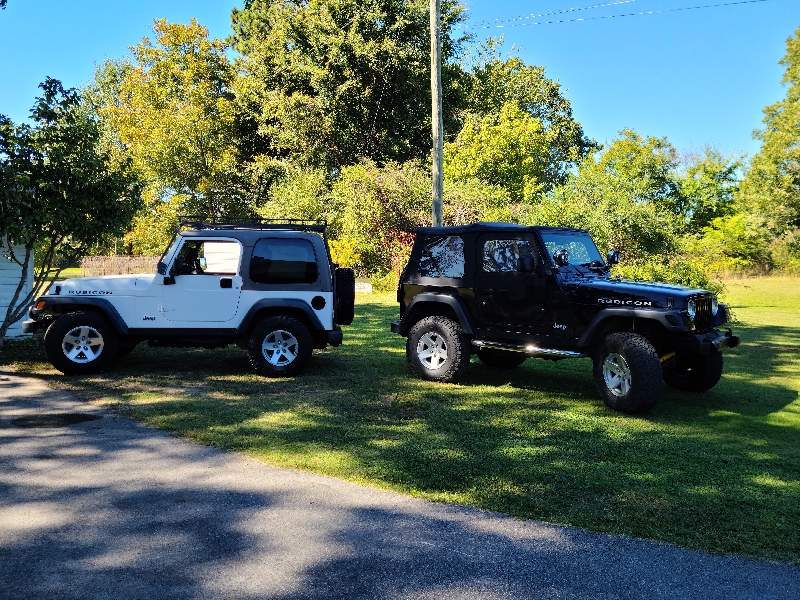

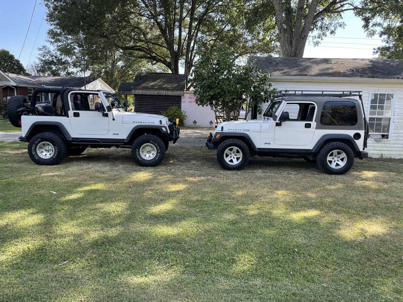

This has been a mystery in the making, it has come a long way since I first saw it when picking up BB that Saturday morning. @AndyG has thrown us a few text messages with some pictures, but nothing like it looks now.
The first day I saw Vanilla Ice!
@AndyG stole your fake Pintler wheels. Why? Confront him

well those Aux beams are 4” but I don’t know about the white…. A little harder to source but would the OP be willing to go the full Monty and paint the rack white So it all blends in? :unsure:

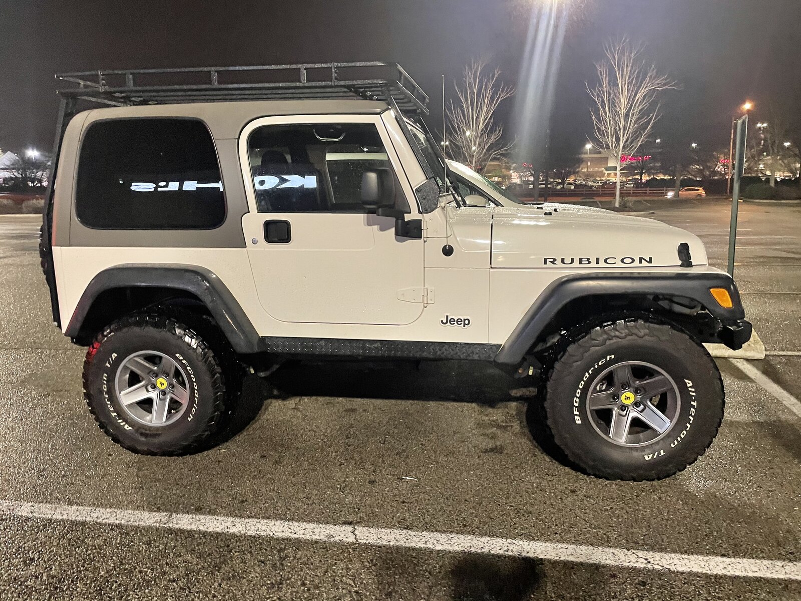

Could do something like this with lights. This is a rack I built for a customer. I don't recall the dimensions' but I would guess around 3" tall.
What ever you end up doing, the lights need to be behind the top of the windshield line or have something along the bottom to keep the light off the windshield. If ya don't do that the lights are unusable with a dusty windshield.
