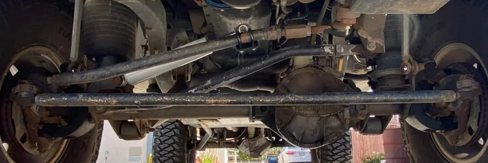

Looks like a pretty good start to me — solid and an LJR with low miles, although, like they say with race cars, "only 71K miles, 1/4 mile at a time." Could have a lot of hours on the engine and tranny. Check those out and plan on spending a chunk of change personalizing for your intended use. But starting with a clean base you are 100% ahead than a lot of Jeeps I see offered for sale for a much higher prices.

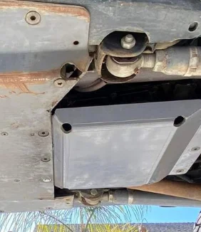

Just some additional observation after looking at the pictures more. The front control arms have been modified by someone replacing the gyro joint with what looks to be a JJ.
So if you go to look at it look to see what was done with the rear lower control arm mounts. Be curious to know if it's still using gyro joints or JJ there also.
And it's got the Nth Degree diff skids on both axles.
I'd also look real closely at the steering. It appears to be some type of heim joint steering.

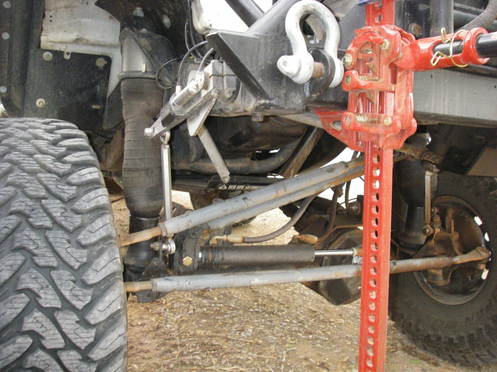

Some of the pluses with the AiRock system is that when loading your rig for a family weekend out and about it will always sit level no matter if you've got 100 lbs of gear or 400 lbs of gear in the back. The height sensors tell the computer to level it to the preset height and it does this by increasing or decreasing the amount of air in the air springs. Driving on a twisty road? The active suspension will compensate for this as you go around corners.
Or towing a adventure trailer? The suspension will self level for that also. And with the SwayLoc being integrated into the system it will unlock when off-road and lock when on road.
I have the AiRock system on my TJ and...
I've torn 2 air springs but both were my fault and nothing to do with the product.

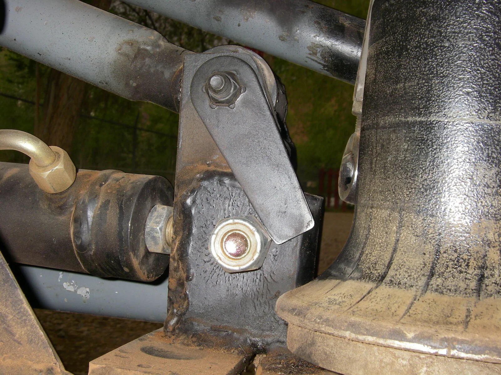

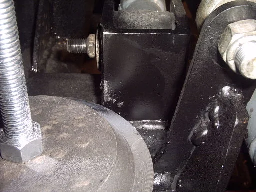

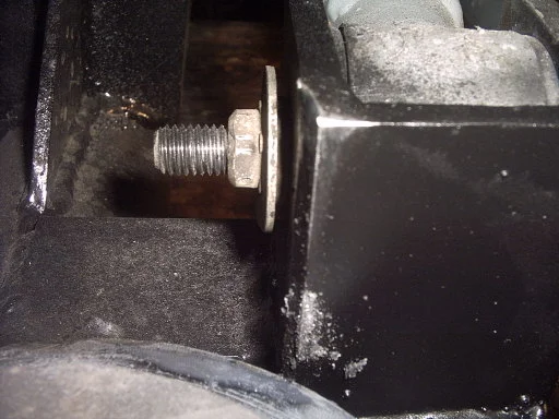

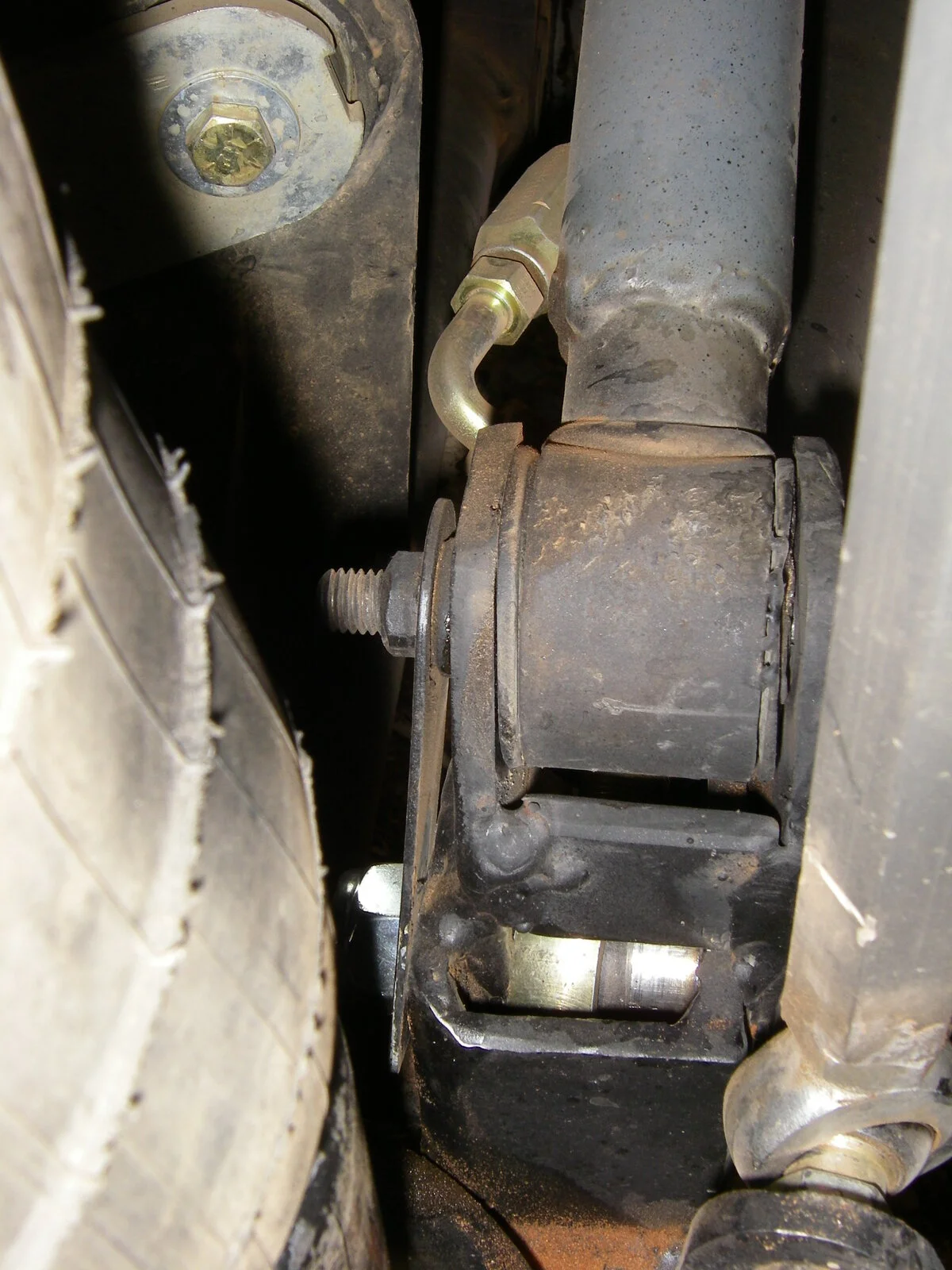

1st time was when I first got the Jeep running after the first V-8 swap and had made a trackbar mount on the axle side but hadn't rounded the edges of the mount.
Drove it down the road about 1/2 mile & had come back to the garage.
Sits right near the spring pad.
Next time was in Moab 2007 and I'd redone some work on the mount and was using a flag nut but hadn't set it in the correct direction so it couldn't spin....
Was out bombing down a dirt road when I noticed my compressor running all the time. Stopped to find it smoking from running so long. Had to cap off the line going to that air spring and limp back to camp. Luckily there was another person in camp who had the AiRock and had a spare bag. So Steve from ORO set it up for me to get his & then I paid for another one and it was shipped to the other owner.
Here is the back side of the flag nut and the bag next to it. The bolt had spun and the flag just sliced right thru the bag.
