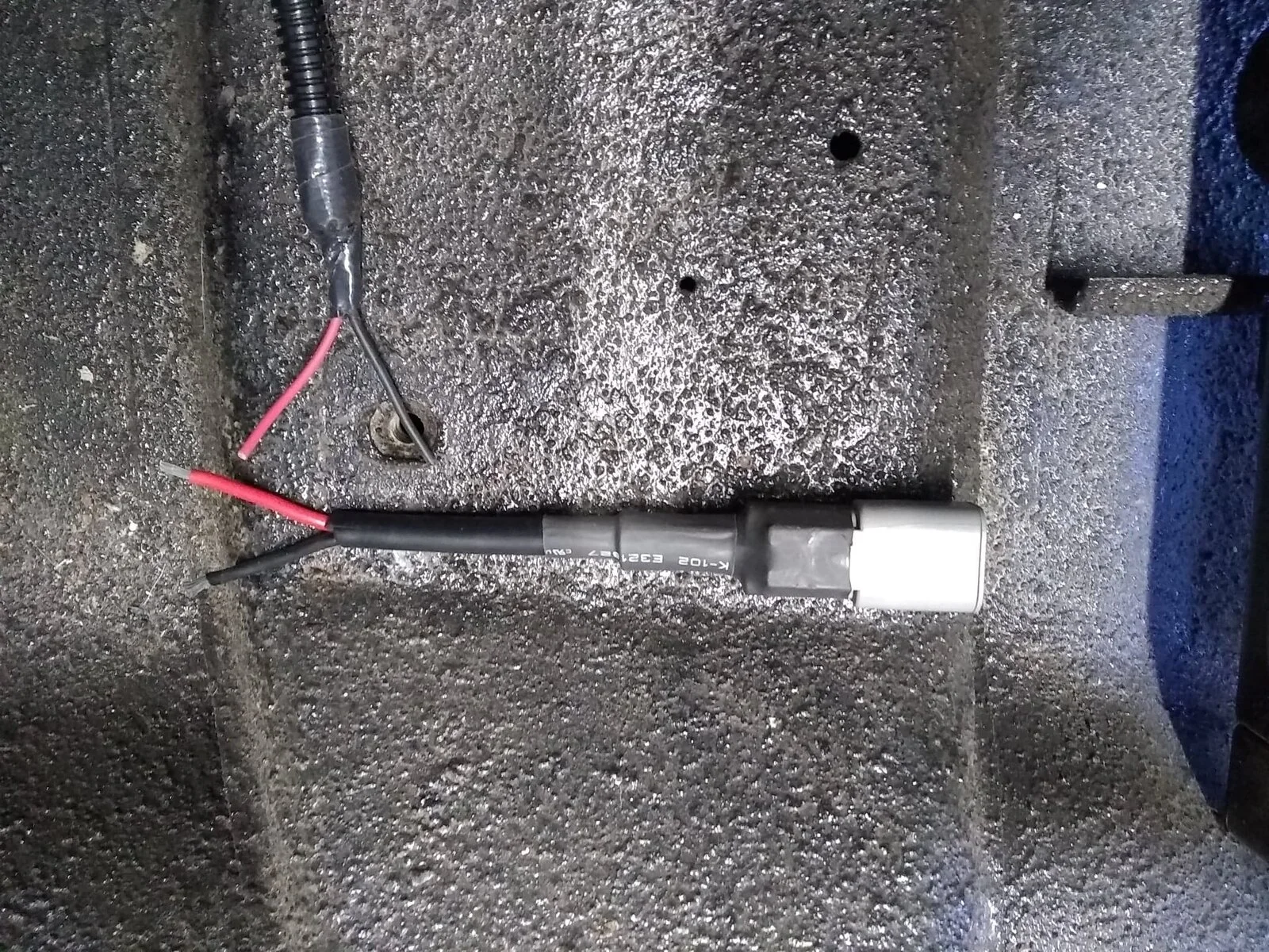

or looking at what i have (the harness) it's run pretty much like the schematic. what i have is the wires from the relay and they have a corresponding pigtail to connect the locker wires with.
this is no simple plug it's gotta be a device like this, no? this thing is capable of handling a 300W lamp, 8W won't even tickle it.
and this would/should be this suppression device , no?
i did look up about every dam site that listed this Hella harness but they all have the same stock description, and do not specifically mention a diode or suppression device.

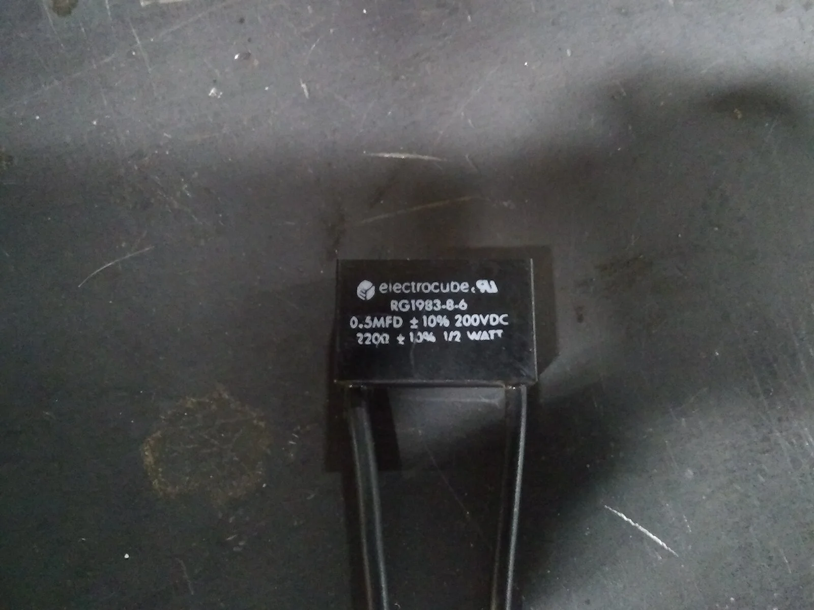

This is what the electrician gave said it was the same thing.

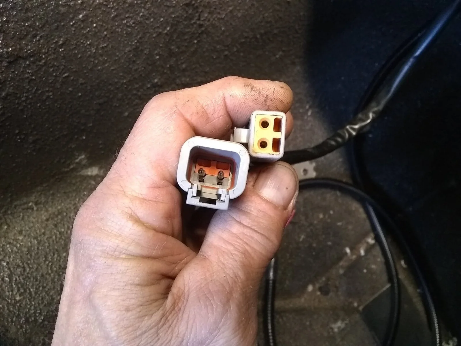

i took the plug end in and let him see that and he agreed it's just a fancy plug, neither of us could figure why they made it .
so elaborate for a simple connection.
he looked at my drawing , then he found an Eaton drawing.
and dug up the Delphi/GM 12110147 and got info and drawings on that.
then he looked at the relays, so he could be sure. and when i asked him if this is a diode he said, kinda but more than just that.
this is the description he gave me (pic).
and a link to this thing, but it's all mumbo jumbo to me. looks like it handles "noise" and peaks to me. but again to technical for my melon.
https://www.galco.com/techdoc/elcu/rg1986-8-6_app.pdf
i do appreciate the help, but feel i'm stuck on a he said he said teeter.
The connector is Deutsch commonly used as an alternative to Weatherpack in industrial applications. I am sure that suppressor will work fine it just has more going on than just being a diode. With the issues I have had with Eaton in the past I try to not deviate much from what they have used in the past like that GM diode.
