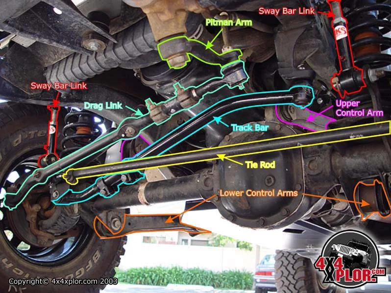

Here's essentially how the track bar moves the axle to the side as the suspension height increase. Look at the letter Z. The bottom of the Z represents the axle, the top line represents the frame. The horizontal line is the track bar and it serves to center the axle left-to-right under the Jeep. Lifting the top line, the frame, via a suspension lift, will as you can see pull the lower line (axle) over.
This photo of the front suspension shows the track bar. Note the track bar in the photo is actually that of an aftermarket trackbar with an adjustment sleeve on its left side used to adjust its length. The factory track bar length has a fixed length without the adjustment sleeve shown below. The sleeve is the short length with bolts at both ends to lock its adjustment in place.
Also note the Pitman arm, leave the factory Pitman arm as mentioned above. Hope this helped a bit. :)
