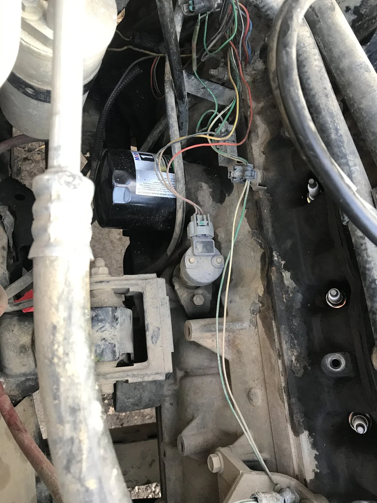

Ive exposed most of the wires between the camshaft sensor and pcm and the crankshaft sensor and the pcm but didn’t find anything. I’m going to test the rail again then take her in for a battery and alternator test. If those are all good, I’ll grab the new parts.

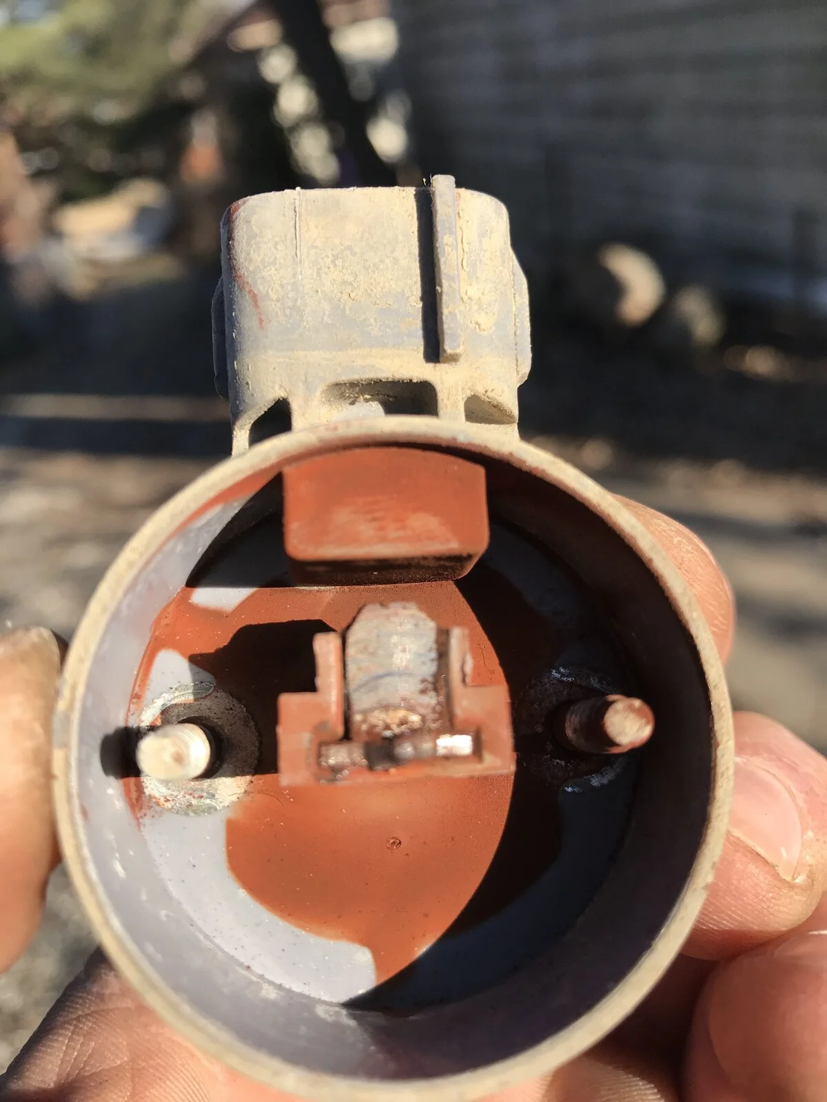

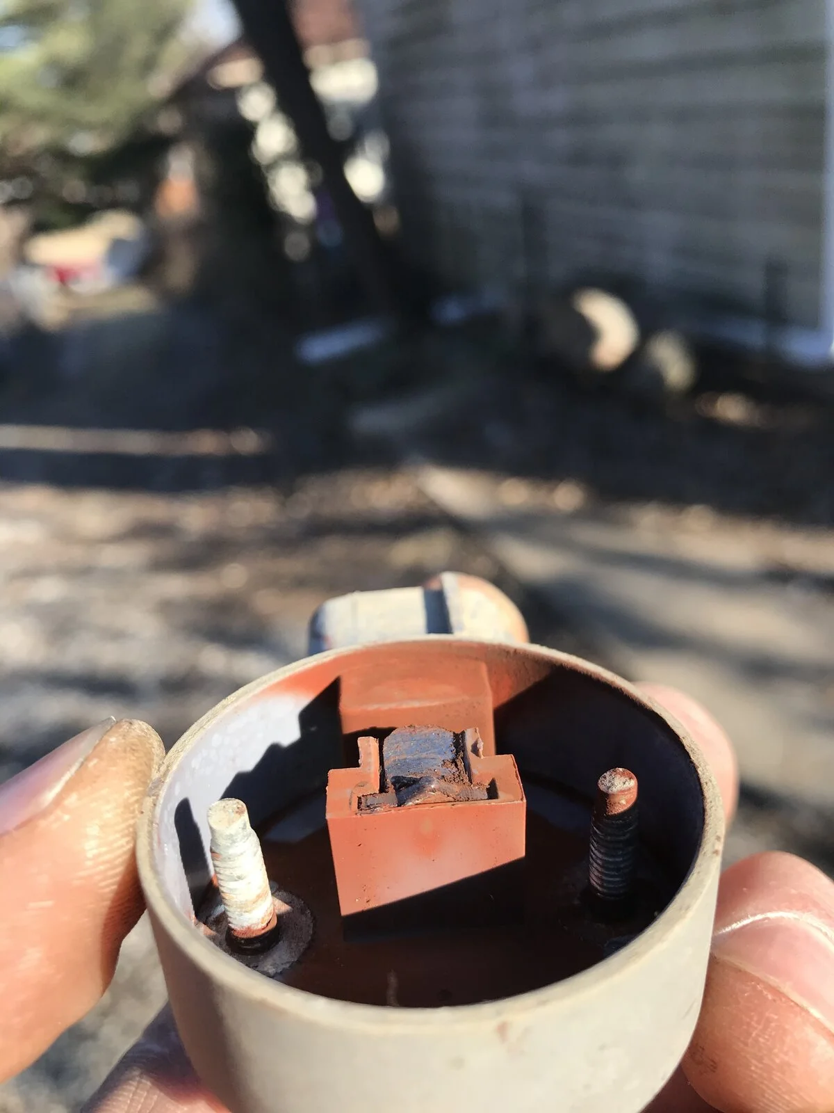

I ran to the store today to rent the tools for a compression test and picked up a noid light kit too while I was at it. When I ran the codes again all that was showing was P0340 which is the camshaft sensor. Luckily I have an old aftermarket one that I never installed when I switched out the oil pump synchronizer. When I removed it I saw this...
Suffice to say it’s not supposed to look like that. It seems the magnet came loose and kept getting worn down by the rotating synchronizer. I’ve replaced it and not had an issue or a code pop up yet but only time will tell. Especially considering this was the crown camshaft position sensor...
