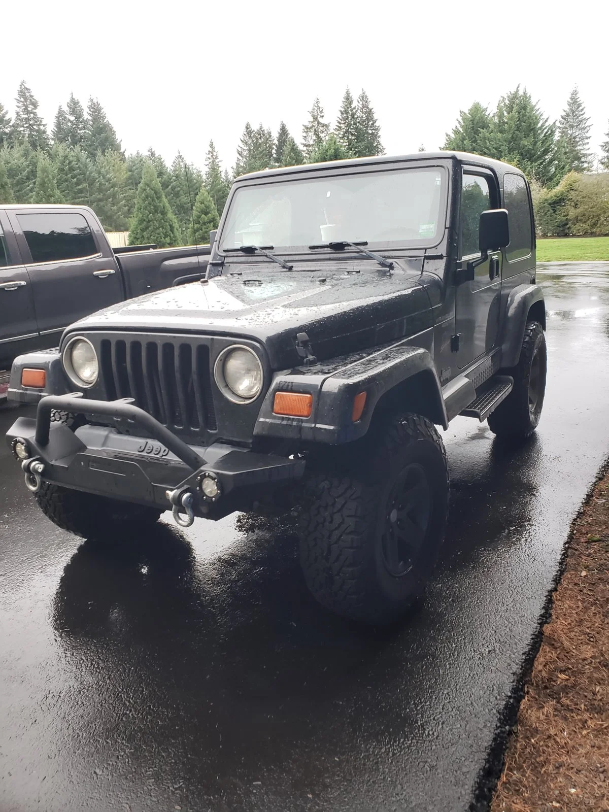

Not sure if this is the look your going for but I running the 2.5" OME suspension lift, then a 1.25" JKS body lift, and 33s.

Now I’m looking to put some beefier tires on, maybe a lift, brush guard, locker, and a few small things like oh shit handles and what not.
I really don’t want to go overboard as this is my daily driver as well, but I would like some tasteful upgrades. But I don’t know where to begin. Pics below and thanks for any info and suggestions. As for budget, it’s similar to my idea for the Jeep itself. I don’t want to break the bank but I don’t want to go cheap either. Thanks.
My advice is to get a nice set of 31" tires and make sure you have a compressor to keep them at the correct pressure when you hit the trail. I think a lift is really just there to make the tires fit and 31s will fit without a problem. I've run that size for over 100,000 miles on my current Jeep. Some people get caught up with tire sizes and lift heights instead of investing in a locker and I think that's a mistake. See where a good set of all terrain tires like the General Grabber ATX or the BFG KO2, set at the right pressure, take you. I know some people do things for looks or stance but I think keeping it as close to stock as possible makes for a good daily driver, higher resale and fewer headaches in the long run.
