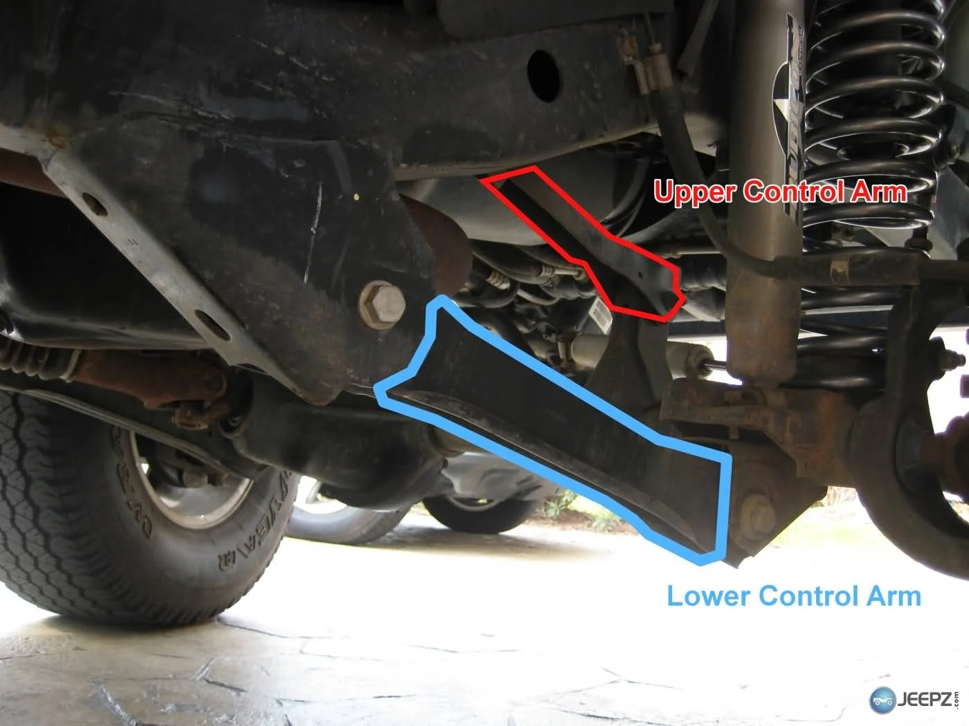

1. What CodaMan said; stock spring lengths are 12" front and 8" rear. There are two types of lift, suspension and body. If it has a body lift, there will be puck spacers between the body mounts and the body. That could account for some of the lift, or it may be all suspension lift (i.e. 18" and 14" springs)
2. The drop pitman arm is only beneficial when the frame-side track bar mount has been moved or modified. If you add a drop pitman arm without also moving the frame-side track bar mount down, you will have bump steer. Pictures of the front axle linkages and steering linkages would help give you a better answer!
3. Again pictures would help. There could be a lot of different things going on. It may be an aftermarket longarm suspension lift. Stock linkage looks like this:

Notice the red outline. He drew a weiner.
