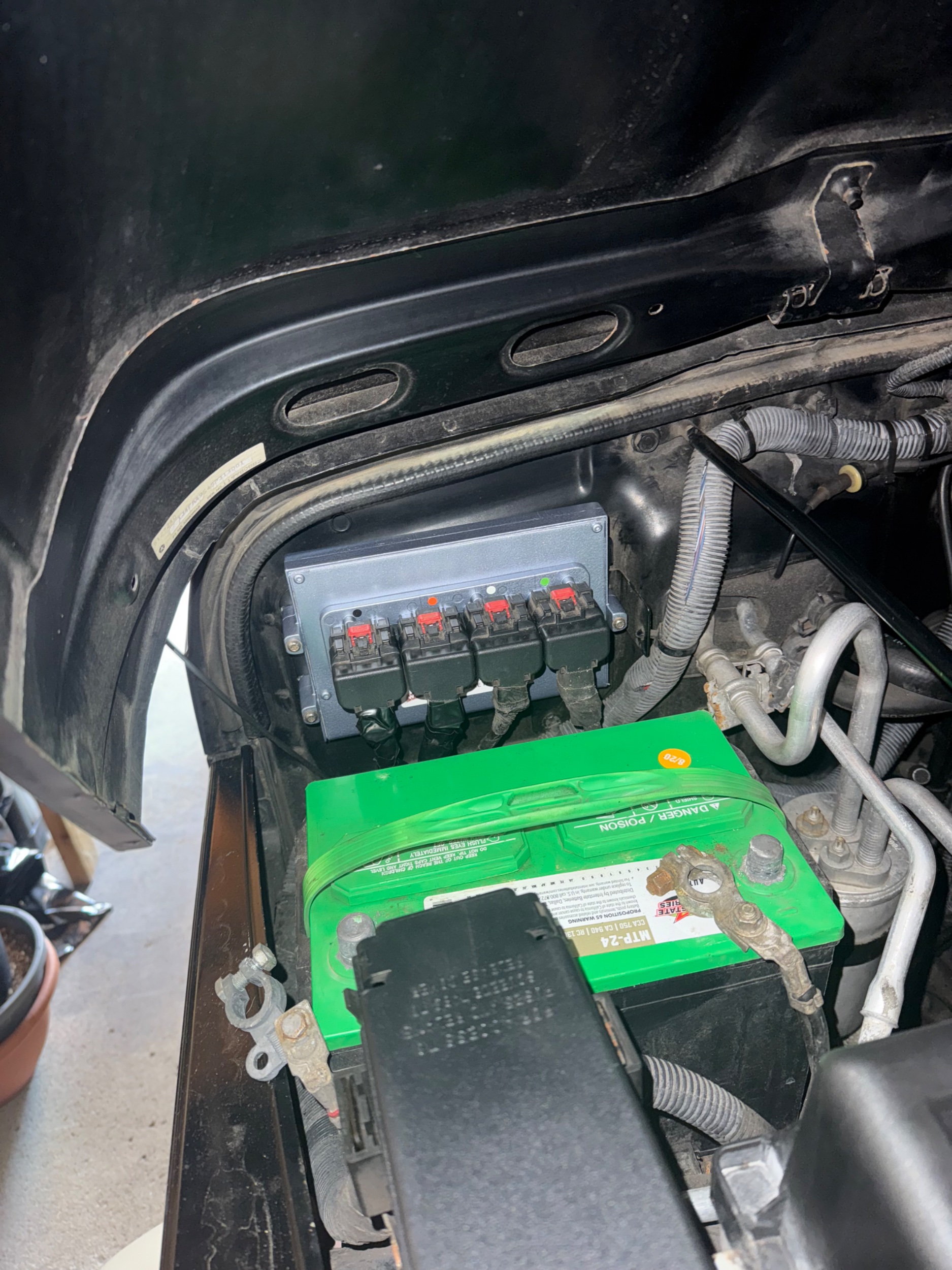

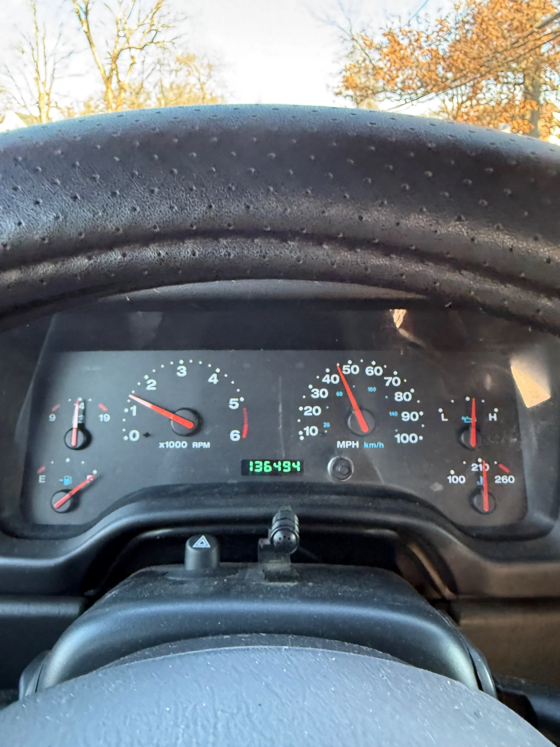

At first only two of them were reading, now I have all 4 so really think it's a PCM issue.

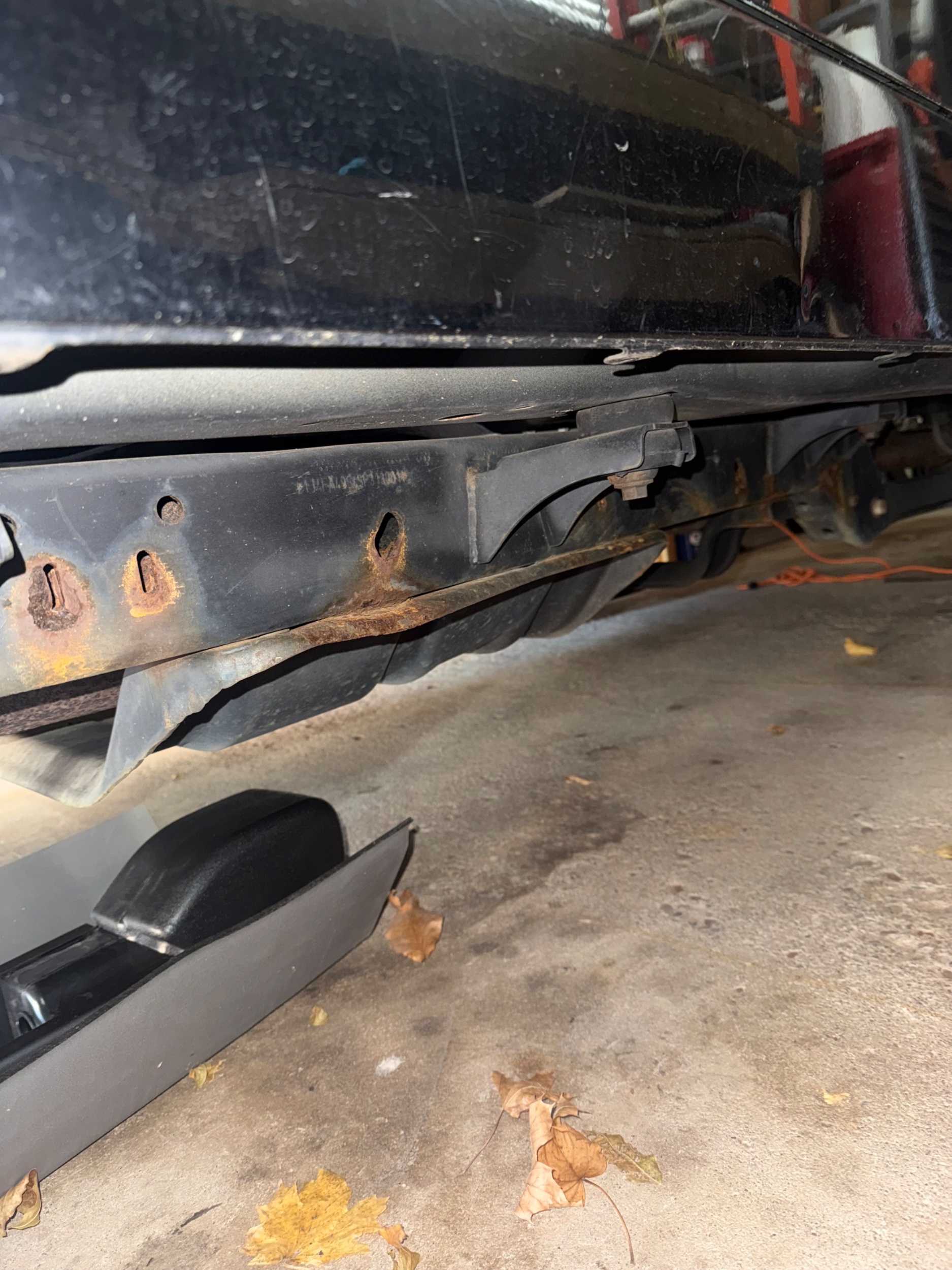

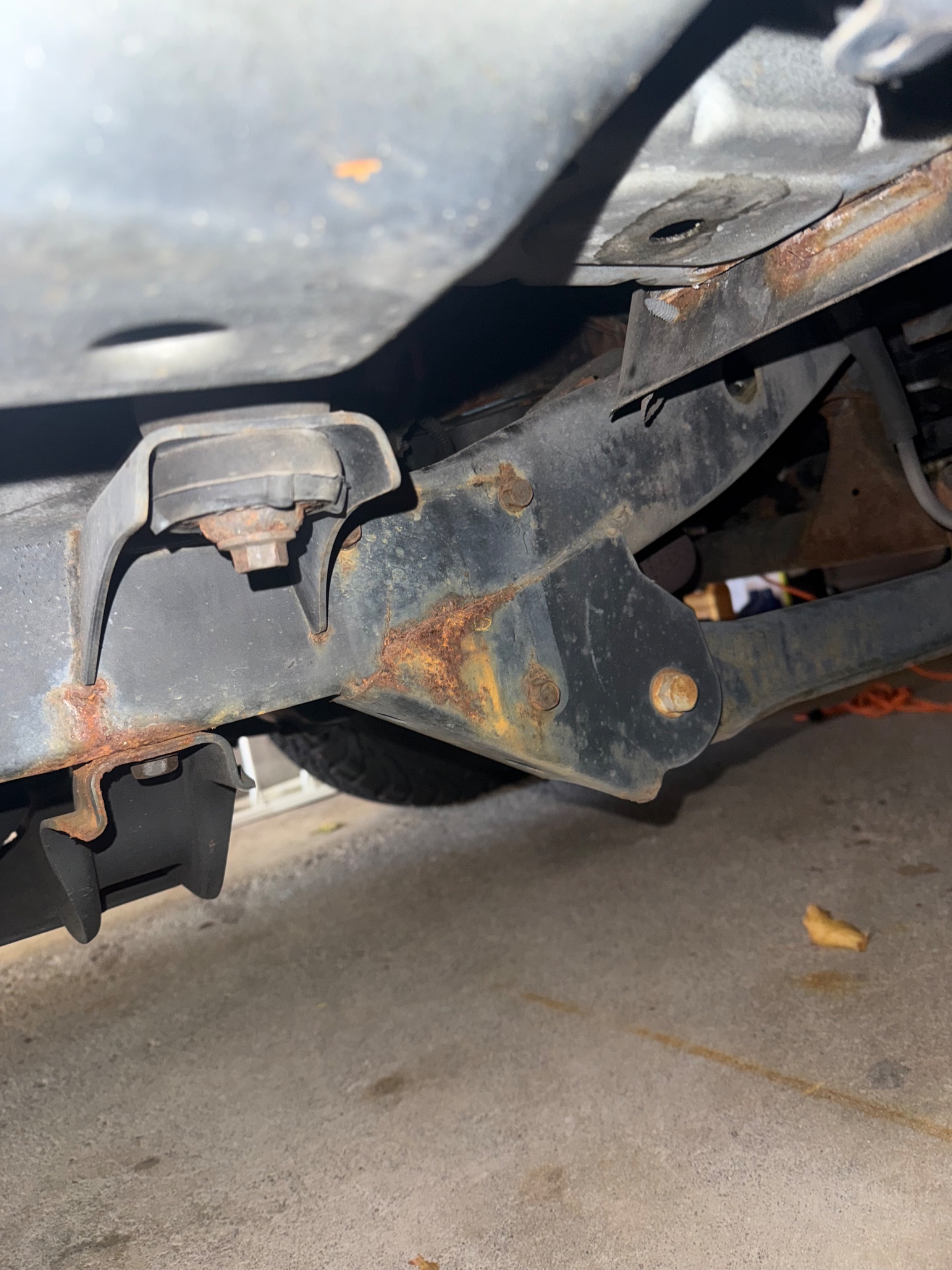

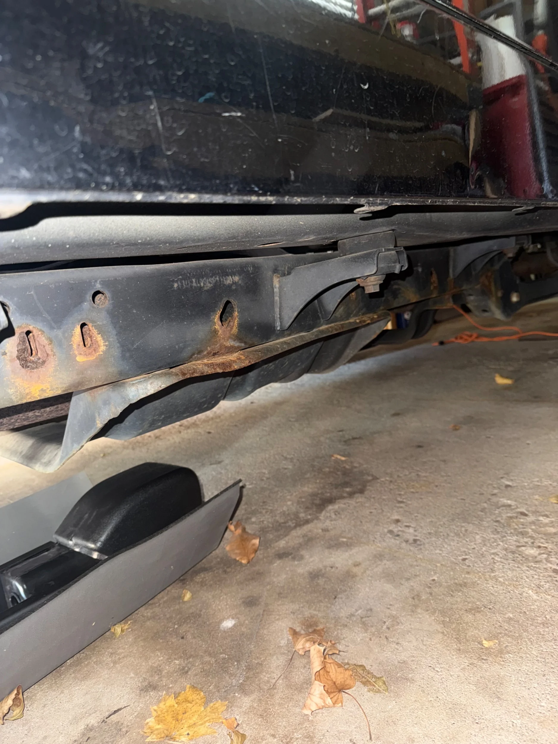

How does the frame look on this? Only asking because you can see the rust at the skid plate. I would want to make sure the frame is solid before I would start investing too much into it.
Hey Maximus,
It is a sport not a rubicon. In regard to the rust, I did check that lol. That was main selling point for me as I thought the frame looked really good for a northeast jeep.

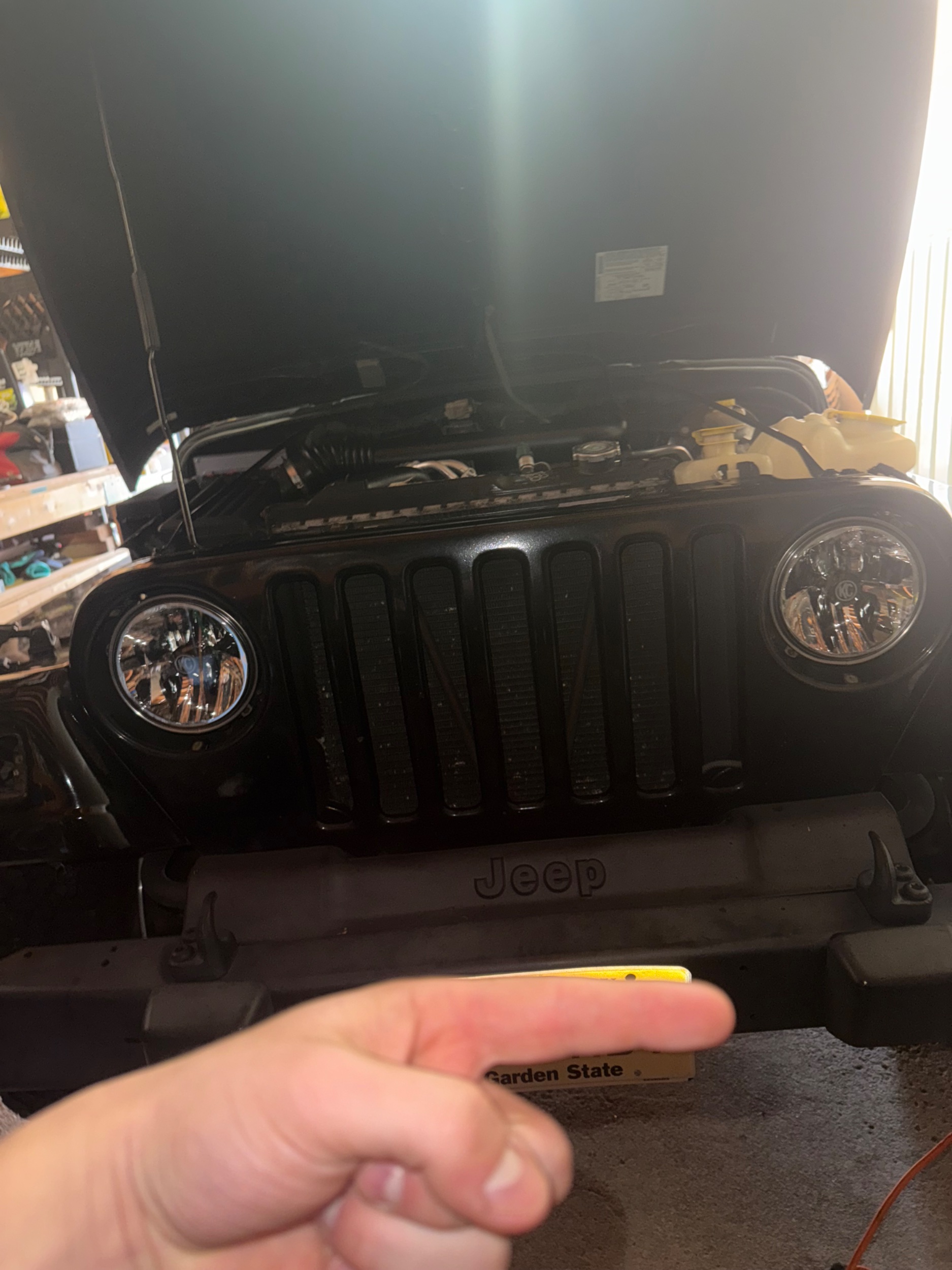

-Installed the new KC hilights
-Installed wranglerfix PCM
Had to learn how to do soldering as previous owner had aftermarket’s leds that weren’t compatible with oem wiring harness. Have to finish soldering up signals but think it’s coming along!
I turned on car and engine light was off and Headlights look great! Both signal lights were on, on the dash but think it’s due to the connectors being removed and not finding a ground?? I think will resolve once everything is hooked back up.
Hey all, good news! The engine light is off thanks to the new wranglerfix PCM.
In the future, don’t do any more soldering of wires. Over time vibrations cause the solder to crack and the connection to fail.
The best connections are made by a non insulated butt connector crimped with a stake and covered in adhesive heat shrink. Fast, easy, reliable.
