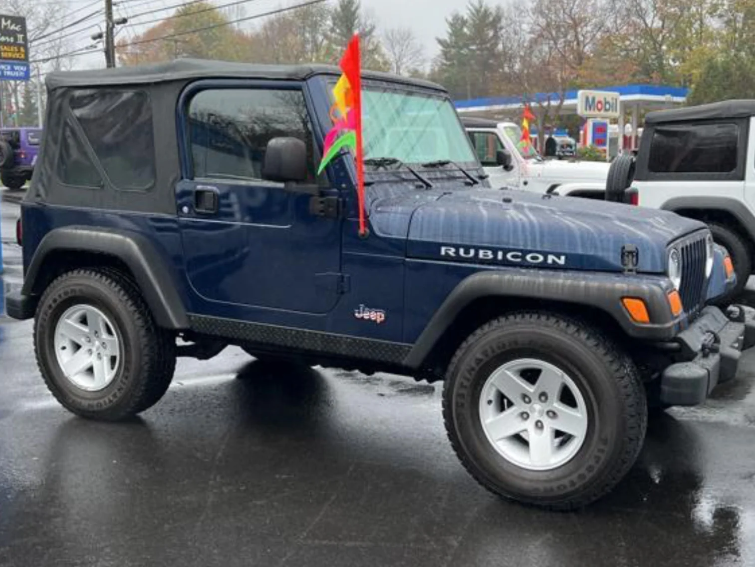

Like others have said. Be very careful that undercoating is a red flag in my eyes.
Heck the dealer could have applied it. Never trust a used car salesman.
Inspect the inside of the frame by the skid plate and at the low points by the front and rear control arms very carefully. . These frames are notorious for rusting from the inside out. Stick you fingers in the frame holes. Again a boroscope will save you from any future headaches.

So a clean looking frame on the outside may be brittle inside. A NE Jeep with no rust is extremely rare, Also if your mechanic friend doesn't know TJ's he may not be aware of the frame rot issue.

Going to check it out thoroughly. I do trust the dealership. It’s a small place, only three guys. father, son and one other guy. They only sell and work on Wranglers, nothing else. They have a really good reputation in the area. They all drive Jeeps, and are only a half mile away from me.

And if you do end up getting it I would get rid of all that undercoat crap. It’ll end up just aiding rust in the long run
The finger test is great because it can quickly rule out a jeep if you immediately feel a pile of what used to be the frame now in giant flake form sitting right there, however a savvy seller can clear that stuff out but may leave behind piles of flakes further inside.
So, I third the motion to get a boroscope in there & poke around from stem to stern, literally every inch of the interior of the frame will be accessible with one of these things, I think the cord on mine is at least 5 or more feet long & there are more than enough entry points spaced out on the frame so you really only need to get a foot or so in...
I've seen more than enough frames here in the rust belt that appear decent from the outside but closer inspection reveals a disaster inside. Most bad frames however will show outward signs too, if not clearly visible rot/holes, at least bulging around the factory openings is usually an obvious one. Also, when you look at a TJ from a distance & see rust on the rocker panels and/or fenders you can usually assume the frame is hosed, but lack of rust on the body is unfortunately not conclusive as to the condition of the frame, it must always be examined regardless of how perfect the body may be.
I second the boroscope....worth every penny. Also consider a preinspection evaluation by a mechanic hired by you. I just used lemonsquad.com. Seriously amazed at the quality of the whole experience. $200These frames are notorious for rusting from the inside out. Stick you fingers in the frame holes. Again a boroscope will save you
Decent advice, except what I've learned is that you can't make any assumptions. My Sahara has some tub issues, but no torque box issues, and the frame is perfect. Like this post, when I first saw it for sale I was sure it was a pile of rusty frame rot. I finally stopped to check it out. tapped the frame.... stuck my fingers in all the holes..... got a chipping hammer and tapped harder over the hole frame.... borescoped the frame.....
