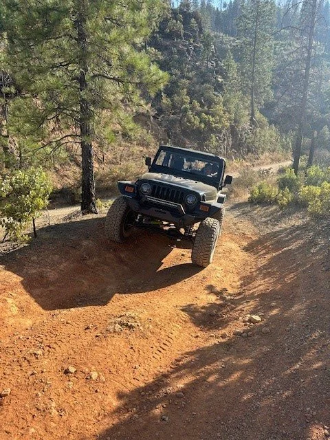

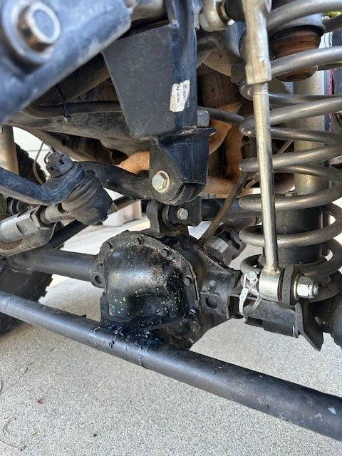

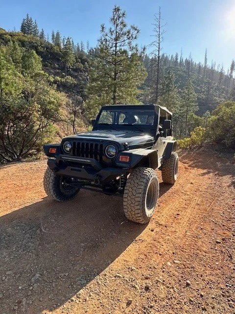

Hey every one, I picked up a new to me 2000 TJ Saraha 4.0 5sp recently and have been reading everything I can on here and everywhere else. As far as I can tell its got a RC 6" long arm kit, SYE, 35" coopers on 15" wheels, and just about every RC product they make. Its been a blast driving it around and hitting some local trails and learning about it. I have a few questions i was hoping you guys could help me out with,

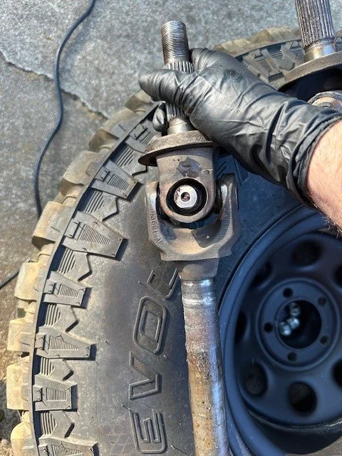

1, this jeep rides like shit, it wanders all over and sways back and forth and is jarring over any bump. I did do a dry steer test and replaced the frame side Track bar bushing. I replace the front U joints / stub shaft and checked all tie rod ends for play. it helped but its still kind of a handful to drive. Is it normal for a RC 6" kit to be this bad? I don't want to toss a bunch of money at it but I'm thinking new shocks are coming next
2. if I do get new shocks should i get new springs too and drop it to a 4" lift? will the RC long arms work if I go this route? I will 35's clear?
3. I want to ditch the dropped pitman arm and dropped track bar bracket and go back to Stock with both. Is that do able with a 6" lift?

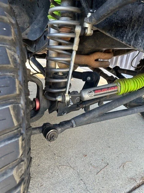

Poor ride quality: this is most likely due to your shock absorbers. Rough Country is known to be low-quality especially when it comes to shocks. I recommend replacing with skyjacker blackmax shocks - these are also cheap, but they are soft. Also check your tire pressure. With 35” tires, you should be around 26 psi on road and somewhere between 8 and 15 psi offroad, depending on how much extra cushion and traction you want to gain.
Wandering: Check the toe-in of your front tires. A slight toe-in will make them track straighter. Also check the caster angle of your front axle. Positive caster makes the steering self-stabilizing, while negative caster makes the steering self-destabilizing. The number you’re aiming for is around 6 to 7 degrees of caster, which you’re probably not getting with that high of a lift.
Lift height: 6” is higher than necessary to clear 35” tires while retaining a good amount of travel/articulation. I recommend lowering to at most 4” of suspension lift (body lift is another topic). This would require replacing your coils and shocks. I recommend rockjock coils and skyjacker blackmax shocks. As part of the long arm installation, the control arm brackets on the frame were cut off, so you’re stuck with the long arm linkage without major welding and fabrication. I can’t answer for sure whether that long arm system works well at 4” of lift but I suspect the answer is yes. Lowering the lift height will mildly reduce body roll.
Trackbar: There is an aftermarket trackbar drop bracket bolted to the factory one. I recommend removing it in conjunction with both lowering the lift height to 4” and replacing the drop pitman arm with a factory version. The factory bracket, which once had a tapered hole to accept a tie rod end, has been drilled out. It is no longer compatible with a stock track bar, but many aftermarket track bars are installed in the same manner with that drilled out hole. I recommend the Rockjock front trackbar, but do check the diameter that your bracket’s hole has been drilled out to and ensure it is correct for whatever trackbar you get.

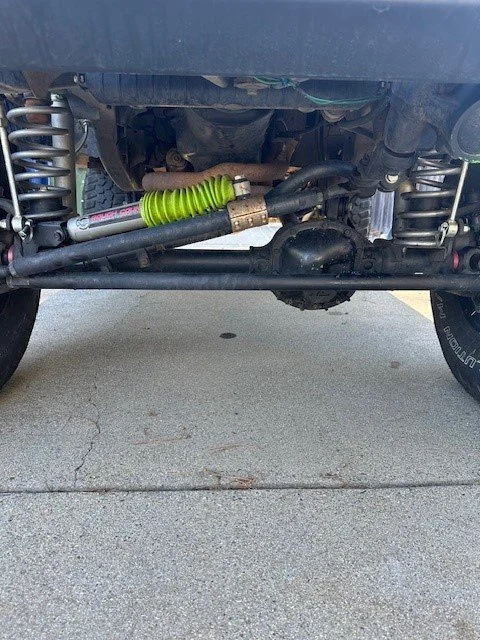

Edit: you didn’t mention this, but I just noticed that your steering linkage is not the factory “Haltenberger”/“Inverted-Y” configuration. It is an “Inverted-T” linkage and is susceptible to tie rod roll, which creates a dead spot in your steering. This is likely contributing to some poor handling and wandering. I recommend replacing that entire linkage with either a ZJ Steering Linkage upgrade or a Rockjock Currectlync.
If you have any questions on any part of this, don’t hesitate to ask and I can further elaborate.

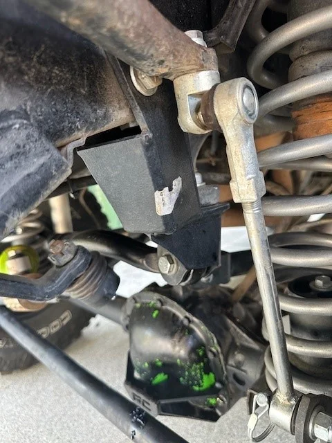

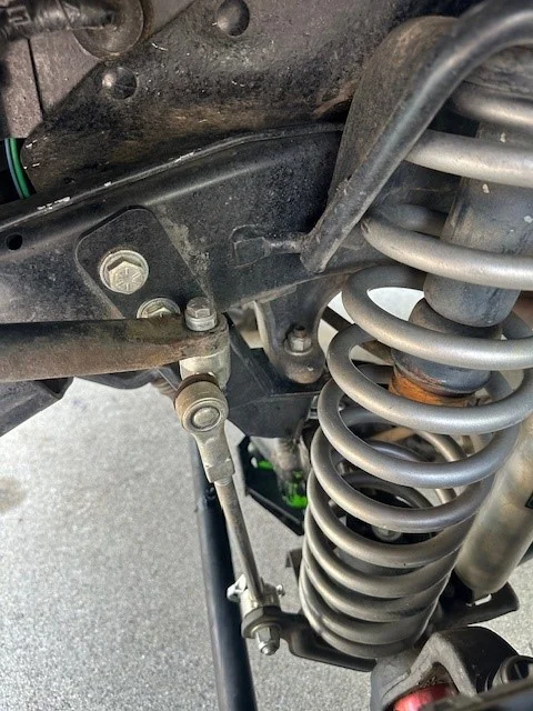

Here's the frame side track bar mount. Thank you guys for the insight and help on this. I reached out to RC to see if the 6" arms and the 4" arms are the same. sadly the stock frame mounts have been cut off so I'm sticking with the long arm kit. with better shocks and springs and steering I'm sure I can get it dialed in.
Good catch on that linkage, I knew it looked off from just a glance. Looks like its an RC HD steering kit, it must steer like crap.
I am in the market for a new linkage setup soon thanks to 24 years of neglect to the front end from the PO, would you recommend the Currectlync over the ZJ upgrade?

Personally id drop the height and lose the adapter brackets. Toss in an oem pitman arm as well.
That alone should reduce the issues you are having. rough estimate would be like $750 for all parts.
If you want to do it all, go for the crown HD kit since its $200 on amazon right now rather than the $700 for the currectlync.
Refer to this thread for the comparisons between currectlync and "ZJ Upgrade"
the bummer on the pitman arm and track bar is going to be finding a new track bar that can use a bolt on the frame side. they drilled the tapered hole to install the drop bracket and the rc bar wont bolt into the stock location.
Most aftermarket track bars, other than the RC bars with the ball joint, use a bolt frame side. Look at options from Rock Jock or JKS. Do you know what size the frame side mount was drilled to?
