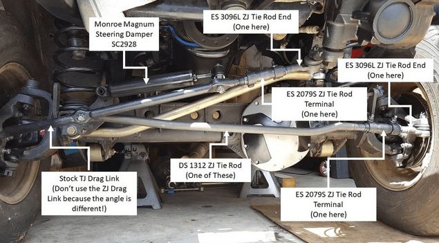

Pretty sure I did the ZJ components on all tie rods and what not

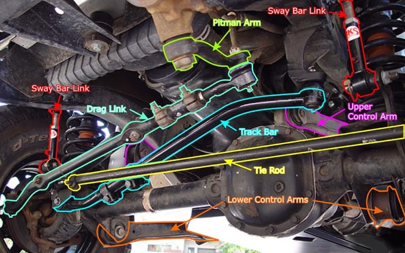

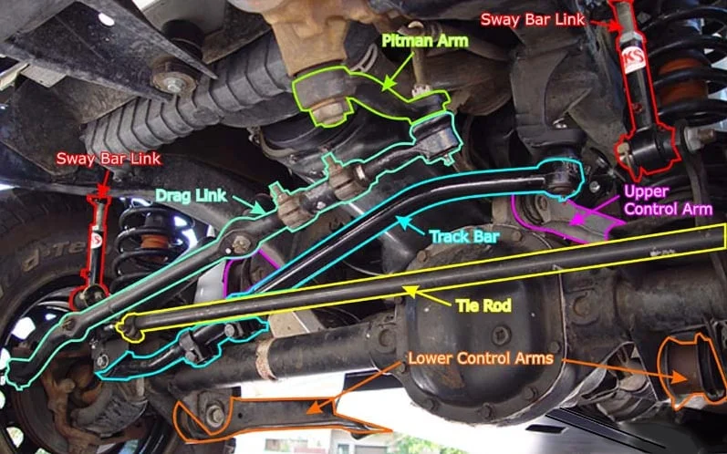

Everything highlighted was replaced except I got a new bushing only for track bar and later realized I screwed up end of last season
I was chasing a horrendously loose steering issue
MOSTLY resolved, but still minor slop
