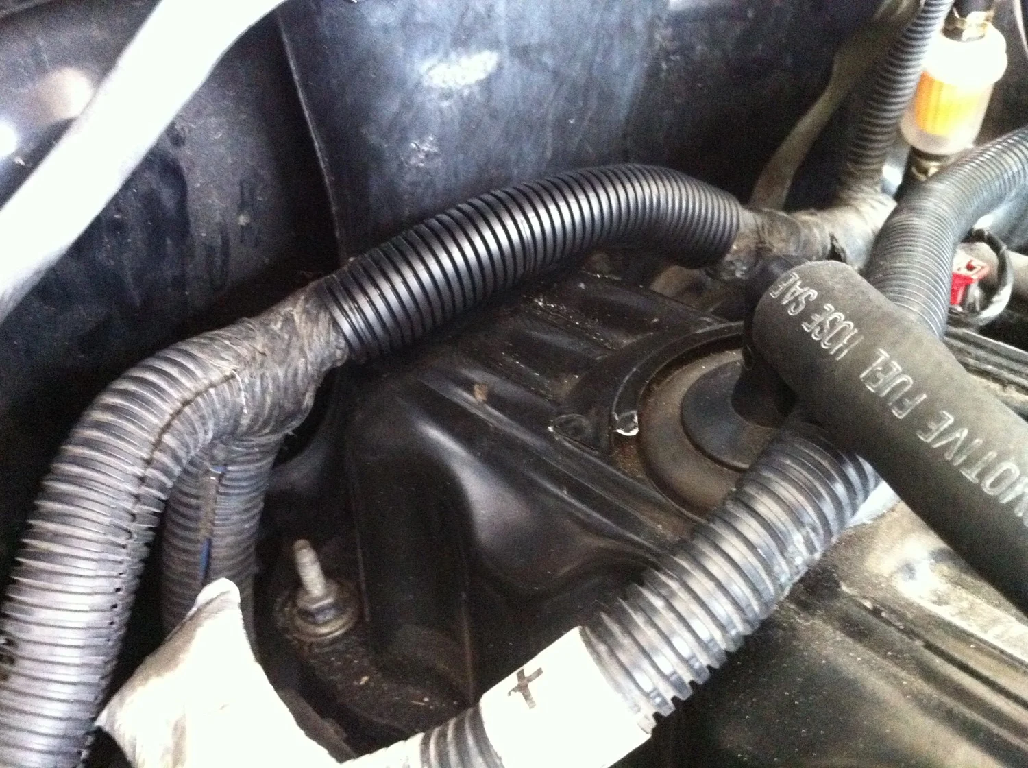

Looking at replacing mine as I just finished the RMS. I’ve read on the forum that the most difficult part is the bridge at the rear of valve cover. Any secrets to help in removal ?
Proper torque is the key, I think it may be due to the plastic valve cover. I believe it distorts easily enough that over torquing causes leaks..... I do not have an answer about the washer on the rear bolt, but I bet mrblaine or Jerry Bransford could answer for you......
My valve cover was metal, not plastic. The secret for the rear bridge is to loosen the screws holding the extension along the d/s support. It was not easy but there was enough movement that removal was not really that bad. Also on the front AC lines (if you have) there is also a bracket up front to remove.

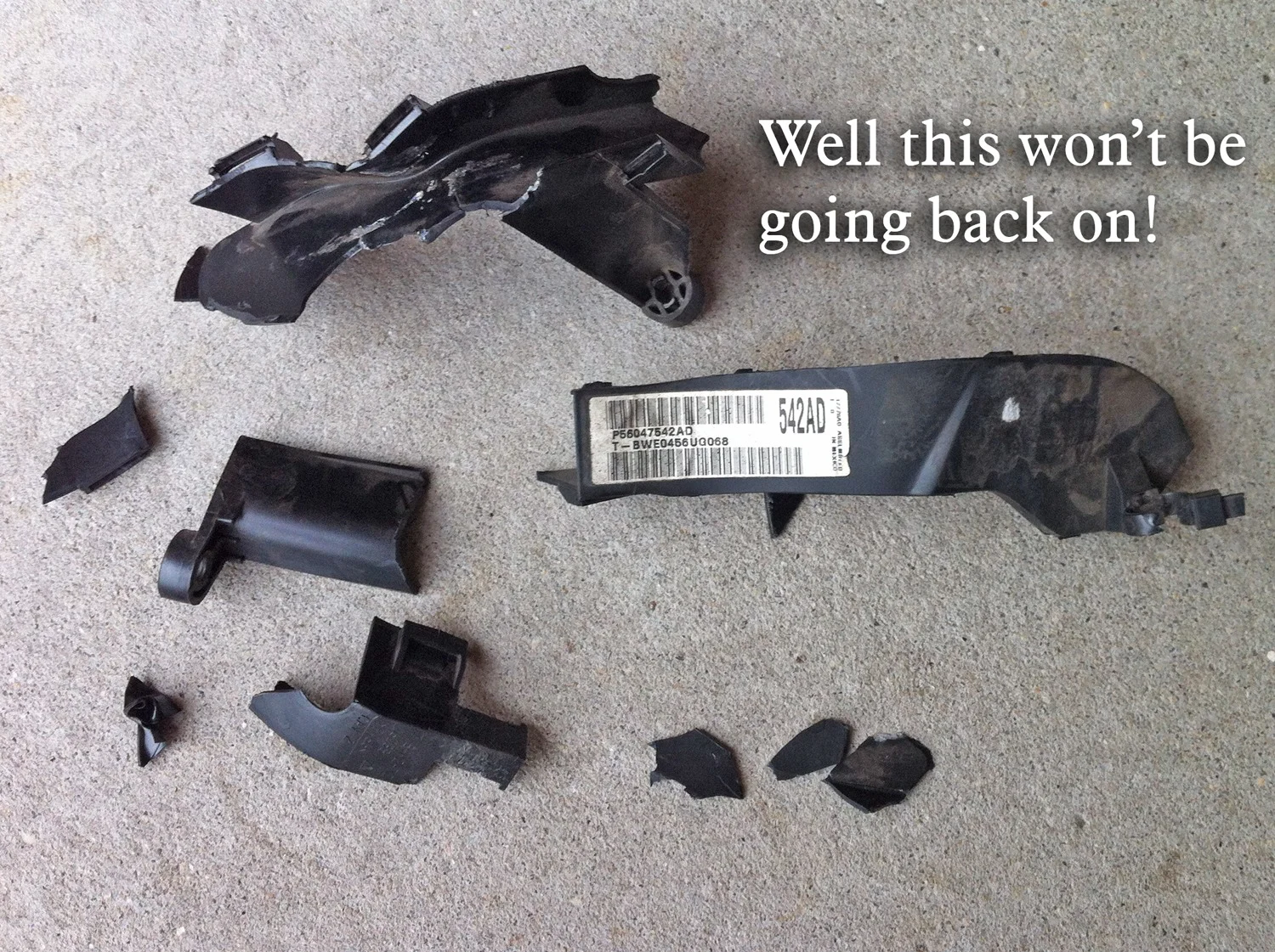

Pull that thing right off and bin it, this is what mine looked like when I got it off. I wasn't trying to be carefull though, the plan was to bin it, so I didn't care. As you can see, you don't really need it.
