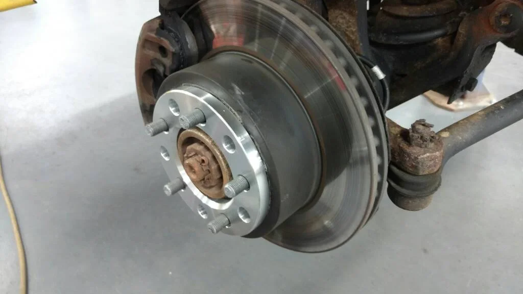

Lugs are not meant to handle shearing force, which is what lug centric rims/spacers will cause. The hub should be what is handling the weight of the vehicle. Yes, most aftermarket rims are lug centric as it would be too costly for them to make rims with correct hub sizing. That's why you can get hub spacers, and some wheel manufactures will provide the size needed for your application.
When you hit a bad pothole on the hwy, and shear the lugs off, you'll wish you had done it properly.
That's ok for a simple spacer like that. Due to my 15" wheels, I had to add a similar 1/4" thick spacer once I installed my Big Brake kit from Black Magic Brakes. Pretty much any aftermarket wheel is going to be lug centric which works fine. Take a look at the lug nuts, they pull the wheel into position so the lug is centered in the hole. The only wheels I've ever seen that were hub centric are factory wheels, though undoubtedly somewhere you could find hub centric if you looked extra hard.

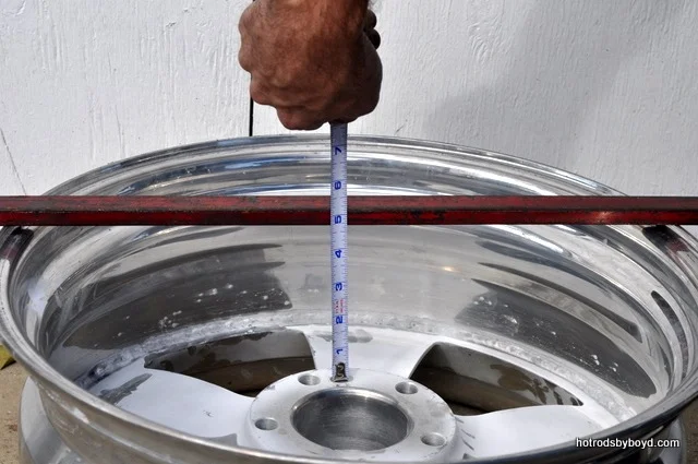

Backspacing wise as everybody has said go 3.75-4-ish and you'll be fine. I'm running 33x12.50-15 BFG KM2s on a ~2" lift with 3.75 B/S i'm not rubbing at all front or rear. The tires will stick out of the stock 2" flares about 2-3" but it's not obnoxious.
