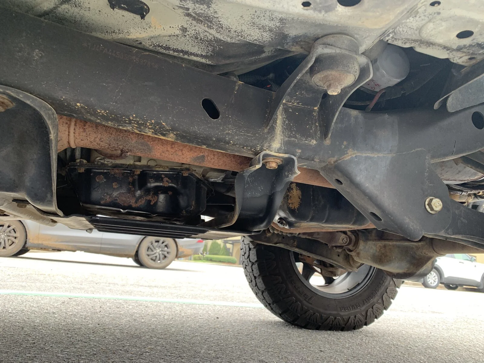

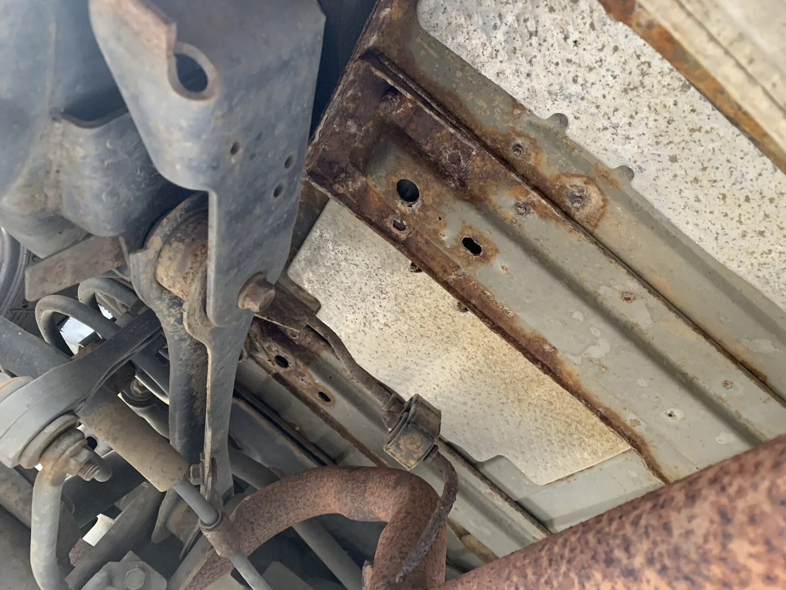

Pretty sure I know the answer here but I have questions about how bad the rust is. Anything else you guys could point out in pics would be appreciated
It is fifth owner, came from New Jersey and has 135K miles. New valve cover gasket. Said he just had a transmission leak fixed and the mechanic told him the main seal was leaking a tiny bit. He said he checks the oil and it never needs any.
He said it had 2 inch body lift. This is not it correct?

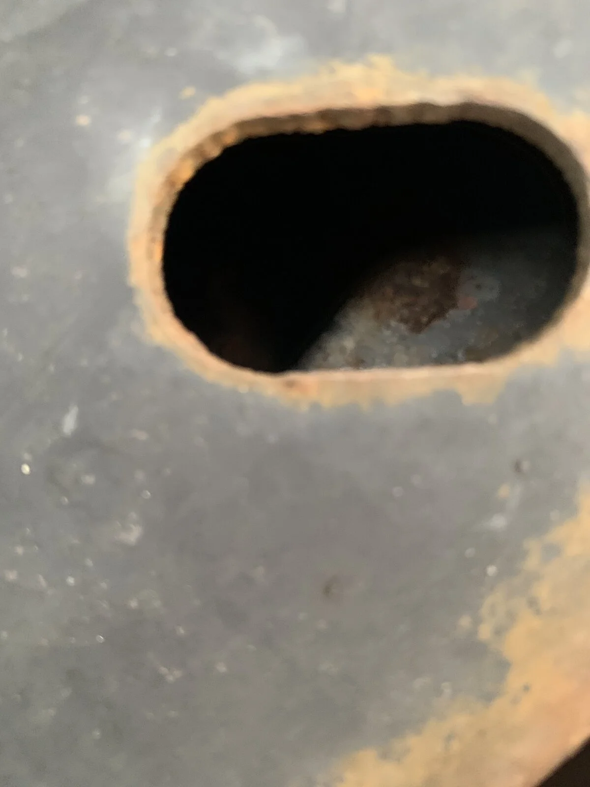

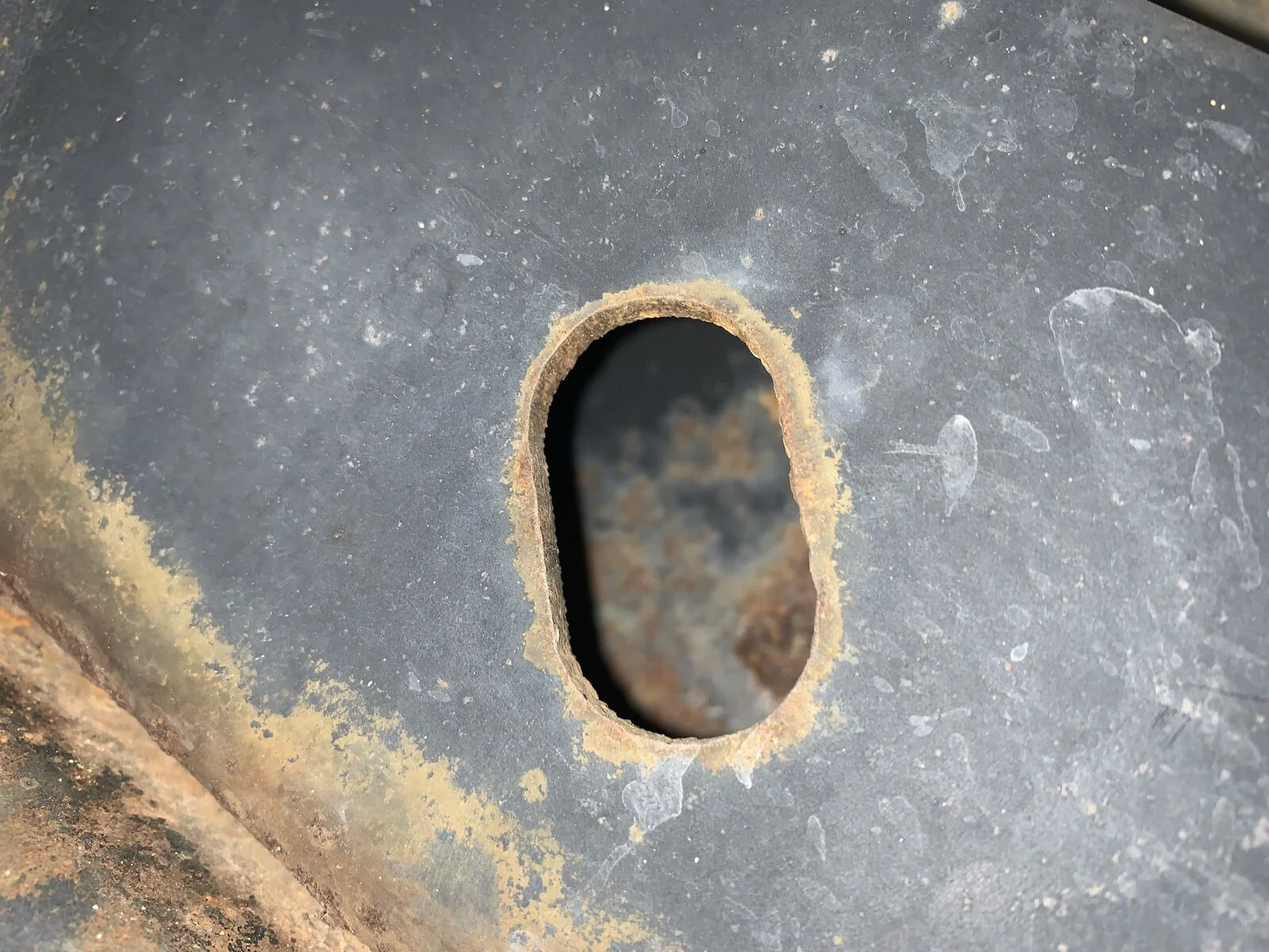

Driver side rear hole in frame same hole Passenger side

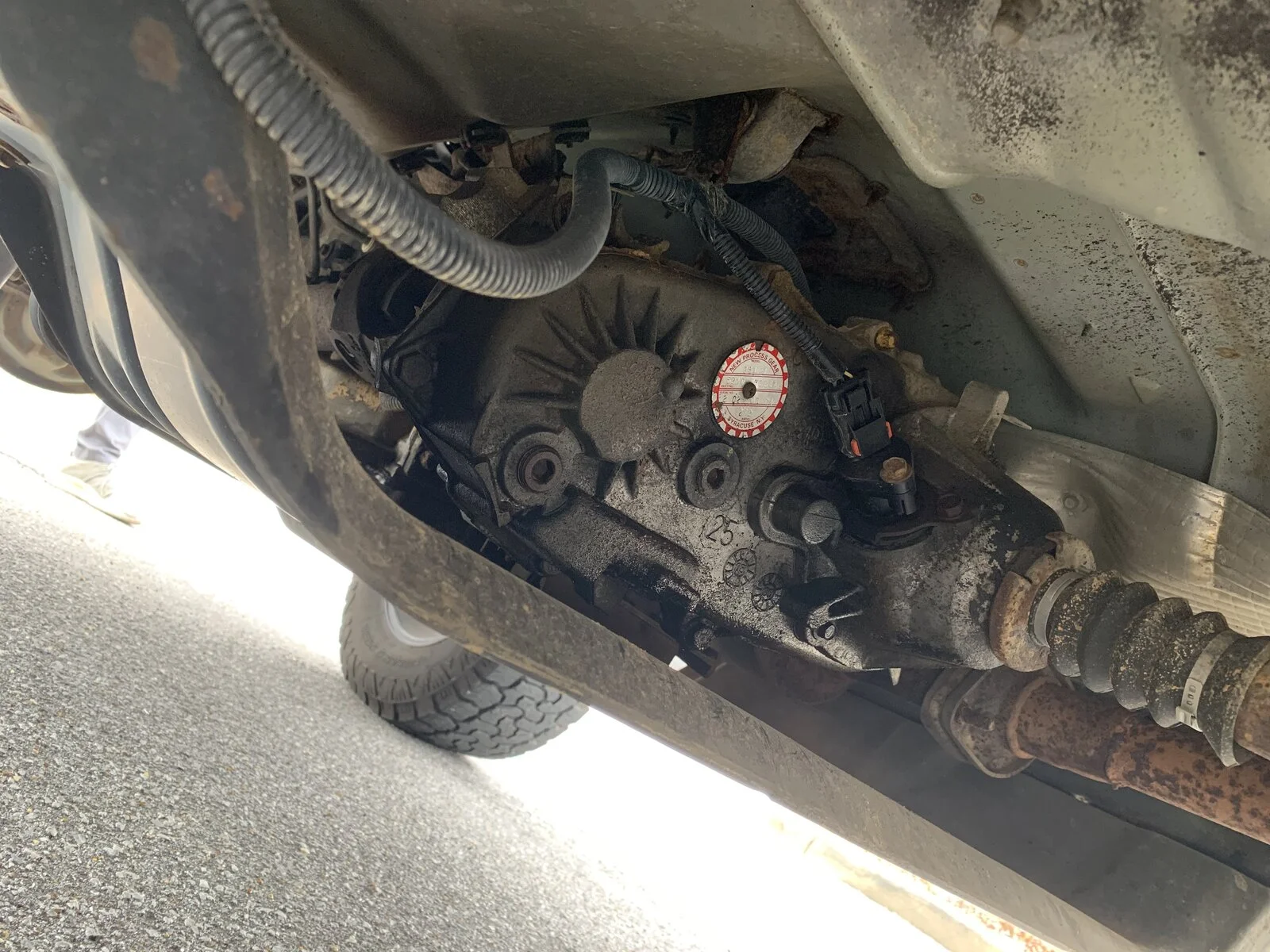

What is that tag?

No body lift
You’d need to measure the springs to check suspension lift.
That’s not rusty at all!
Depending on the price it’s a strong average condition LJ

X2, there's no body lift on that Jeep. Actually the rust, while always alarming at first glance, doesn't look bad at all on the frame where it counts.

Did you look at it in person? If you can, use an inexpensive borescope from Amazon to inspect the interior of the frame (or for future inspections).
The manufacturer's ID tag. It gives you the model number, serial number, etc. of the transfer case.

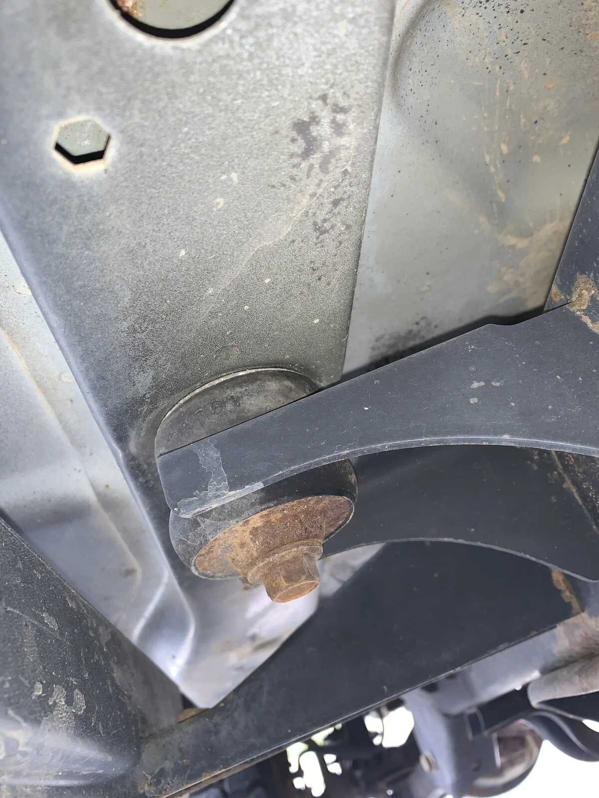

If that rig spent its whole life in Jersey (well, depending on what exit...), it was very well taken care of in terms of keeping the rust in control. I don’t see anything alarming, especially in the key spots as Jerry said. The rear lower control arm amounts are always the first to go, and they look good.
it actually bodes well that the rest of the vehicle was taken care of as well.
