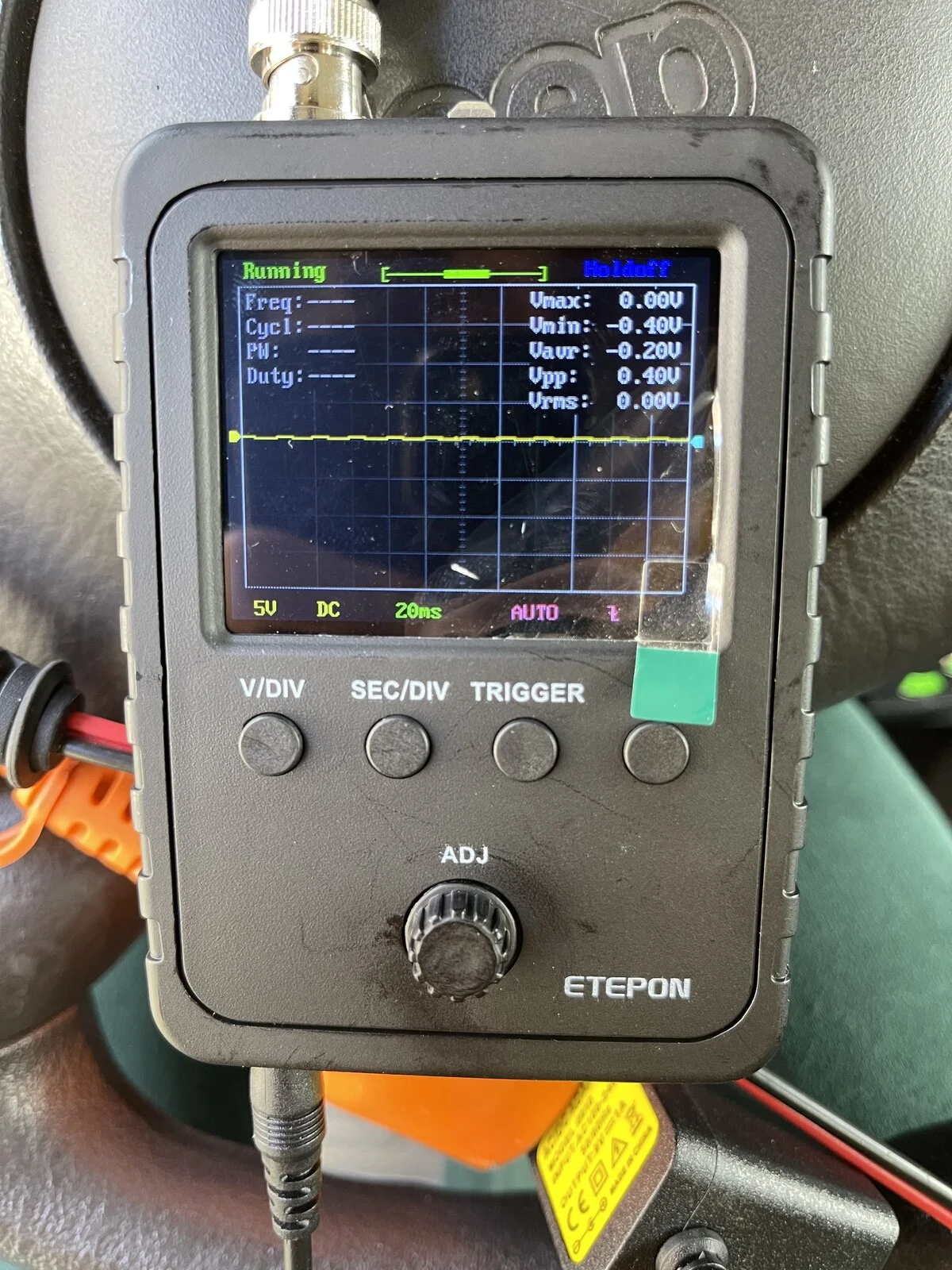

I've bought the same(ish) oscilloscope as in your video, apart from the color, but I am struggling with mine. I entered the same settings (from what I can tell) as you had on your oscilloscope (5V, 20ms, trigger auto, DC) but I when I crank my engine nothing changes on the screen... I connected everything as you explained, red on signal wire and black on battery ground. Any idea on what I might be doing wrong? Or did you do something extra to callibrate it because the "manual", if you can call it that, is almost non-existent for a novice like me to callibrate it correctly...
You bought the dark gray one?? That one only works in Europe where they run on 50hz.
Just kidding. Yes, the manual is a joke. I struggled with the calibration because the instructions barely made sense. Re-reading mine, I believe you hold down the v/div button to enter calibration mode. Then adjust the voltage through its entire set of ranges. Then switch the coupling mode and cycle through the voltages…repeat for all coupling modes. I remember doing it several times because something about it didn’t feel right.
Even then it wasn’t perfectly calibrated. I tested it against my 5V supply and adjusted the voltage knob until it was at the major tick on the y axis. In DC mode.
Then I connected to the sensor and when I cranked the engine the numbers fit the RPMs so I felt good about it.
Tried it multiple times, but my oscilloscope does not go into callibration mode so I think it's faulty and will send it back.
