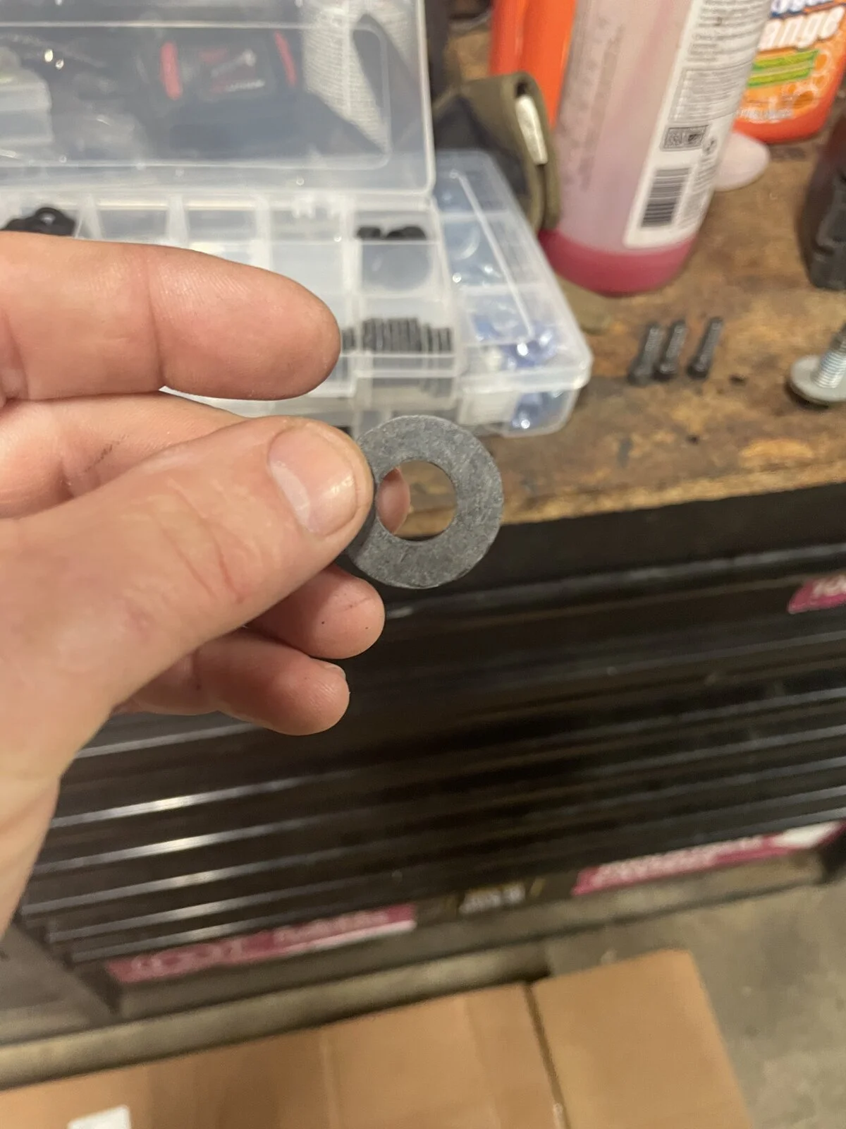

Any issues with sandwiching a strip of rubber down each frame rail between skid plate & frame?
So, 03 Tubicon w/UCF skid as well. Belligerent vibration starting. @ 65 mph. Just replaced my vibe damper on tcase w/ minimal improvement. New Mopar Tcase mount. DS x2 & tires balanced.
Not that I know of- i’m using 1/8 thick x 1/2 “ washers for that, at well as I like a slight gap to wash out grime and discourage rust. Primal Industrial sells these online.
All that said, if it started recently I’d really be looking at anything that may be loose or changed, such as a lost drive shaft weight.
These 4 grade 8 bolts go through the the skid to the mount - they are 1/4” shorter than UCF supplied and I added 1/8” rubber here too -
Getting these away from the upper half of the skid, even though it has clearance holes, helps prevent contact from lateral movement of the mount. Keep in mind the lo pro mount is an entirely different animal from any mount on a Jeep, And the drivetrain will do different things under different torque loads and different speeds- But essentially it always do the same thing- and that is move some way.
