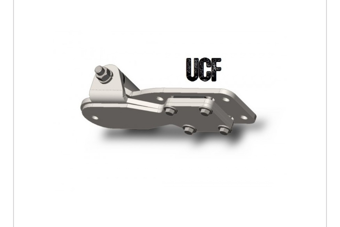

No vibe UCF LoPro mount
Did you get the exhaust worked out?
Some forget that if you move the trans up (TT), that angles the engine down in the front, which pivots the whole exhaust up in the rear. It's usually the muffler or tailpipe that hits.
Yes- I had a motor mount lift planned so when I did that it corrected the slope I created- And I did a body lift and did 4:88 gears.
