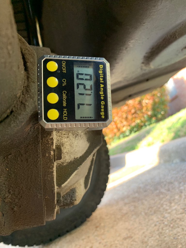

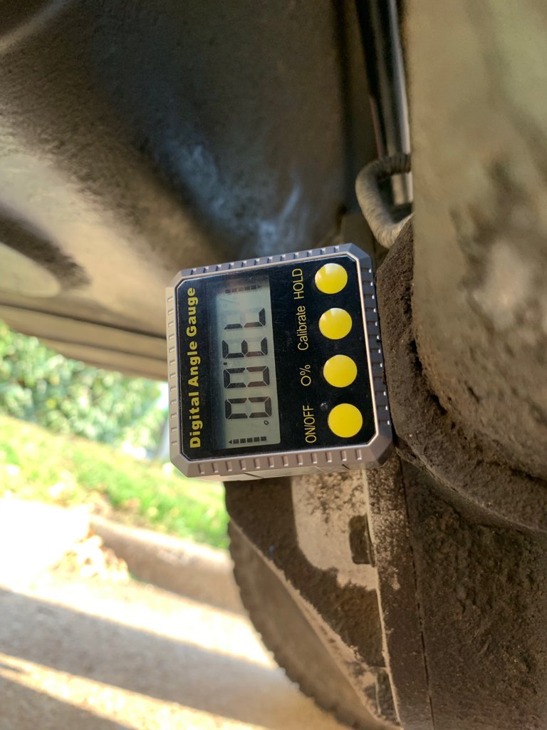

I checked the pinion angle yesterday and I'm pretty sure they were within a degree of eachother, with pinion about .5 lower than shaft, but I'm going to check again today in case i confused myself reading the pinion angle subtracted from 90. I also noticed to play at the ujoints or axle yokes

The pinion and DS should be in a straight line. The rear pinion can take a little down, but never above the DS. It would really help if you could take a pic, from the side showing the TC output shaft and the pinion yoke.

Exactly as mentioned above When you install a DC shaft, the 2 joints at the transfer case do all the work of making the angle down to the axle. The angle between the driveshaft and the pinion should be 0. If you have a little bit of downward angle in the pinion, it is probably close to OK, so you don't feel any vibes driving. But when you let off the gas, especially at speed, the drag causes the pinion to point down a bit more, and makes the vibe more apparent.
My bet is your pinion angle was set too low. Decelerating further lowers the pinion angle so if it's a little too low to begin with, it would get even lower during deceleration which would cause problems. The pinion angle should look exactly like in the illustration above in T's post.

I did notice that the measurement spots on the rear of the axle gave me different readings. Not sure what that’s about
I wouldn't worry too much about all the other angles of the axle. You mostly just want the pinion pointed right at the transfer case. And looking at the pics, it really looks like you are in pretty good shape. It might be just a touch low. Not enough that I would worry about really, but if you're getting vibes, there's nothing wrong with just trying to raise it a touch higher and see how it feels. I'm certainly no expert on these things, but it seems like you have quite a bit of splines showing. Certainly more than mine does, and I am also running one of Adam's driveshafts. I am wondering if the shaft is a little over extended and it's actually wobbling a bit? This is getting beyond my knowledge level, but it just has me wondering. If putting half a turn the upper control arms doesn't help your vibration, it might be worth sending a pic or two to Adam's?

I don't need an angle finder to see from your first photo that your pinion angle is too low.
